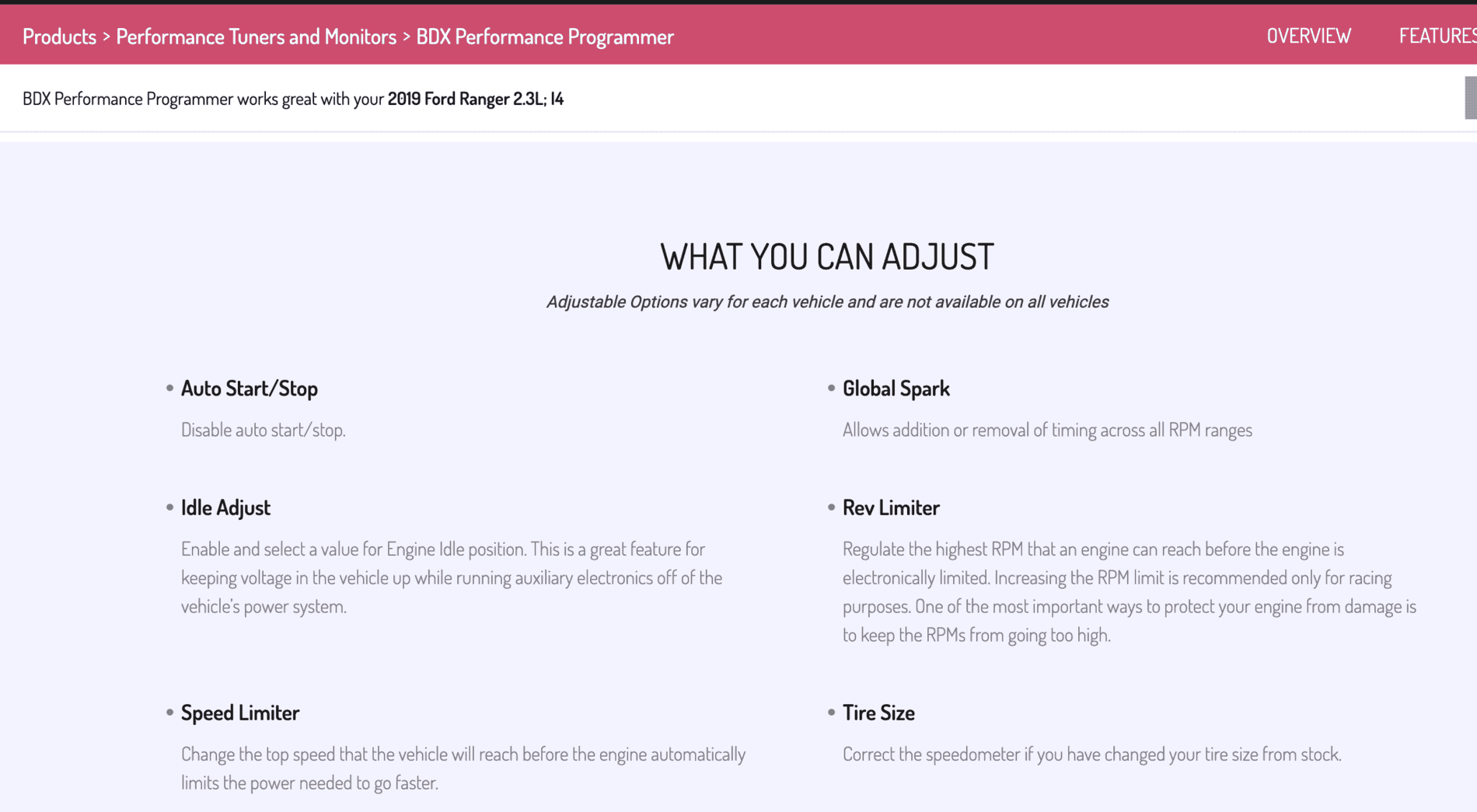

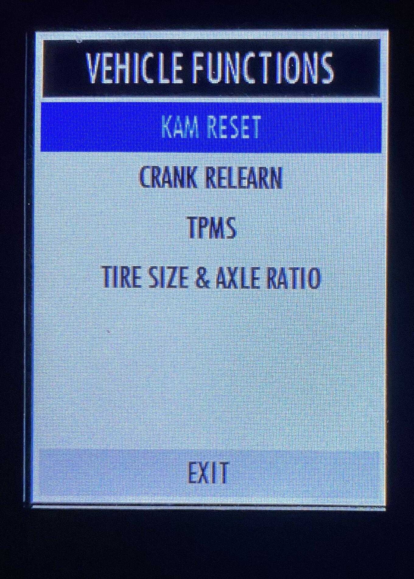

This is not correct and who ever you spoke to is wrong. I had been checking their site under the Ranger consistently waiting for this to release under the What Can You Adjust section. It finally popped up last month and I updated accordingly. I just went out and grabbed this for you:

I did change it to be correct with my 33's. It worked perfectly. It literally asked me for tire diameter, in which case I entered 32.7 as that's where my KO2s land. I confirmed the new speedo with GPS and it's spot on.

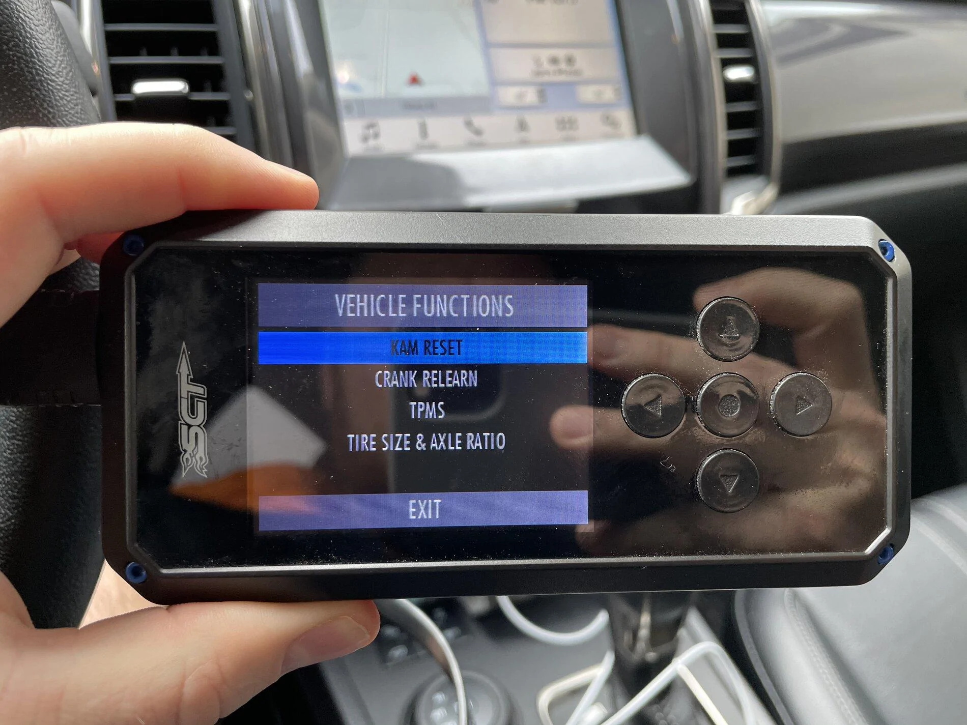

Well it sure does show it on yours. Crazy mine does not and they told me you cannot. Mine shows Kam, Crank, and TPMS but no tire size & gear ratio.

I’m in the truck now de-tuning it. I’m wondering if it’s because I loaded a custom 93 tune and not the stock SCT canned tune?
I did remove the Hypertech tire size tune so that’s not the issue if it would even be one.

That was the problem. Canned tune has it. Custom tune does not.
Now I need to decide if custom tune is worth it and having to use Hypertech for tire size or use canned tune and only 1 device???
