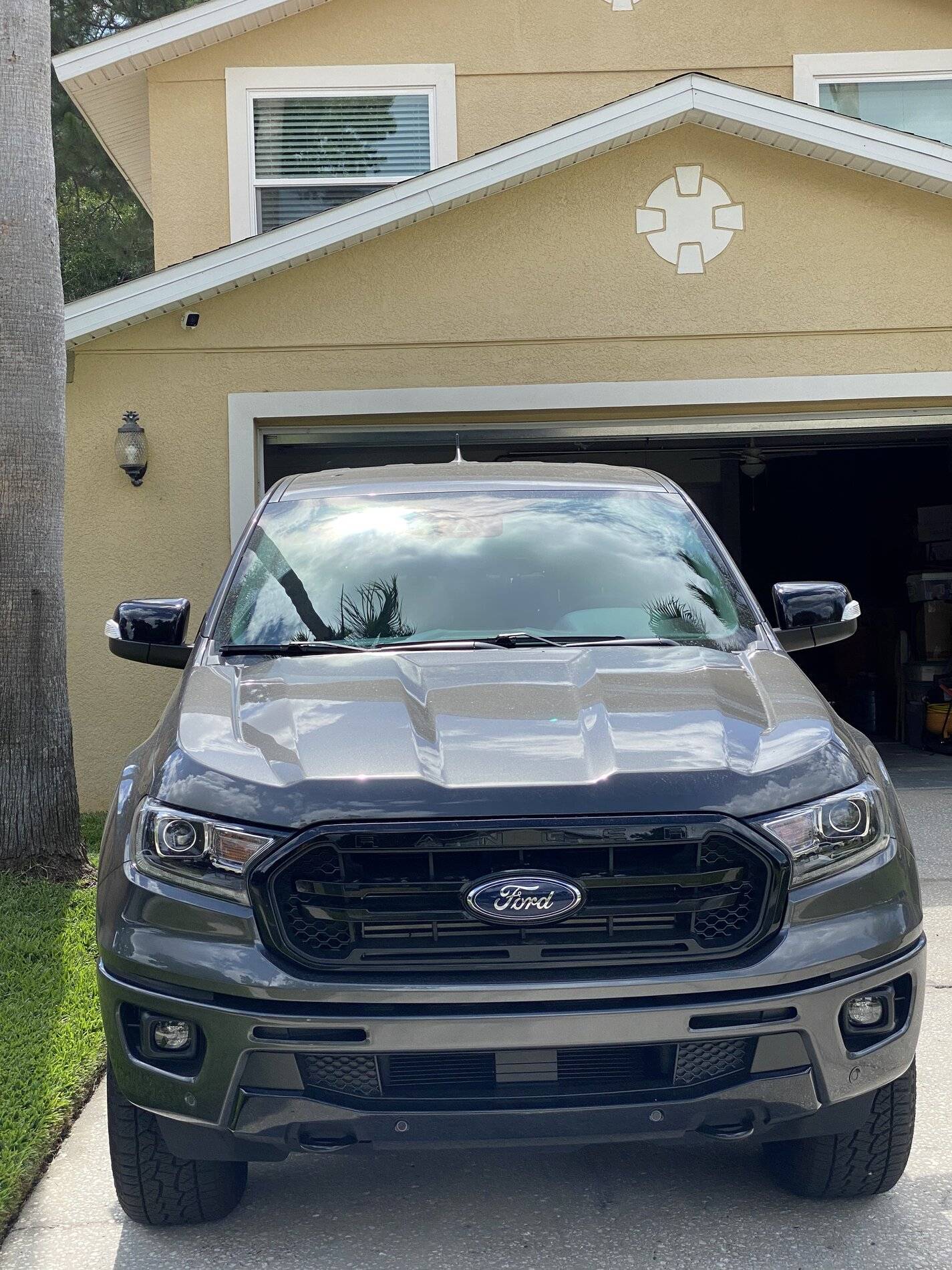

I'm in Florida and love using Air Blue 80 on my windscreen and side windows. They use in on the cockpits of airplanes. Has a "faint" blue hue but doesn't affect night vision at all and yes, helps with the heat as well.

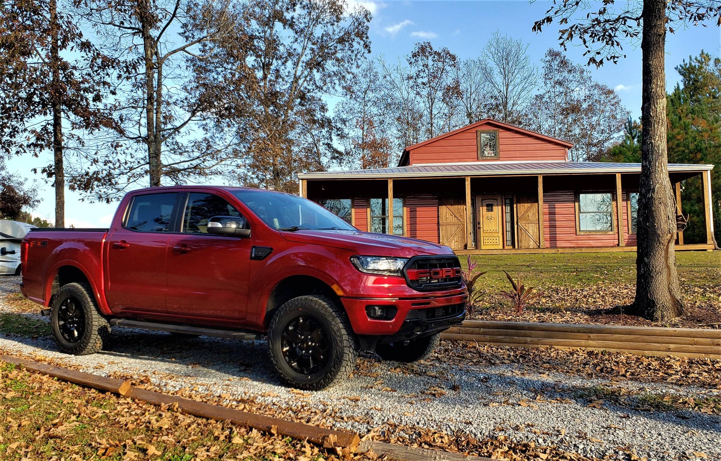

Window film/tint is made up of several polyester layers . The cheapest have a "dyed" layer to provide the color while "ceramics" or " metalized" films have the color imbedded or mixed into one of the polyester layers . Dyed films usually have a maximum warranty in the 3 year range while most ceramics/metalized have lifetime . This is for the film only and labor/installation is up to the sellers discretion . Pick a reputable shop and even the dyed films can last 10-15 years with proper care .
Tint is rated in light transmission where the higher the number the clearer the tint . 5% film only lets 5% of the visible light pass through while 90% lets all but 10% through, therefore the 5% appears darker . Most all the benefits of window film are in the clear layers . A 90% film will keep out 99% of all UV light and a large percentage of Infrared , even the cheaper dyed film . Dyed films are available in the standard smoke as well as many bright colors such as red , blue , green , yellow etc . The metalized films will add a marginal amount of infrared rejection and give a slight reflective/grey appearance while the ceramic will add a little more IR and appear more grey to smoke colored .
As someone noted previously , some metalized / ceramics may add a slightly different look than the factory tint and will vary with manufacture so that could be a consideration when choosing . I'm partial to the Llumar brand as I used it for over 20 years when my shop performed 3-5 tints per day over that period .
https://llumar.com/na/en/automotive
I tinted my front doors with 35% but did not do the front windshield as the IR rejection will interfere with the sensors in my Lariat pkg .
On a side note : Pay attention to every automotive ad on TV over the past 40 years . They always show the windows tinted , even the windshield . They know it makes the vehicle look better , even though you can't order one that way :(

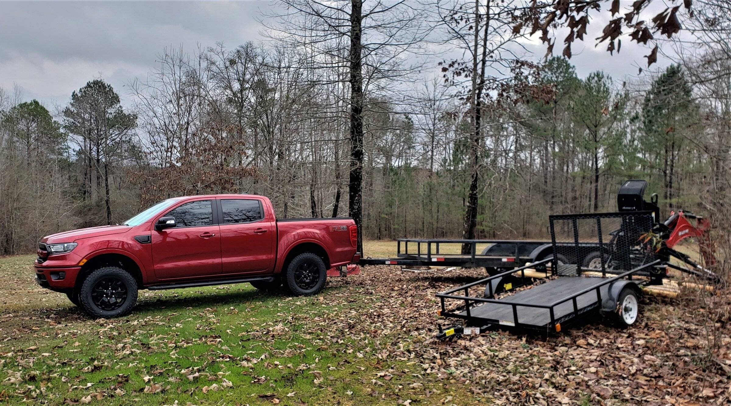

Same truck in different light .
