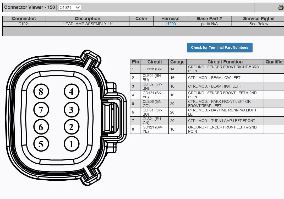

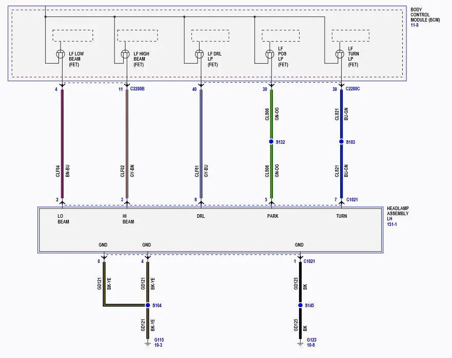

Hi BronzedAussie, do you have drawings of lights connector fo Australian Ranger? I have 2021 Wildtrak model. I'm trying to find out which pin is for DRL. Thank you kindly.
Yep, if you read my next reply to the one you quoted, you'll see I found out the only difference to the diagram given at the start of this thread for AU is to ignore the indicator pin (when you look at our lights you can see the indicator wiring doesn't go into the main headlight loom). All the other pins ring true. So you want pin 6 from that diagram.

as per the schemarit on this page, the wire from lightforce doesn't match what it show here,
pin 5 on lightforce with greenwire should be ground but the schematic says ctrl mod park front left and the red wire that should be the signal for highbeam is pin 4 and on schematic, it show ground. anyone figure it out?! or am i reading the plug schematic wrong?!

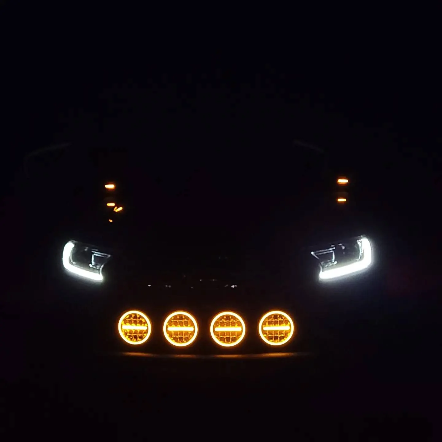

I have 4 x 7" strands siberia night ranger and 2 x strands Qube work light with amber and white drl in it. I want to have the drl from the truck to trigger the white drl in my lights
ill also add a switchback module to switch from white to amber. currently the amber is hooked up to my auxbeam switch panel.
everything that light up yellow in the pic will also be white as soon as the weather warms up a bit!

Being that I cannot see the exact pinout for the harness, I do not know exactly what wires the Tap-Off is actually from.
But all US RANGERS have the same wire harness (TO THE HEADLIGHT)
Where the differences are at is (INSIDE THE HEADLIGHT ASSEMBLY)
The (BCM) internal control circuits move power and ground around to the correct pins on the connector. (Halo vs LED)
Noted Differences:
Headlight Grd OUTPUT pin from headlight assembly
Halo's = Pin 8 - Low & High Beam Ground
LED's = Pin 4 = Low & High Beam Ground
Note: They are spliced together and go to the same ground point.
DRL Supply:
LED - Supply Power is Pin 6 and Ground is Pin 4
LED (DRL's) manuals call for a specific power check between Pin 6 and Pin 4 (if inop)
The manuals are vague for Halo's and DRL, but I believe as for a Pinpoint test of DRL in a Halo system, only have you check the Low Beam Circuit and is the DRL enabled or disabled in the IPC.
But I believe that (DRL's & Halos) this is how it is powered.
(A test of the DRL circuit with a meter is needed to confirm)
If pin 6 is not powered at all on a Halo circuit, then the internal circuitry of the BCM is only Appling 50% power to the Low Beams on Pin 2.
Halo's - Pin 6 and Pin 2 are supplied power and Pin 8 is the ground.
So, this split power feed would show as 50% power on the Low Beam circuit.
If I am correct
If not and the power is only on pin 2, then the BCM is cutting the power voltage input on pin 2
This is the reason for LED swaps from Halo's - Issues
EDIT:
To finish out the wiring pinout (To include Parking/Turn)
Halo's
Pin 7 Power Turn Signal
Pin 1 - Ground
Pin 5 - Power Parking Lights
Pin 1 - Ground
LED's:
Pin 5 - Parking Light Power (LED Strip) In DIM
Pin 4 - Ground - Parking Lights
Pin 7 -Turn Signal Power
Pin - 1 - Ground - Turn Signal
So, to summarize the added harness will plug into the US Version Rangers but you may have to adjust your wiretap off for power and it changes for Halo vs LED headlamp assemblies.
Mainly the Grounds change between the 2 assemblies.
Here is a summary from above for ease of understanding.
Halo's Pinout Below:
Turn Signal:
Pin 7 -Power Turn Signal
Pin 1 - Ground - Turn Signal
Parking Lights:
Pin 1 - Ground - Parking Lights
Headlights:
Pin 2 - Low Beam Power
Pin 3- High Beam Power
Pin 8 - Low & High Beam - Ground
DRL's:
Pin 2 - Powered @ 50% Power (Low Beam)
Pin 8 - DRL Low Beam Ground
Note: I cannot find how the circuit cuts power down to 50%, I believe is the BCM itself
but it may be applying power to Pin 6 as well, thus splitting the power supply.
The pinpoint test for the DRL and Halos just has you check the Low Beam Lighting circuit.
Power & Ground (Pins 2 and 8)
A meter test for voltage would be needed to confirm Pin 6 power (With Halos)
LED's: Pinout Below
Turn Signal:
Pin 7 - Turn Signal Power
Parking Lights:
Pin 5 - Parking Light Power (LED Strip - DIM)
Pin 4 - Parking Light Ground
Note: The LED assemblies use the same dual filament bulb in the park/turn light socket - however it is only wired for (Turn Signals) only (Internal of the headlamp assembly)
Headlights:
Pin 3 - High Beam Power
Pin 4 - Low & High Beam Ground
DRL's:
Pin 6 - DRL Power (LED STRIP) Bright
Pin 4 - DRL Power Ground
Note: The power and ground supply movements come from the BCM - Hex-Code changes done via Forscan:
This is how the BCM handles the Power and Ground, supplied pin changes when you do a Halo to LED swap.
It's easier to visualize when you know what is being shifted around when you view the above power and ground shifts between them.
