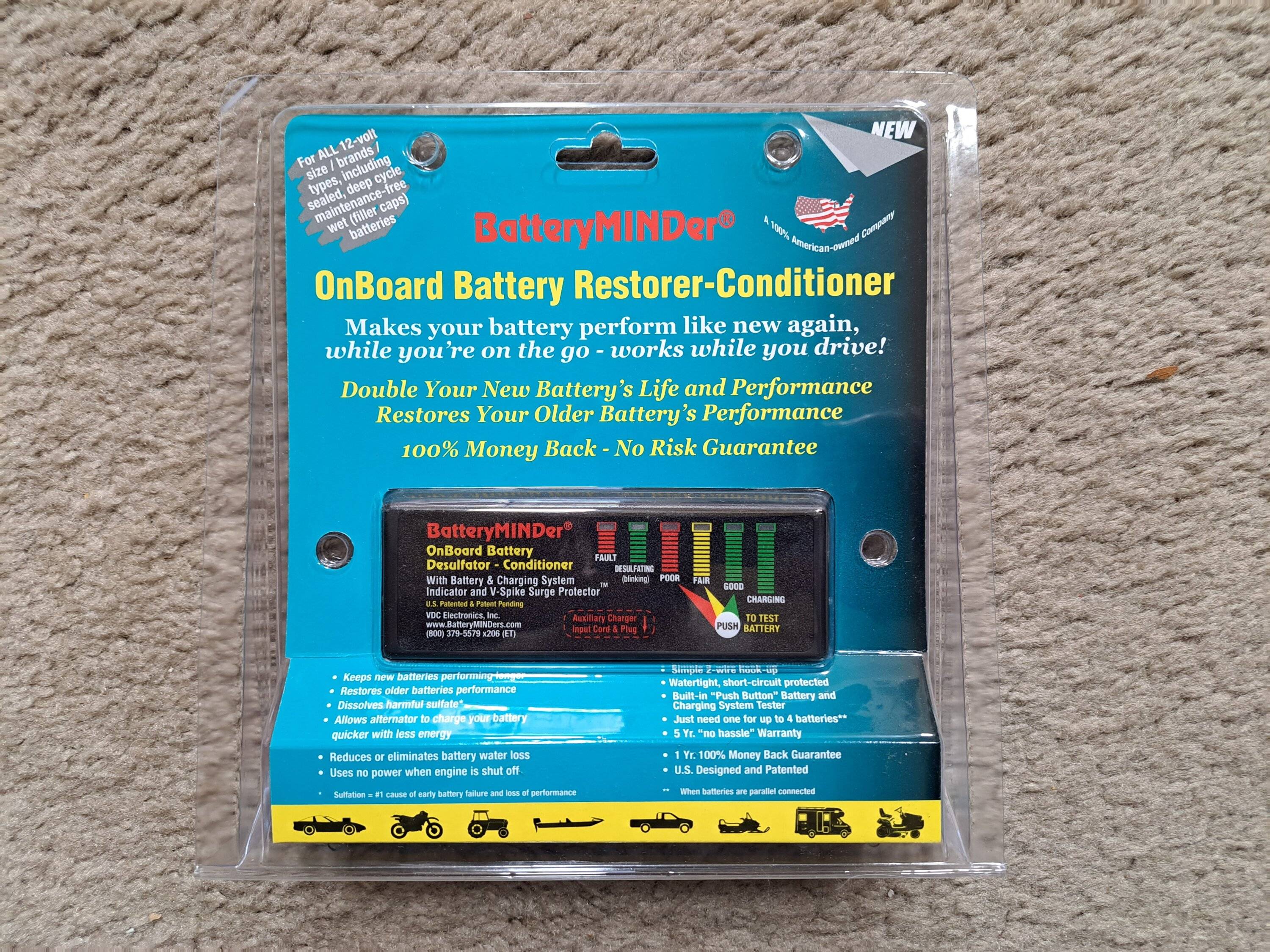

Thanks for the link...no lights? I like lights...
I'm not into bling except at Xmas , I think it has a single red led, I tucked mine under the space about the headlights in front of the battery , didn't bother to hard mount it and it's out of sight.

Why can't I find this for sale anywhere?
Sid,
Not sure about the current sale prices but at the time I got mine the best price (82.99 with shipping) was at VDC Electronics, Inc: https://www.batteryminders.com/
I usually ask about a 1st time order discount and sometimes get it, but can't remember if I got it from them or not.

buy the pulse tech - less than half that price, I think mine was $34 and yes it works.
I do not believe the pulse tech ever stops the desulfation process. This will lead to low battery voltage if your auto sits for any amount of time. The BM only desulfates when the battery is being charged. Please correct me if I am misinformed. Back when I researched this it was a true statement.
FWIW, the only two brands that I have found to work are the Pulse tech and the Batteryminder. Pulse tech works well for temporary usage, but I would not leave it attached long term to a battery that is not on a float charger.
I have gone to using the BM 1.5A-2A wall wort chargers for my long term batteries. I have several 1200 pound magnetic locks that are battery backed up. I use large 12V AGM deep discharge batteries to bridge power outages. The batteries are all at least 10 years old (probably closer to 15 yrs,) and still holding a good charge. The system is set up to run off the batteries full time, but the batteries are being constantly monitored and charged with those BM desulfating wall wart chargers. There is a small drain to run the modules that control the magnetic locks, but it is trivial to what the locks themselves draw, and they are constantly on in the locked mode. They only unlock for 30 seconds, then relock.

you are correct - PulseTech is constantly on, the instruction set cautions that it should be used for vehicles driven on a regular basis, doesn't quantify how much of a drain but states it is small and should be disconnected if vehicle is parked for an extended period. To that end I have installed an inline switch to disable it.
Battery Minder is to PulseTech what Cadillac is to a VW Beetle , the main thing is that both do work and for the money are a reasonable investment, esp when the vehicle or battery is new as it will extend the life of the battery, sometimes greatly.

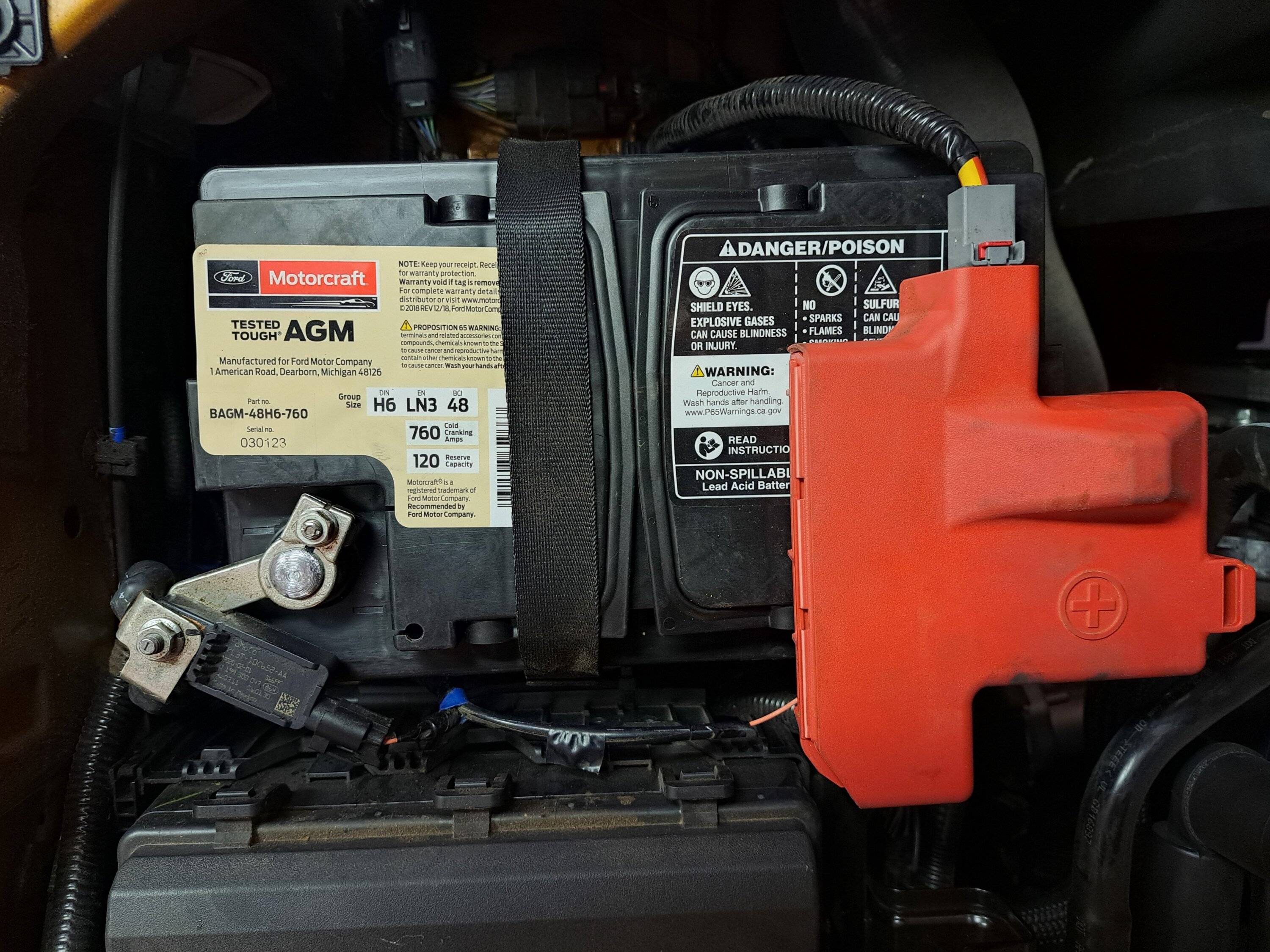

I got this message on the truck about 3 weeks ago for the 1st time (the ignition was off and the key was not in it) then started it and took a drive and this message has not appeared since. I am retired so sometimes the Ranger sets 3-5 days without being driven because I consolidate my trips to save gas and keep down the mileage as low as possible. It was very hot in our high desert area around the time I saw this message so these two conditions possibly could have resulted in the message.
I had the original battery replaced in March of this year and no issues so far with it. Hoping that it is not faulty this soon and caused the message for that reason.
Also, I have a new BatteryMINDer and this thread is a ReMINDer that I need to install it soon which should indicate the actual condition of my battery.

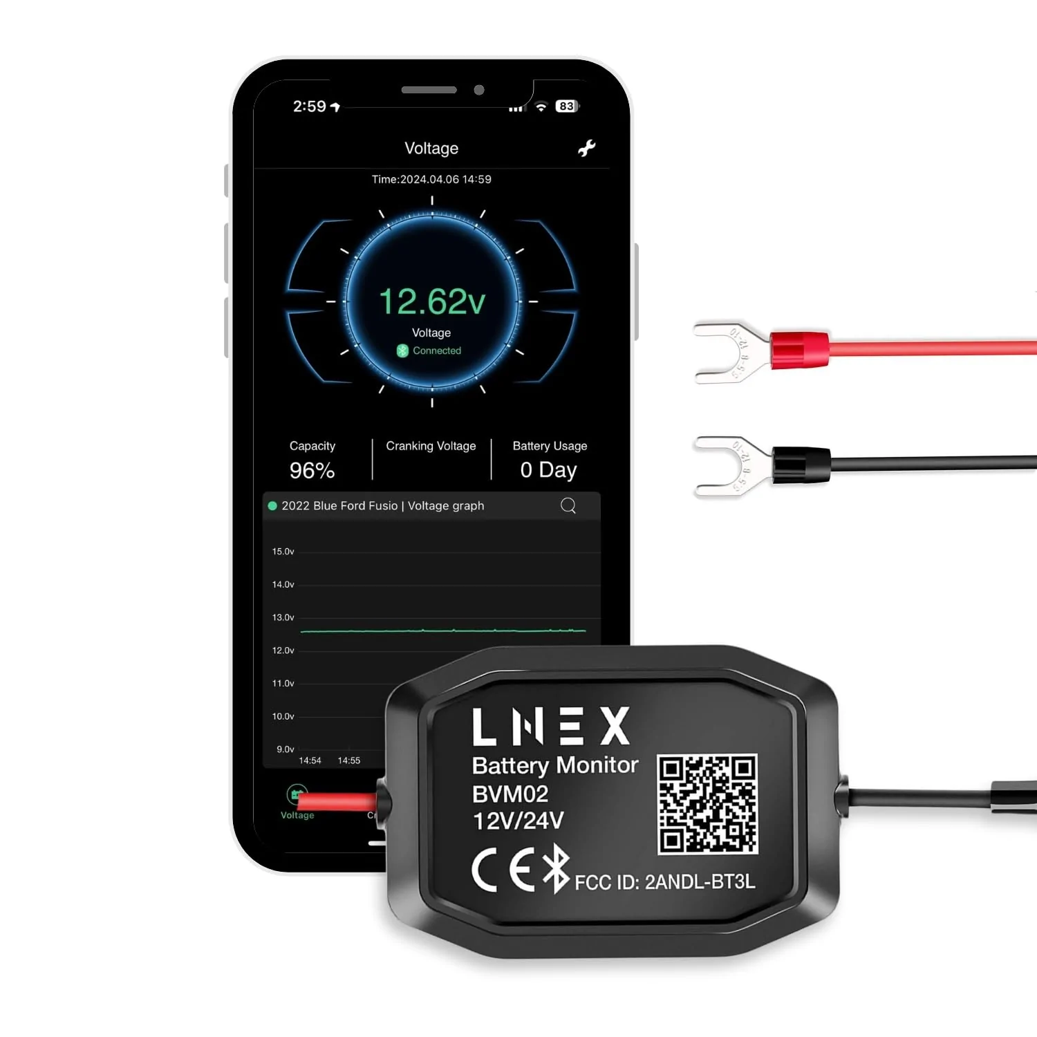

I have this installed underhood and plugged in at night...monitoring is through WeeFee App to iPhone...'
