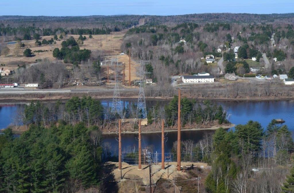

A new power transmission line is being run down the road from me. The power poles are being lifted with helicopter in sections. The factory finish is rust. When I asked about the rust, they said it was done that way intentionally and will last considerably longer than any other applied coating. Apparently it has become a thing.....
