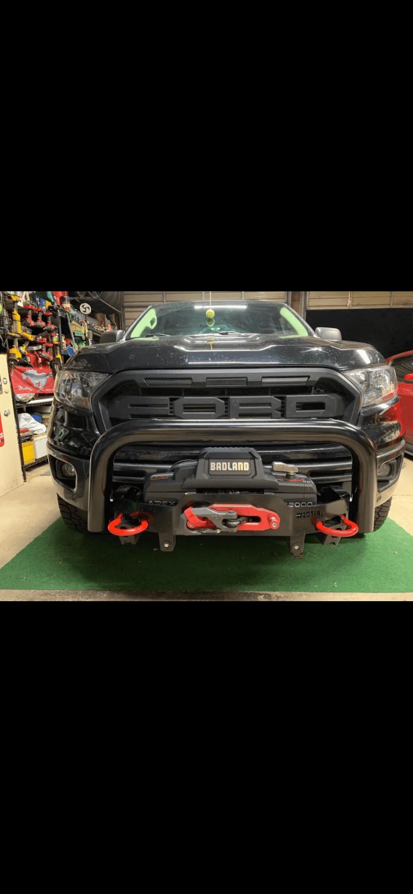

I went with an exposed winch and so far zero issues. The Westin mount is extremely stout & so long as you keep it clean should last a long time.
I have the same one. mines seen some abuse lol. but works great.

Or a mount that is exterior like the Westin @Dynawide has that can be covered up and has easier access for maintenance and cleaning.
