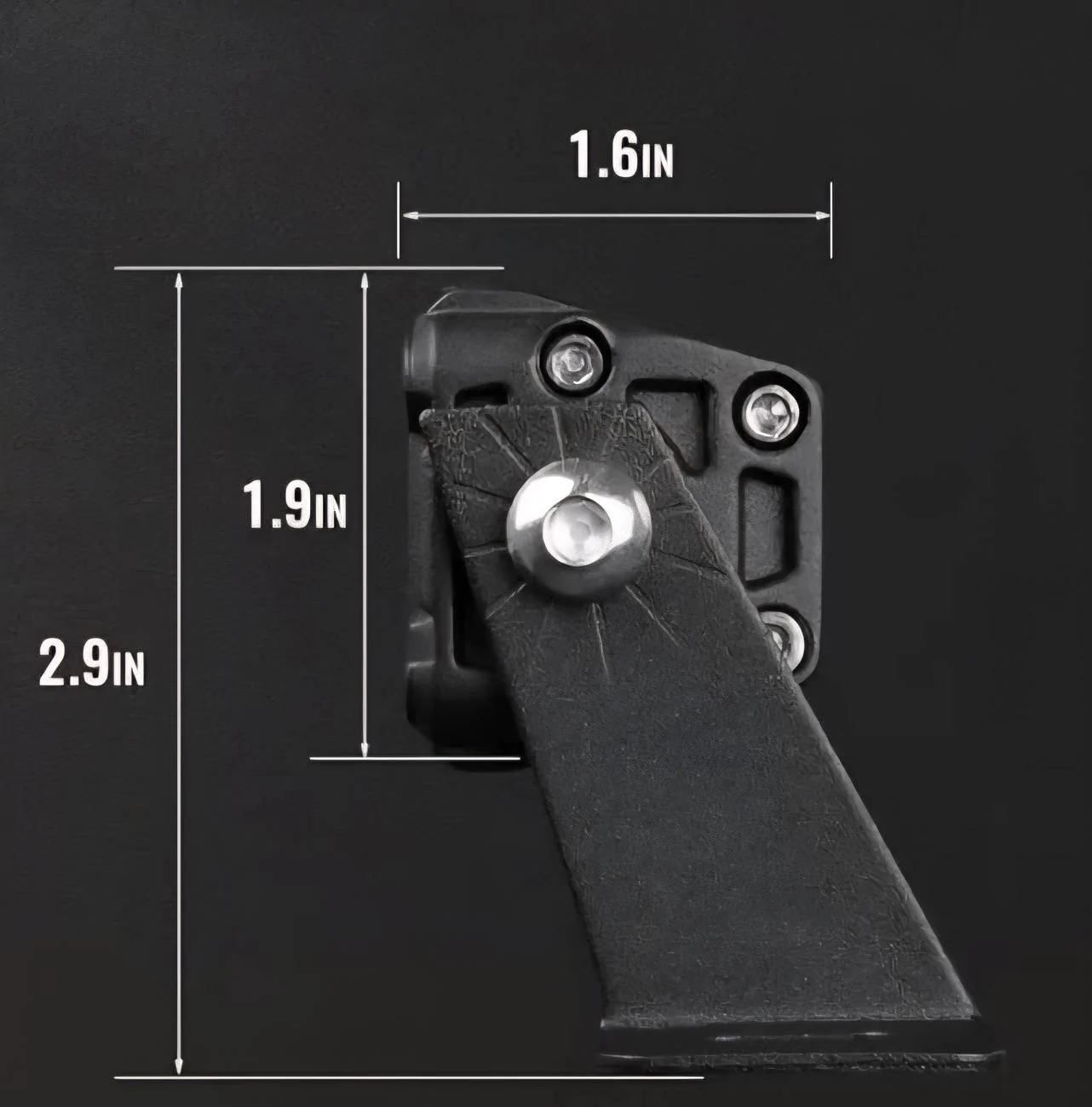

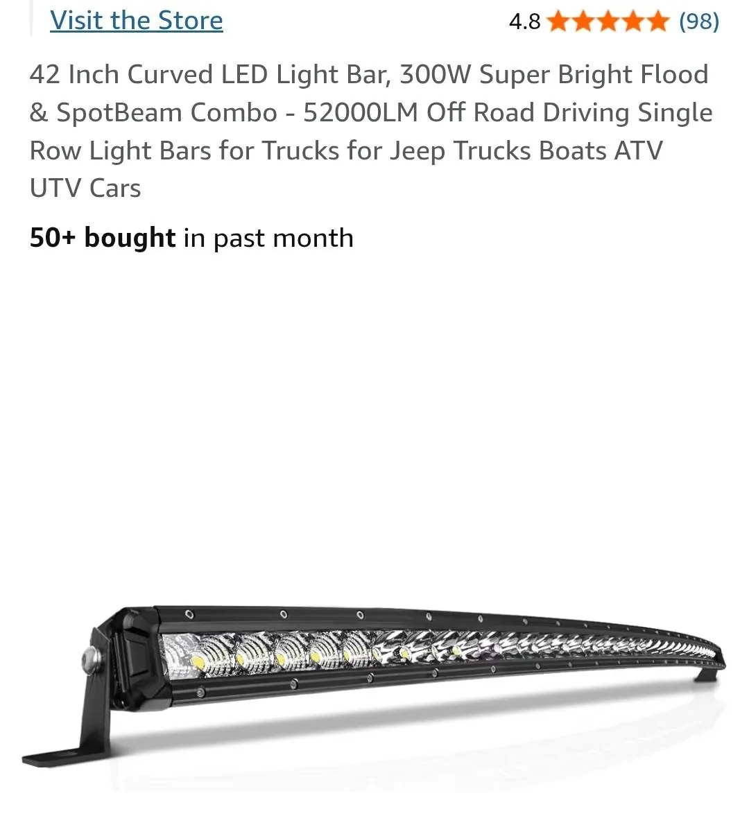

The 150 pound magnets didn't feel strong enough. They came with rubber covers that killed their strength. I used a thin sheet of ClingWrap to cover the magnet and it was a lot stronger,,, until I added the weight of the light. Then it was a "no go". Not strong enough.
Now,,, I've got a better looking, curved bar coming that weights ½ as much... Paired with magnets that are twice as strong.

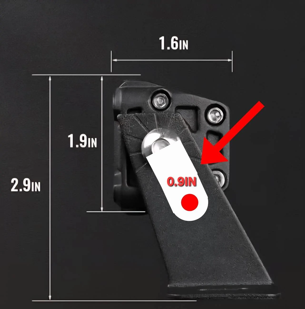

And,,, the new bar will sit @ 3" high when mounted on my roof. I plan on cutting up the mounting brackets a little. I'm going to make the mounting hole into a vertical slot so I can adjust the bar as low as possible.
The heavier bars that I'm returning would have sat 6" high.

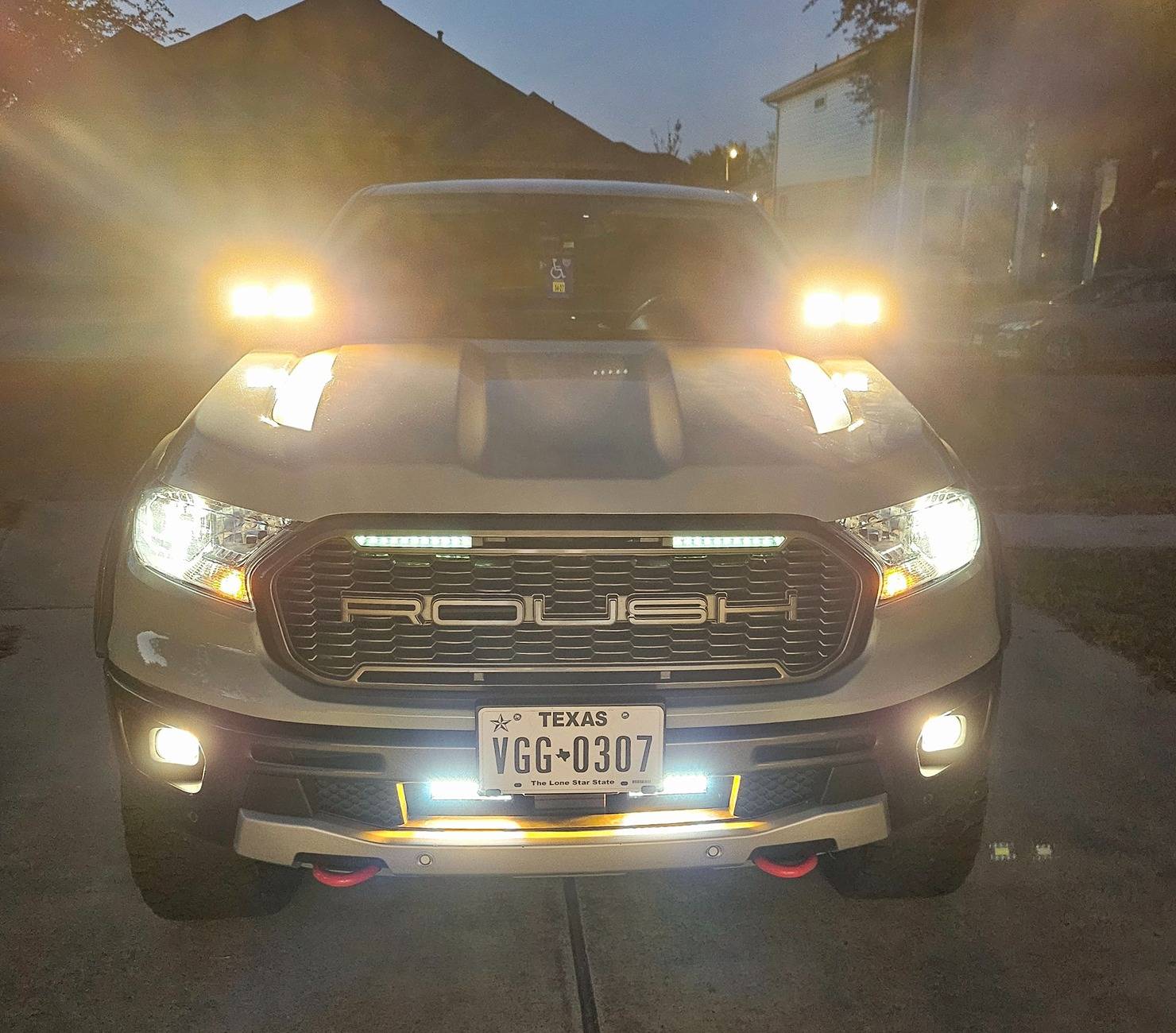

I just noticed you don’t have your fog lights or headlights/high beams on in the pics… ??.. you will have no trouble seeing at night that’s for sure.

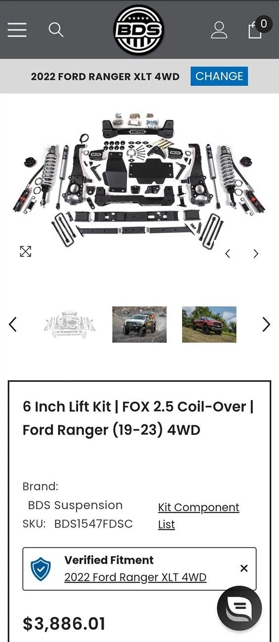

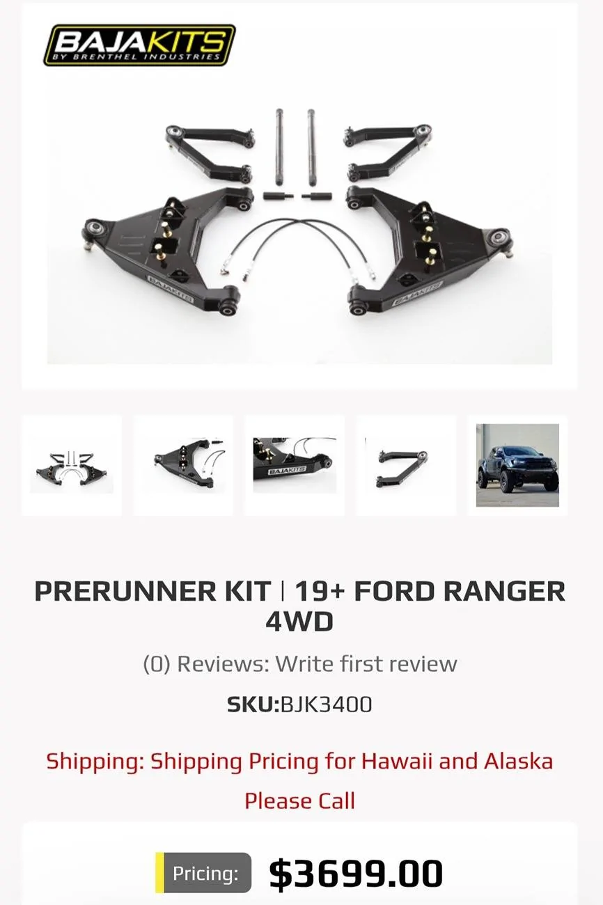

There's a huge section of real-estate at the off road park I go to that's all washed out sand swells (about 1 foot deep) that I carved out a wicked 0.75 mile course. You can lock the rear axel, turn off all traction and stability controls, dial the throttle signal controller to "race mode", keep it in 2wd and just shred these sandy bermed out corners at full throttle in 3rd gear and blast sand 100 feet. You damn near never have to lift, except in the straightaways. The suspension only allows me to go 35-40 mpg before the rear gets bouncy. That needs corrected. 300 pounds of tools pinned up against the tailgate did smooth thing out "a little". But I'm going all-in for the full overhaul (eventually). After I recover from my "Light Phase"...
Also,,, I'm gonna need these to complete the job
About $7600 in parts (with the 6" BDS)... Best guess on labor.
That's lottery ticket territory.

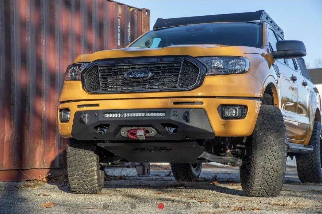

2020RangerGuy
Josh
Feb 22, 2025
136
344
Missouri
2020 Ford Ranger XLT 4x4
Manager
I'd guess 5-7 hours of labor
You want to go up, and I want to go down.
This dude in the pic I have attached has about exactly what I want, but I just can't figure out what wheels I want. I notice my truck in 4-high doesn't like to turn at sharp angles, and I wonder if it's due to the geometry being messed up?
Even stock trucks have that in 4H. Every lifted truck will do it too. A 2½" Leveling Kit won't affect handling performance or driveline function negatively. Going up from there requires drop-down brackets to maintain normal driveline geometry and factory stability controls. I'm sure common sense will kick in at some point and I'll keep things on the "lesser comcomplicated" side (and cheaper).
