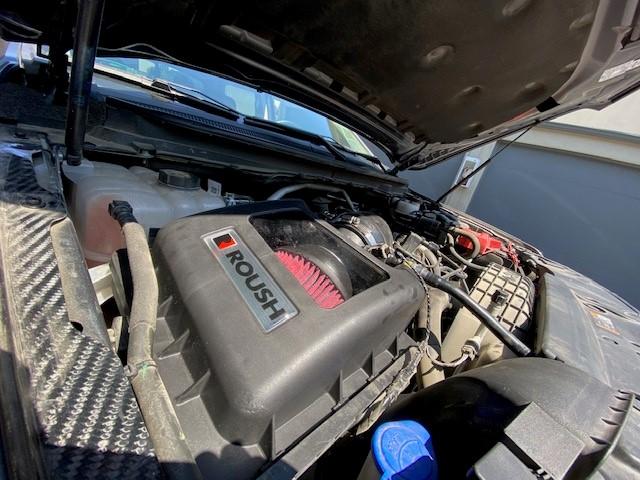

I installed the Roush CAI this weekend. Looks nice, feels nice and sounds really nice! I'm holding off on the tune aspect until both my AFE charge pipes arrive and I decide what I'm doing with exhaust.

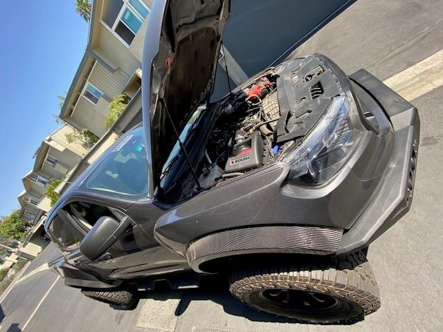

Installed the Roush Performance Pac Level 1 today. I am blown away by the package. I do have the SPD Downpipe and Axle Dump Exhaust. Together, this thing now rips. The turbo noise it loud and sounds great. Waiting on my Mountune FMIC to finish off the package. Well done Roush!
