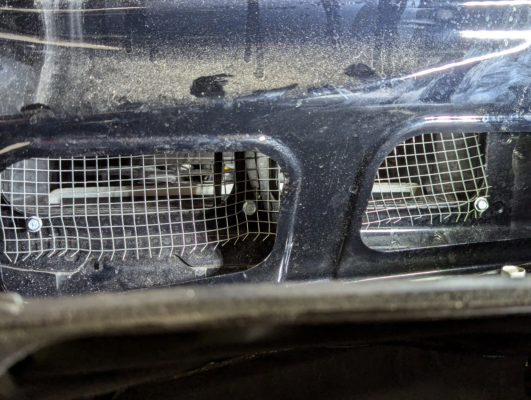

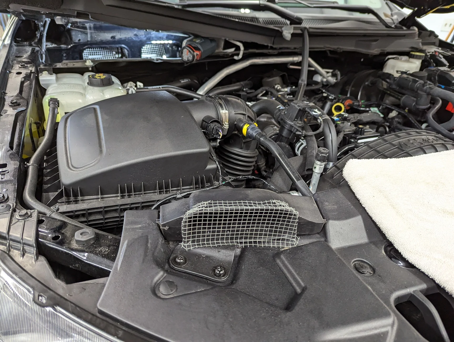

Now for the PREVENTIVE
Cover this inlet - to stop the critters from entering
This is the air feed for the (Air Inlet Door) it's under the plastic cowl below the passenger side of the windshield.
Do the same (PREVENTIVE) for the Inlet for the engine air filter housing.
I am using drywall sanding screens

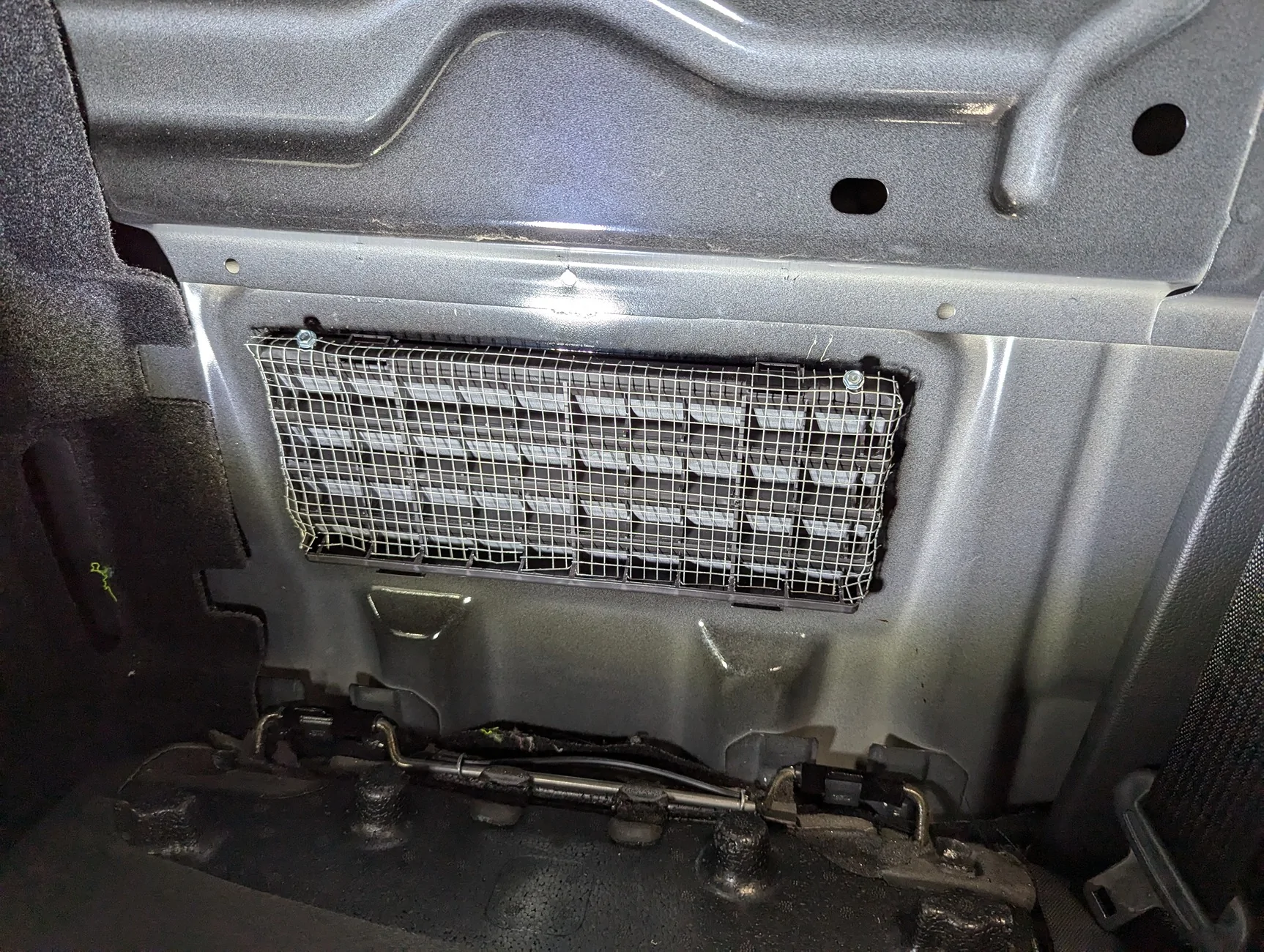

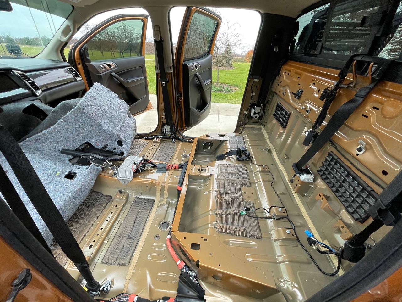

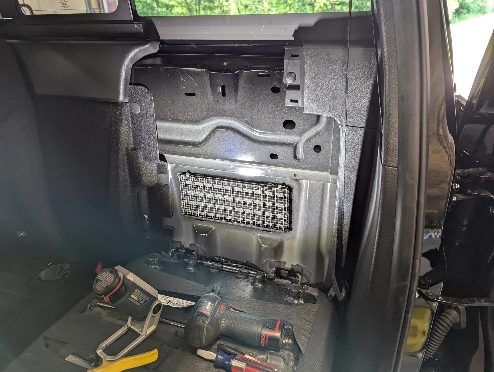

I am so glad to see this question and all the remedies.
I found a rat nest behind my rear seat. Got rid of it and thought the mice as well. Have saturated my truck with peppermint/ water mixture. Not sure if they are gone or not. But my little rescue, Cookie, sure seems like she still smells them. Since COVID I cant smell anything hardly.
But thanks to all these answers, know more about where to look and where to block off openings.
One question I have is Where are the vents behind the rear seat.??
Here is a better wide angle shot of them:
You have to pull the backrest or lower it - Depending on Trim Level and also remove the (Loadspace) Carpet & Panels to get to these from the inside - If you look into the space between the bed and the cab - This is the area where these vents (exit) the cabin pressure.
Although it has not yet been proven that critters can actually enter here, as they may be traveling down the tunnel (under the carpet) after gaining entry from the (Air Inlet Door)
As you can see - there is a nice little cubby hole for them to make a living quarters under the back seat.
It's still a good idea - to cover these as well with some screen proven or not.
So far - I have only covered my (Air Inlet Door) but have recently switched employee parking to a parking garage vs remote lot - The Parking Garage has some critters (Rats) I have actually seen them scurrying across the sidewalk.
The old parking lot had a family of stray cats that the employee bus drivers were feeding, and it was surrounded by empty fields. Never saw any critters
So, it should be in my best interest to finish out my (Preventive) for this and complete the project due to the (Possibility) of them getting into the cab.
I have stepped up my - Open Hood and Inspect the Battery Blanket & Engine Cover as these will be the first signs they have found the tasty morsels the truck provides them.
So Far - They are leaving my truck alone.
