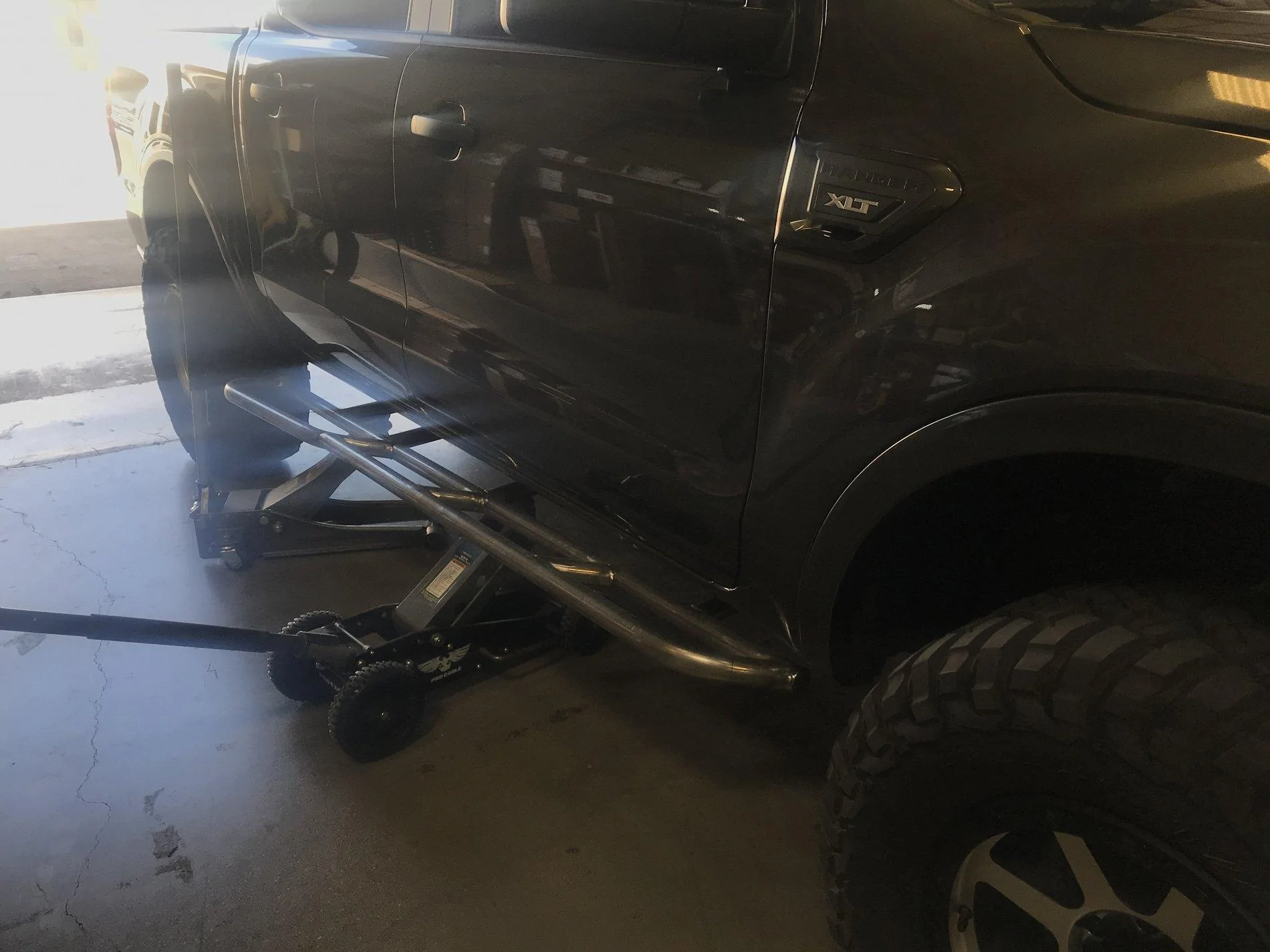

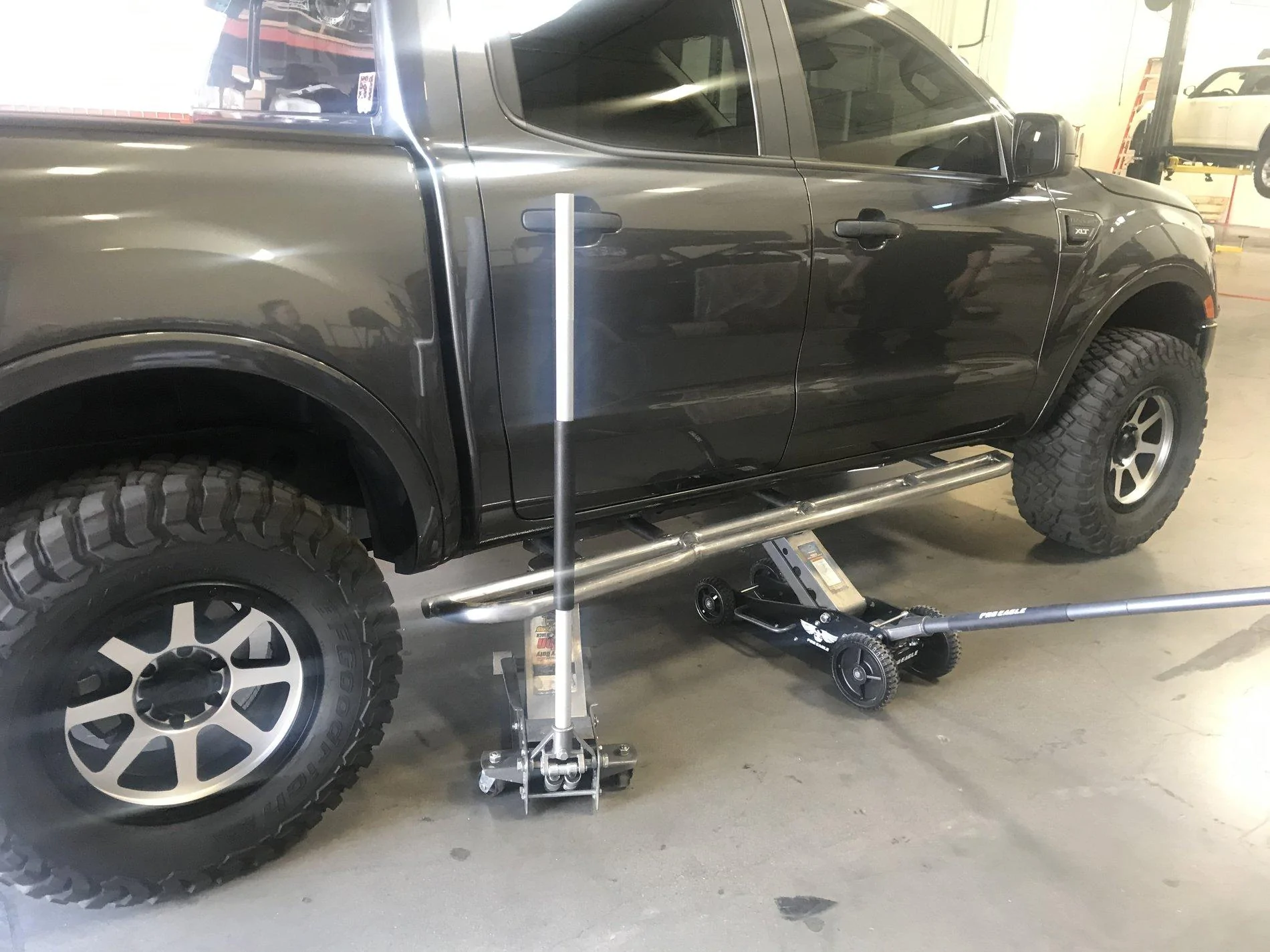

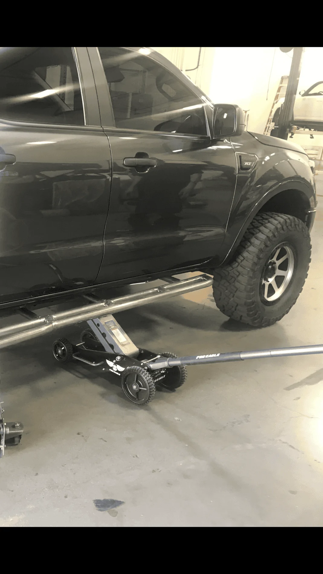

Who is ready for some rock sliders? Will Be Available second week of May. Starting at $799 Pre order yours today. First batch will be 10 sets. email [email protected] to preorder. Call or text 702-501-3139 www.fordrangerlifts.com
Made from 1 3/4” round .120 wall thickness. Bolt to frame.

Nicely done. Are you sleaving the bolt holes in the frame or doing a backplate? Because the frame is pretty thin on these.
I didn't sleeve my sliders on my Explorer and the bolts just started pulling in the inside of the frame, and the frame is thicker on it.
Back sandwich plates.

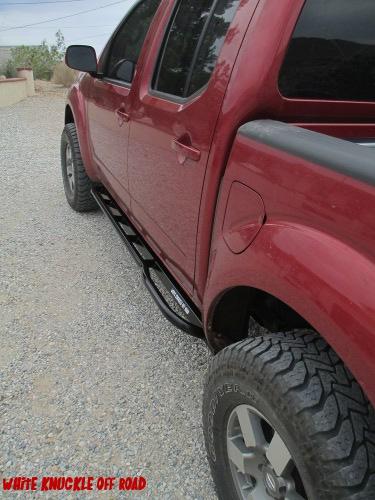

IMO these sliders need to conform better/closer to the rockers; as is, they protrude too much sideways, and WILL unnecessarily contact rocks - the chief purpose of sliders is to protect the rockers, not to go out to meet the rocks or be used as sidesteps. A shorter distance from the frame rail will also make the slider stronger and stiffer as a unit.
Bend them up and in, as below:
My pics were mock up only and not final assembled. But yes I agree to a tight fitting slider.
