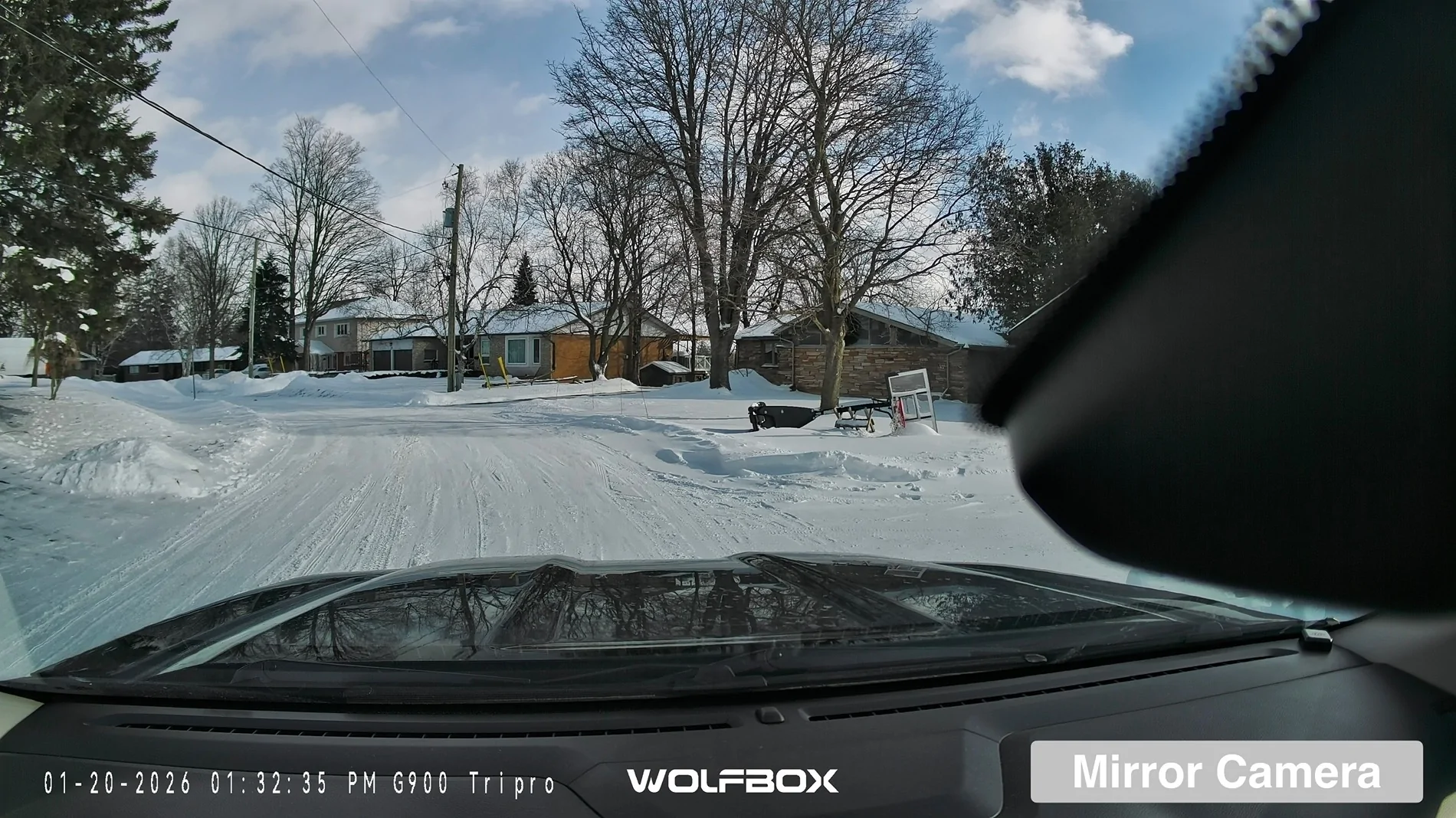

Some folks have commented on how the mirror dashcam view is partly blocked by the Ranger's pre-collision system cover on the right hand side of the screen. That's really a Ranger issue more than a product design issue. It doesn't seem to block much that you might want to use forensically and if folks are relying on it to see where they're going, they really should be looking out the windshield.

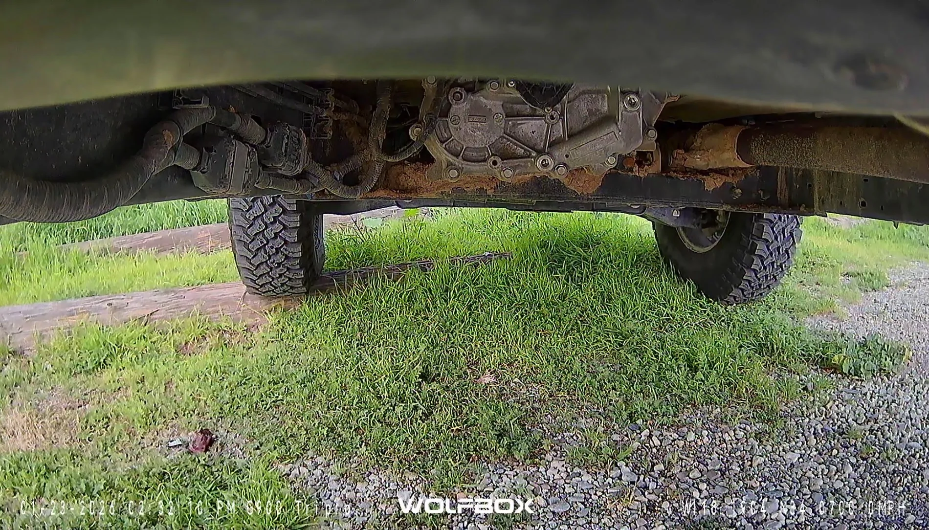

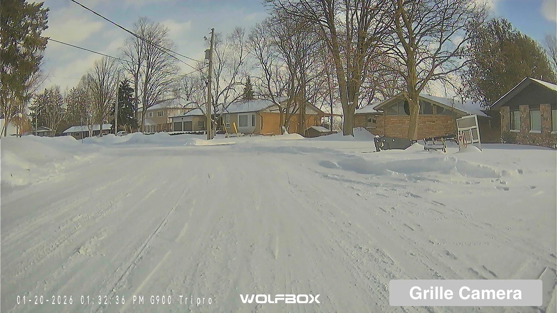

I don't use my front camera for off-road purposes but the video from that angle has a great perspective. Mine is mounted in the grille, above the bumper - perfect for my instance. It can be helpful when parking, especially when there's no pull-through. I can certainly see how others would want to use it to see just what's in front of them when crawling through rocks or climbing a steep incline.

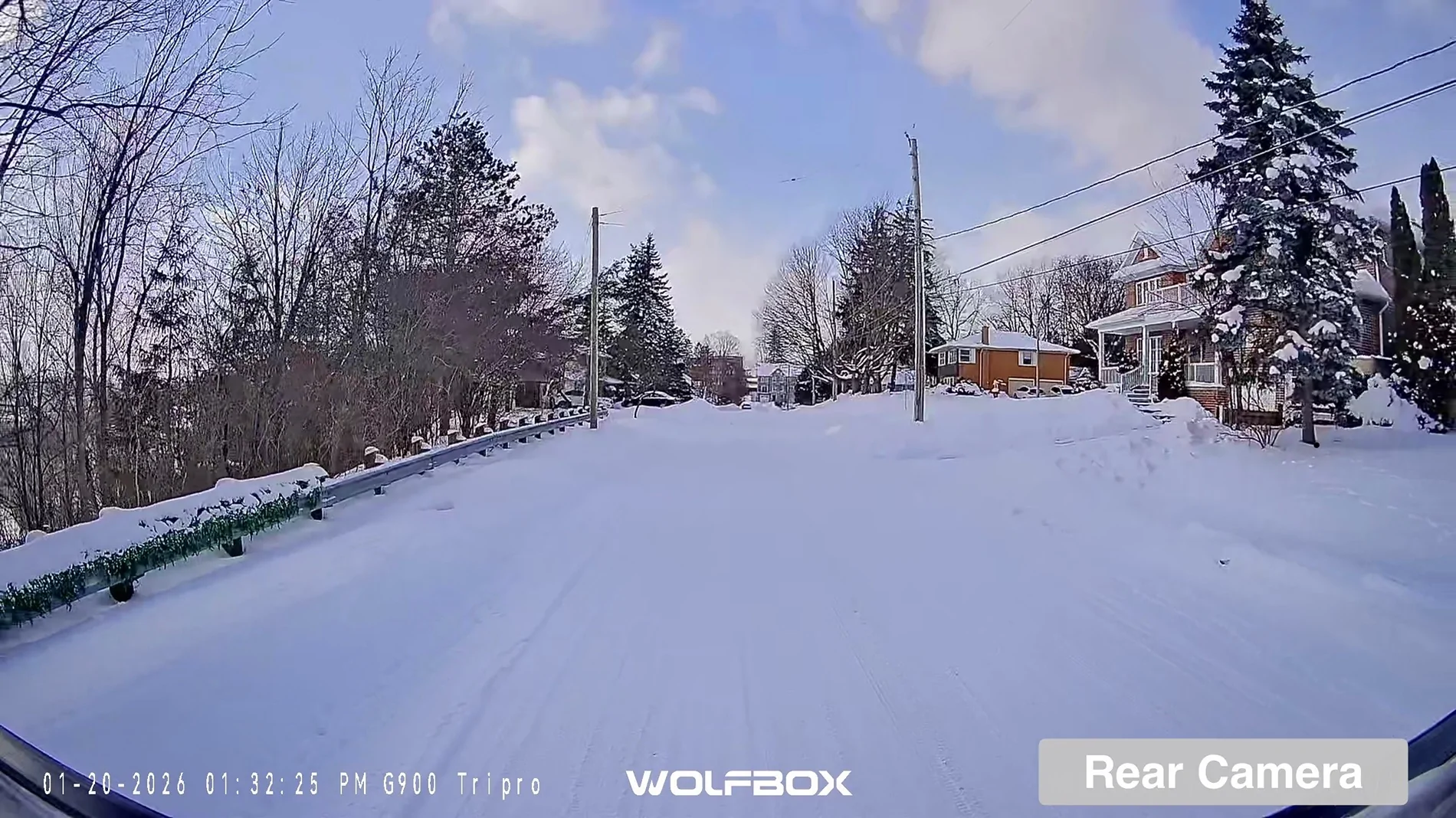

The Three Camera Views
Video Examples
I'm looking forward to using the cameras for recording adventures but hope I never have to rely on its forensic capabilities.
