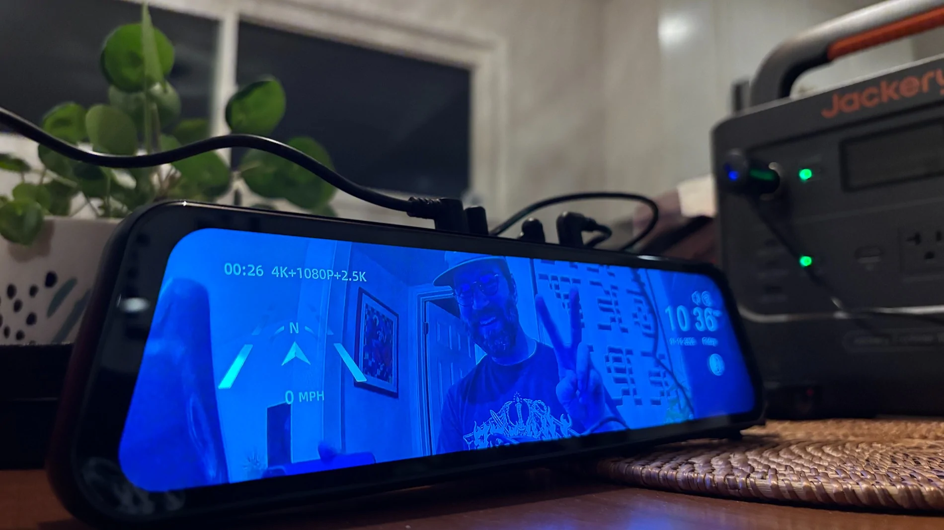

Wolfbox does a great job including everything you need, and it’s packaged really nicely. I bench-tested everything using my Jackery before running wires. Everything powered up perfectly and immediately got me excited to get it installed. I still have many camera spare mounts, cable clips and taps.
(screen is blue from protective film / white balance differences on my phone camera)

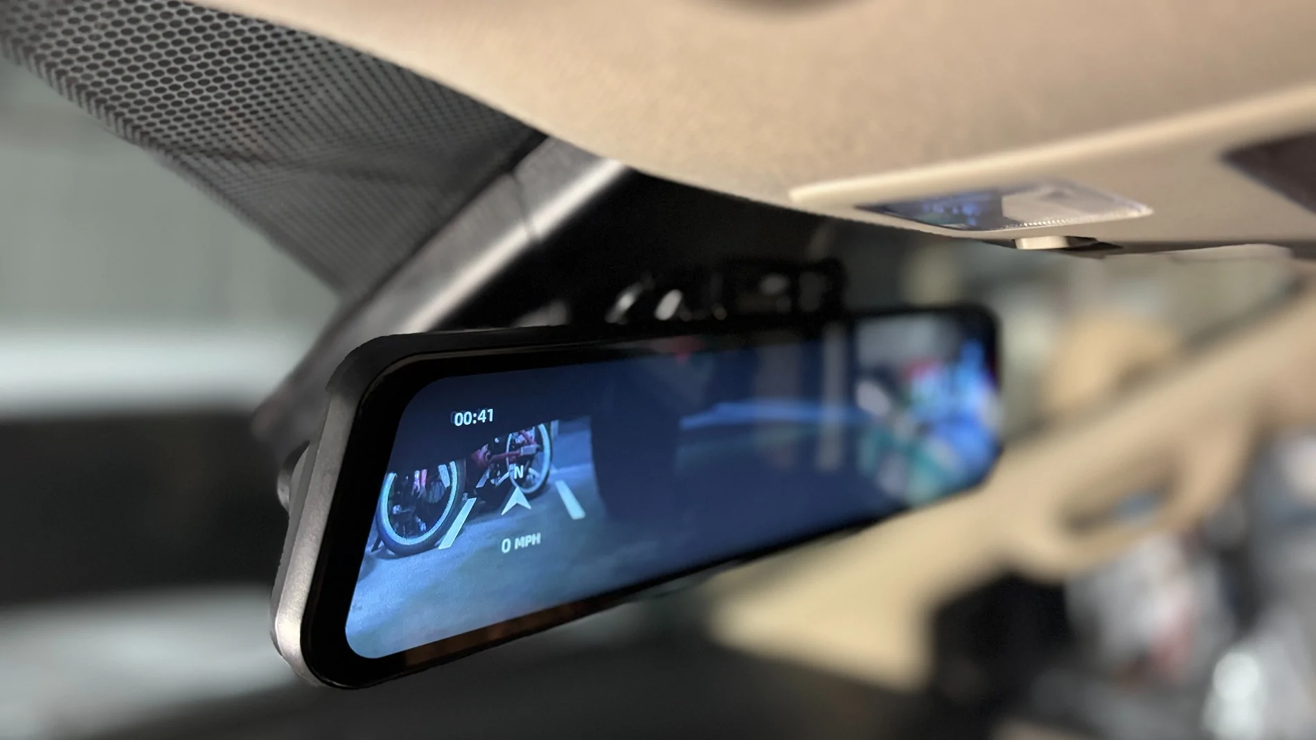

My next step was mounting the mirror and rear camera and doing a dry fit without routing cables, just to see how I liked it. It was a little messy with wires hanging out, but I’m really glad I did this first. I settled on the rear camera mounted just to the left of my rear plate so there is clearance for the tailgate to open.
I’ll be honest: for the first day or two, I kind of disliked the whole system and even questioned whether I wanted it at all. It’s a very different experience compared to an optical mirror. But what really messed with my brain was catching both the optical mirror reflection and the video feed at the same time.
Once I angled the mirror so there was no rear optical reflection, everything clicked. The viewing experience became a pleasure. It’s still different and takes some getting used to, but I really like it now.
If you prefer an optical mirror, you can simply turn the power off. The optical mirror is slightly darker than the stock mirror, but still totally usable. If you like to look at yourself a lot in the mirror or check on occupants in the backseat keep this in mind. You could run it this way and only power the screen on when you need it—for example, as a trail camera. I tried going back and forth between the two, but for my experience it works best to just use the screen full-time.

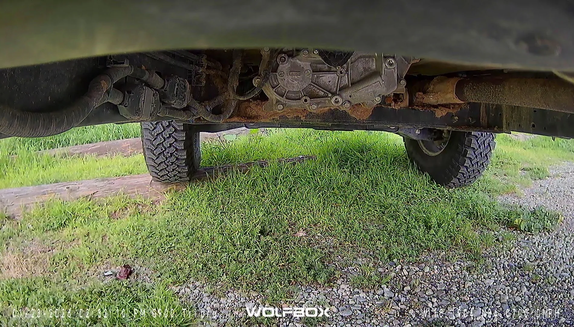

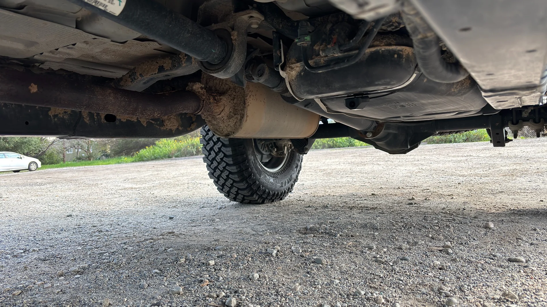

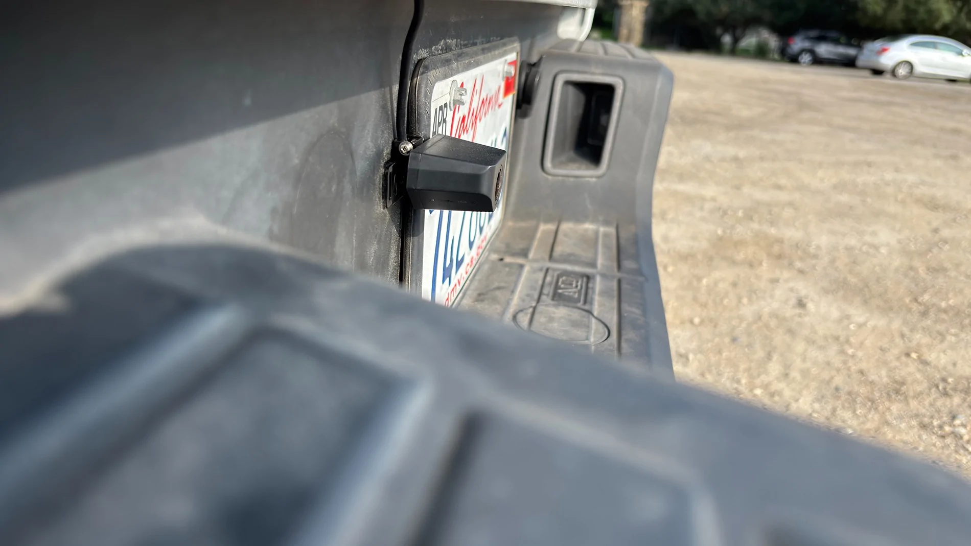

Now for the fun part—the second camera. Instead of a traditional bumper or forward-facing camera, I installed it under the truck.
I don’t find the Ranger’s hood particularly long or hard to judge, so forward visibility isn’t an issue for me. A bumper camera might be nice for parallel parking, but after living in cities most of my life, I’m comfortable without it.
I do most of my wheeling alone or just with my family, and having a camera to check wheel placement or see underneath the truck for clearance is very useful. I did this once with a GoPro and live view on my phone when I had my Sportsmobile, and it was super helpful in making sure i didn't bash a greywater, propane or extended fuel tank.
Plus… let’s be honest… the footage is going to be sick. I love making videos of our adventures, and having an always-on, interesting angle recording is a big bonus.
For mounting, I wanted something solid and simple. The gas tank strap turned out to be the ideal solution. I loosened it just enough to slip the hinged Wolfbox bracket between the tank and the strap, then snugged it back up tight. Cable routing was easy using the rear cab grommets, and it’s actually higher than the frame itself. I don’t think it’ll get hit by anything other than potentially rocks flung up by the tread.
I know it’s a bit of a risky placement, but I’ll report back on durability and once I’ve gotten it off-road a few times.
(still a lot of mud from baja underneath I need to clean :/)

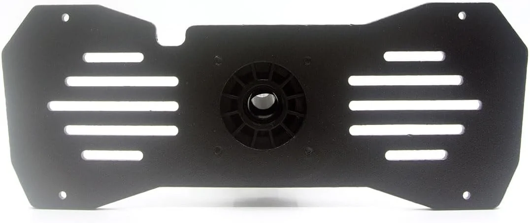

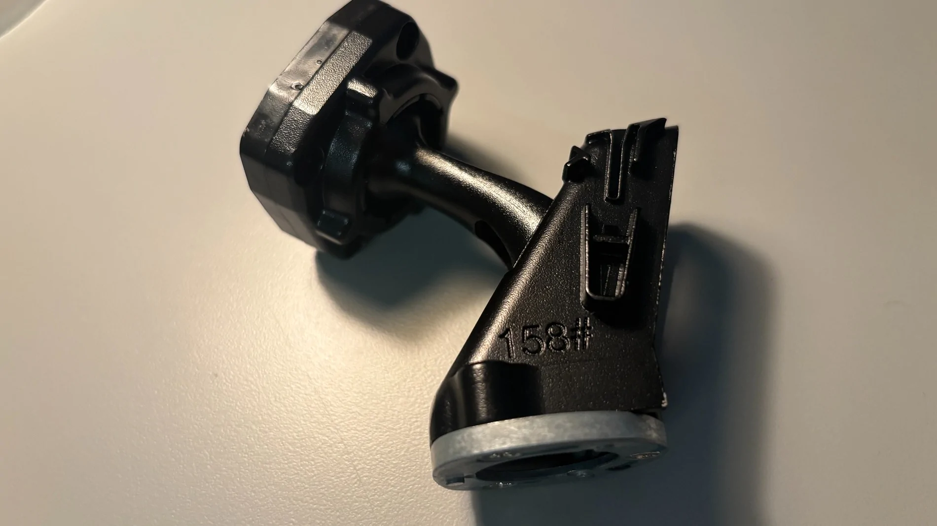

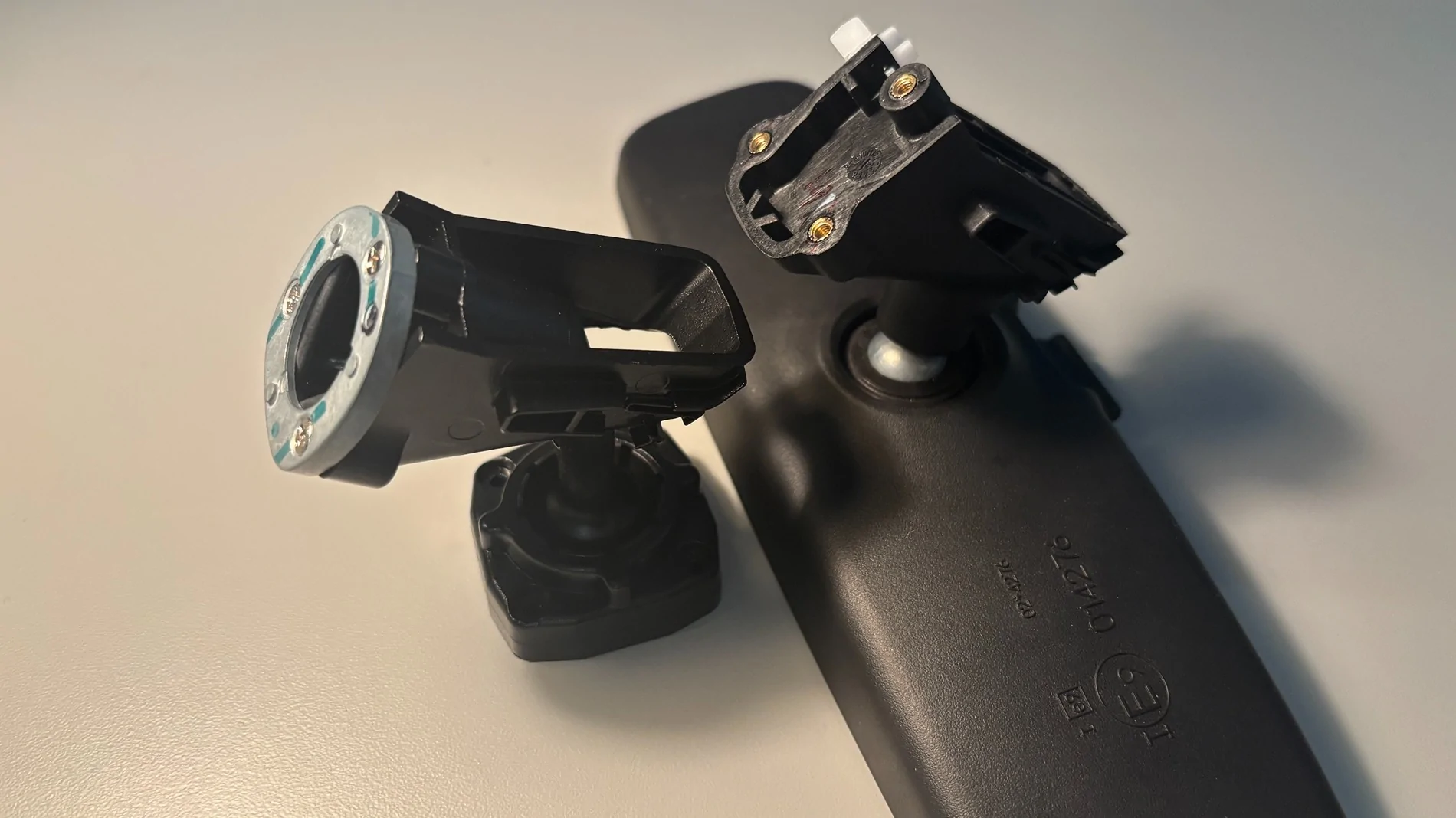

Mounting & Power

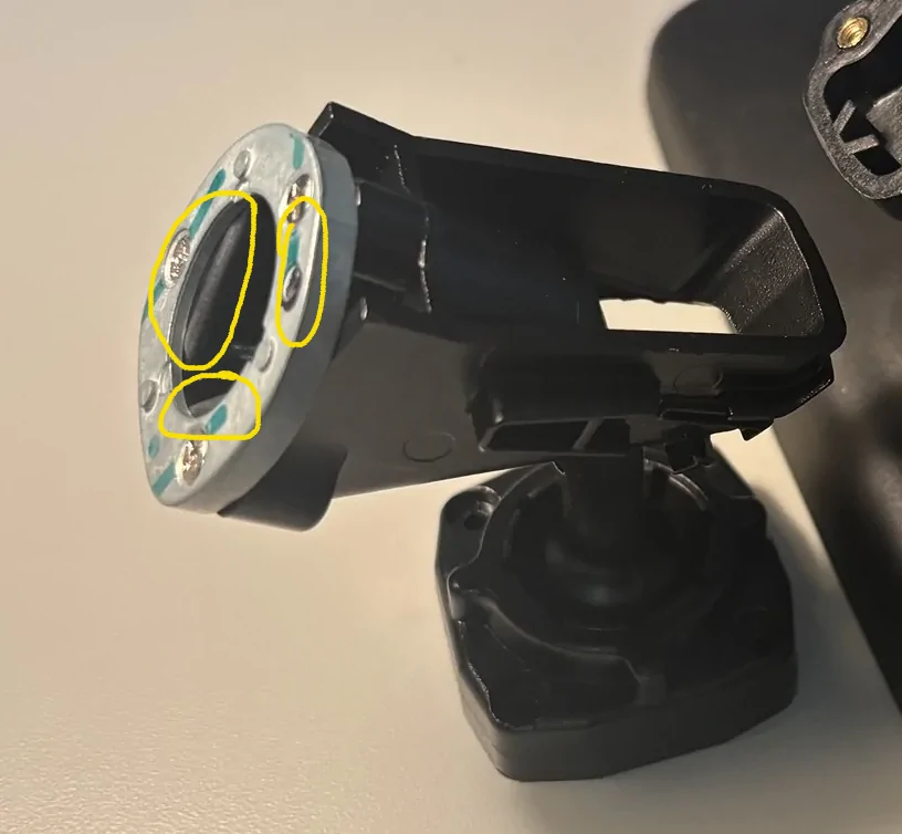

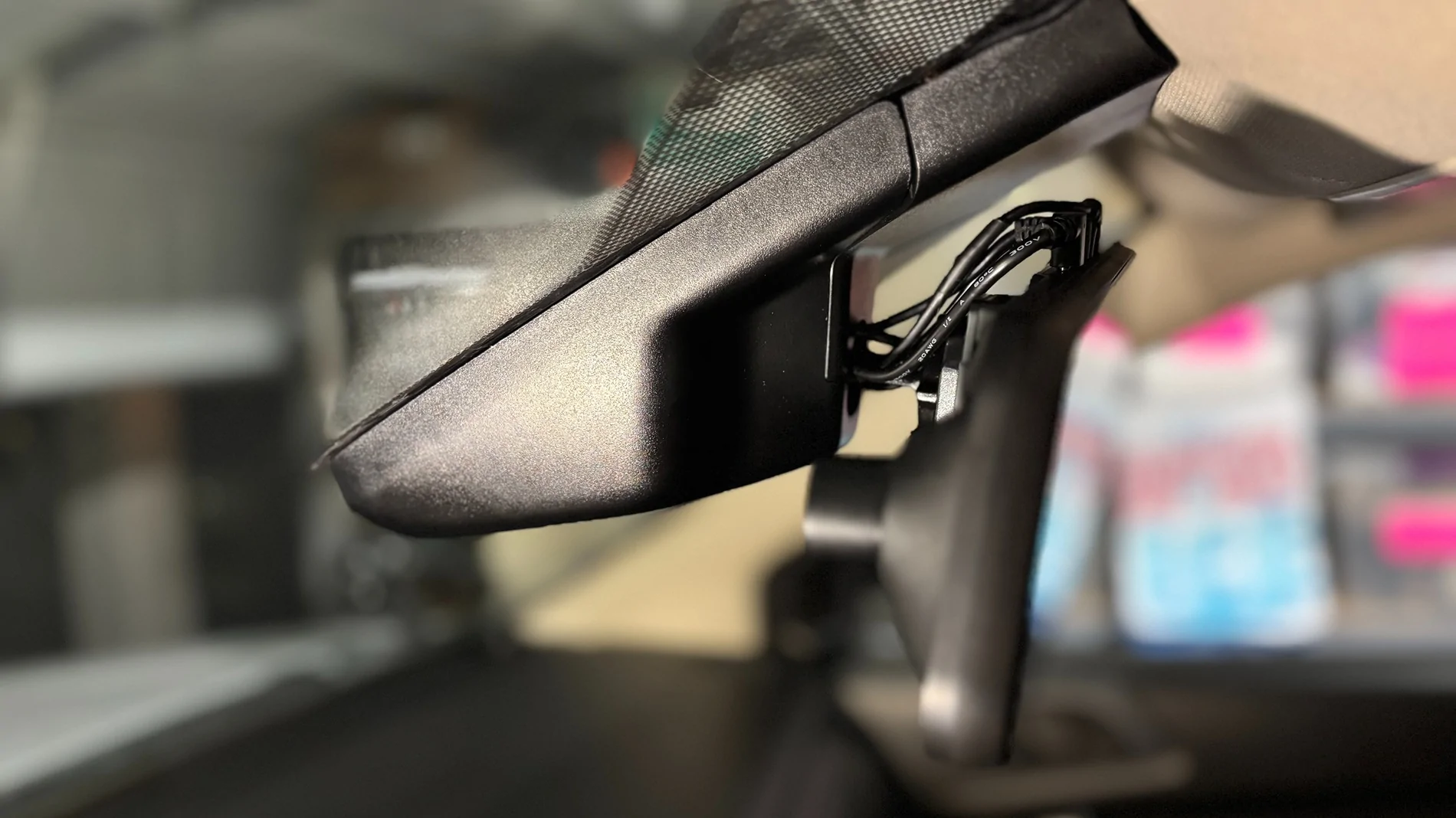

I used the Wolfbox mirror mount kit along with an adapter that was a total nightmare and I had some wobble issues until I found a different mirror stalk that worked perfectly—without having to permanently alter my stock mirror or trim. You just have to move the metal ring and tension bars over from your stock mirror to the replacement stalk. (ebay seller xrc-tech bracket #158)
I don’t have the auto-dimming mirror, so the piggyback mount would’ve been fine, but I wanted the cleanest install possible and to get the mirror as far from my face as I could. The mirror is large, but not in a bad way—any bigger and it might start to feel obstructive, but as-is it feels just right.
As for power, I ran the cigarette lighter adapter for about a month before finally installing the hardwire kit. The cig adapter honestly isn’t bad at all, and the built-in USB-C charging port is a really nice touch. That said, the hardwire kit is obviously much cleaner, and I’m glad I eventually did it. Wolfbox has some really helpfull videos they posted on the forums here. For B+ (yellow) I used fuse #26 and ACC (red) i used fuse #33 with the provided fuse taps.
