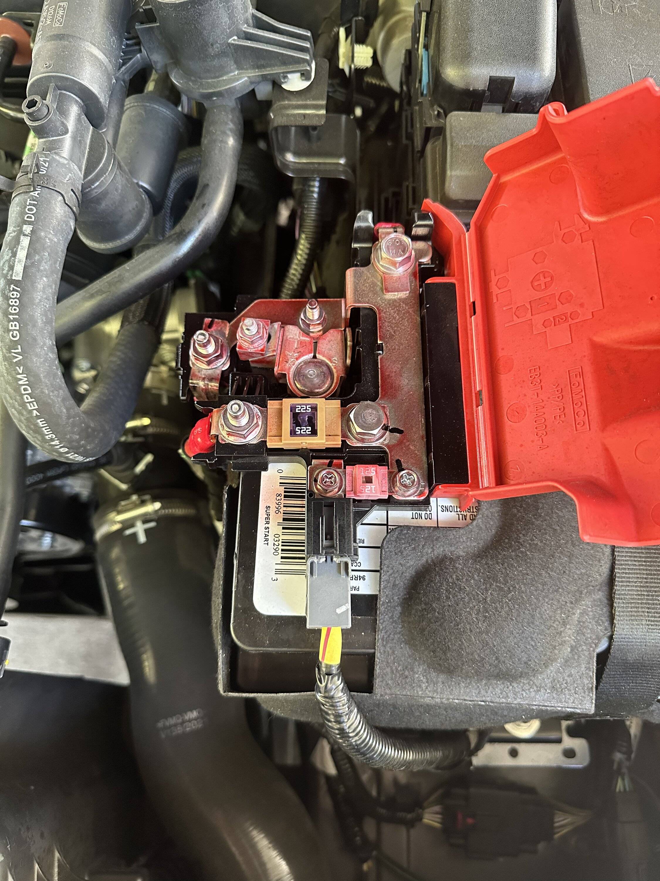

Hello everyone,
I have been searching, but cannot find the part number for the cable that connects to the pre-fuse box on the positive terminal of the battery. Does anyone know the part number or have a link to purchase?
Long story short, I was replacing my battery. I had some unwanted help from an auto store employee and he ended up breaking the red clamp that locks the connector piece of plastic in place.
As of now, it stays connected but I’m worried that it will fail with time. Photo below for reference. Thanks in advance for any help!

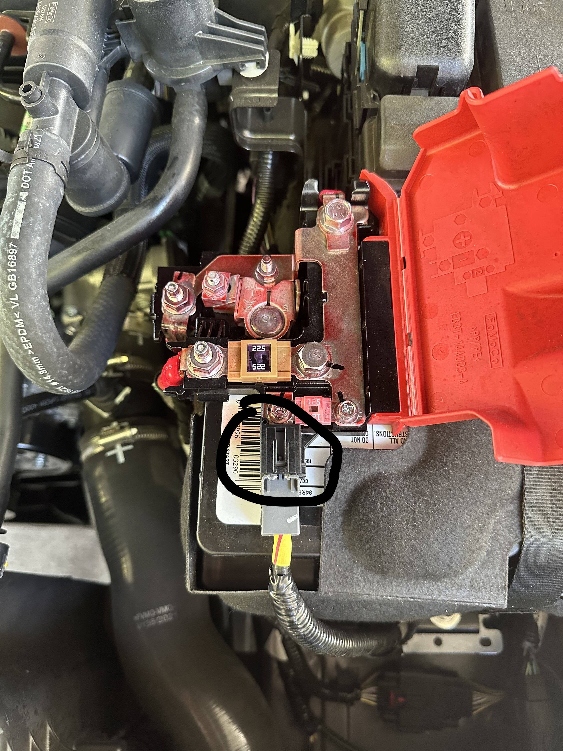

If you are talking about this (Circled) - this is for the Power Steering Control Module. Connector # 1135E
This should get you close to what you need. The Wiring Diagram is not that specific on this connector.
I'm sorry I can't be more help
I suggest asking Benny or visit a Ford Parts Counter, as they will be able to pinpoint down deeper than I can with just the Wiring Diagrams
Connector:
C1135E
Description
BATTERY MOUNTED FUSE LINK (BMFL)​
Color
Harness
14B060​
Base Part #
part# N/A​
Service Pigtail
Not Available​
Terminal Part Number
Service Part Number
Size
8L8T-14474-CAJU2Z-14474-BA
Pin
Circuit
Gauge
Circuit Function
Qualifier
1​
SBF02 (YE-RD)​
4​
FUSE - 2​
8L8T-14474-CA​
Alternate Possibility - I do not know if this has that lock pin or not, I doubt it, but here it is (#12)
Home 2020 Ford Ranger Battery GB3Z-14526-A

PART CAN BE FOUND AS REFERENCE #12 IN ILLUSTRATION
Circuit Breaker - Ford (GB3Z-14526-A)
  • MSRP:$121.64
  • Discount:$44.70 (36.7% off)
  • Sale Price:$76.94
