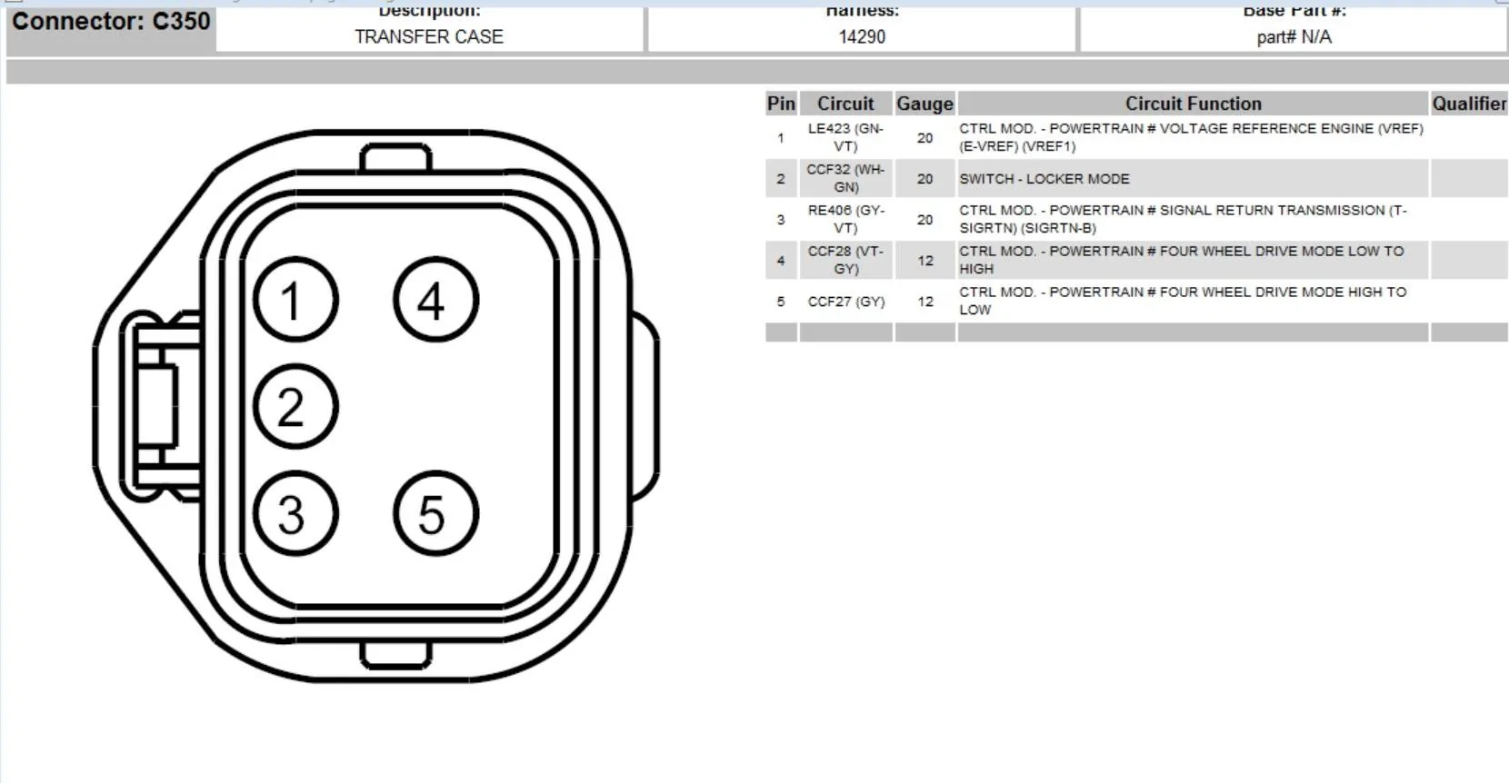

I am thinking that the wiring to the transfer case position feedback is open, or the position feedback sensor is bad. This would cause your 4 wheel drive switch lights to not function.
That would make a lot of sense considering this is the wiring harness running to that connector:

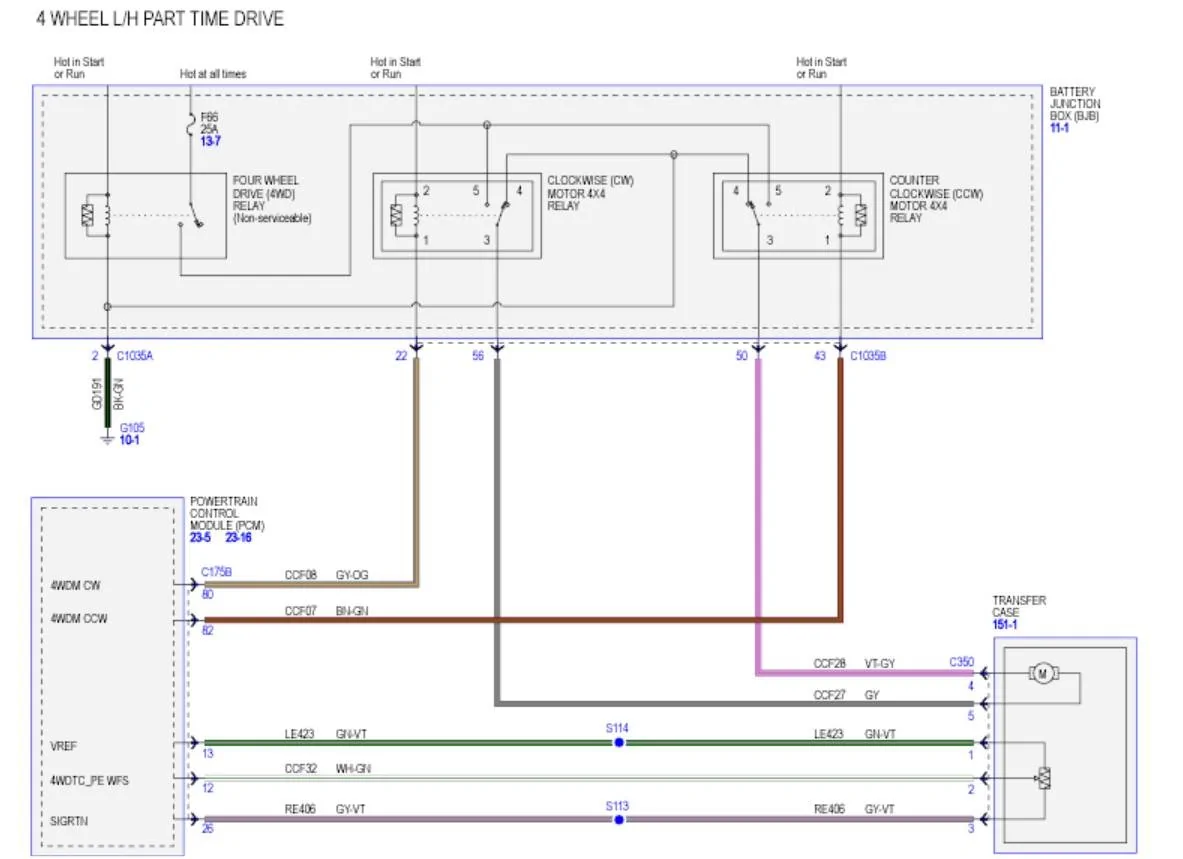

Since you do not have any switch power - Check Fuse #23 in the BJB, plus check to see if you have a working rear camera. I believe you need to look at the other side of this and that is the switch itself.
If the fuse is good and the Rear Cam is working
Plus, in the interim, have a helper cycle the switch (constantly) from 4-High to (2-High) while you shake, bend and twist the harness at the damaged spot - to see if either the switch indicator lights flicker, or it shifts out of 4-High

To wrap this post up: Dealer determined that the damaged harness had shorted against the front drive shaft, and blew the #66 fuse on the bottom of the fuse box. I checked this fuse but it did not appear blown, when I inspected the fuse when I picked the truck up it was nearly impossible to tell that it was blown.
Tips for others: The fuses on the bottom of the fuse box are difficult to access and diagnose, and it would be a good idea to swap in a good fuse to double check if it is blown or not.
Thank you everyone for your help!
