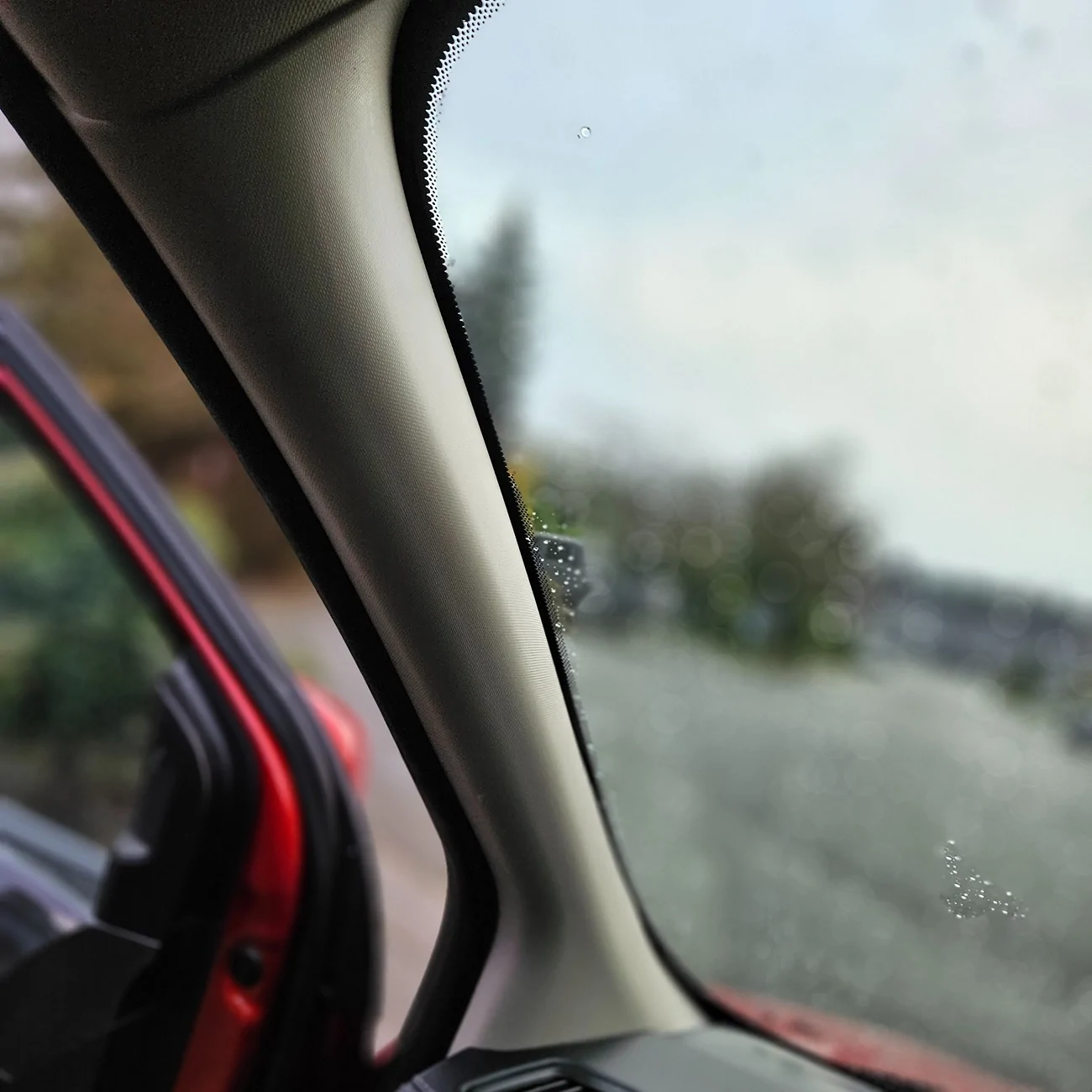

I am trying to install a Dash Cam and looking for some help on how to remove the pillar molding.
Thank you,
Terry

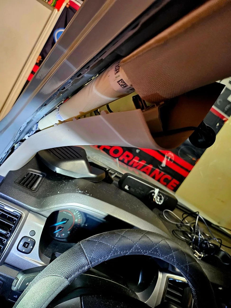

I was concerned about breaking the A-pillar trim when I removed it to hardwire my Cobra dash cam. It actually removes pretty easily. You just have to pry it a little at the top to un-pop the 1st clip. Then you can slide a finger in the top and pull it horizontally towards you. The other clips will release without much effort. To put it back,,, just line it up and press. It will snap back into place. Then just pound it a few times with the palm of you hand to make sure all the clips are secure.
* I've never taken it all the way off. I've just loosened it enough to get the wires hidden behind it.

You just pull it down. Start at the top and pull at an angle between the windshield and door. There are plastic retention clips but it does just pull out.
