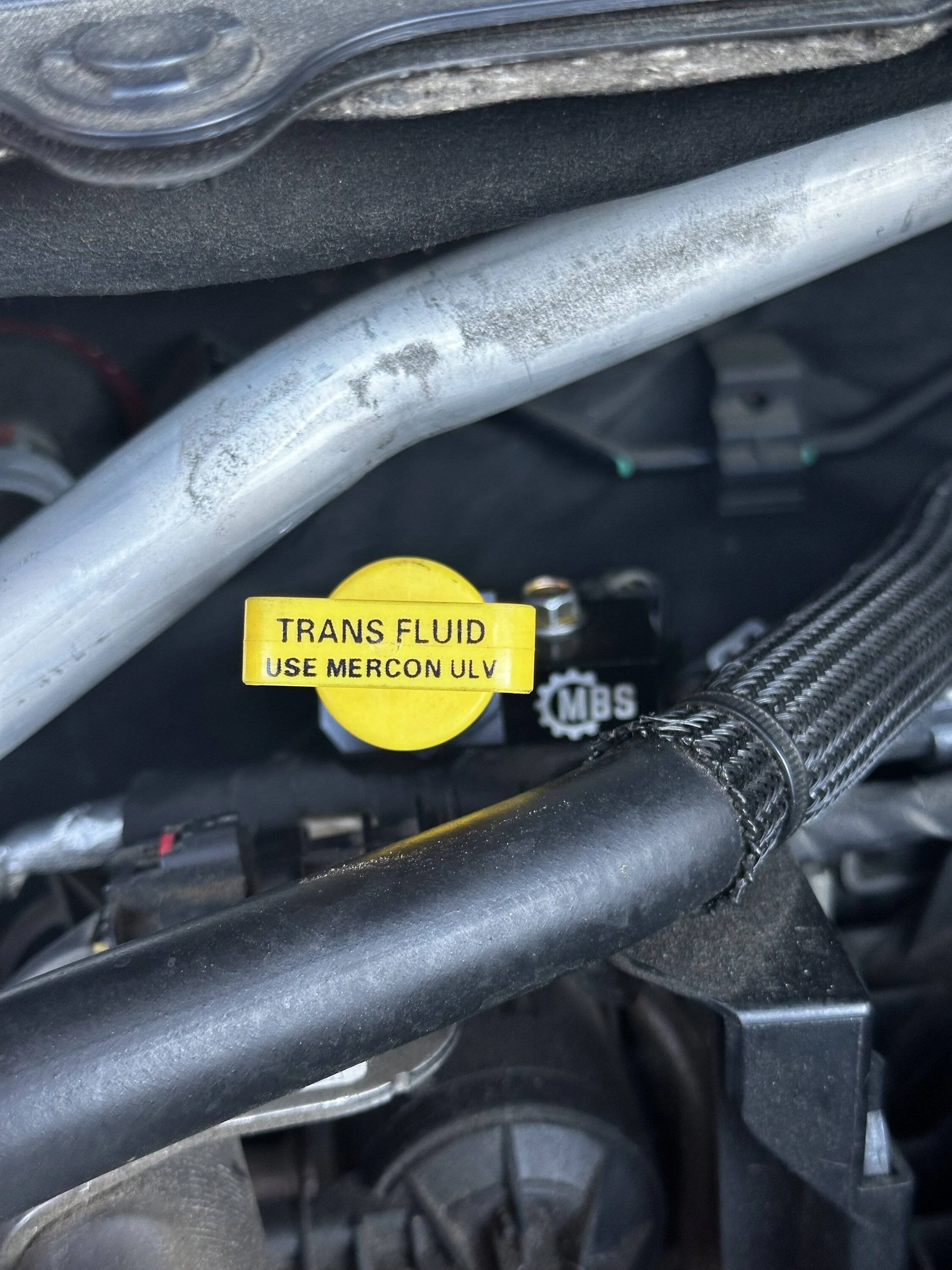

It's interesting how the looms are slightly different between the trucks, I tried to track model, year, nothing really correlated, it's some production variance at the vendor for the looms.

That's why you see in the notes, the cold check will be about 1/16" off until it warms up, I should not get so specific here, other stick builders just got a freebie data point.
Not necessarily, I suspect expansion rates differ by diameter and hose composition. And it takes a great deal of time to determine that expansion rate. Multiple testing cycles, both hot and cold, promptly removing, measuring, and installing both dipsticks during each cycle. Cold cycle easy enough... Hot cycle not so simple a task, and certainly not risk free (think burns).
Frankly, I doubt anyone will go to that level of testing... and another reason to purchase your product.

Yes, everything will expand differently, when I was measuring the expansion, I wondered how much one of those Econoline dipsticks must expand, those things are like 4.5' long.
And Yes, that was the goal, an aftermarket dipstick with factory looks, markings and function, just bolt it in.
