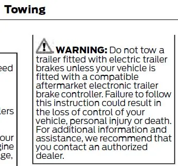

The quick start Guide warns to consult the Owner's Manual. The owner's manual outlines the need for a brake controller.
So, like so many laws on the books. It is the responsibility of the owner to read the owner's manual or at lease the quick start pamphlet which directs them to the Trailer Tow portion. To shove off responsibility onto Ford is naive. But is so systemic in this time when people cannot accept responsibility for their own actions.

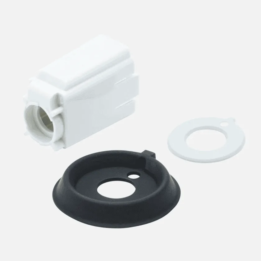

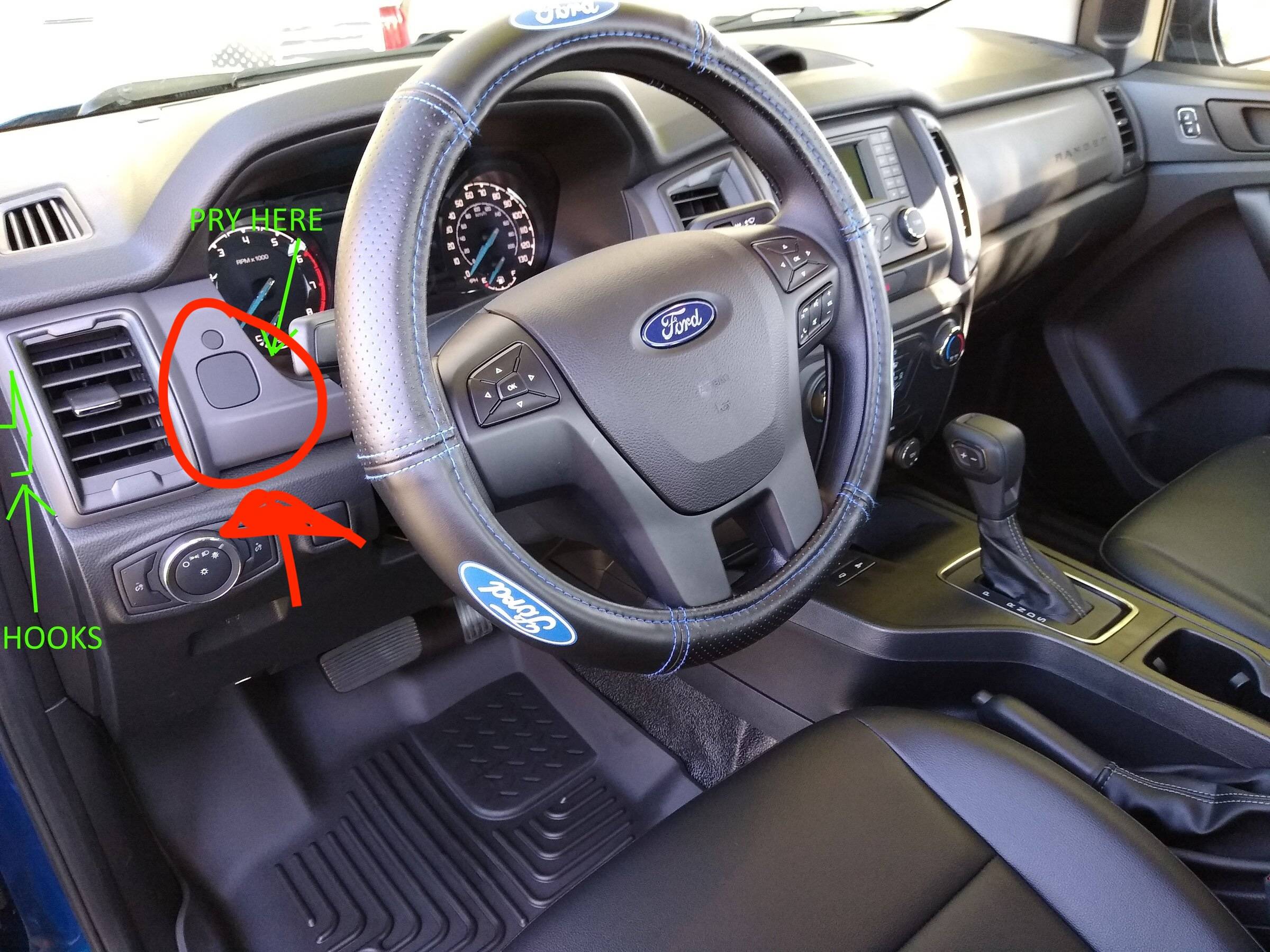

I like the location in the 12v outlet. It's easy to grab. If I had an XL without power mirrors, I would consider using the button blank.

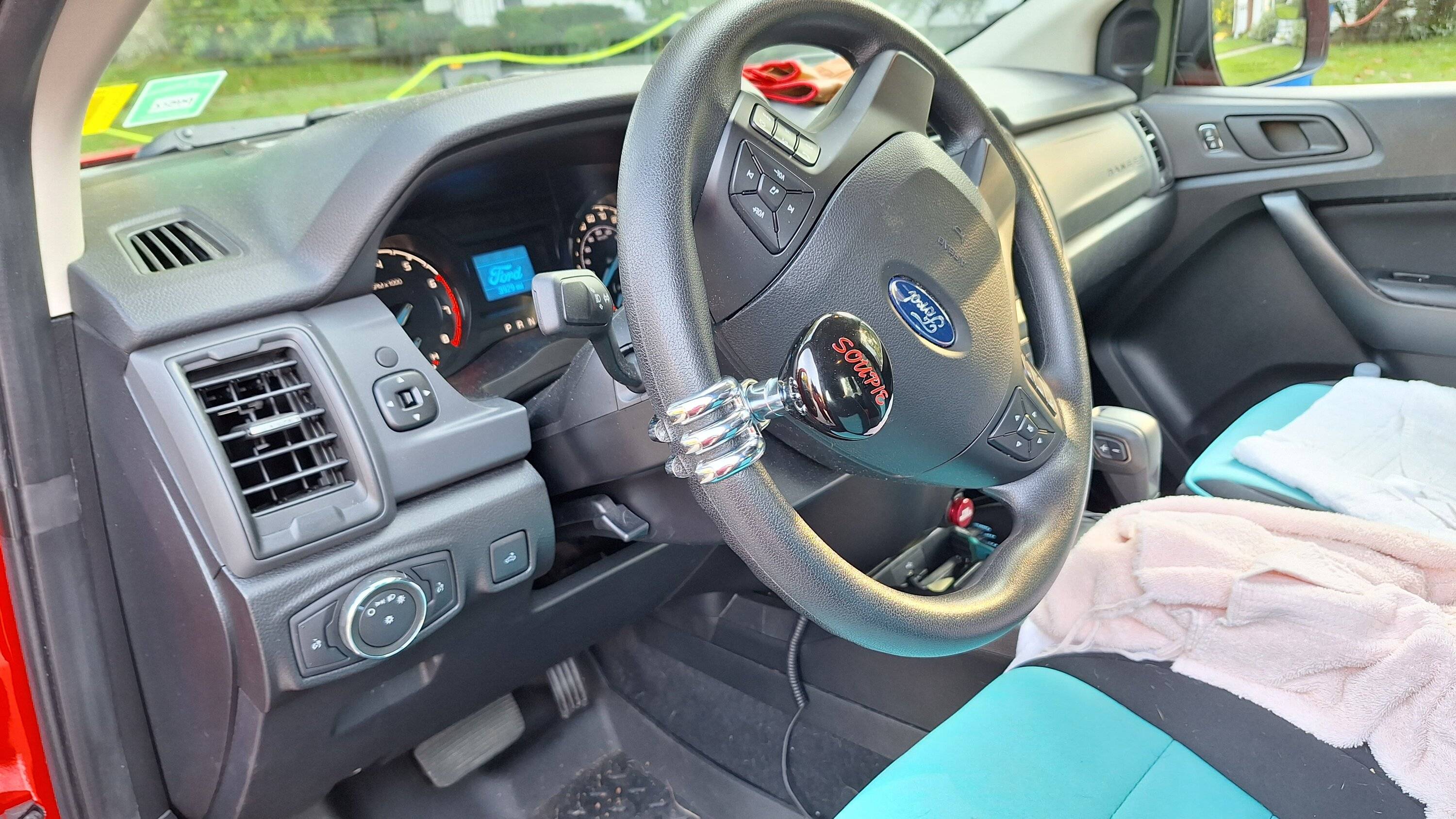

I never considered that location. I have power adjustable mirrors but not folding ones, so the small circular plug is available and that's where I'll mount it!
Thank you for the perfect suggestion and how to remove that panel. I'm scared to death of breaking clips, so this is very much appreciated- thank you.
my empty power mirror plug - absolutely perfect!
