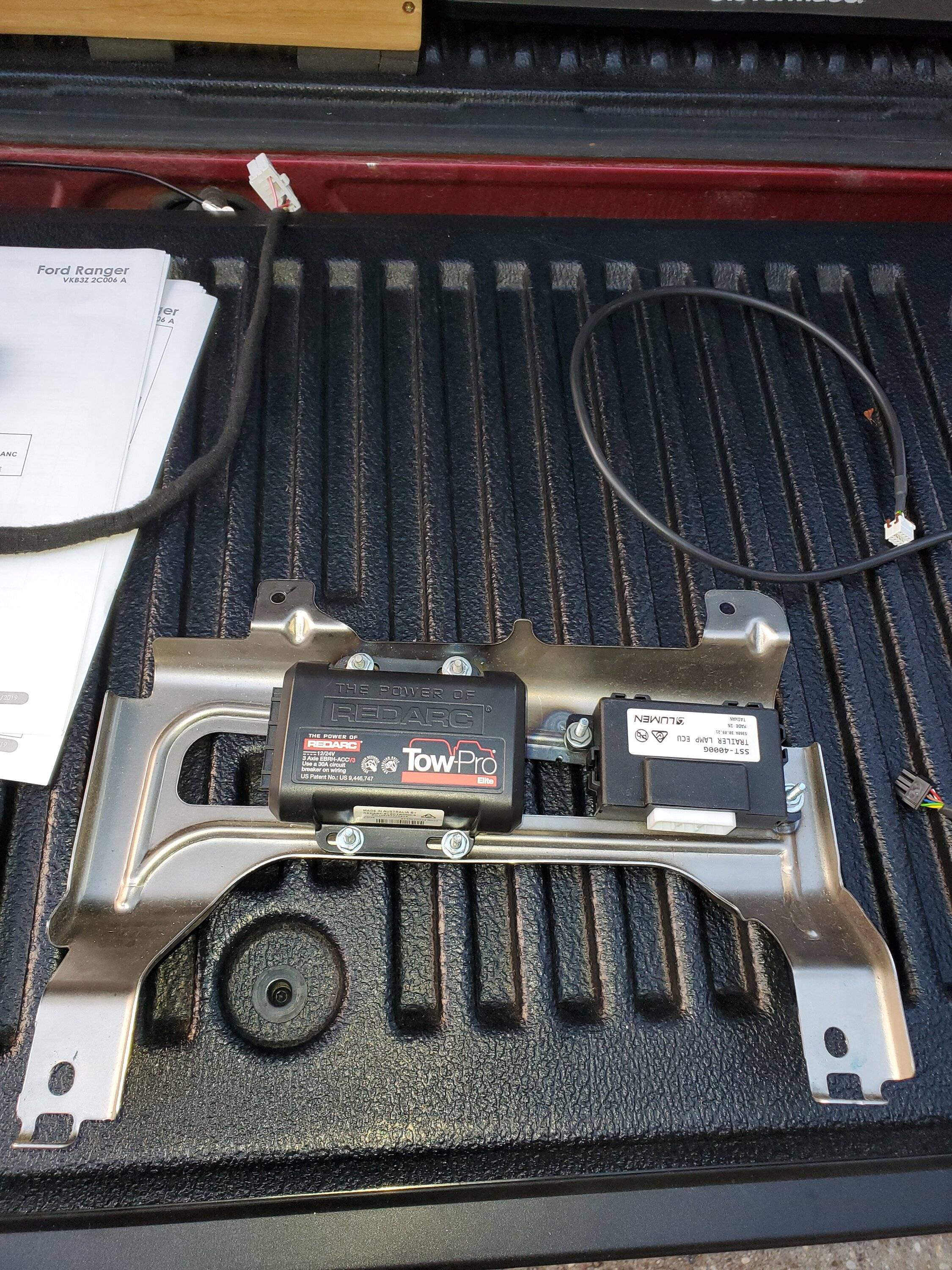

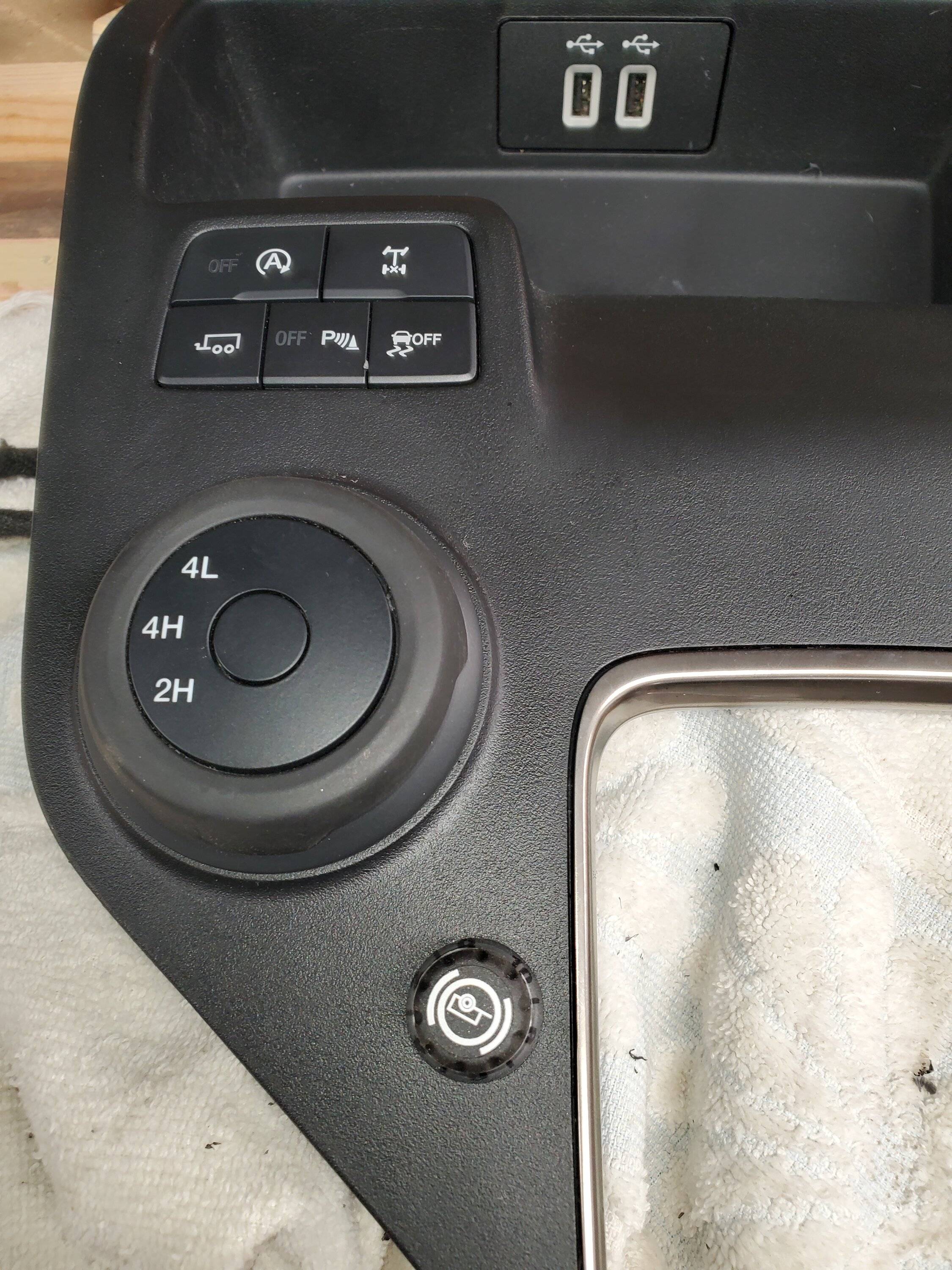

I just followed the instructions that came with the Ford kit and used the supplied foam pads and zip ties to lash both the Redarc module and the Lumen module to the metal frame behind the fuse panel cover. I mounted the control knob in the indentation in the fuse panel cover that they provide a template for.

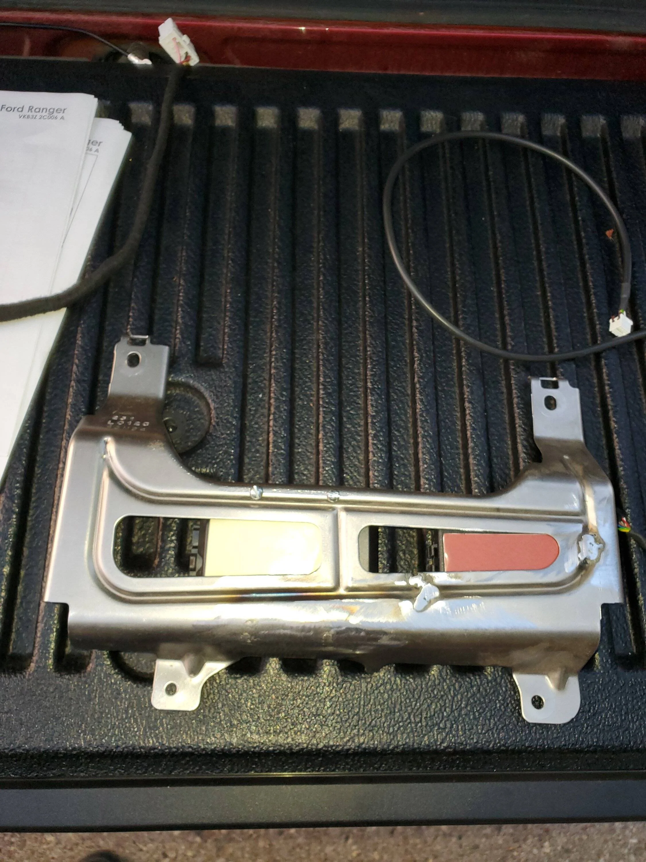

Autoworker
I ended up welding some #10 pan head screws and shimming the mount side with washers to the knee bolster bracket. If I need to replace or repair something, it all comes apart.
