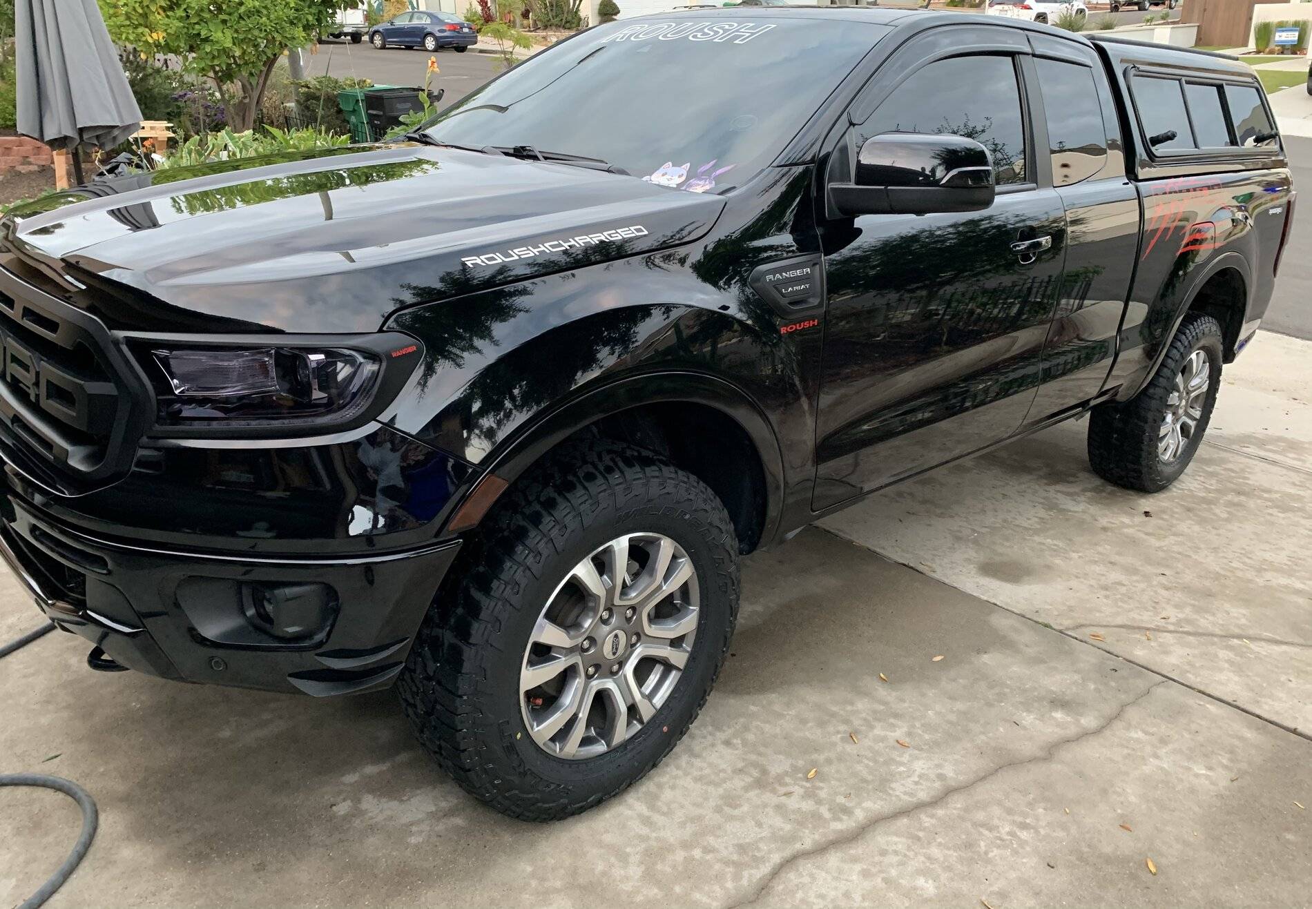

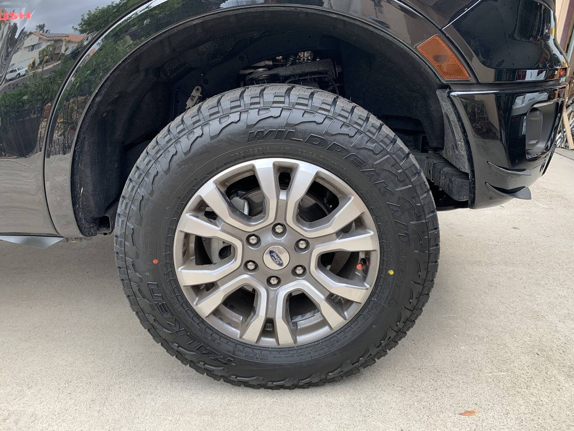

I run my 265/70/17 Wildpeaks at 30psi and I find the ride is good. Anything more and it starts getting too bumpy. Any less and mileage starts dropping more. According to a tire calculator I found (https://tirepressure.com/tire-pressure-calculator) where you input your stock tire and factory recommended PSI, it recommends I run these at 27psi, but I find that too low.
I think the tire pressure calculator is only intended to tell you where you have to inflate the new tire to equal the load rating of the tire you are replacing. It tells me that Cooper AT3’s in 265/70 only need to be inflated to 26 psi to achieve an equivalent load rating to the 30 psi of the Hankooks in 265/65. But, that does not necessarily mean that 26 psi is the best psi for ride comfort, mpg or tire wear. I find that 33 psi is much better for all those reasons and the side benefit of running that pressure is a greater load capacity as well.
