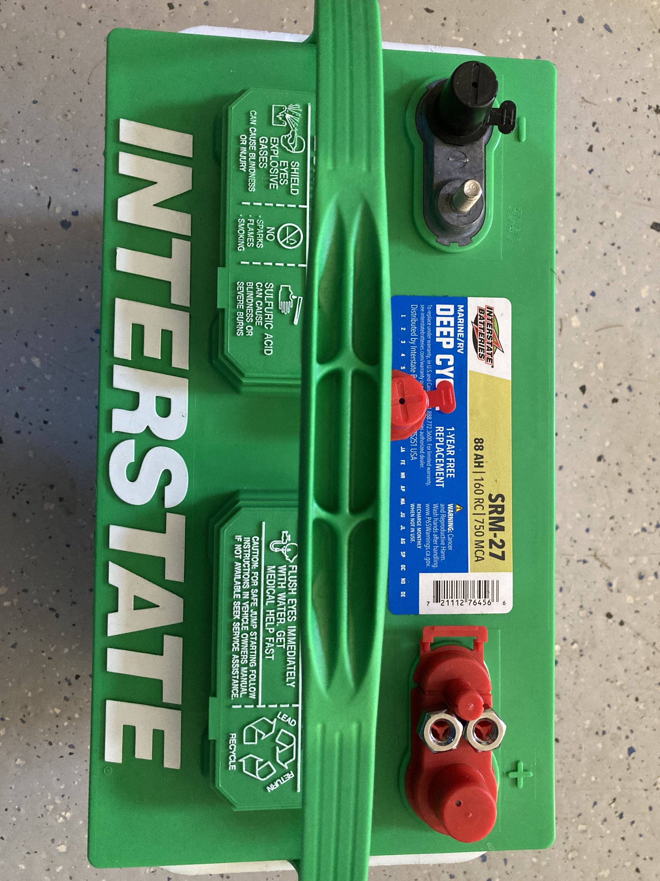

Edit: This is the type of battery I plan to use in the travel trailer.

If you use an unsealed lead acid battery inside the trailer, even with a vent, you will have some charging off gassing. That’s the nature of unsealed liquid electrolyte batteries. You will have occasional CO2 / propane alarms go off. You would need to put the batteries in a sealed compartment that only vents to the outside to keep off gassing outside. Or move to one of the sealed battery chemistry’s.

I'm now thinking of placing the lead acid battery inside a storage compartment inside the trailer, which is mostly sealed away from the inside of the trailer but may still have a few gaps in the trim where offgassing could leak out. I am thinking of getting some sort of vent to the outside (the compartment is very close to the outside) to prevent issues from offgassing.
