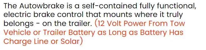

The autowbrake has to run off the truck AUX +12V power, not the battery. I think that is for liability reasons. If you can’t stop and the trailer battery is dead, that could open up some legal issues.
Limiting the current meant “charge as little as possible when braking” so the autowbrake gets priority. That would hook to the truck’s Aux +12V (black pin) and the DC-DC would either come after or be a totally separate Anderson plug.
That would also keep the Autowbrake from killing the trailer battery when parked, as I don’t know how it can “sense” a moving trailer without some standby circuitry looking for gyro or accelerometer changes.
So, wire it to the trailer battery. Run your new charge line to the battery and be done with it.
