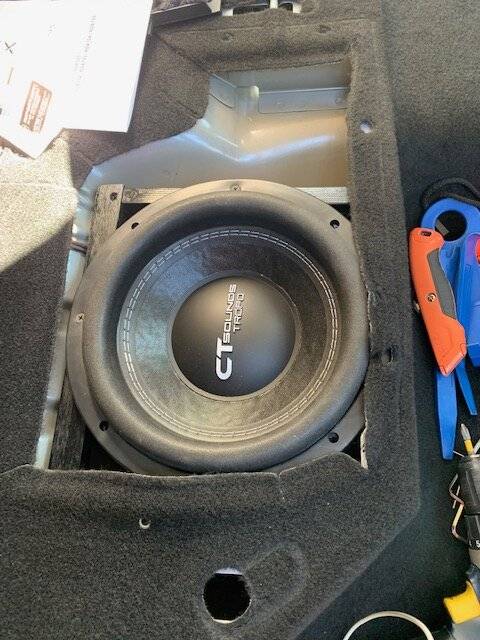

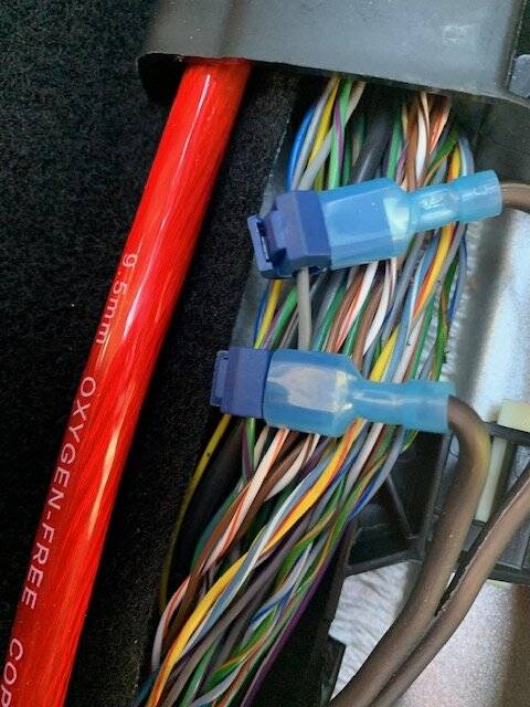

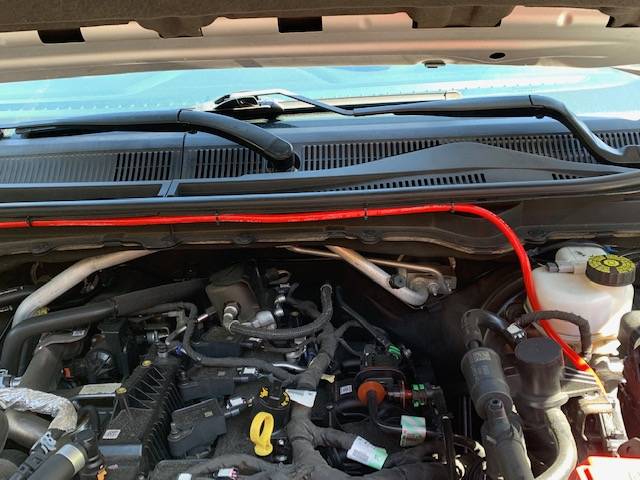

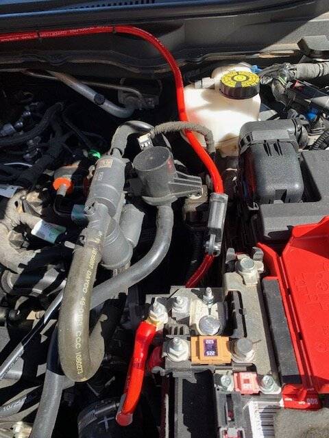

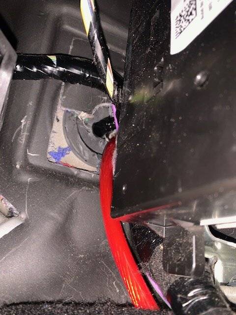

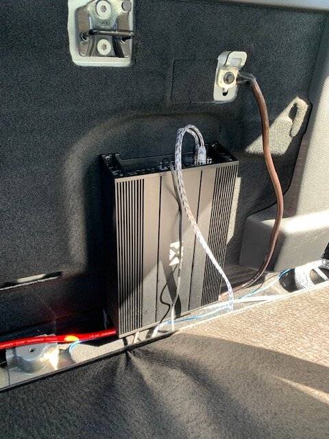

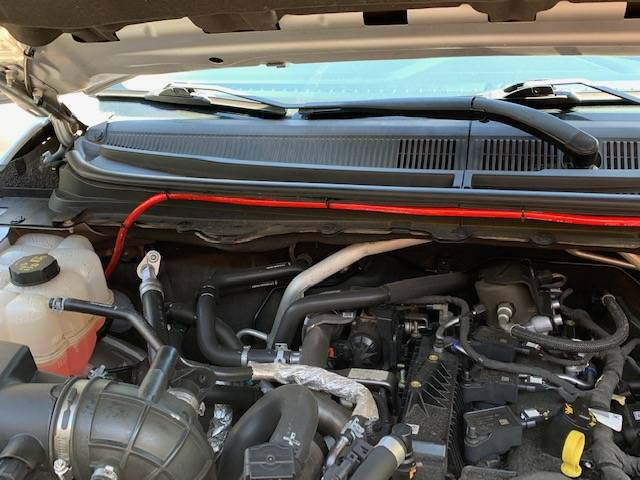

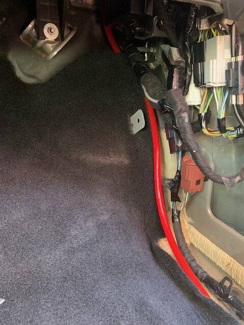

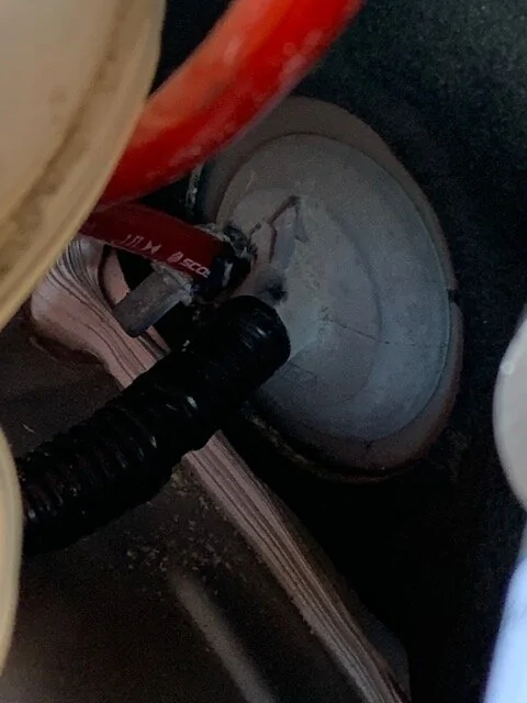

I got everything ran and tied in but still have to finish the speaker box top (ran out of daylight). I found the perfect spot to run the power for the amp through the firewall. The passenger side has a large rubber grommet with one bundle of wire in it with another plugged hole. Feed wire in it and along the door pan. Also posted a picture of the speaker wire tap on the passenger side line output converter. I will get the wires on the amp tidied up this weekend when I get to finish the speaker box. It is a CT-Sounds TROPO-10-D2 1300 watt, 650 RMS Sub and NVX NDA102 1500 watt, 750 RMS Amp. It took a little modification but not much and WELL WORTH IT!!!
