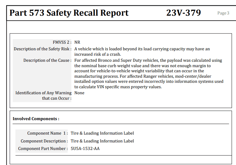

Attached are the recall reports. Seems that Ford didn't take into account mod center or dealer installed options in GVWR. Specific to Ranger:

NHTSA Campaign Number: 23V379000
Manufacturer Ford Motor Company
Components EQUIPMENT
Potential Number of Units Affected 29,607
Summary
Ford Motor Company (Ford) is recalling certain 2022-2023 Bronco, 2023 Super Duty F-250, and 2019-2023 Ranger vehicles. The Tire and Loading Information (TREAD) label states the incorrect load carrying capacity, which can result in an overloaded vehicle. As such, these vehicles fail to comply with the requirements of Federal Motor Vehicle Safety Standard number 110, "Tire Selection and Rims."
Remedy
Ford will mail a new TREAD label to install over the existing label, free of charge. Owners will also have the option to take their vehicle to a Ford or Lincoln dealer to have the new label installed, free of charge. Owner notification letters are expected to be mailed July 5, 2023. Owners may contact Ford customer service at 1-866-436-7332. Ford's number for this recall is 23C18.
