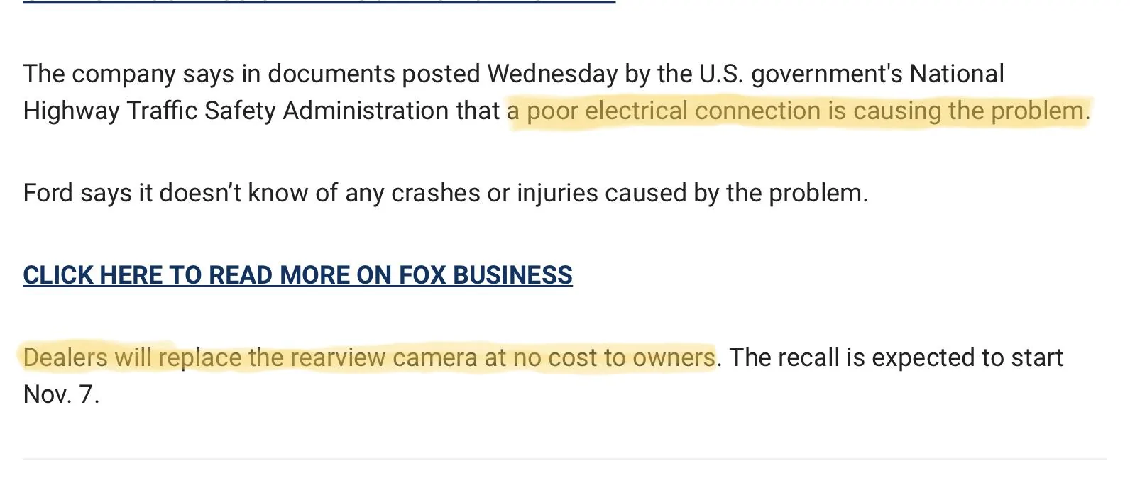

Explain why Ford is replacing the cameras if it’s only an electrical connection issue?

Phil,
If it's an electrical connection on the camera (to the wire hardness), or even inside the camera, then it's easier to just R&R the assembly than try and fix it. At least for us structural issues usually get a repair, systems issues usually get an R&R. It's just easier that way. Especially for a field repair like this one.
Just my two cents. Phil may feel otherwise.
Hi Matt,
I do not know the specifics of this but agree with you that it the problem is within the camera where the wiring loom plugs in. Tells me the wiring loom is okay, not the conncetion on the camera. When recalls involve such large amount of vehicles, just the mailings to owners costs $ millions...
Supplier Quality Assurance, SQA, is in for many sleepless nights... They need to understand how so many were made that were defective, but it could be only a very few in large sample population, but I doubt this as the first step would be a diagnostic, not just replacement. Most supplier agreements have a provision that the supplier pays the cost of the recall and this could likely tank the supplier... What a mess!
Going to affect the bottom line for sure...

Hi Matt,

My RAV4 had a recall on the “driver’s window switch electrical connection“. Toyota pulled the switch, put electrical lube on the connector & sent me on my way. That’s why I asked Phil. Thought he had insight on the wording of the recall. Thanks all!
Could be any number of reasons why they'd replace the entire assembly. Mostly it's probably labor related. If it's a $100 camera assembly (with harness), or a $10 harness, but 30 minutes of labor vs 2 hours of labor, you can see why the assembly would come out cheaper in the long run.
