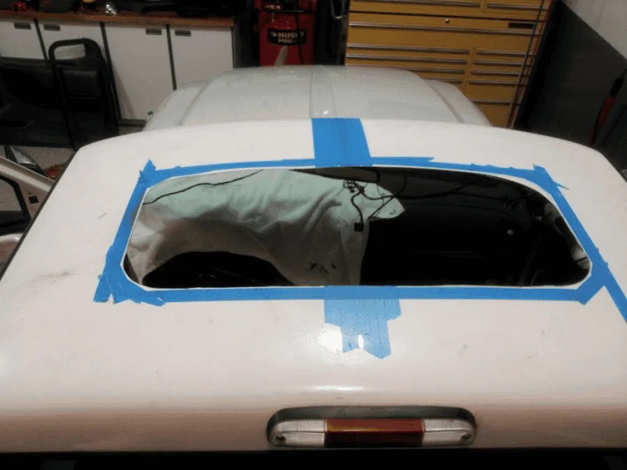

I did this to mine before I bought the camper top. You can find the oem sliding back glass much cheaper than from ford, from pilkington if memory serves. You should have a pro windshield installer do the job. Goes in with polyurethane sealant just like the windshield. The slider comes with the defrost grid and the power leads are there under the C-pillar covers. How you would actually make it work I do not know. Be really careful if you choose to plug it in as the tabs break off super easy.

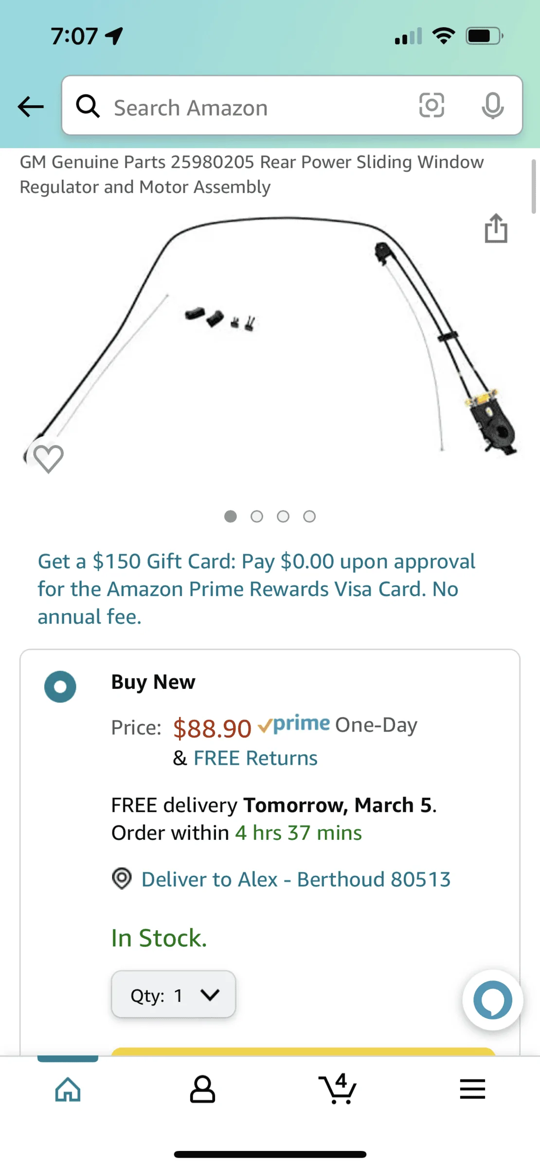

I’ve been trying to figure out a way to convert my sliding rear window into a power slider. I’ve read the threads about using linear actuators. There’s some drawbacks with that method, mainly mounting it on the bottom causing torque that may bind the window.
I am wondering if there is a way to covert this kit to work with a regular sliding rear window? Anyone have any input? GM Genuine Parts 25980205 Rear Power Sliding Window Regulator and Motor Assembly https://www.amazon.com/dp/B005OVM1KC/ref=cm_sw_r_cp_api_glt_i_6VHWS9JE03XCPTG3400W
