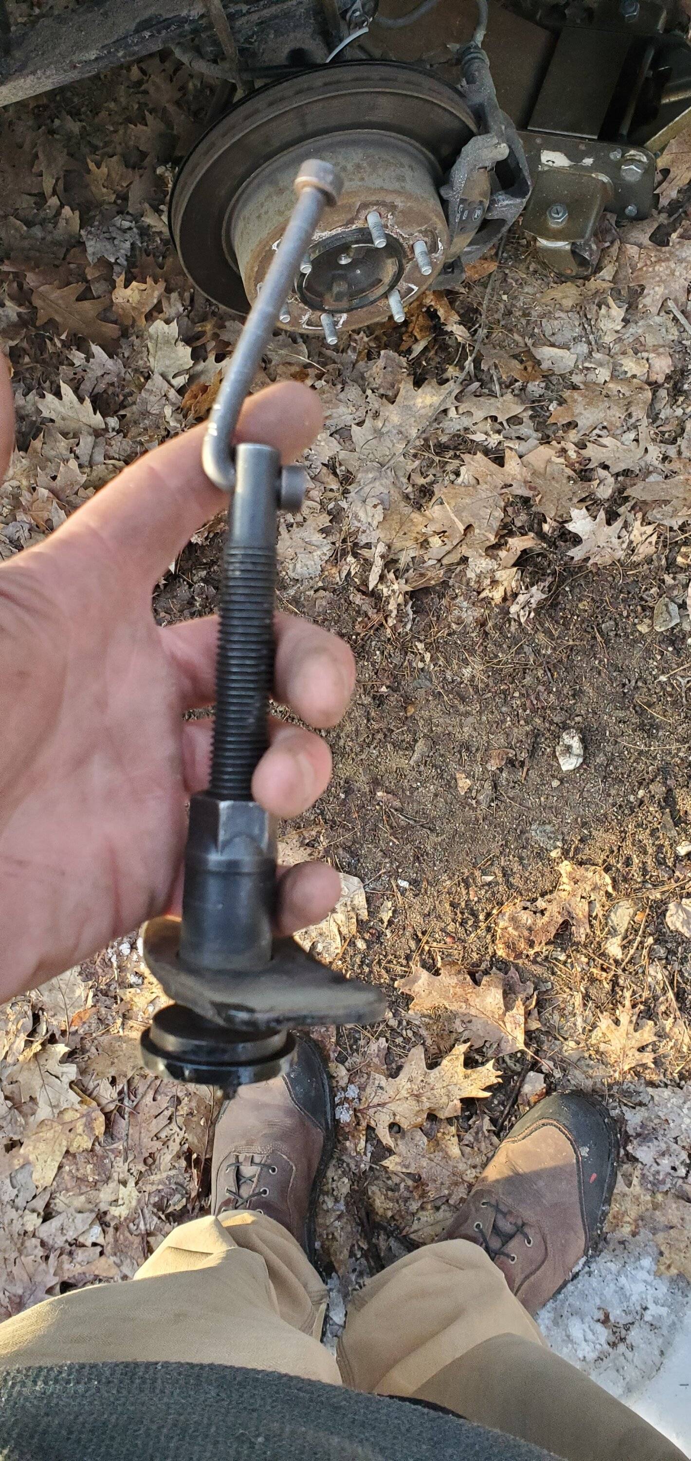

Attempted a padslap today, and could NOT for the life of me get the pistons to depress.
I have the stupid spinny piston depresser tool.... and really folded it up in a fit of "I'm a total gorilla, WTF" rage trying to spin the damn thing in lol.
What's the secret? Either I'm missing something extremely stupid because I was in a super rush and don't operate that well under time deadlines.. or the calipers just jacked.
My money is on missing something stupid. This is the first vehicle I've personally owned with these stupid spin-to-depress rear calipers.. forgive me. Or make fun of me... I deserve a bit of both no doubt.

You need a tool, one turns in clockwise and the other one is counter clockwise.
Ah.

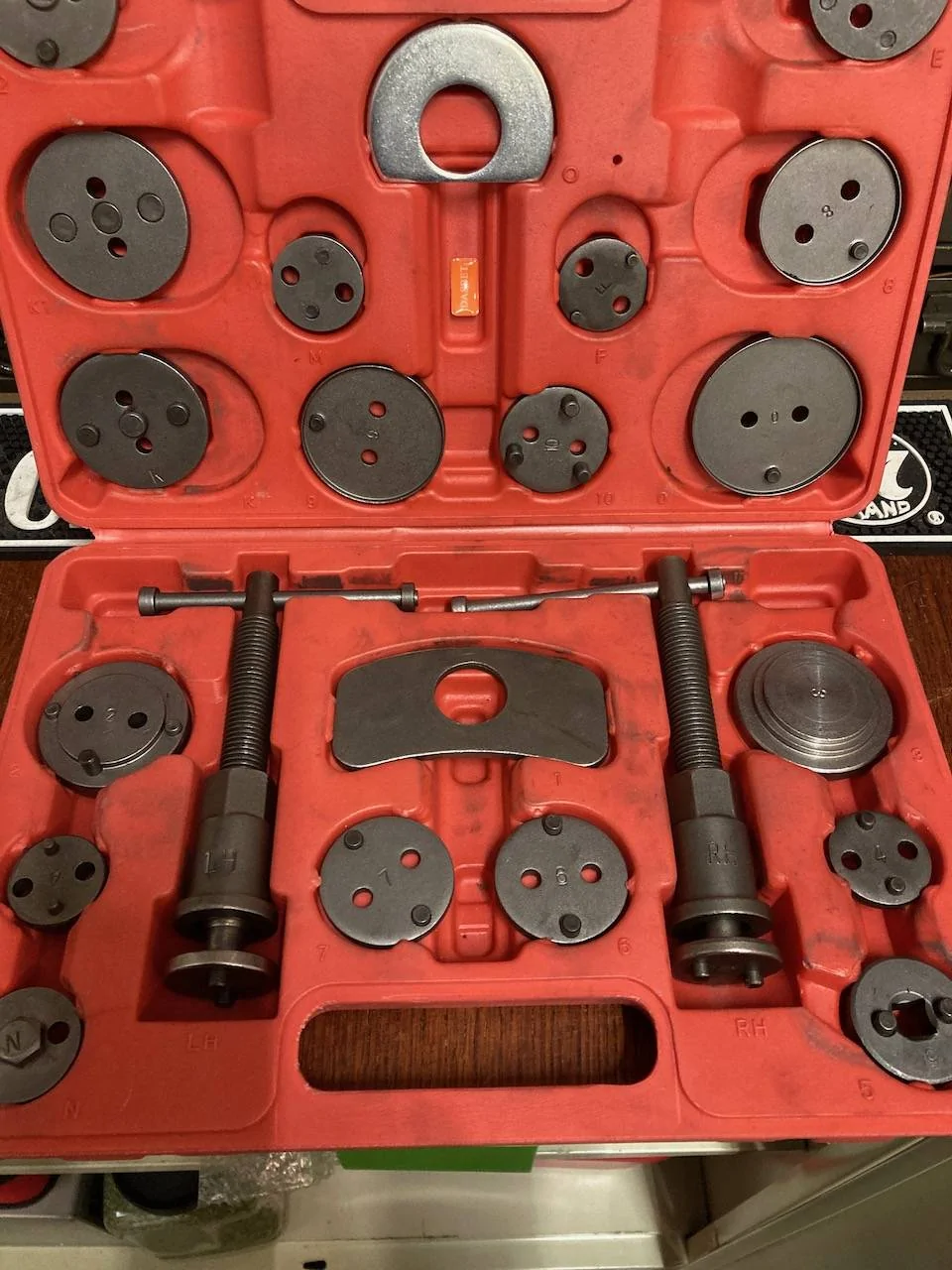

So the hazard fraught kit I bought is completely useless for one side of the vehicle then lol, it'll only depress if its wound clockwise ?
Considering the drivers side would NOT spin clockwise for me I can only assume that one needs to go counter-clockwise then..

Unfortunately yes

Leave it to Harbour Freight to sell a one sided caliper tool.:crackup:
Ha tell me about it. Probably my first 'dud' of a tool I've bought there over the years though.. Can't win em all.

Parts stores will rent this tool for free FYI. I did this when I changed brakes on my Wife's ford Flex
I'm just gonna suck it up and buy one that actually works tomorrow.
I'm a big fan of owning all the tools I need, even if some of them only get used once every few years.
