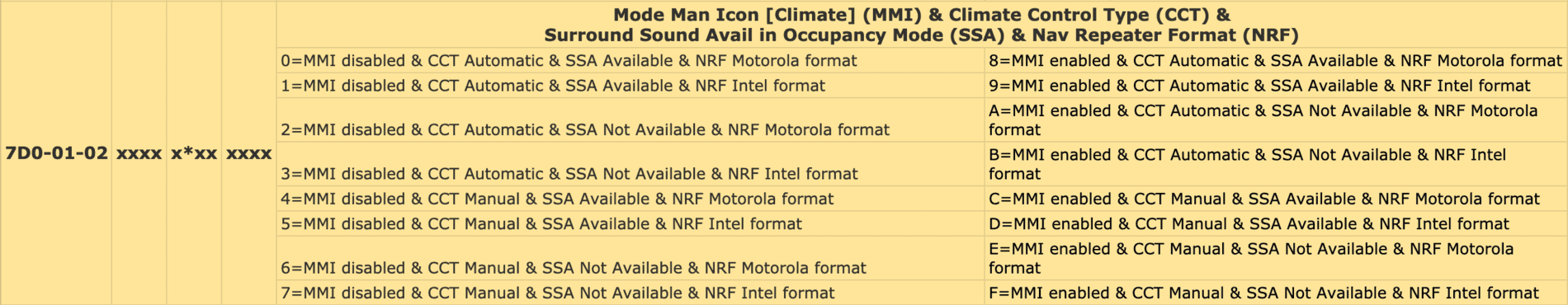

I do have a 501a Lariat, which is why I was surprised your configuration didn't work. According to the F-150 sheet, these are the differences in the values.
I used 8 because it changed my original value of 0 from MMI Disabled to Enabled without changing anything else.

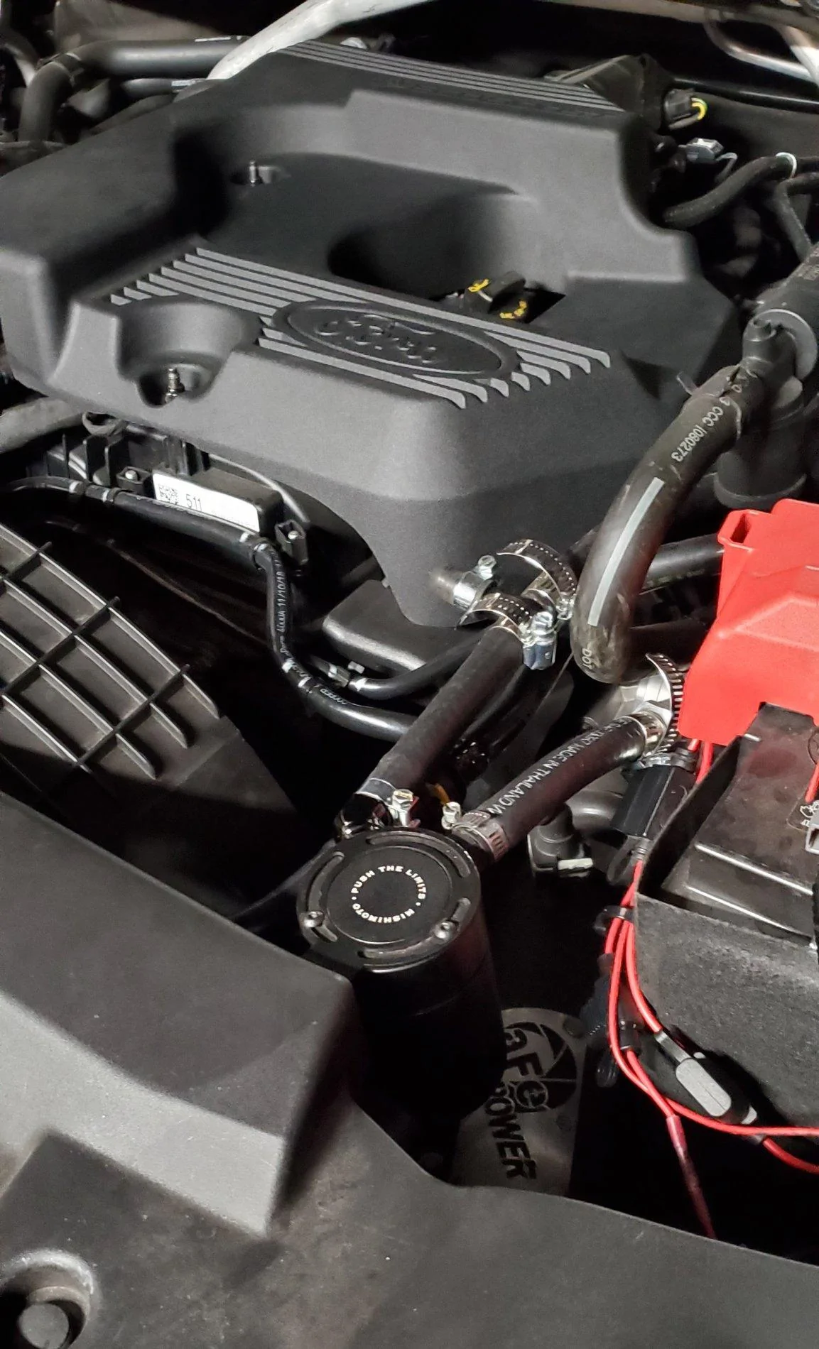

Based on 5,000 miles of testing I've picked up virtually nothing but condensation on the boost/breather side. Switched back to PVC only for the catch can.

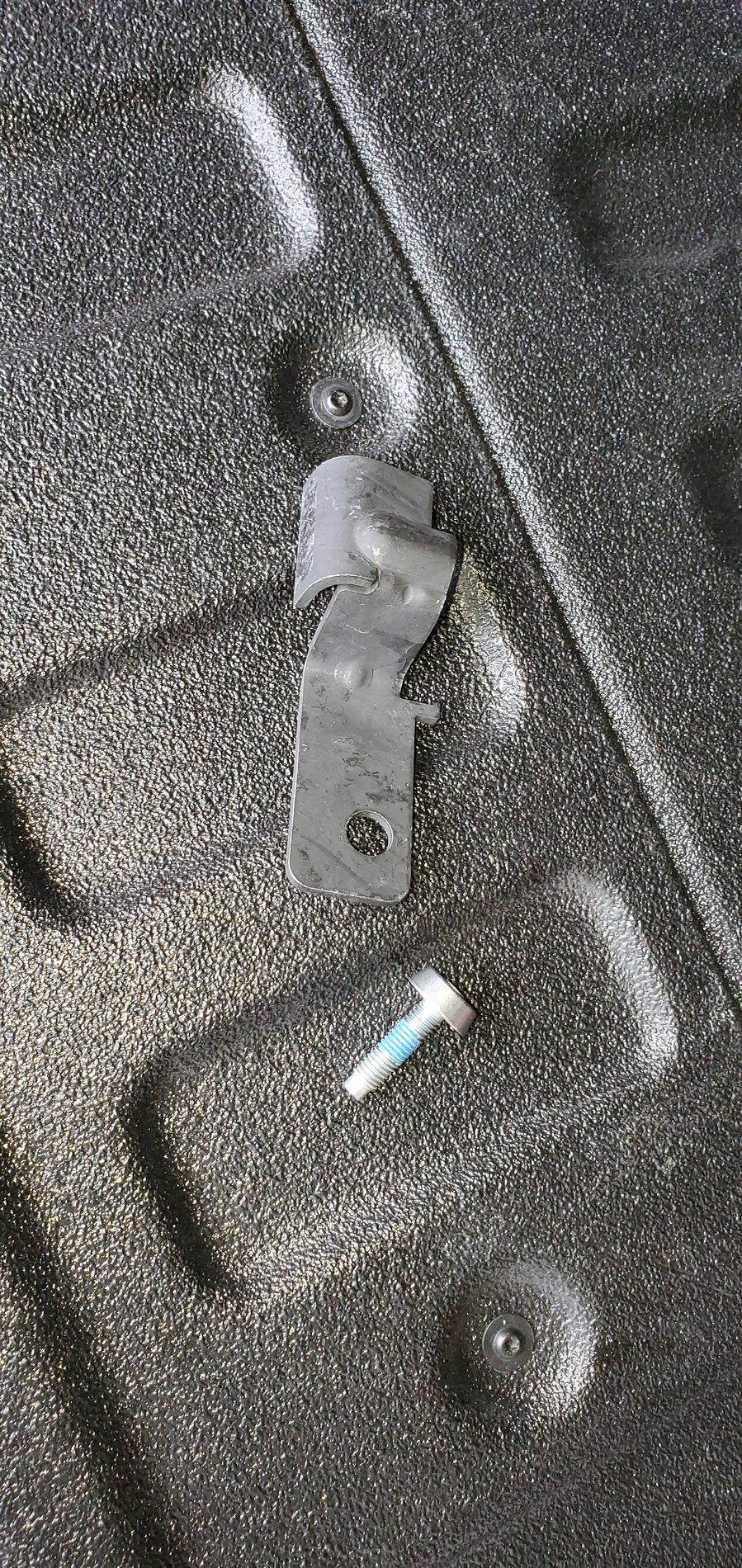

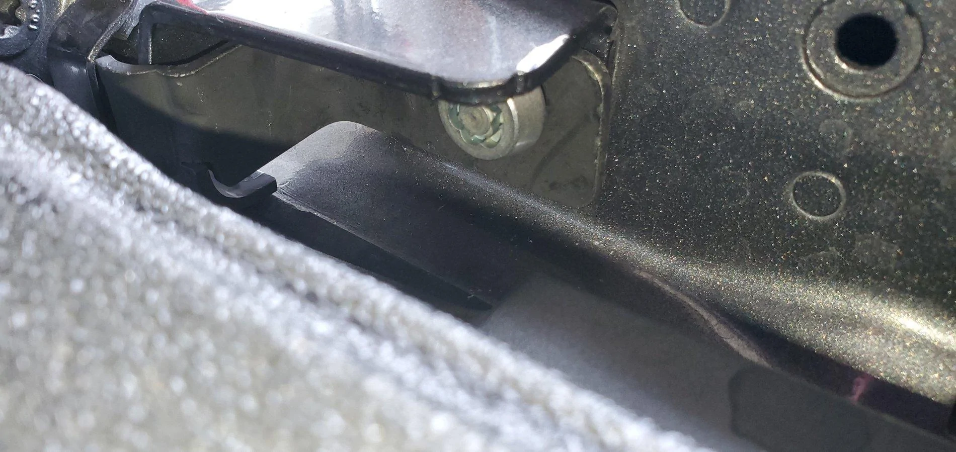

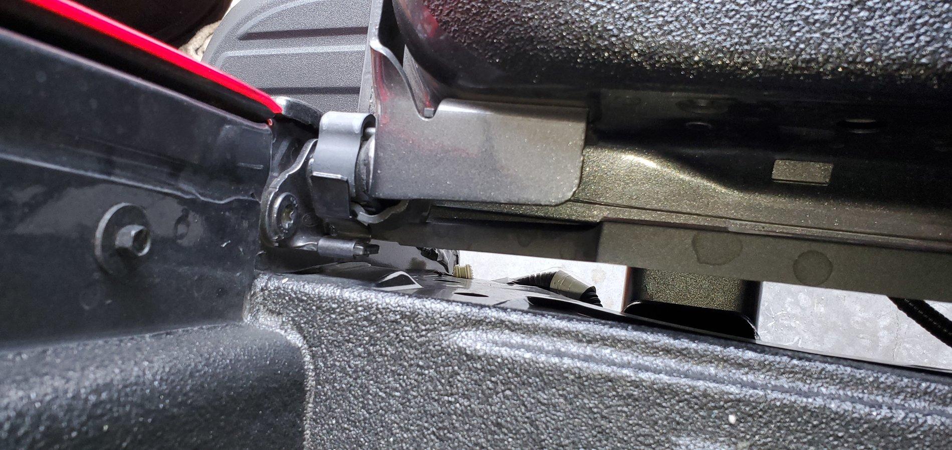

Tailgate lock. Good luck stealing the tailgate. Prevents the tailgate from lifting off the hinge. Pretty thick gauge steel. McGard under contract to Ford. Just like the DeeZee tailgate dampener. You won't see them outside of Ford till the contract is over. VKB3Z-18168-A

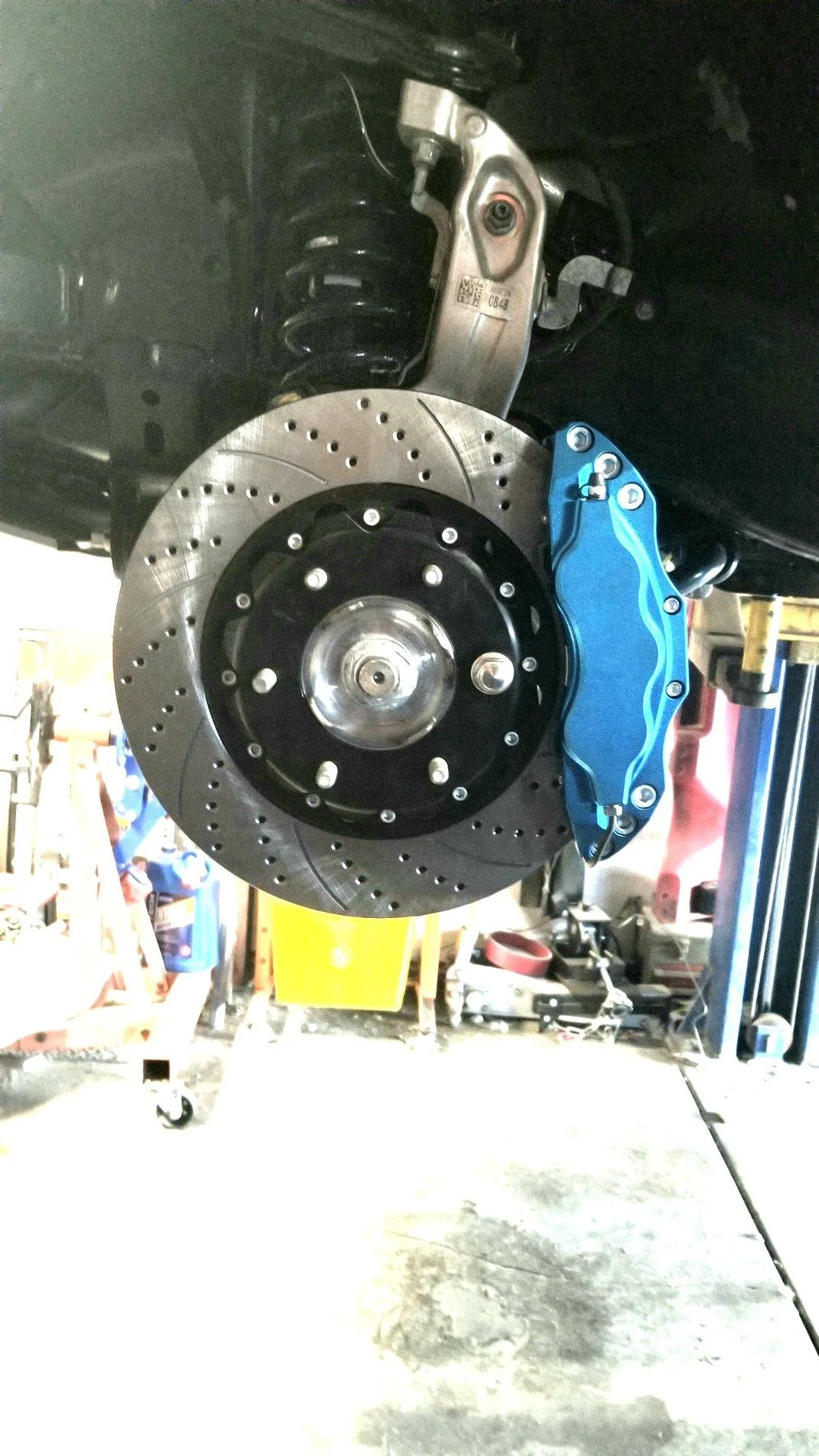

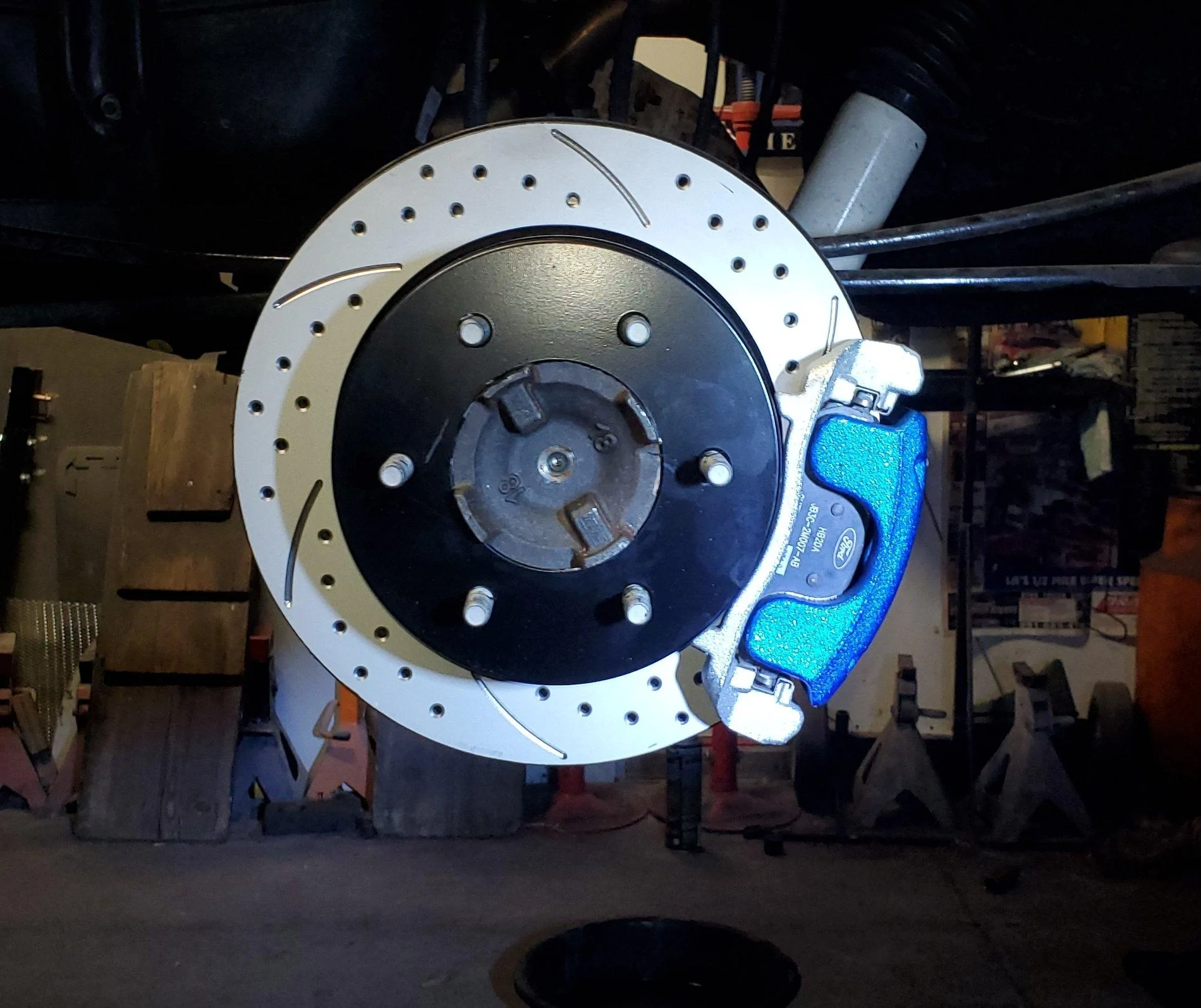

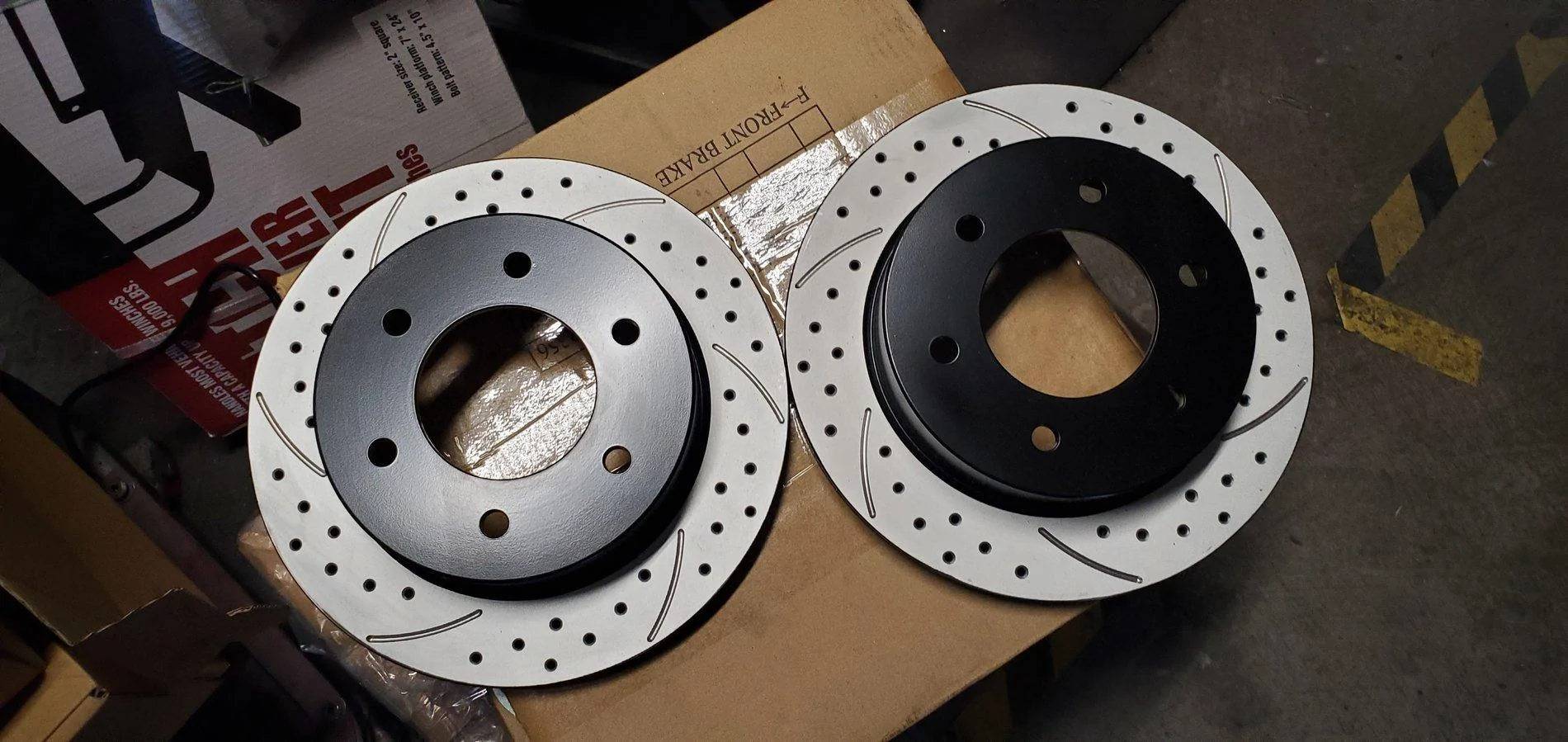

Just painting the rotors and what not? or new beefier breaks? Always following what you up too...
RCMUSTANG
RCMUSTANG
Ray
Jan 22, 2019
1,867
2,192
Los Angeles
2017 Fusion 1995 Ranger

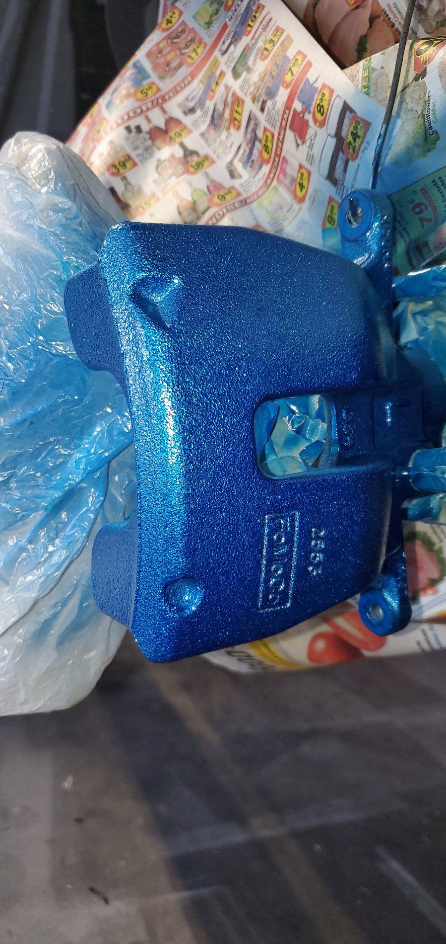

Just replaced the rotors and painted the calipers to match.

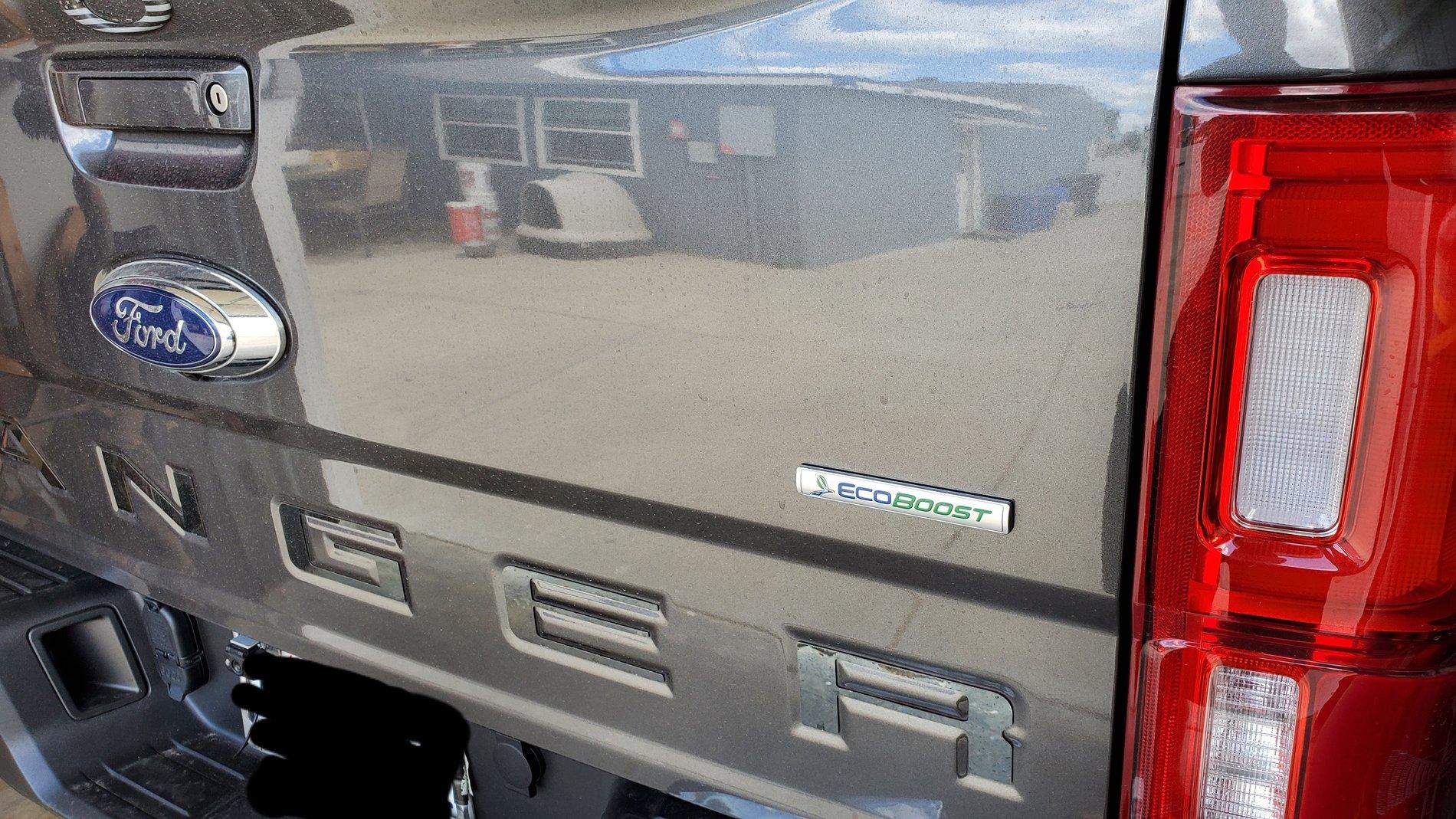

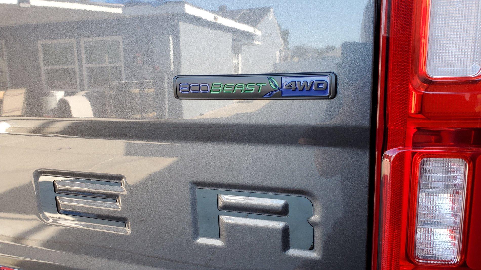

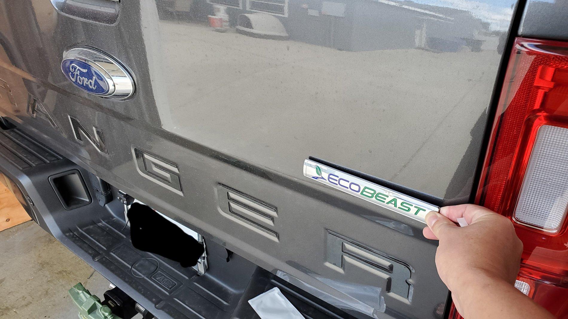

Is been a while since I've done anything new. I'm either waiting on the intercooler or doing research for a project done may want to do too. In the meantime, I have this little decision to make. Trying to decide whether I use this Ecobeast emblem or not. I didn't realize it was that big because it's meant for the F-150's. If I do I'll probably black out the chrome part.
