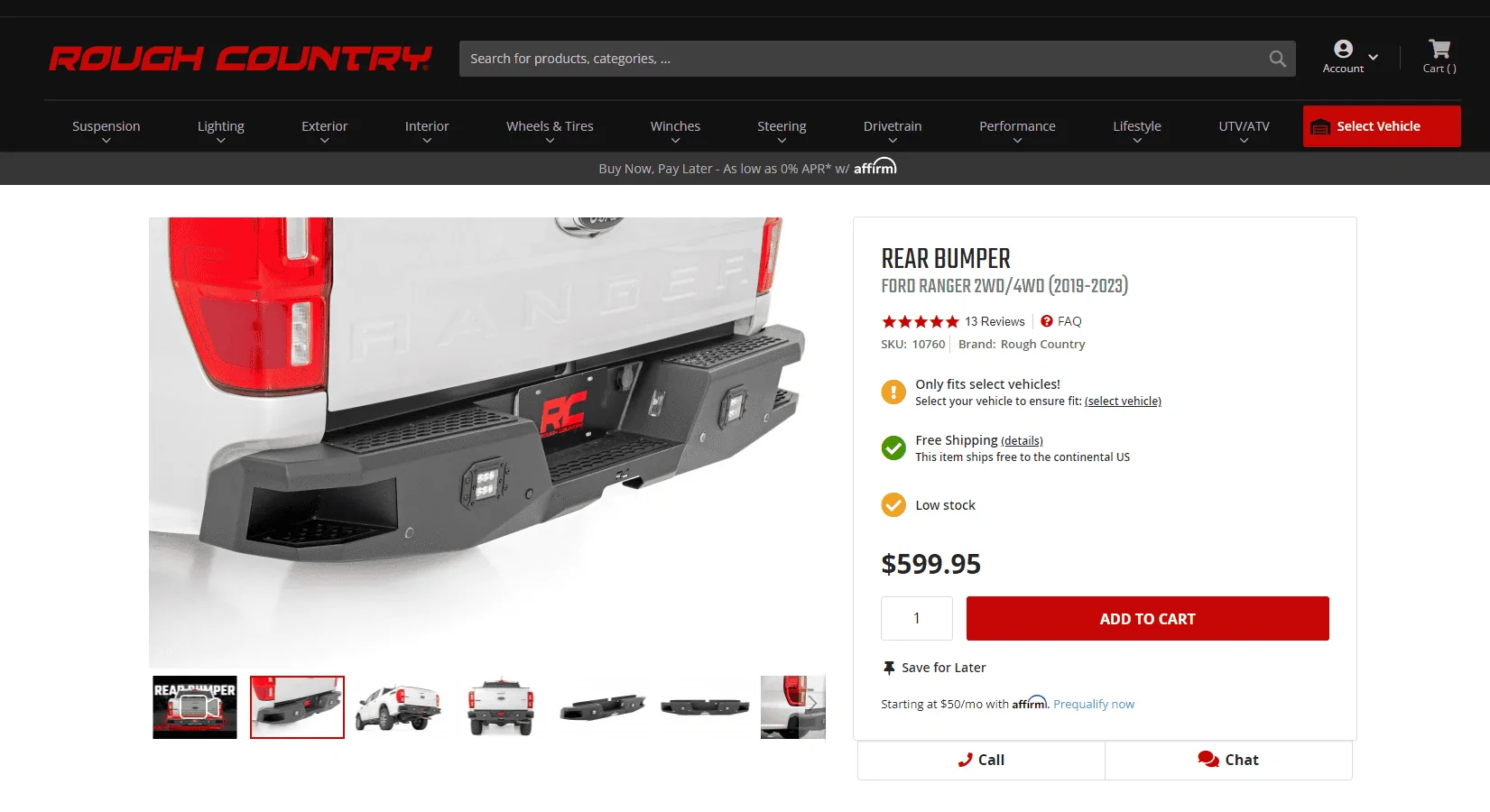

Wondering if the $200 gap between the two is worth it?
I know there are a couple of post regarding the rear mount steps, but haven't really seen any good info regarding the RC bumper.
I hear that there are some fitment issues if your Ranger is equiped with the trailer hitch reciever.....
Roug Country Rear bumper with intergrated step $599.95
https://www.roughcountry.com/ford-rear-led-bumper-10760.html

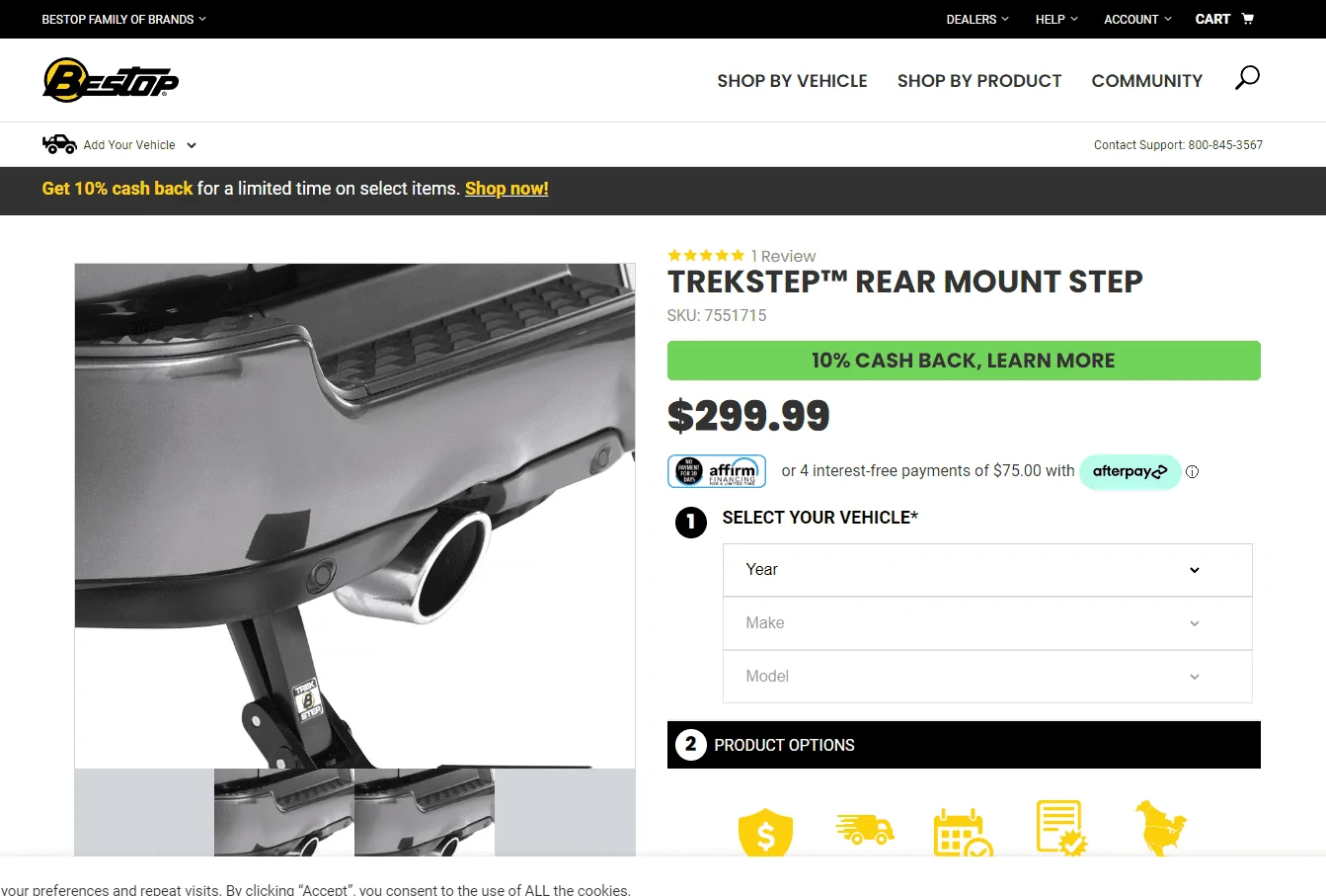

Trekstep Rear Mount $299.99
https://www.bestop.com/products/trekstep-rear-mount-step-ford-2019-2021-ranger/?sku=7551715

I would have bought that bumper without hesitation , but i have the factory hitch and didnt want to chance it... it does look like its cut out for it though...

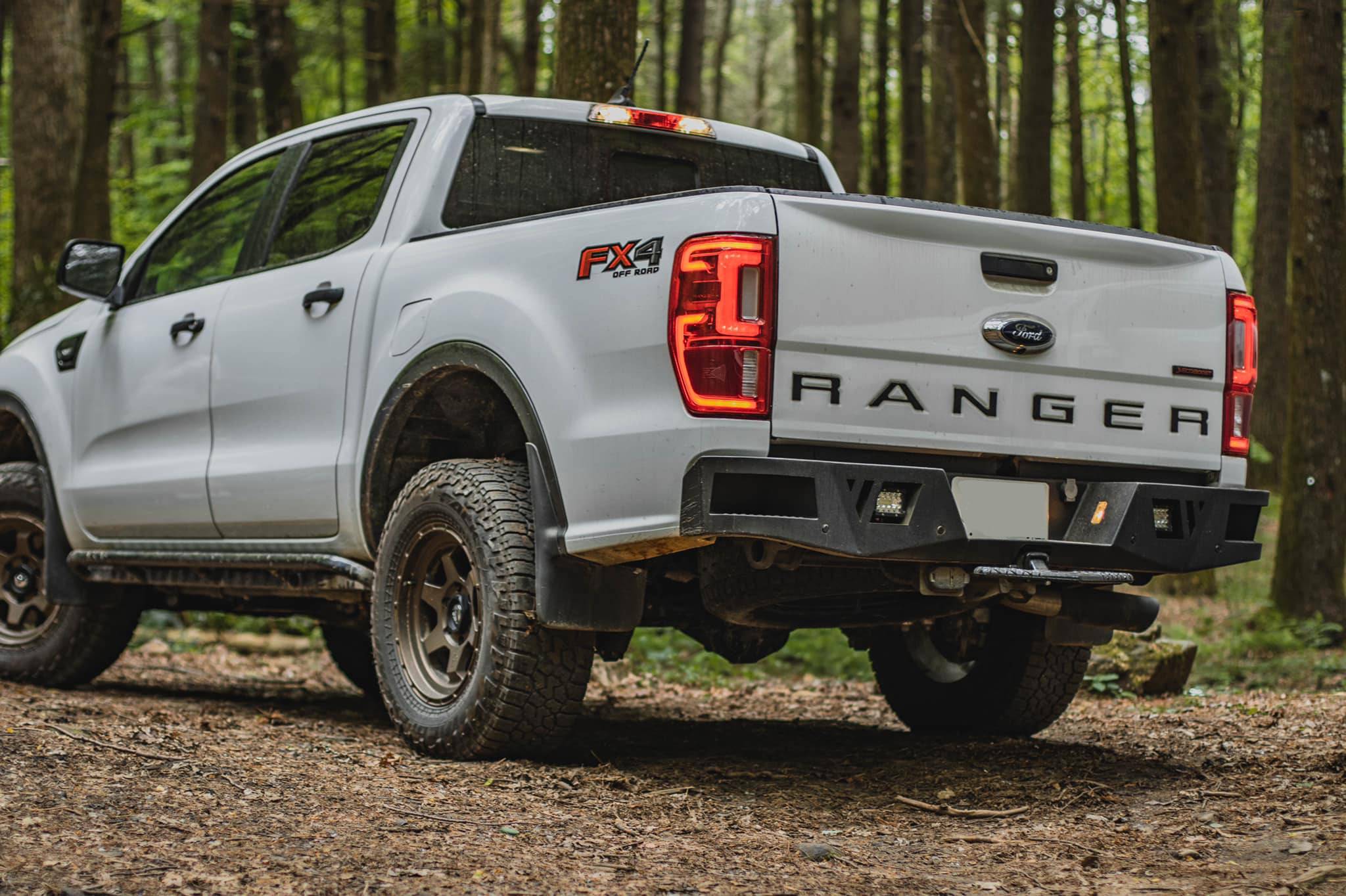

I have the Black Horse rear bumper with integrated steps and I wouldn't trade it for any of the steps.
No problems with hitch clearance and I added LED cubes for backup lights.
Here is is with a recovery ring in the hitch.

So you have the factory hitch with that bumper ? Me likey !

How was installation?

ouch ! 1 thousand dollars !!! best one ive seen though ...
I got it when it first came out. I think it was <$700 then.
Installation is several hours.
I was thinking that you unbolt the factory bumper then bolt on the new one.
In actuality, you have to disassemble the factory bumper to get to the "skeleton" of the bumper and then the new one bolts to that.
That's probably why this one has no issues with the factory hitch since it's using the factory bumper frame.
HERE is a link to the installation instructions.
Overall I really like it.
It's very heavy duty, I like the way it looks, and the steps are extremely handy.
EDIT: I found my original installation pics from June 2020 and I actually got it for <$600 :rockon:
LINK To Installation

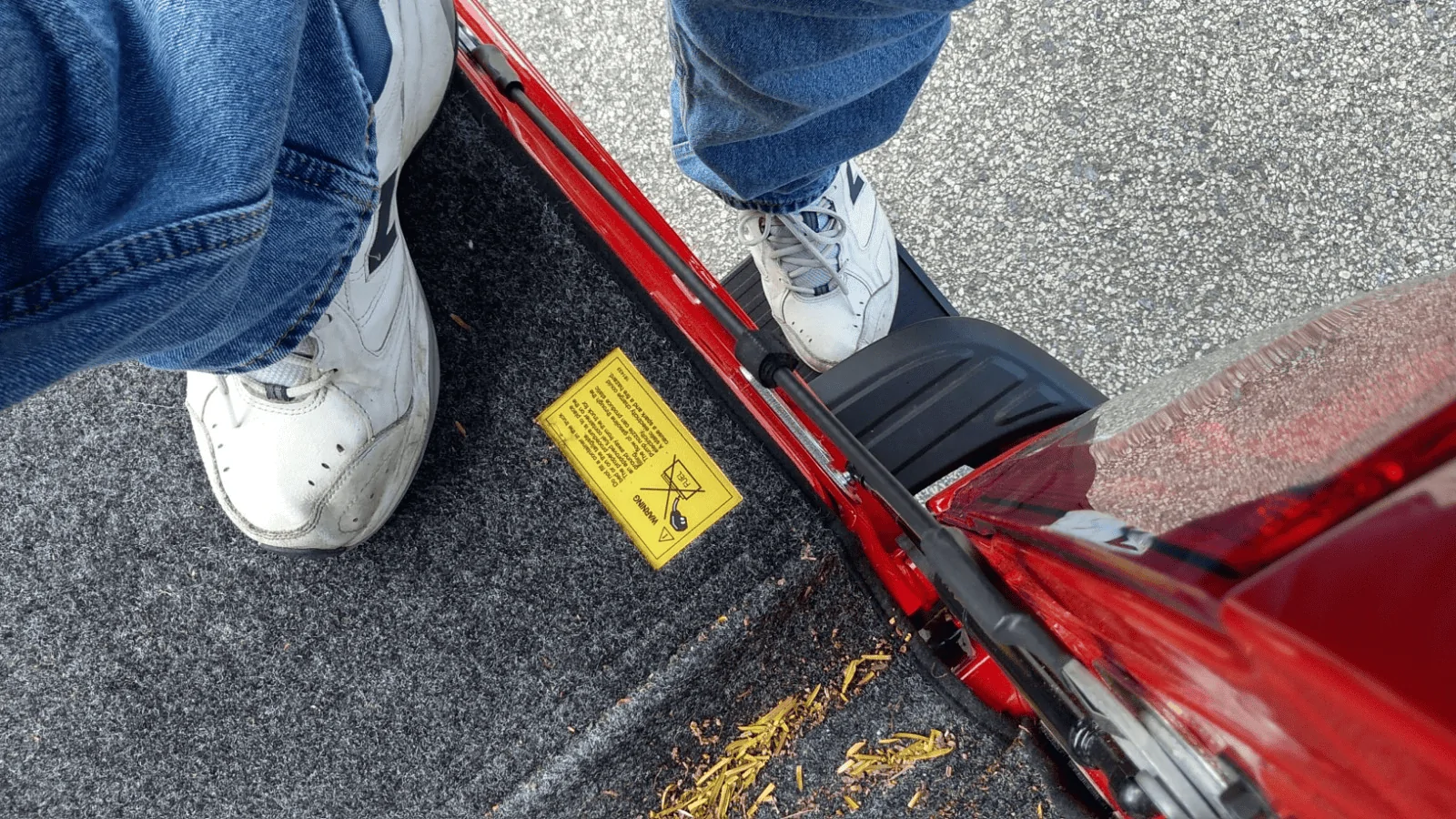

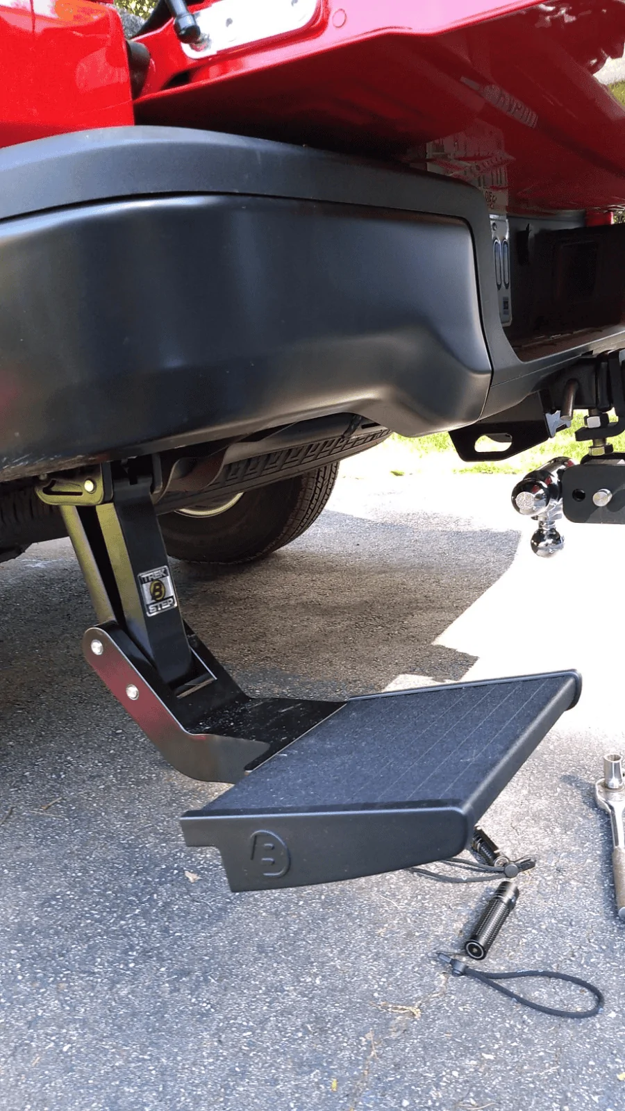

I like the TrekStep because I'm 5'6" and can't get in the bed graciously. I'd have to flop onto my belly on the open tailgate and roll into the bed and stand up. That's quite the site! =D
The bumper with step cutout would be too tall for me. =(
The TrekStep comes down enough to make it a manageable task for getting in and out of the bed. I use it often and it's incredibly secure. It's also top quality - 100% aluminum step with thick steel frame and pivot.
It is a job to install it, not hard, but you need the right tools (like 1/2" drive, deep socket, and decent extension - I used a 12" extension and cheater bar). I did mine when my truck was only a month old, so the bed bolt was not too bad to remove. I did hassle with setting the height I wanted after I installed it. It would have been far easier to set that before installing it!
The TrekStep is an add-on that would be hard for me to live without.
My installation and lots of pics at how it sits.
https://www.ranger5g.com/forum/threads/what-did-you-do-to-your-ranger-today.3511/post-434835
https://www.ranger5g.com/forum/threads/what-did-you-do-to-your-ranger-today.3511/post-435001
The bumper is very cool and certainly sportier looking. The step is very utilitarian, imo.
Whichever floats your boat is the one to get, just sharing my experience. Good luck!
