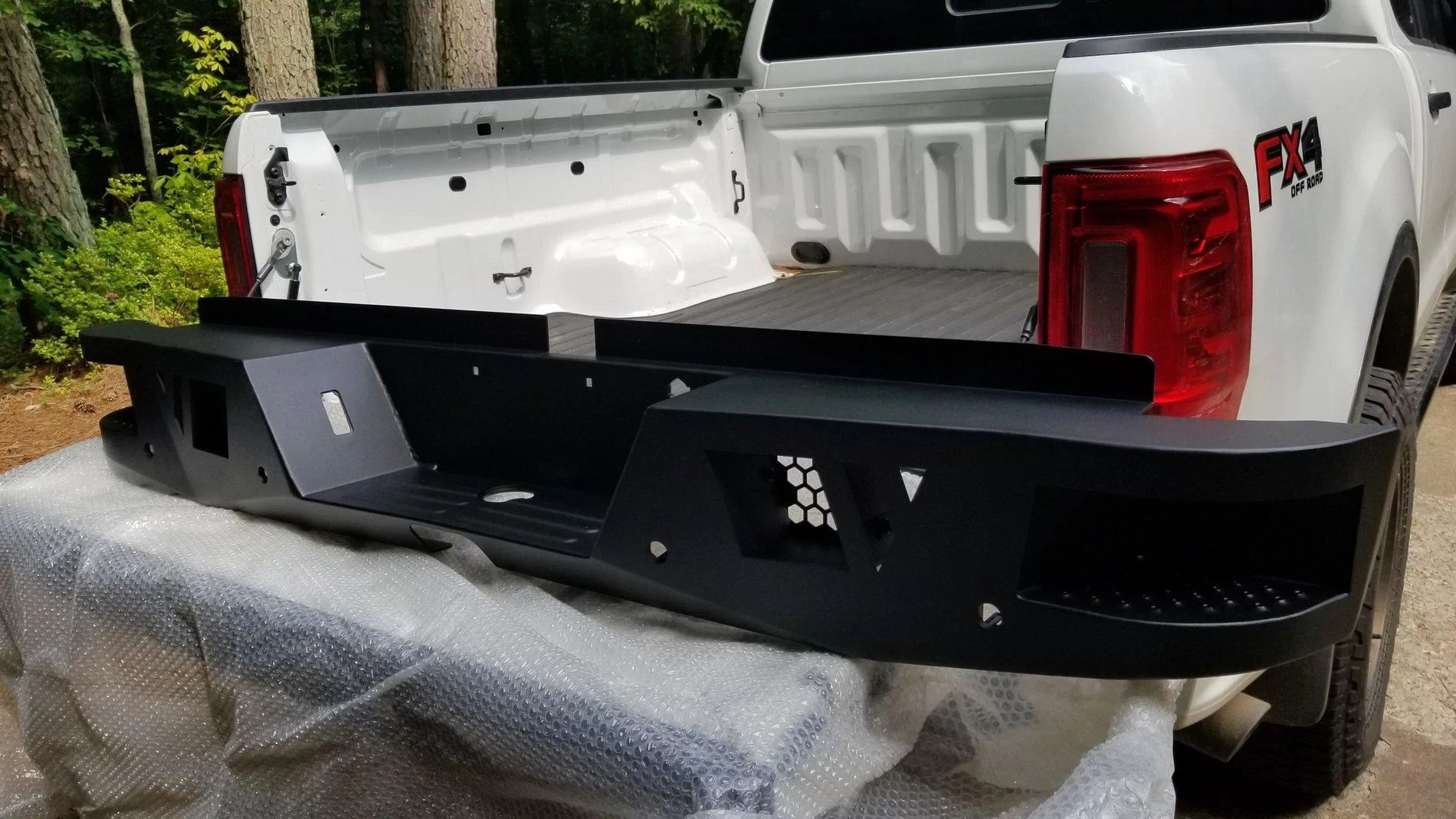

The UPS man left me a present
Nicely packed and much heavier duty than the factory bumper. And with STEPS! Also provision for rear LED cube lights.

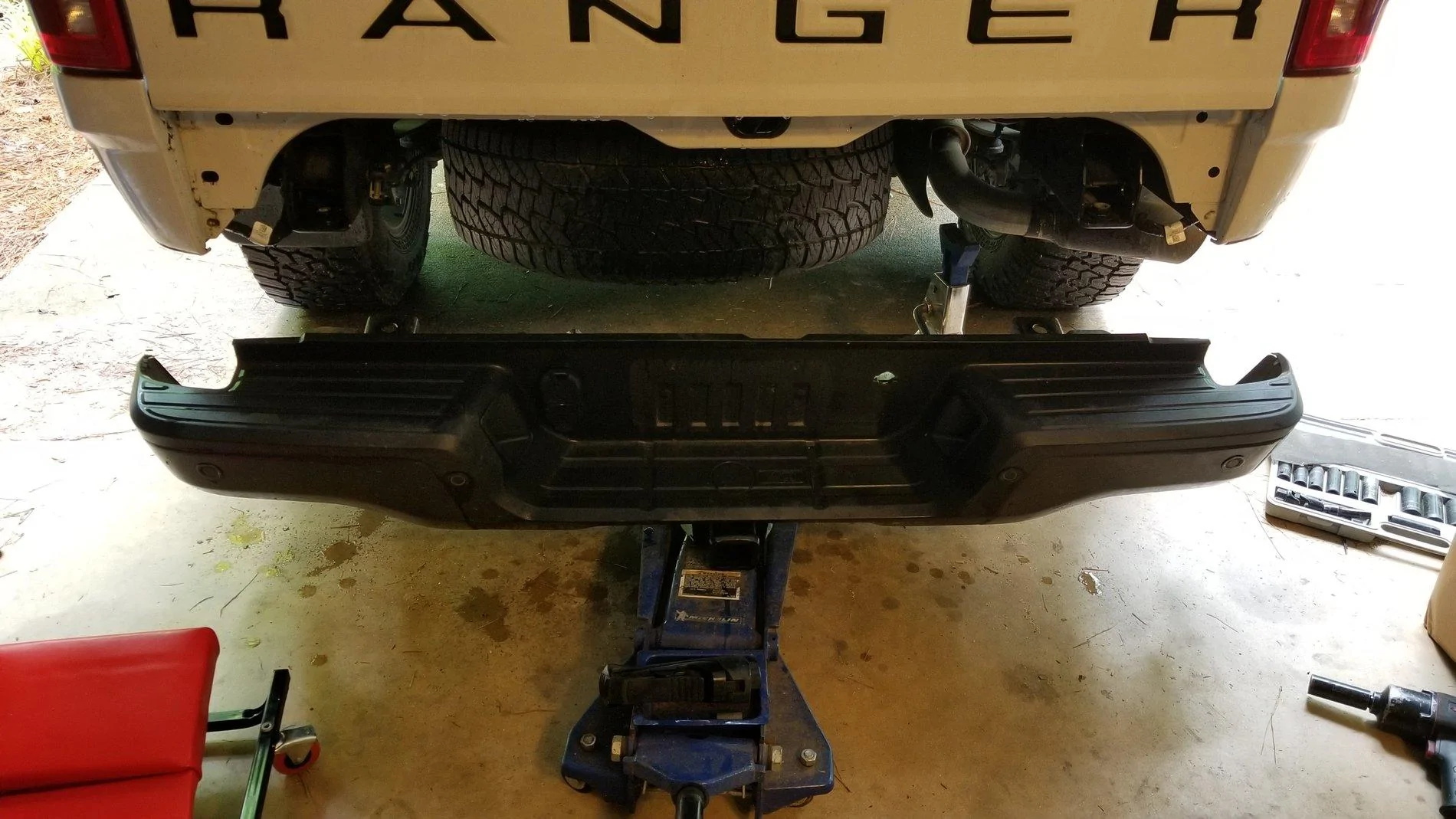

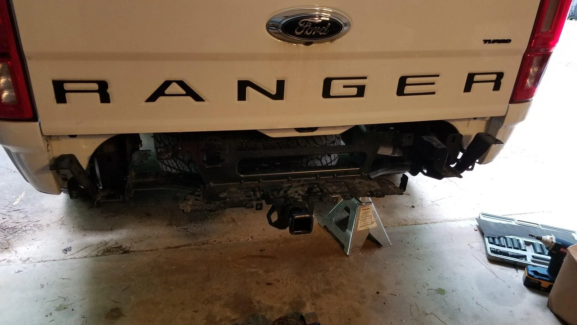

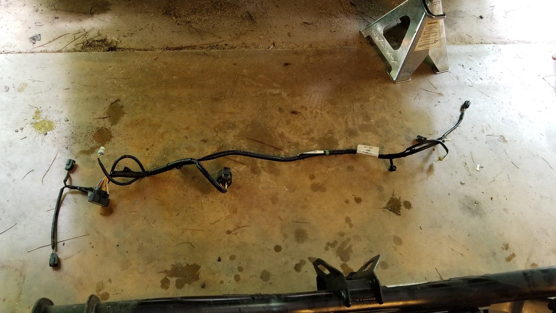

Out with the old. The entire rear bumper harness is on one connector. Disconnect it and pull the whole thing down.
Removing the harness and sensors from the old bumper is easy.

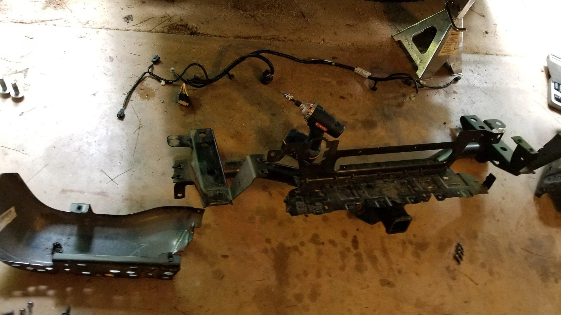

Now the (Un) fun part. Disassembling the factory bumper. It may be easier if you don't have the tow package, but mine does so you have to remove the plastic shell on the bumper to get to the steel frame underneath.
Frame reinstalled and ready for the new bumper

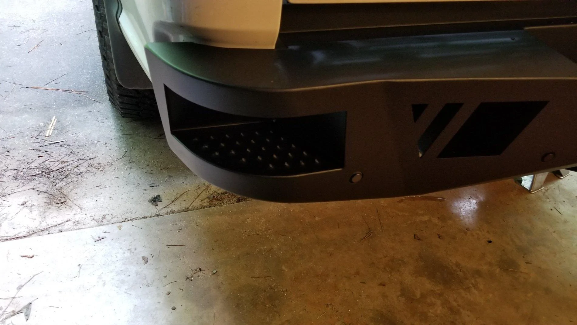

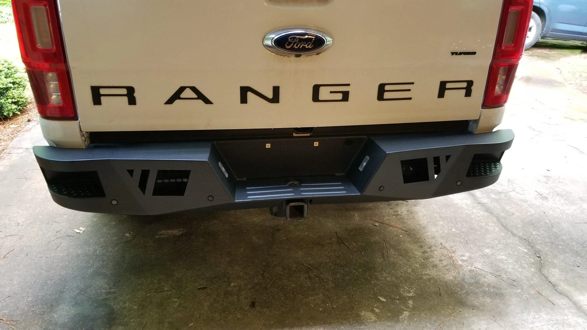

And here she is!
And those glorious steps
The first time I hopped up in the bed with them, my immediate thought was "Worth it!"
It's currently sitting at the bottom of the slots so I still have to adjust it up a bit but adjustment is easy.
I'm pleased with it overall.
The only thing I don't care for is that the images showed the trailer connector in the stock location, but the bumper actually mounts it down next to the receiver hitch.
There is room for the cutout and I have a buddy with a plasma cutter so that will eventually be rectified.

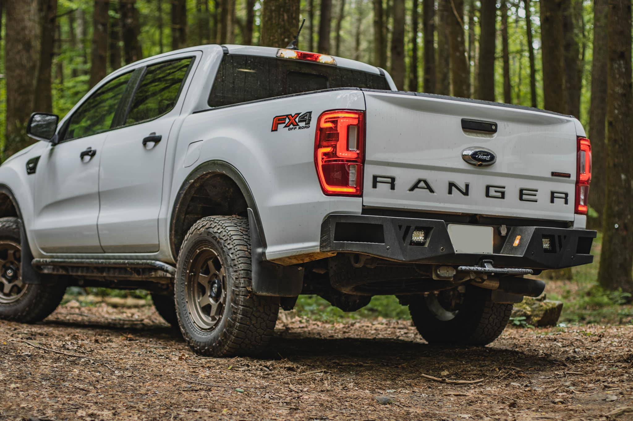

Edit: This thread has popped up again lately so I decided to add a picture of it after 3+ years on the truck. Pic is from a trail ride last fall.

So, almost 4 years later...
Still looks like brand new, Very heavy duty, and still loving the corner steps.
Edit: Here's the roughly 4 years later pic.

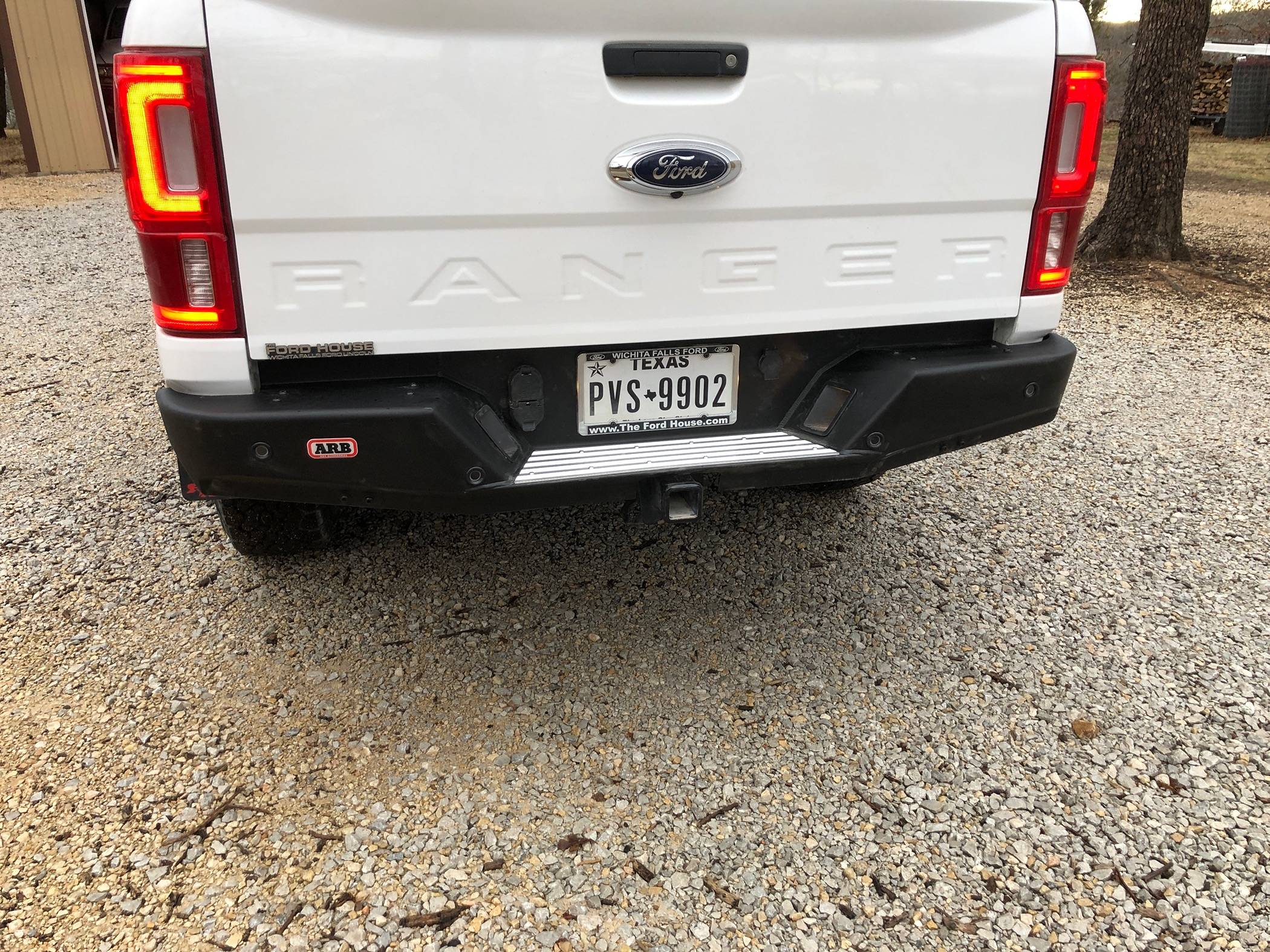

You might look at the ARB bumper, I put one on after a valet parking attendant gifted me with the right rear pushed in just barely touching the body. It seem like it was around $500 bucks. The only drawback I had was trying to get a pin in the trailer hitch, I had to cut away a little metal, but not a big deal.
Do you have any pictures?

Any chance of any photos of how the ends match up with the fenders? Do they mirror the side of the fender or stick out?
Thanks!
Thanks!
bryan
It sticks out past the edge by about 1/2 inch.
