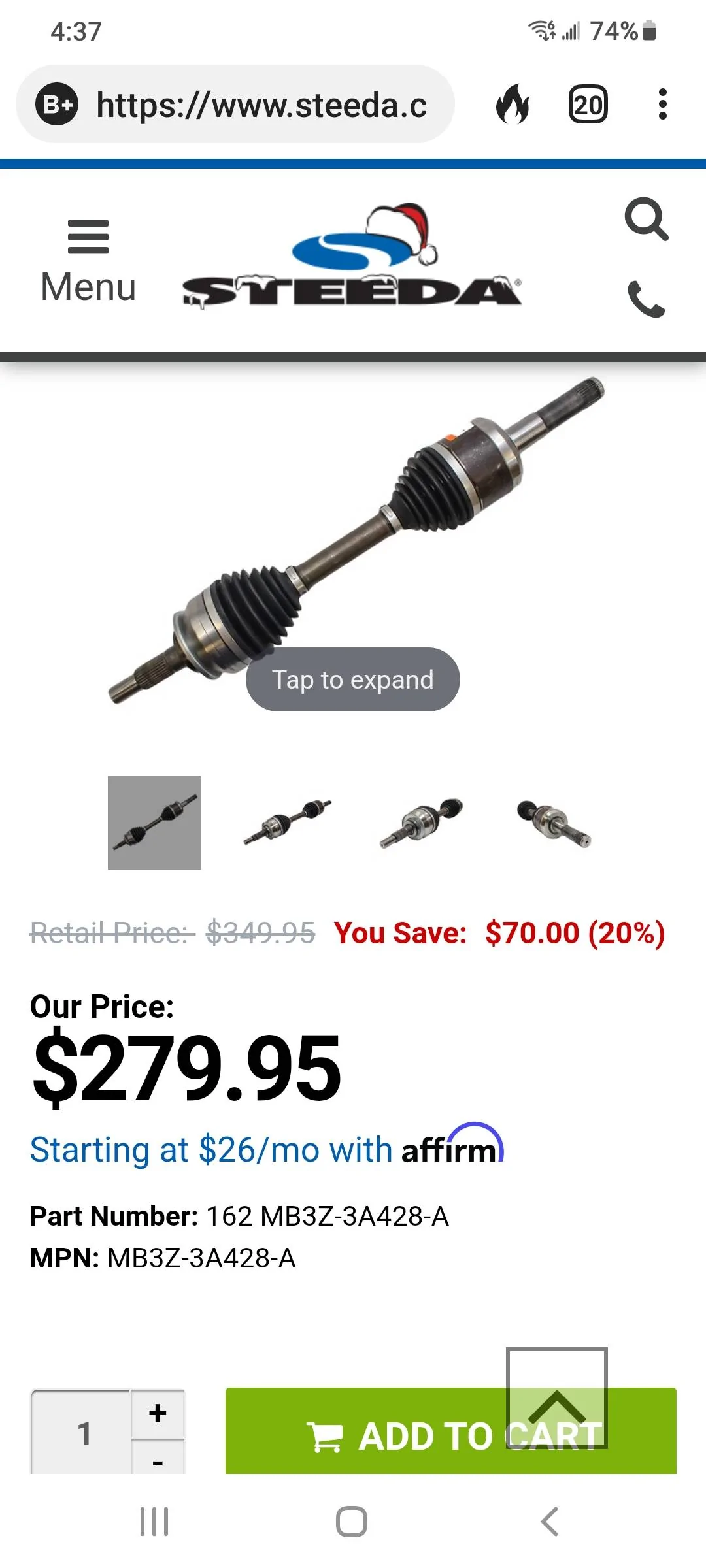

Steeda has best prices.

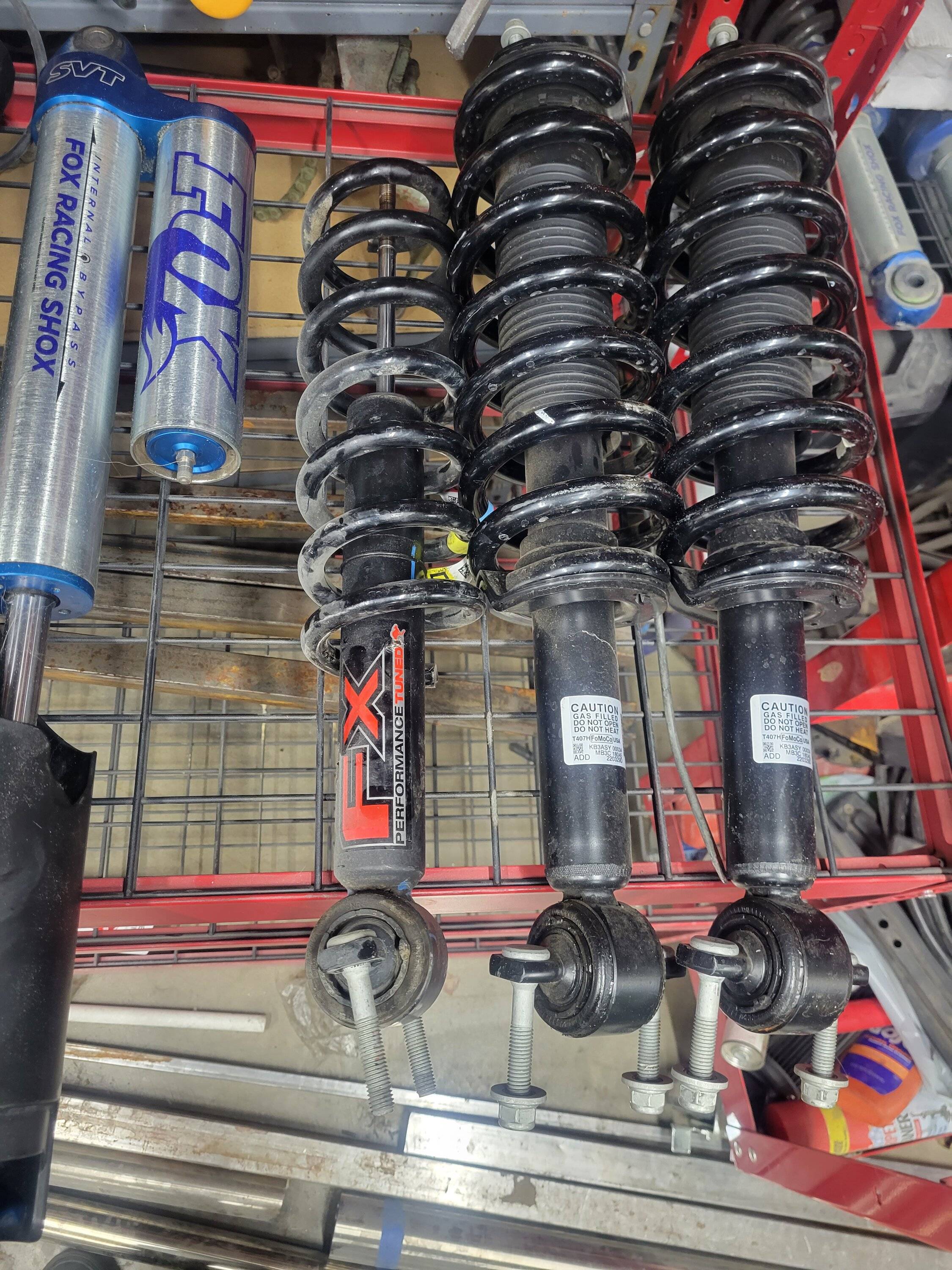

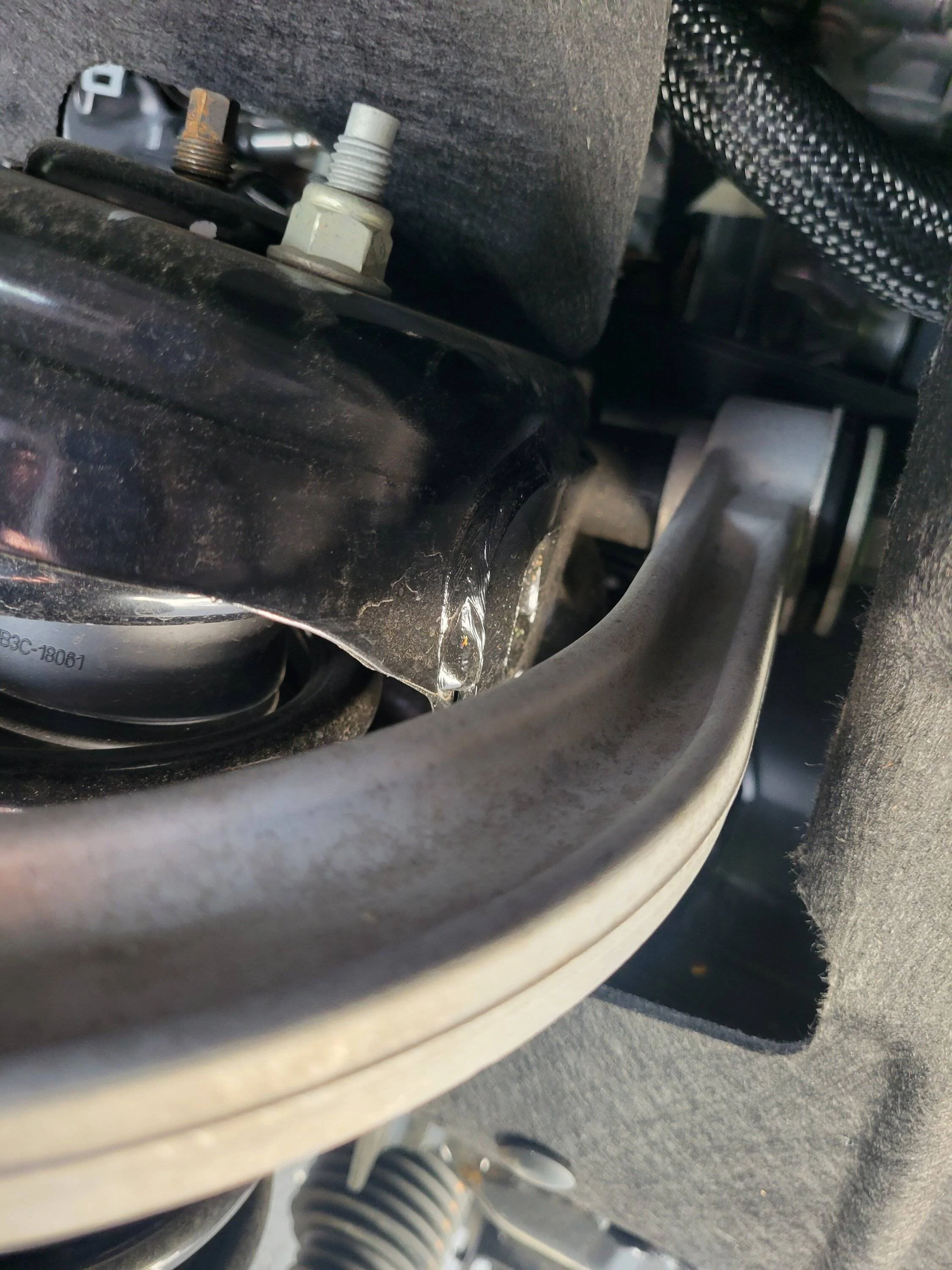

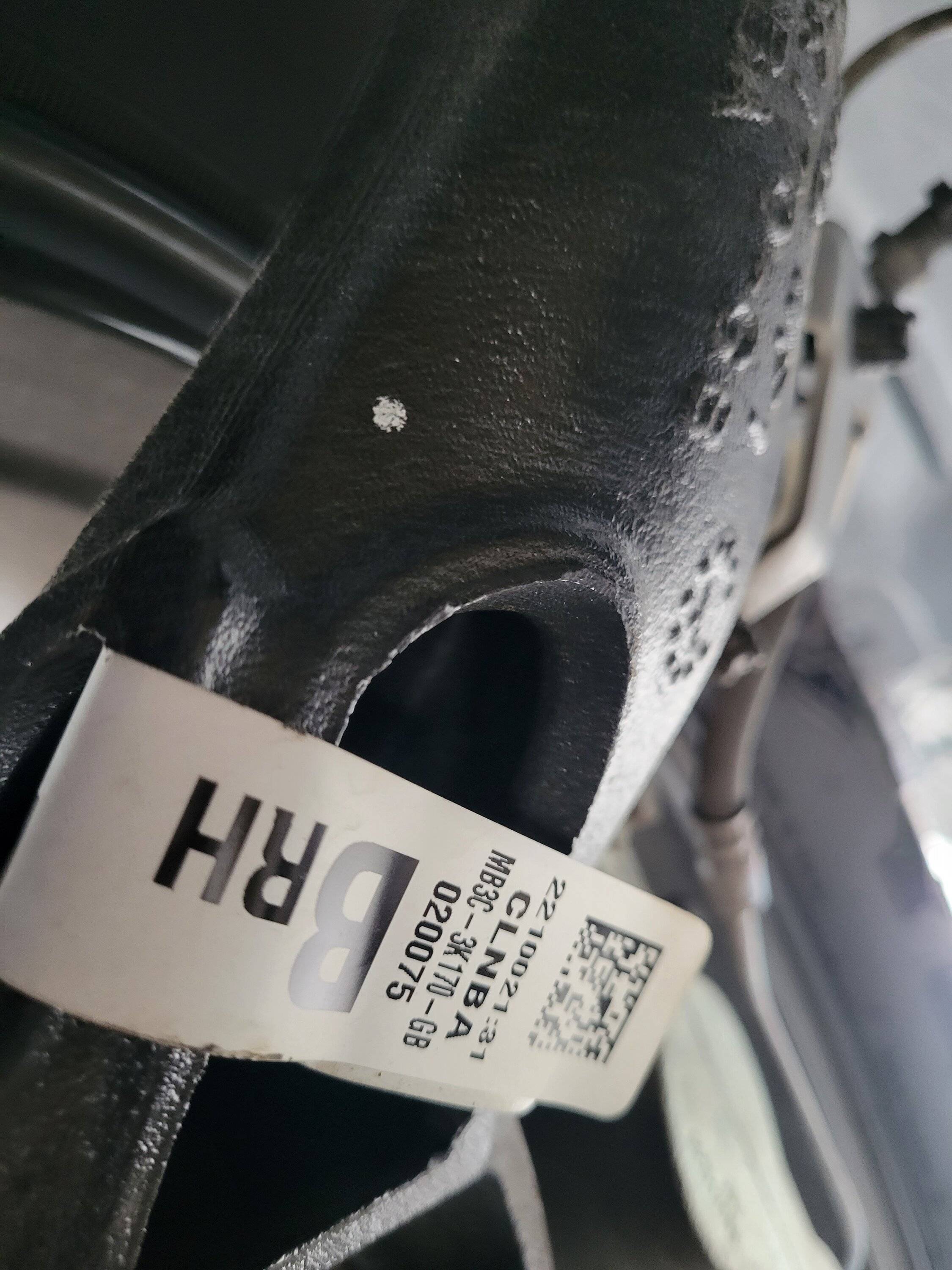

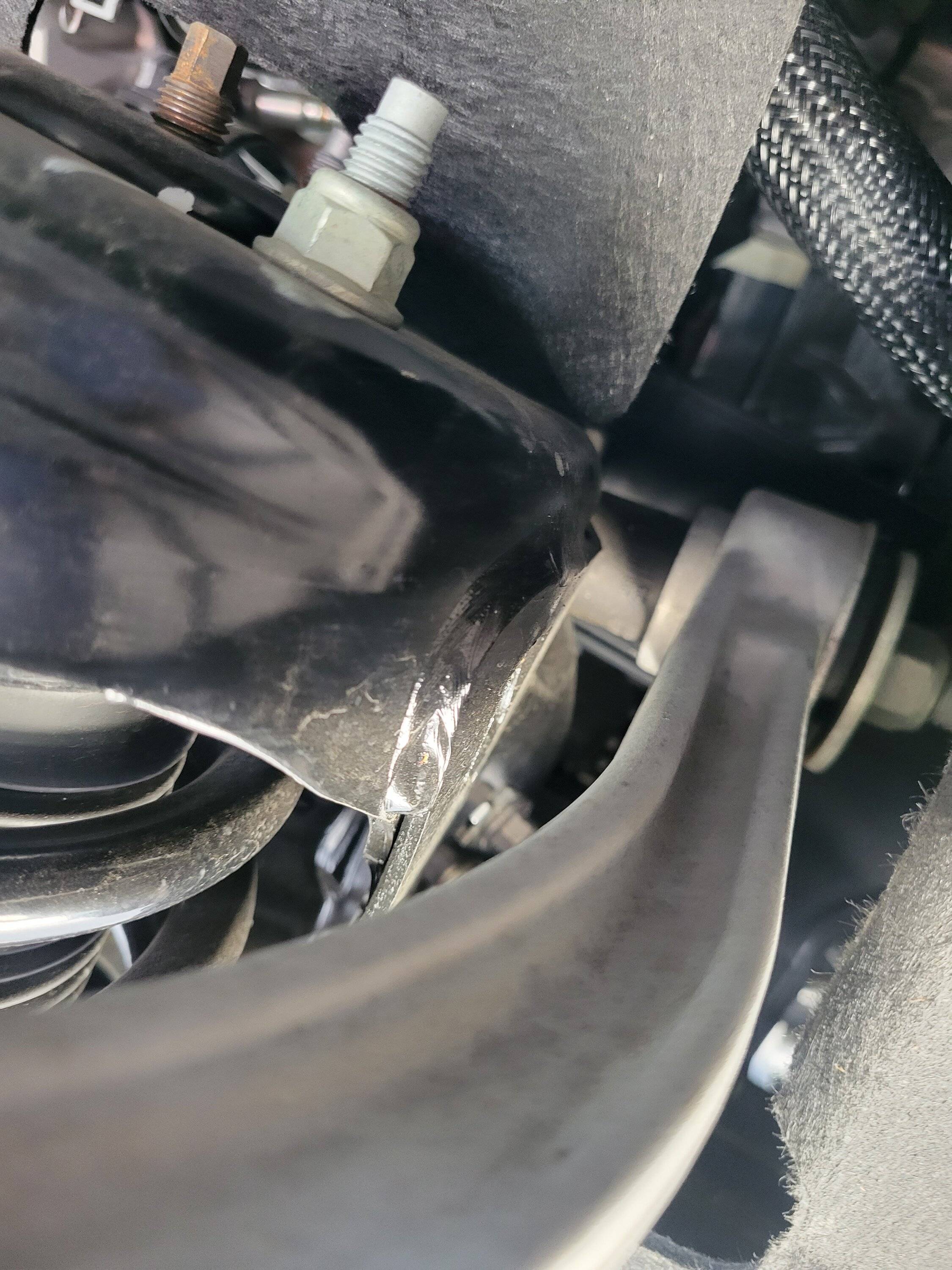

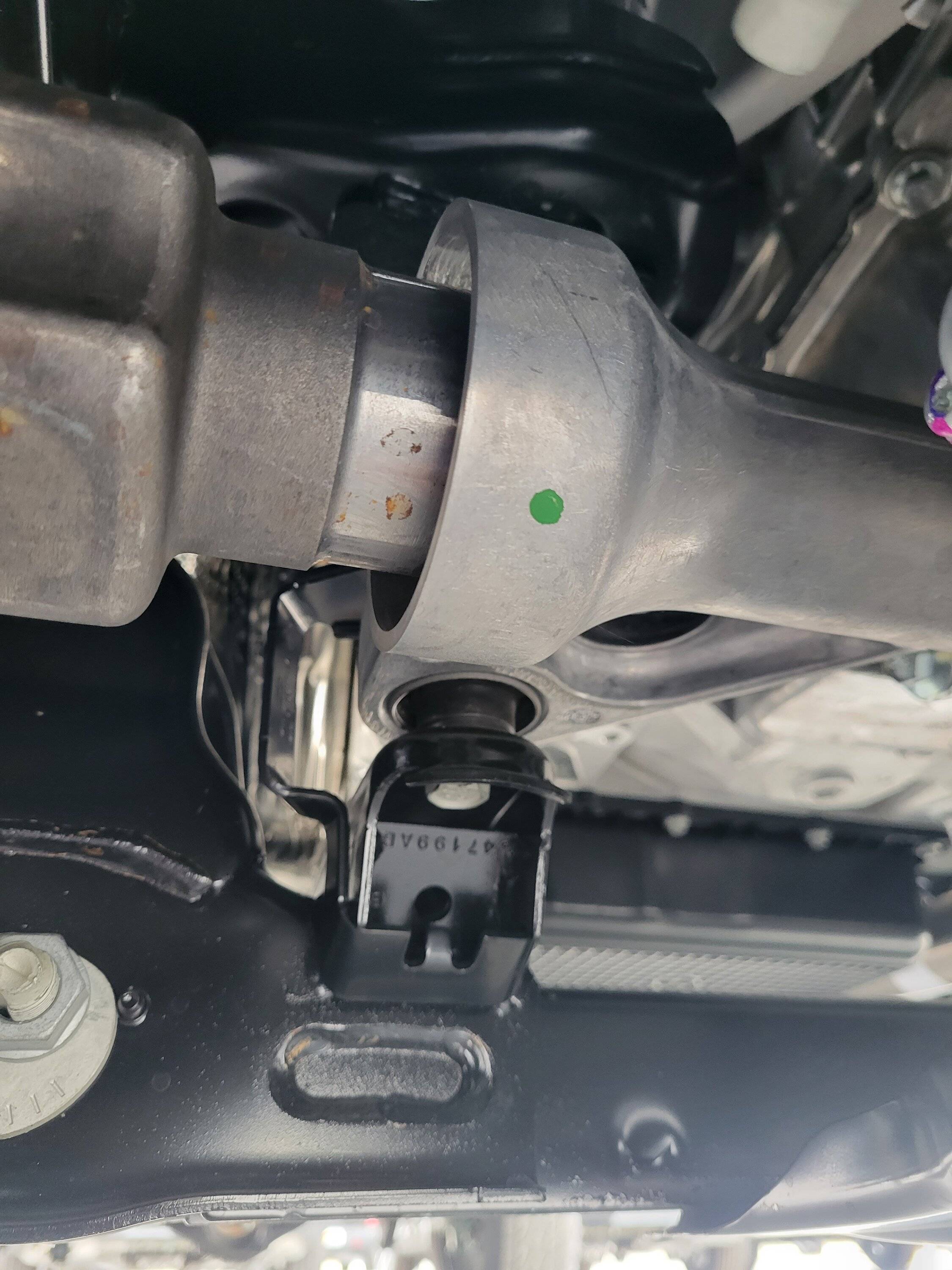

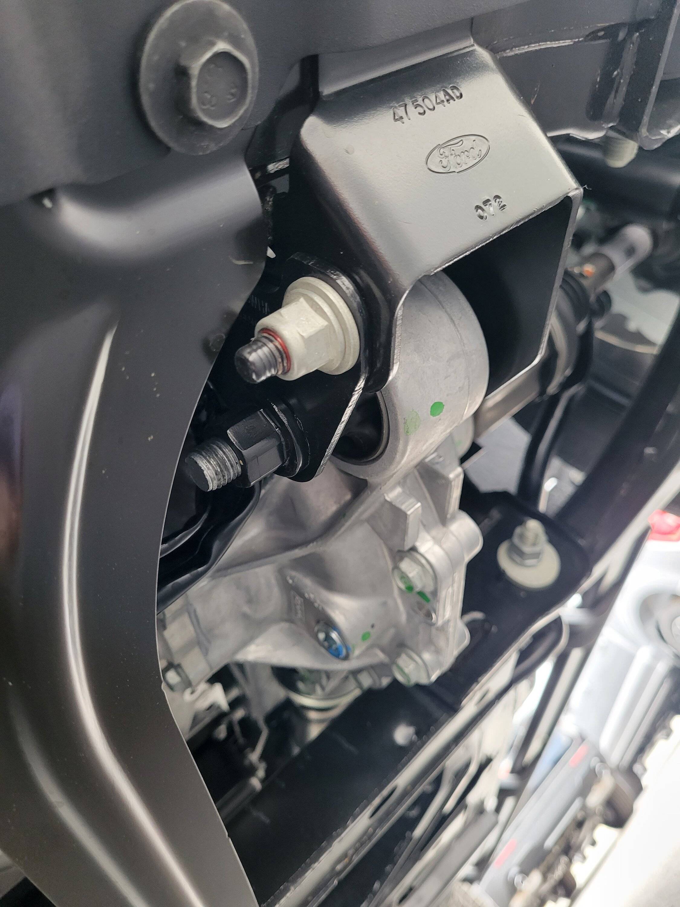

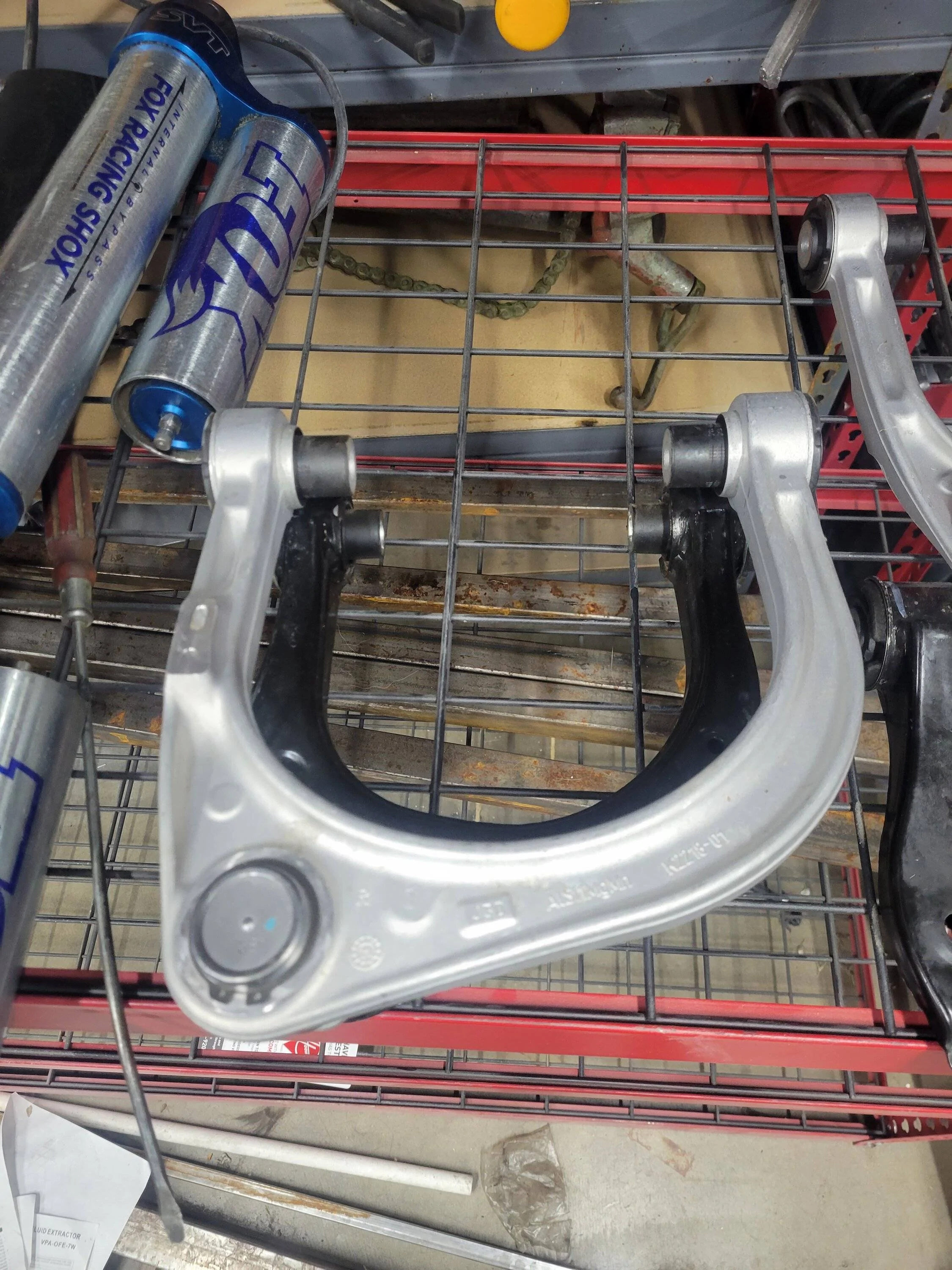

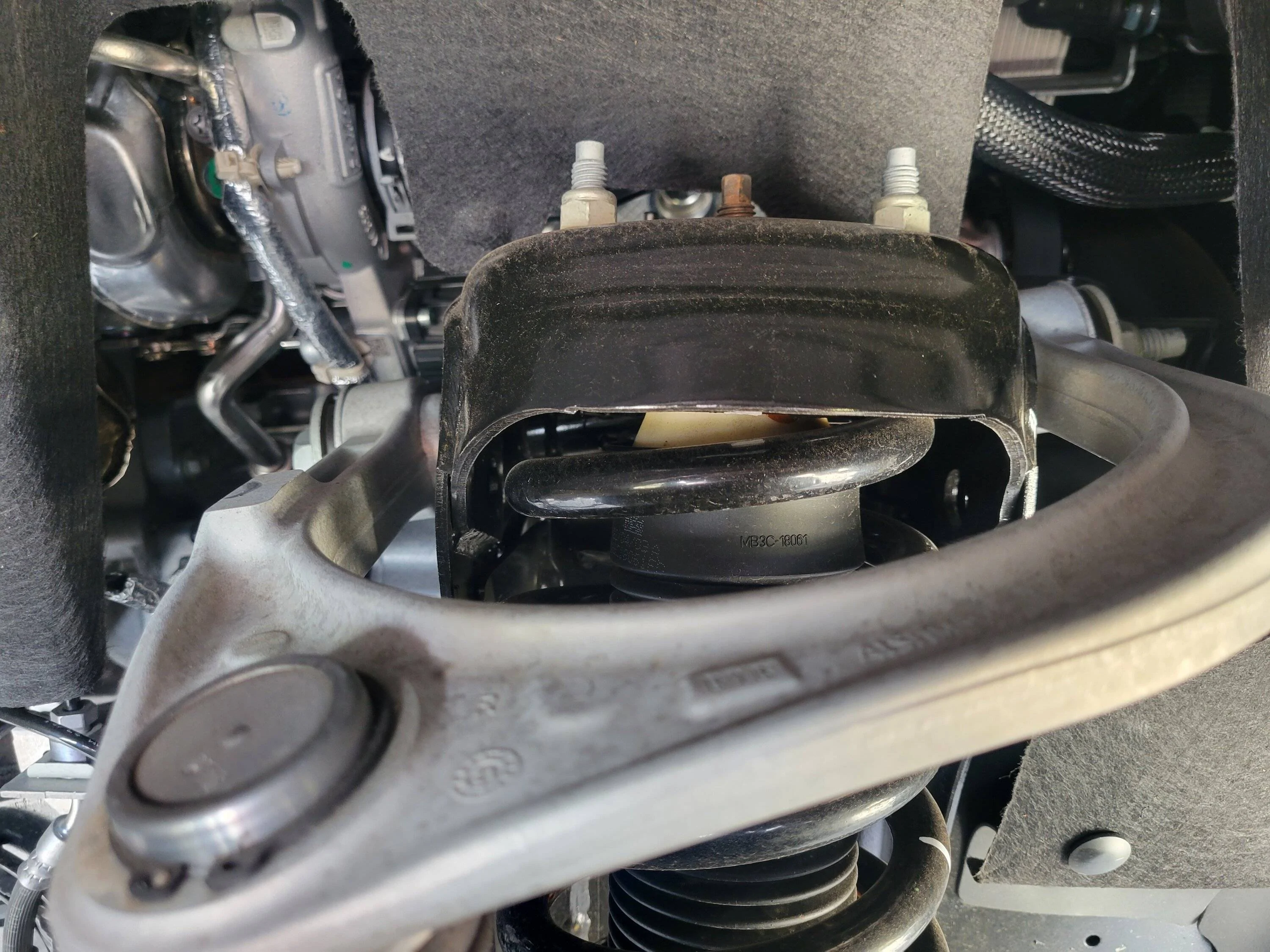

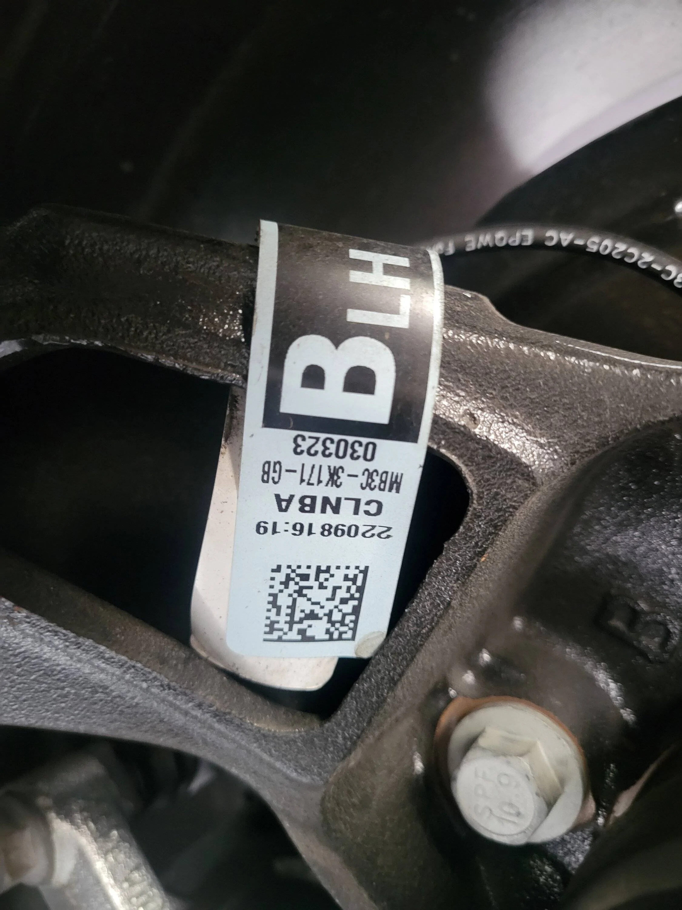

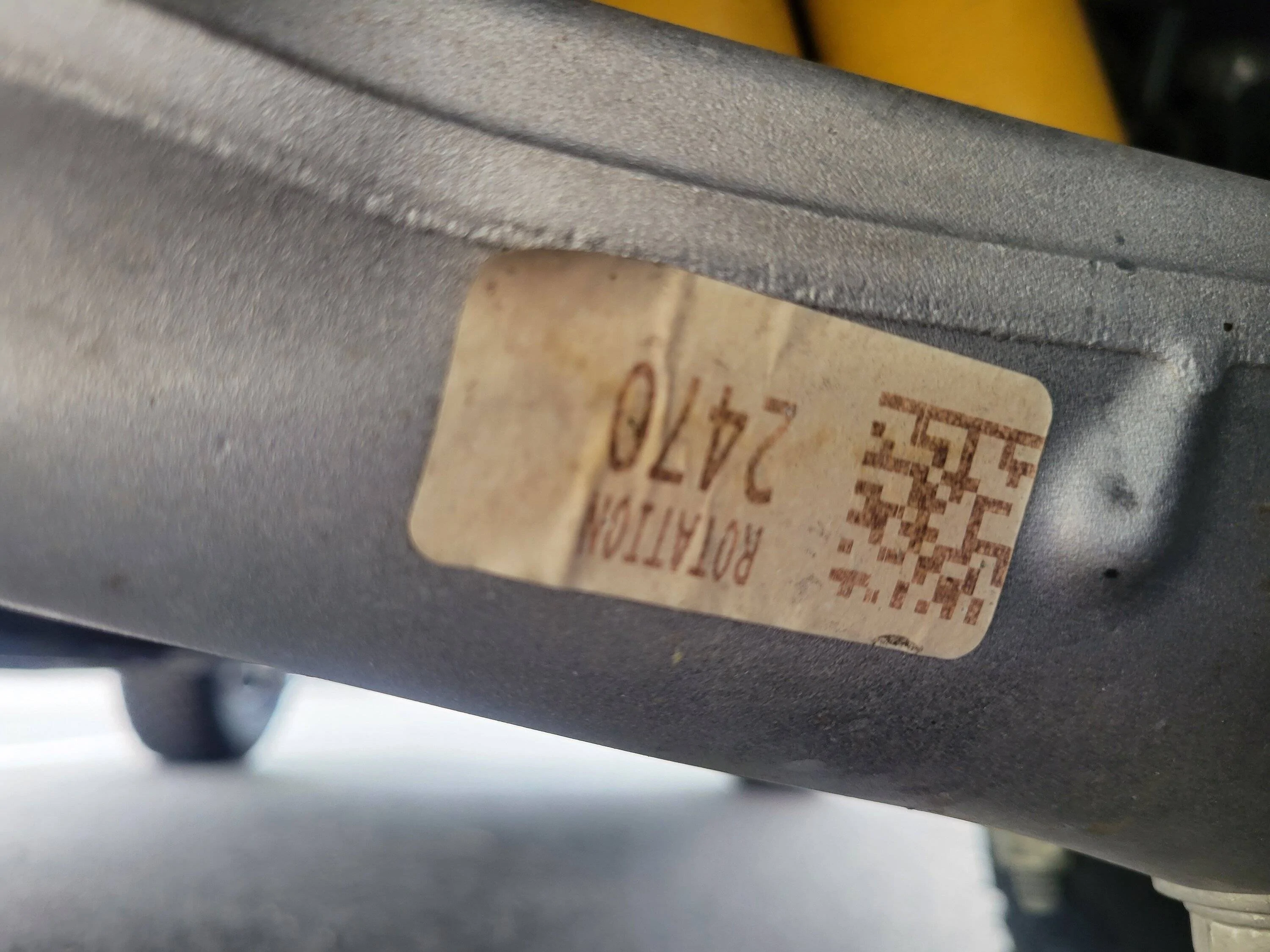

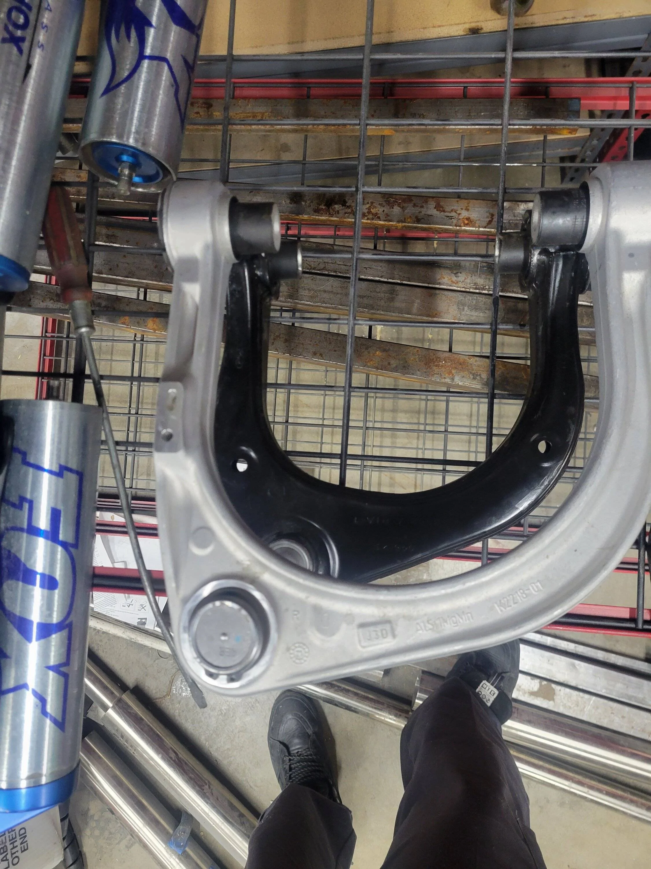

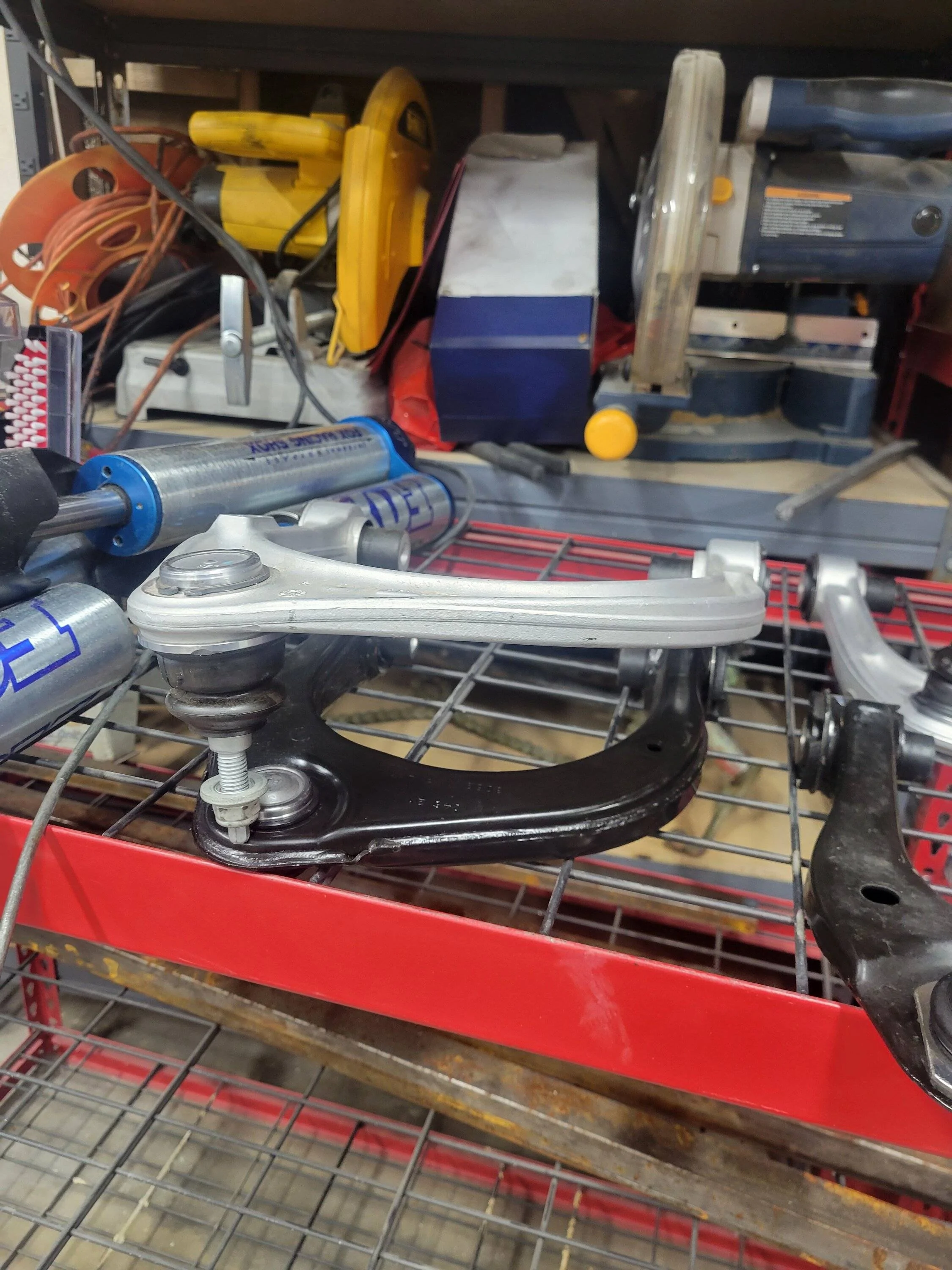

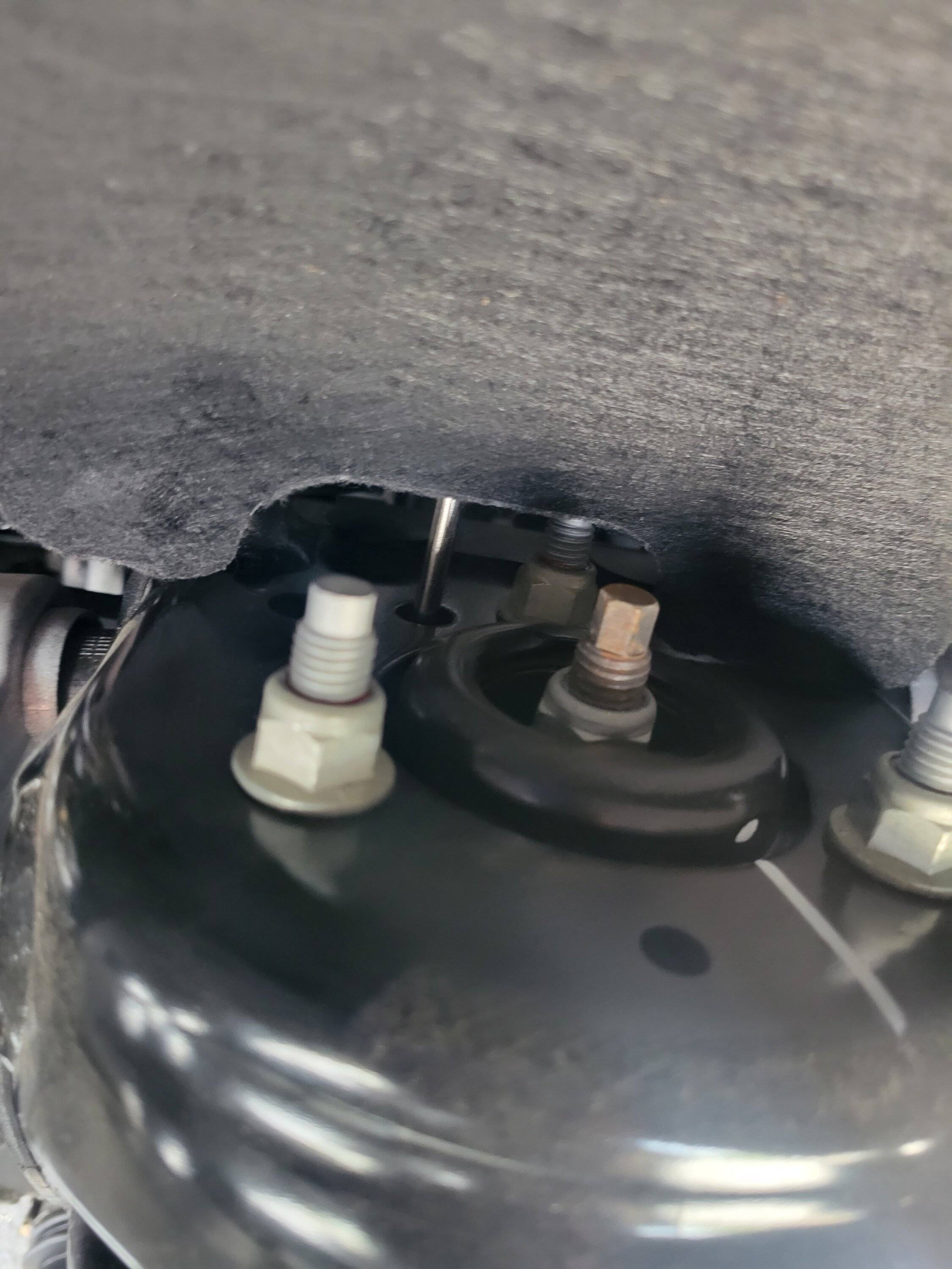

Welp got upper control arms they are 1 inch longer and I've stated mount in same location. When I measured out the lower control arm they were same mounting location, but they were 1 inch longer, mounting location of the m210 is same as m190. Shocks even will mount similar except they locate 2 inches higher. Pretty much if you look where the top hat ends on ours the bronco sits flush with control arm unlike the ranger where the top hat is below the control arms. So yes the m210 is a viable option to do a locker, with gears, and a longer amount of travel

sorry I've been watching bronco6g forums for this. I guess they're having issues themselves swapping from m190 to the m210 do to pcm issues and only work around so far is leaving the passenger side axle tube intact with sensor staying intact or pcm deactivates 4x4. They stated that they've spoken to ford in regards to this. ford stated that they are working on a fix since that was one of broncos selling points that you can slowly upgrade whatever you wanted to just using off shelf parts. Also would seem that if not going with a m210 option a easy swap for a regeared assembly would be to pick up a Bronco m190 carrier theyre about 500 bucks and can reuse many parts and wouldn't require fabrication of any sorts.

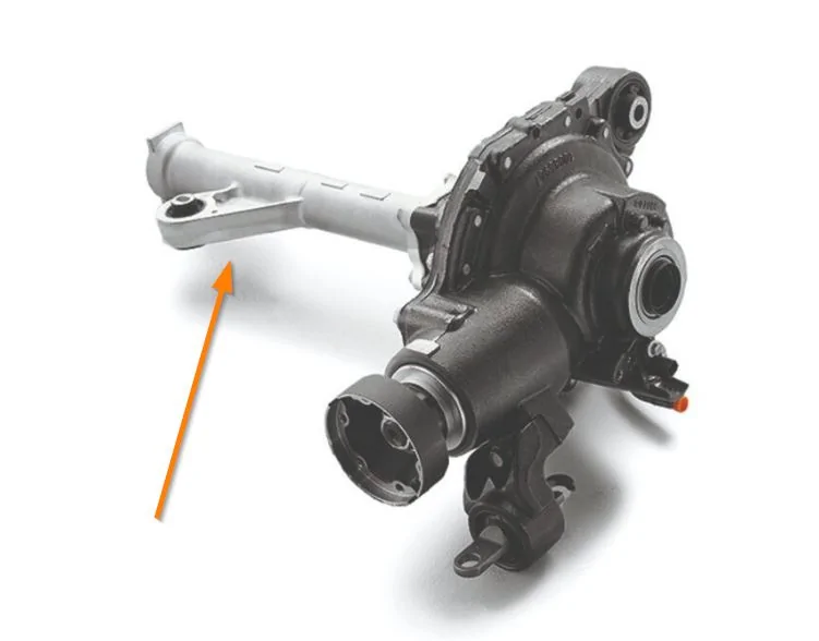

I have been watching the FDU from Dana pretty closely and they say this mount needs to be rotated 180 for the Ranger. Has anyone actually taken a M190/210 from the Bronco and tried to mount it up? Dana actually makes their mount rotatable for this reason. I'd love to buy a M190/210 from someone doing the FDU upgrade and just use OE hardware with better gears.

Everything I've read on pirateoffroad forum, bronco5g forum and just some general digging through manuals its the same as long as it doesn't have the fdu. The dana one is pretty much a stock m210 with bigger stronger case and direct swap for both ranger and bronco. Now if you don't care so much to going into a m210 which is like a 8.8 vs the 7.5 we have then just go to ford direct parts and get a carries off a base bronco with m190 in the gear set that are available theyre like 560 remove and use your old tube by doing so you'll save like 600 dollars. I believe the largest m190 gear you can get is 4.27

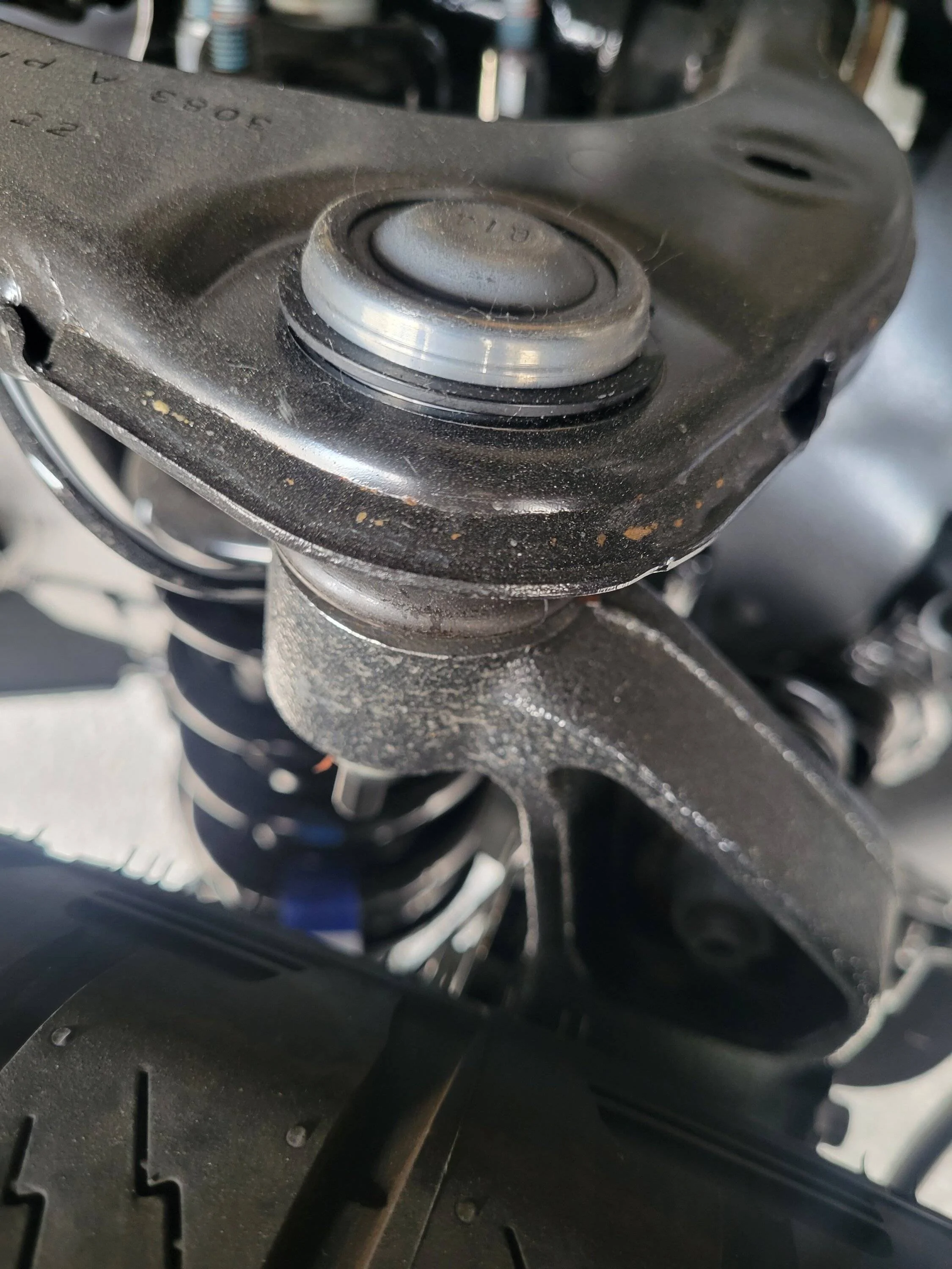

Has anybody done the control arm swap yet? It seems like the best option for my 2019 FX4. I don't really need the stronger front dif though, will probably just buy lengthened axles. Most aftermarket UCAs seem to be sold with different ball-joints depending on aluminum or iron knuckles. It looks like the pics show an iron knuckle on the Bronco. So I'm quite curious if the ball-joints can just be swapped for an aluminum knuckle Ranger.
