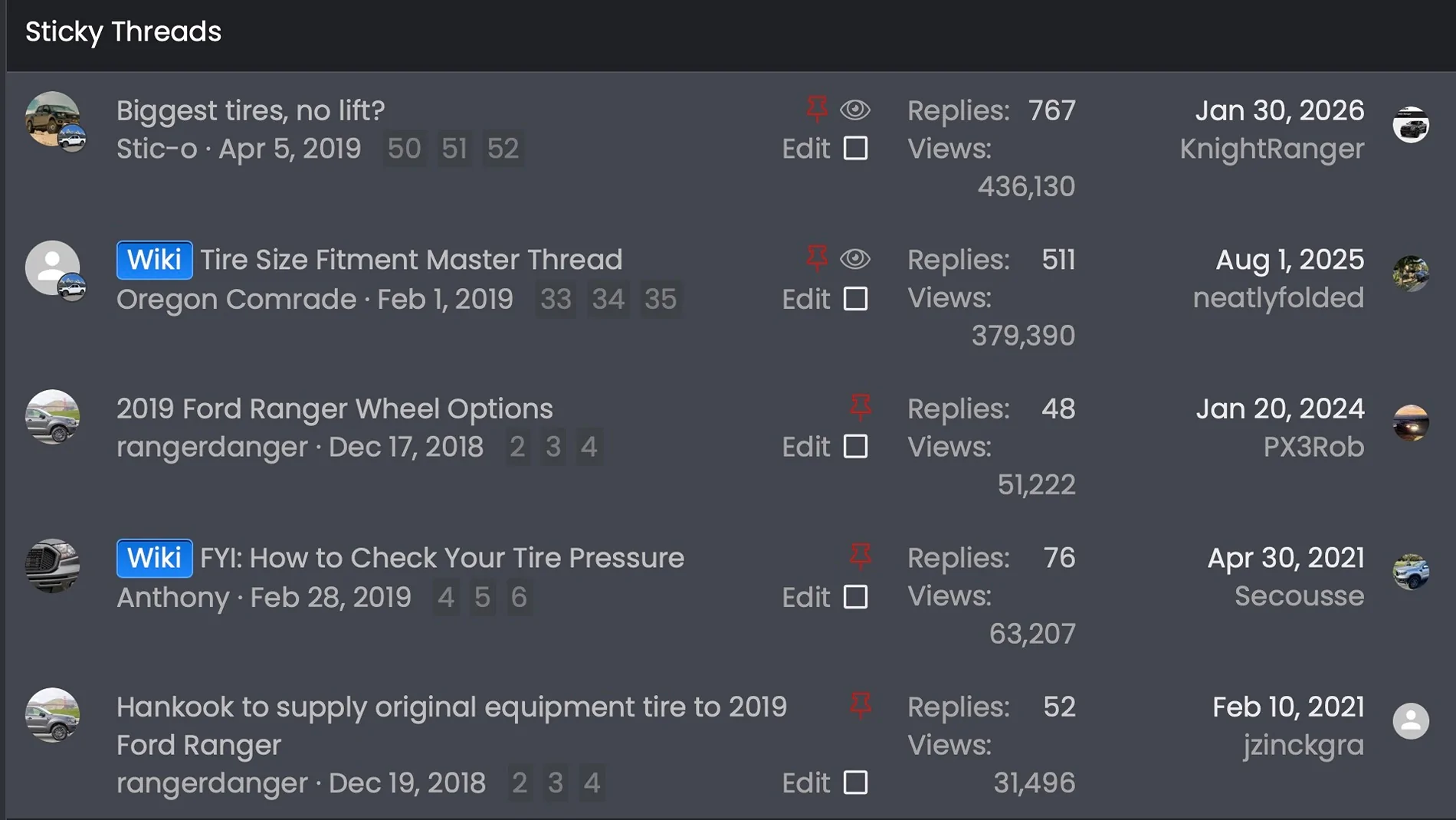

We should just keep a link to a "what tires can I use post" and paste and be done with it?

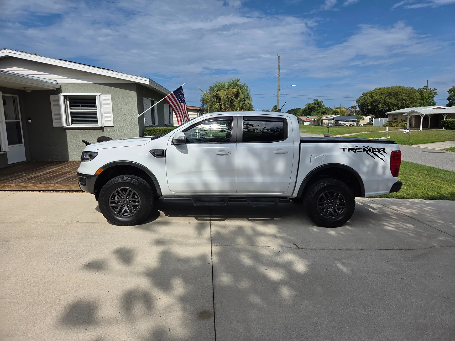

I have 285/75/17 No Spacers, I still have my Crash bars 3 1/2 inch Rough Country lift, I rub a little on the plastic Air Damn when I am backing up as you can see in the first picture, I had 285/70 on before ...
137,185
We do. lol :wink:
There's a couple threads in the Sticky section at the top of the Tire, Wheels & Brakes section. I guess no one looks there anymore.
