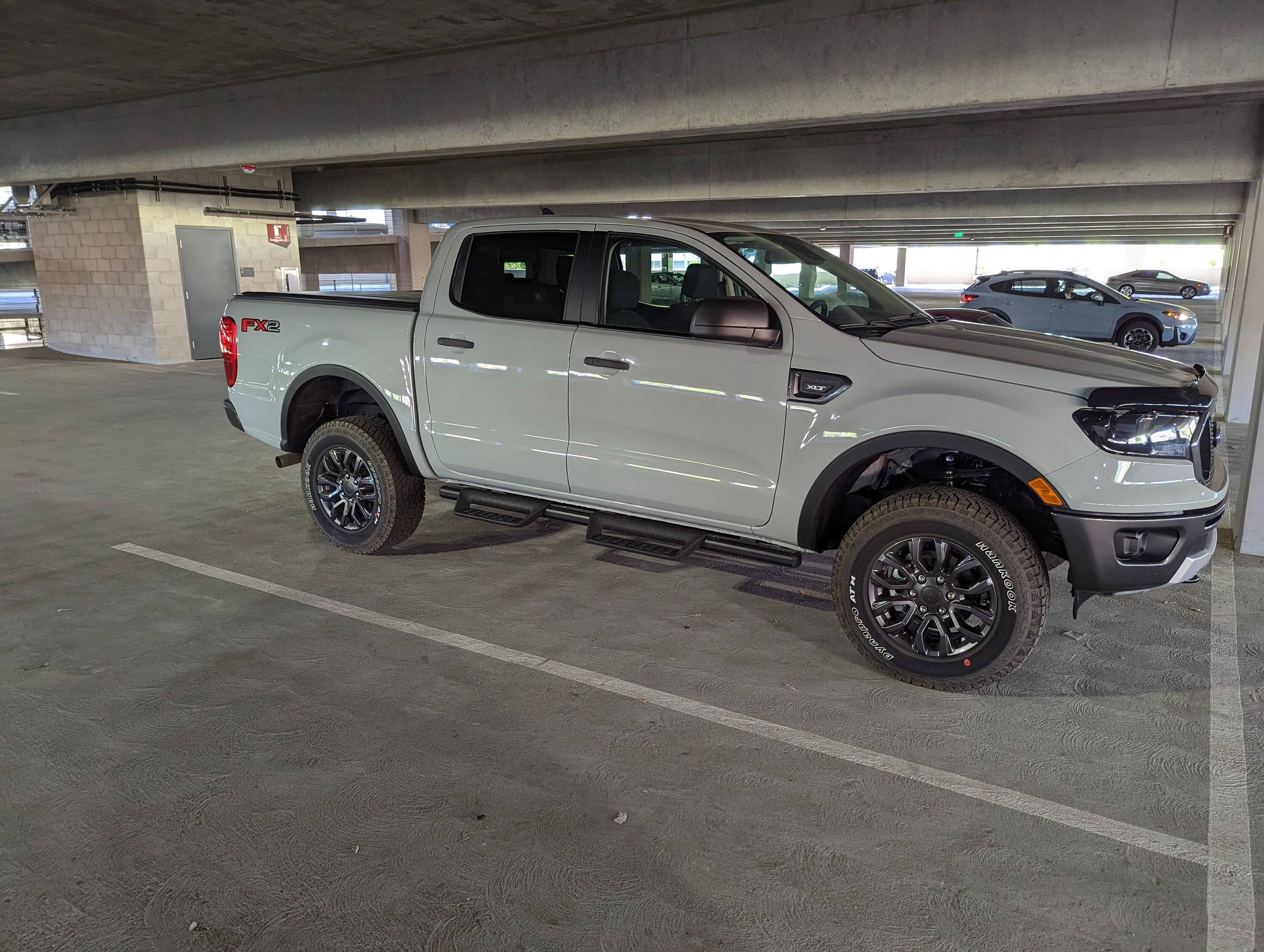

Installed mine today, went with the 1.2 in front did them first turned the truck around to do the rears and thought nice stance. Did the rears then looked again and well the rake is back. I wanted some rake, but was hoping for about an inch and 1/4 got about 2 and a half. Not going to go through the hassle to change the setting. Hopefully it will settle some in the rear. But will say the ride is much improved!

hmmm something sounds off there.
I did fronts at 1.8 and the rears. I have about .5 inch of rake now.
is yours RWD or 4x4?

also where are you measuring for the rake?

Mine is a 4x4 and i didn't measure but I can in the morning, you can tell by looking at it the rear is up.

You can measure from ground to top of wheel well to see the difference and get an exact measurement.
My fronts are between 1/8 to 1/4 inch difference in height in each side, but it’s only noticeable when measuring.
Send a pic - there are several people with pictures on the site of theirs at 1.2 for comparison.

Measures 36.75-37 in the front and 38.5-38.75 in the rear after a 100mile trip. That measuring from the ground to the fender lip through the center of the wheel.

It does seem off. I would expect about 1 to 1.2 inches rake.
Are you sure you set the ring to 1.2? Any pictures by chance?
Did you add anything else to the rear for height?

My setup is the same as BettaRanga, 1.8'' 36.75 in front and a very slight rake remaining,
rears are 37.25 left side 37.75 right (i put some ballast weight to close the lean gap) so I'm now only left with a 1/2'' higher on right side.

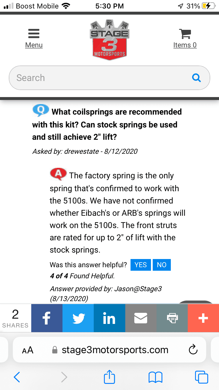

I just put mine on the front. I have Fox rears on. 22 SCrew FX4 tow pkg. On 1.8 mine was almost level on one side and within 1/2" on the other. Took them back out and went to 1.2 and now have an even 1 1/4" rake. With a quick camber gauge I got it close and it may have enough adjustment to do an alignment. On 1.8 I couldn't get the camber close. I ran into this on my Grand Cherokee. Bought 5100 and on 0" lift it raised the front 2". Went round and round with them with measurements, comparison pics, etc. Had to return them. I think their lift numbers are very generous.

The factory shocks have low gas pressure. The 5100 are a high pressure monotube and add around 50 lbs of spring rate per side. You can tell when you try to push the rod into them. They are stiff. In effect, you took 100lbs off the back end with the shocks and it raised up. That is how manufacturers add ride height on Z71 trucks for example. Throw on monotubes and it is like taking 200lbs off the truck and it raises up some.

Iā€˜m set at 1.2ā€œ and it appears youā€˜re about .5 to .75 higher in the rear than I am. I’m right at 38ā€ in the rear, or just under. I’m about the same as you in the front. (Disclaimer: I’m parked on gravel at the moment and can’t get an exact measurement.).
