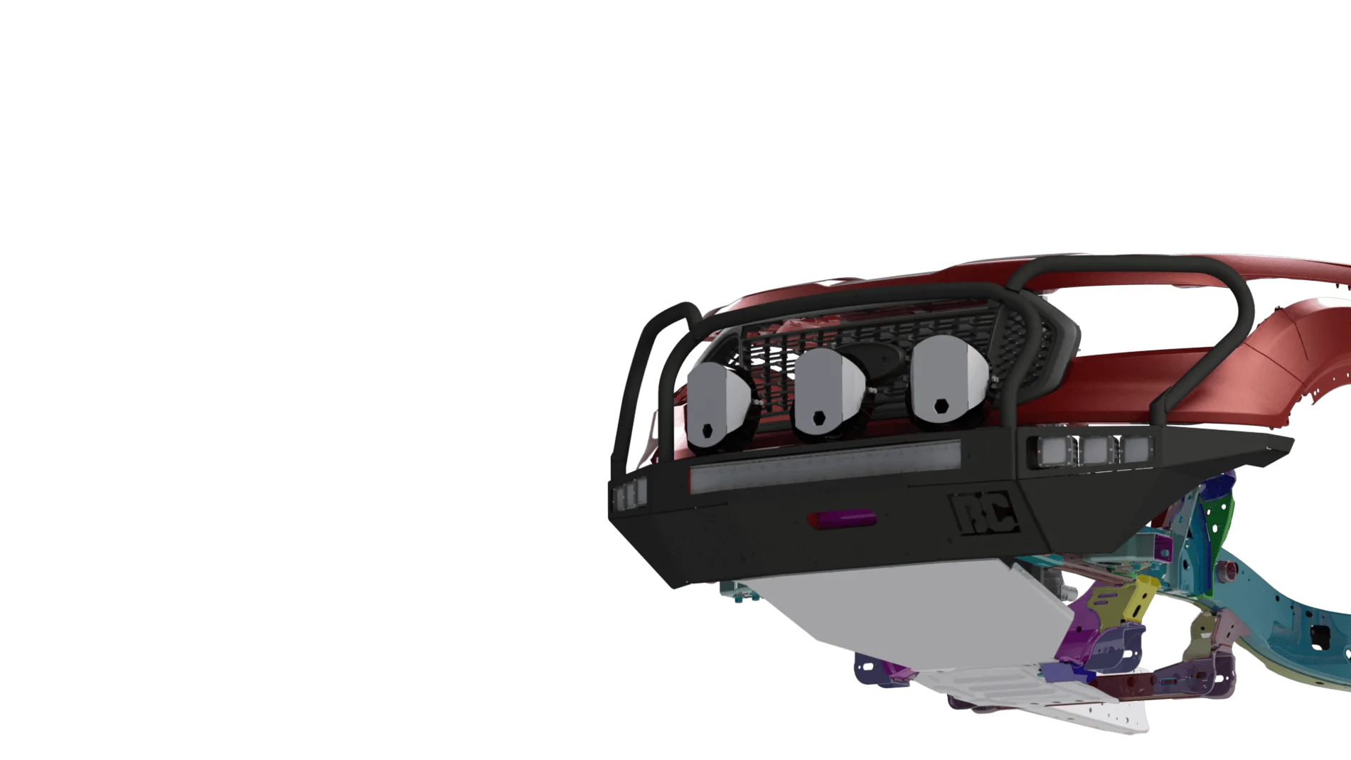

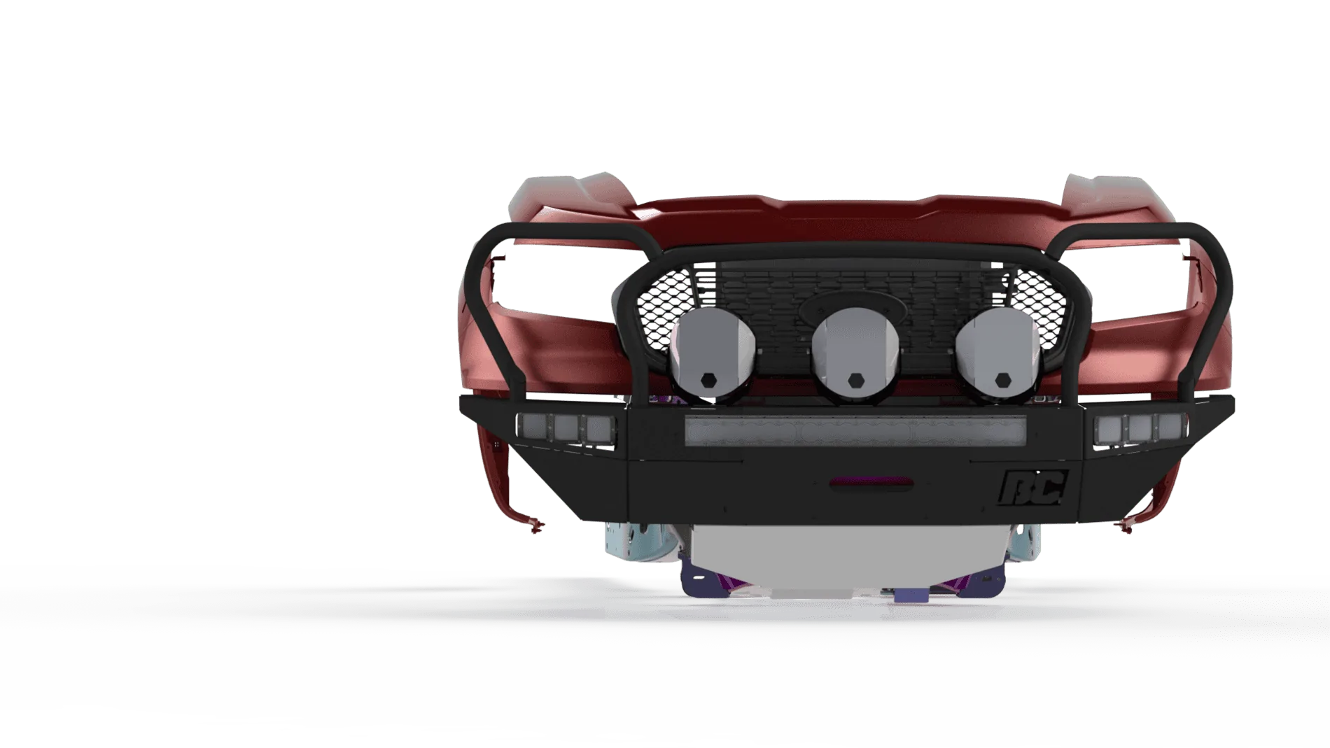

Doing a bunch more work this week, but the bumper design took the lead these past few days. It's getting there. The list of things I'm working on keeps continuing, but this is what the render on this looks like now. A couple more tweaks to make, then going to laser next week or two hopefully.
All modular, 3 piece lower with removable upper hoops, winch compatible, wire management tabs, trussed and gusseted, all following/shadowing the great body lines the truck already has not fighting them. Adventure Ranger Ready.

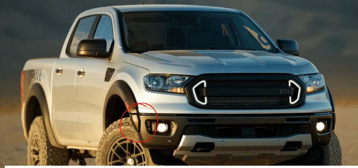

Cool bumper....looks slick! If you are planning on marketing/selling these, something worth considering (IMO) is flaring the sides out a bit beyond the body so the aftermarket/raptor fender flares will terminate in-line with the bumper. RTR has these "bumperettes" that do the job, but it would be cool to have a bumper that filled the void.

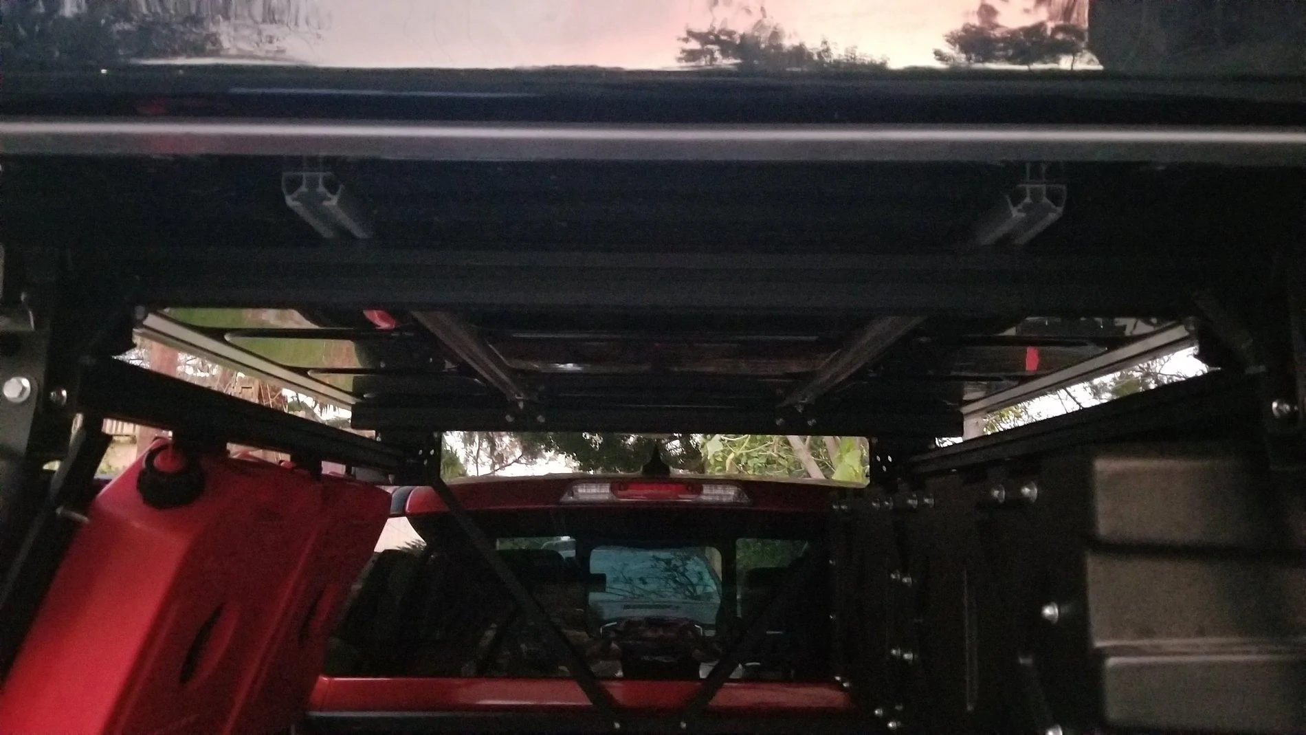

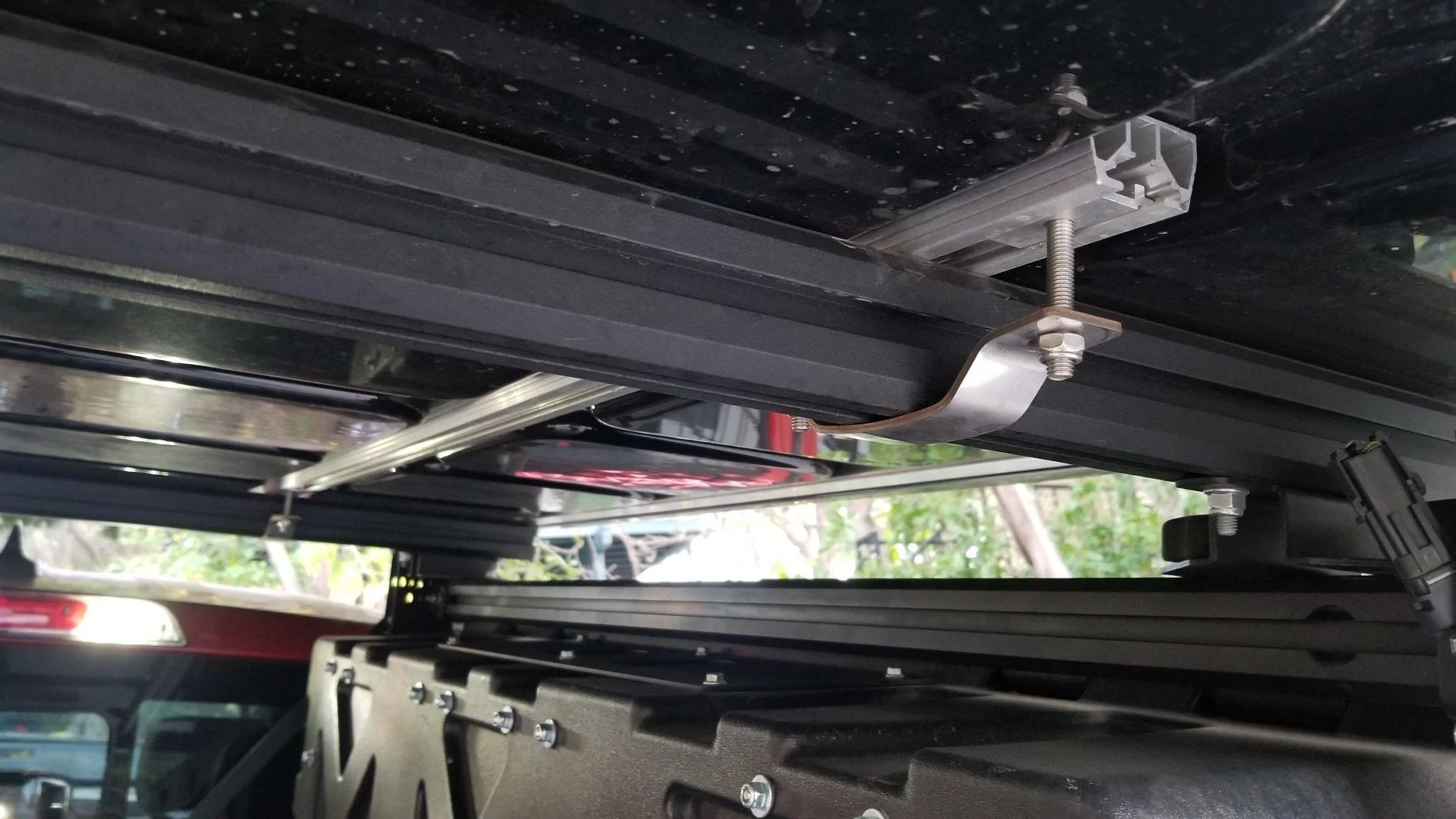

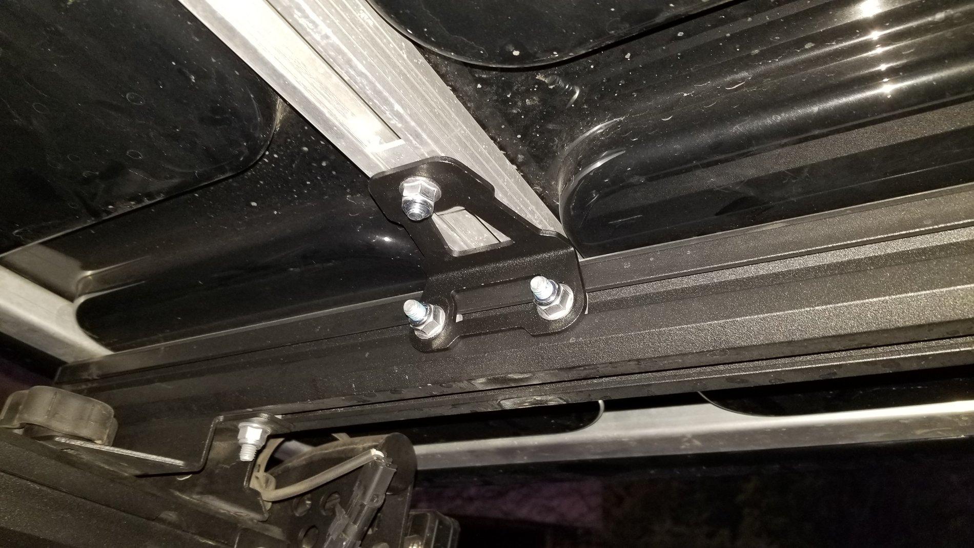

Cleaned up the RTT mounts so it looks a lot cleaner, is more secure with the higher quality brackets, and no more getting stabbed in the back by hanging bolts when I climb in the bed.
Before and after.

Awesome thanks. Yeah I've been looking into it maybe as an addition so people who run stock fenders like me can have it fit flush then have an attachment that extends to match a flared width. I've got a friend with the ADV glass so I'm going to measure hers for the additional piece.
Still a few tweaks to make but I'm excited, not a lot of good options out there at the moment IMHO.
