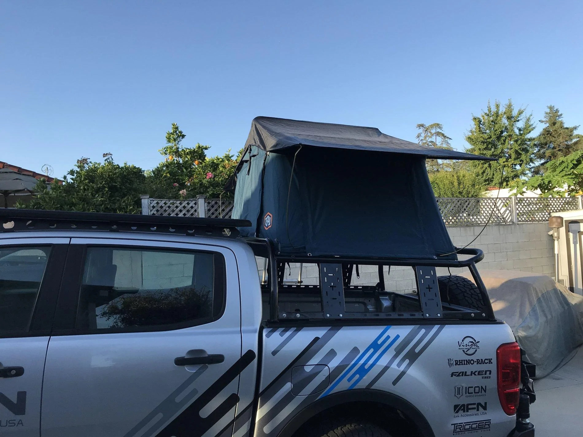

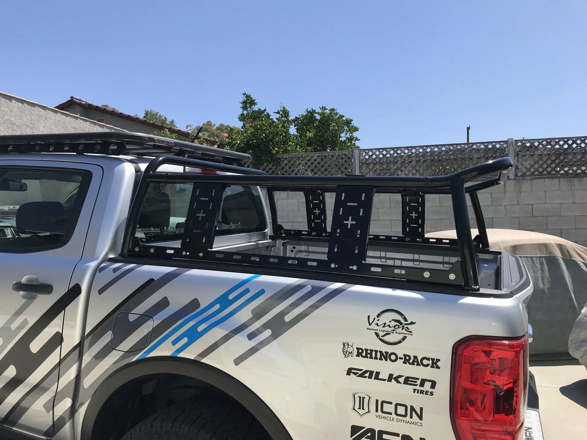

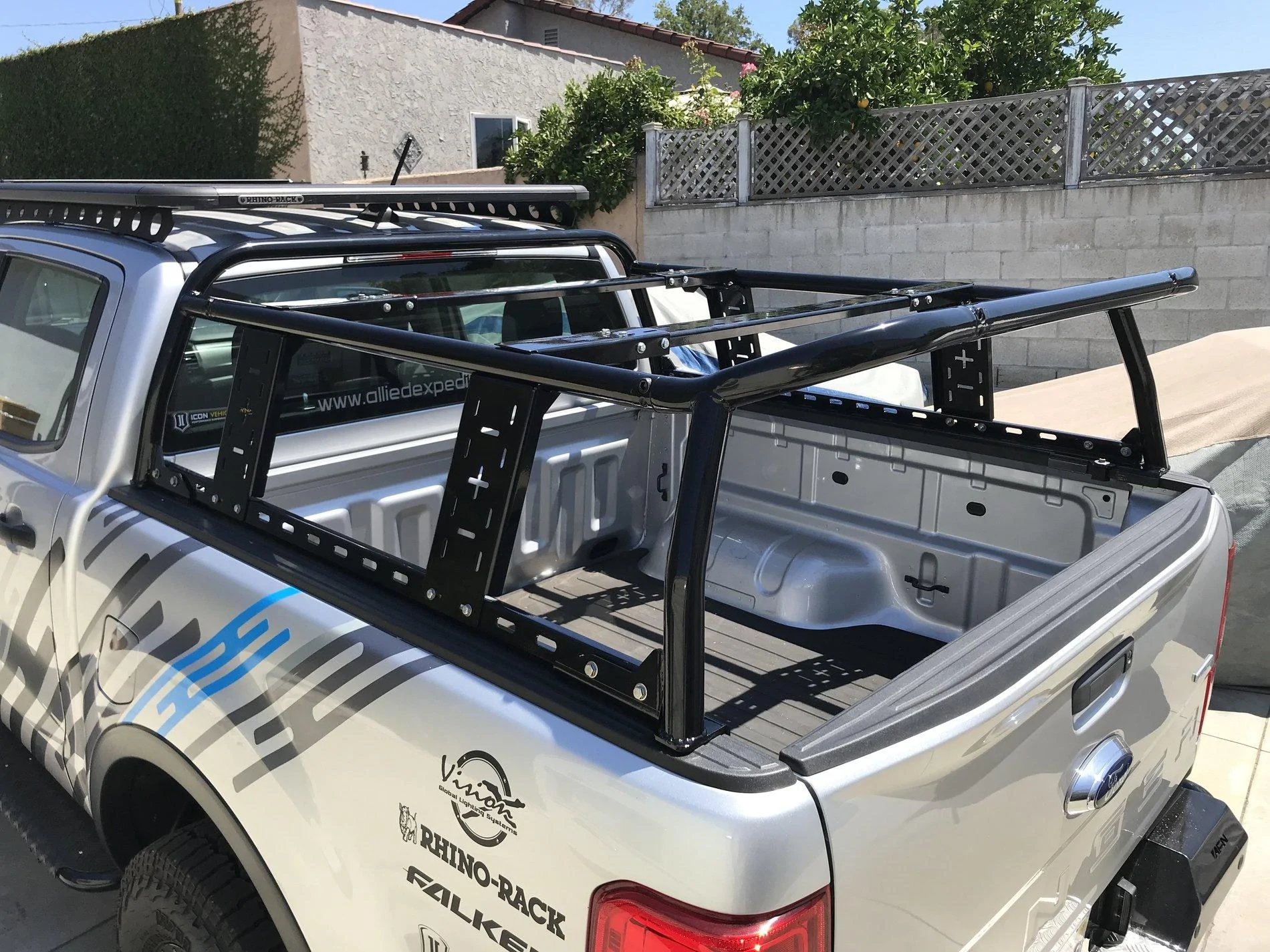

what is with the piece at the back if you dont mind me asking? i love the design but i wanted to run a RTT w/ a awning that maybe goes like 270 degrees, hope that piece doesnt get in the way, or can that be cut off?
the raised bar is so there is a tension point for the canvas top that will be and additional accessory... you won't have an issue with a 270 as long as your pivot is at the rear corner.. most 270 awnings have adjustable legs that would allow it to go up and over this regardless...

It's a little different than others out there as eventually we'll have a canvas top to go over the rack....
A canvas-covered rear topper is something i've been looking for! i'm excited to see the canvas cover! How much does this weigh compared to a bed cap of similar size? I also like all the extra slots/holes, will make it much easier to add custom tiedowns and such. How does this mount into the bed?

Do you have a photo with the roof top stowed. I am looking for one that the RTT top will be the weight of the cab when stowed.
You will need a much shorter rack than he is making. The tent he has on appears to be a Tepui Ayer 2, which is 11" tall when stowed. (Specs and stowed pics here) With the cab being ~19" high above the bed rails, you would need a rack that's only 8" tall for it to sit flush.
