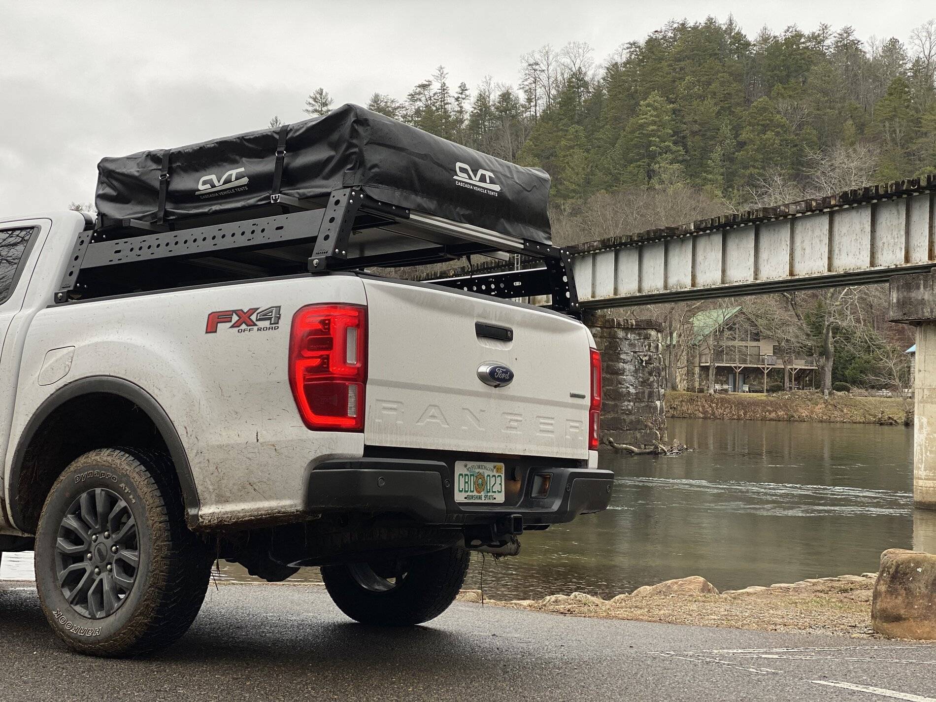

I have a KB Voodoo Modular 58”(L) x 10”(H) Rack bolted to the bed via their tonneau cover brackets. With their brackets I am able to roll up the Gator Tonneau Cover all the way to nearly the back window. Mounted on top is a CVT Mt. Shasta Tent.
My suspension in the rear is factory FX4, and the front just the @Fordrangerlifts.com 2.5” Level. I do have a slight sag in the rear, but a full steel rack and tent will do that.

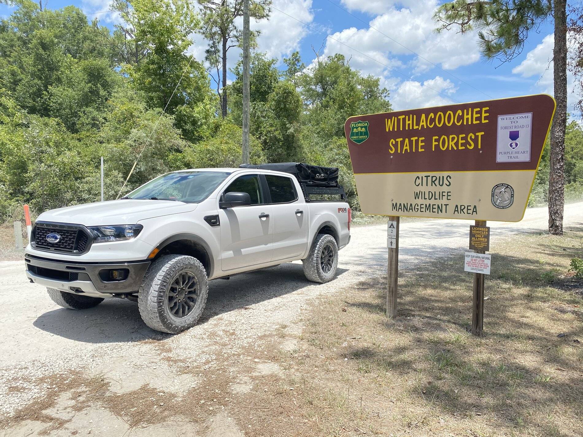

The first photo at the exit of the forest shows the sag with the rack, tent, cooler full of drinks and food, and a bed full of totes with camping gear.

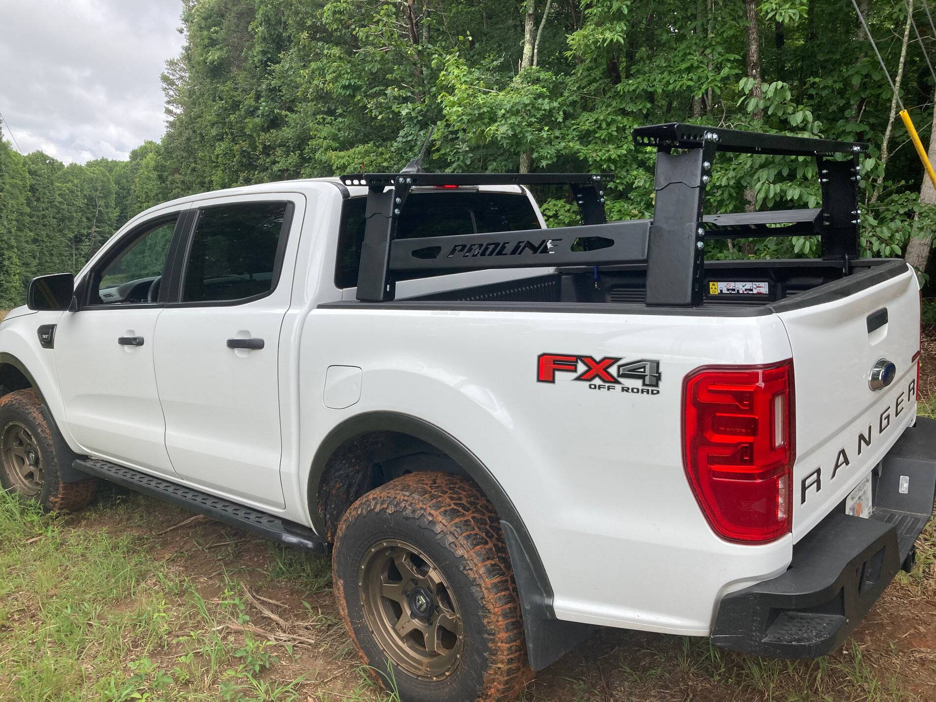

Watch the local used listings as there seem to always be used bed racks available, well in my area anyway.
Most are for the Tacoma but depending on the rack they can work well on the Ranger.
Mine is a used ProLine that fit and mounted great on my truck.
I have the Bilsteins on the rear and a Zone leveling kit on front. The Bilsteins actually raised the rear by almost 3/4".
No noticeable sag with RTT and everything loaded up.
I haven't taken it camping yet as that will happen when it cools off a bit, but here's a pic from a local charity car show.

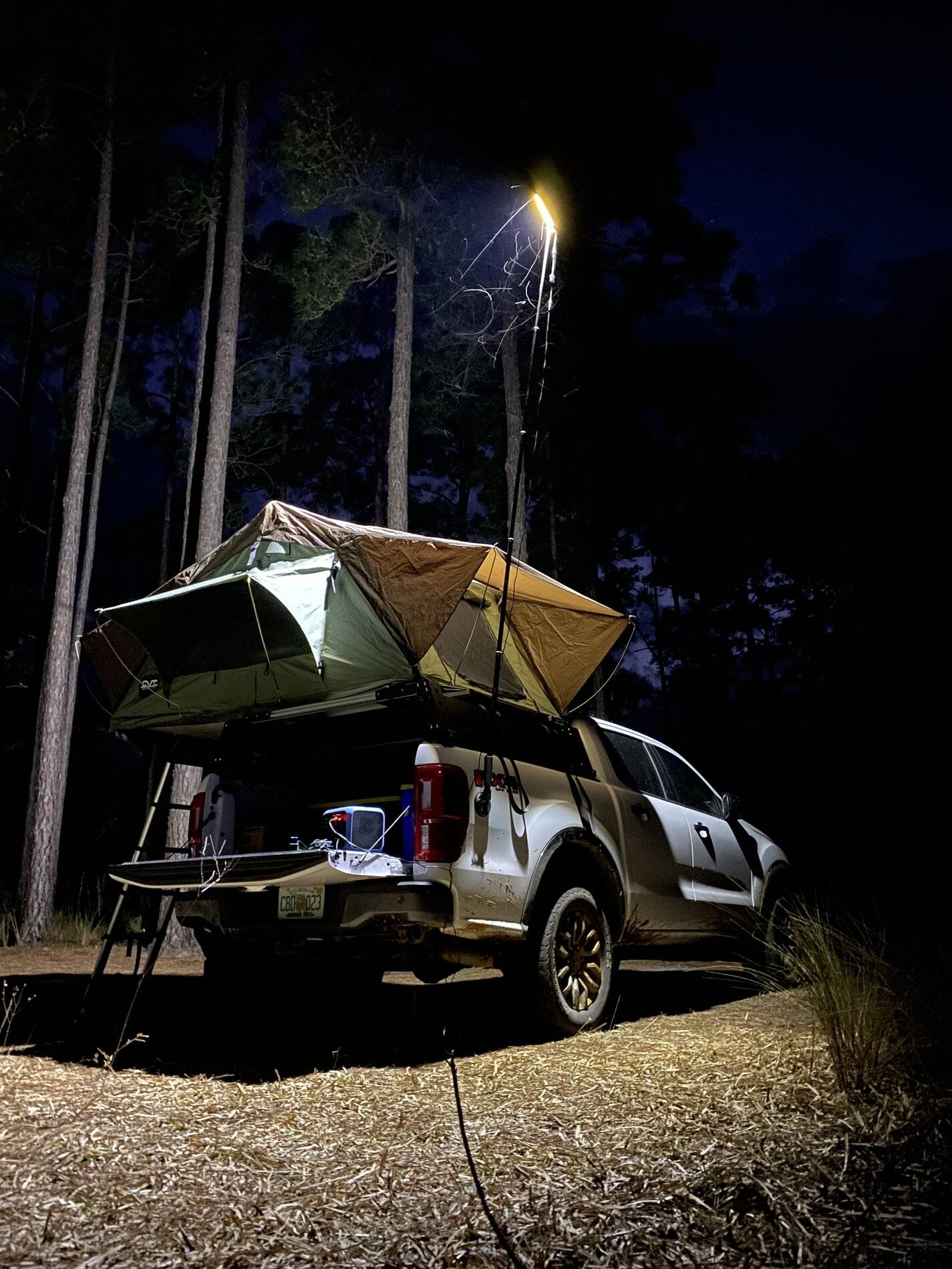

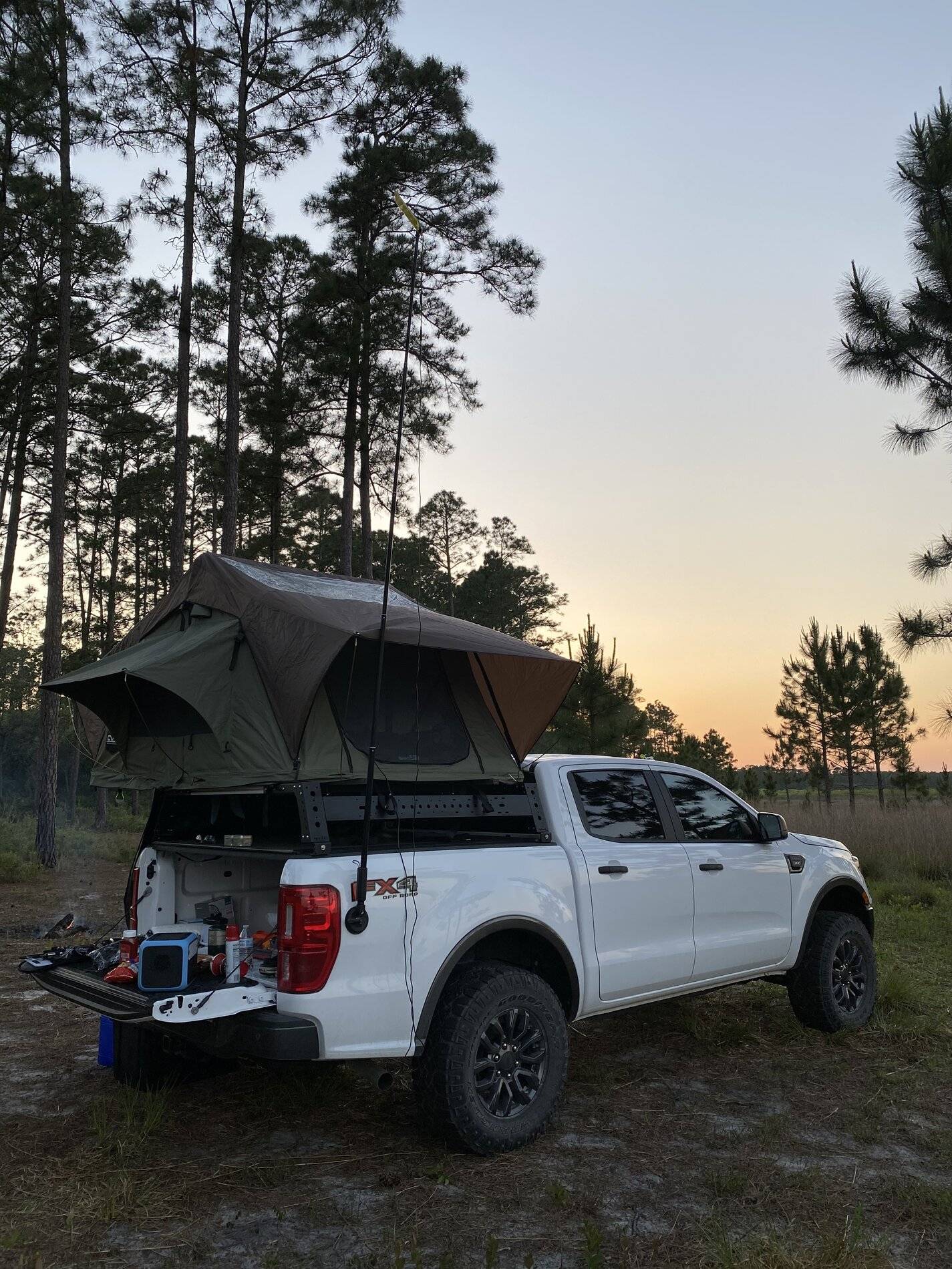

I’d love to know more about that light in the pervious post….
Look for it on Amazon under “Conpex Camping Light”. At the time my brother purchased his, there was only this single panel, now there is a five panel set-up.At full power, which is insanely bright, it registers around 90-100w on my power bank. It comes with a ground stake as well as the suction mount used on my truck. Power is via two alligator clips or 12v plug.
He says it’s probably one of the best things he’s ever purchased for camping. When he showed it to some of the other firefighters at his station, three of them actually ordered one on the spot.
