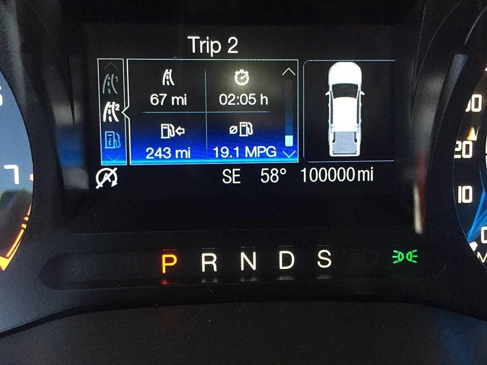

Msfitoy has been crossed the 100K milestone and still looks like she just rolled off the line...albeit a 1,000 times improved...
