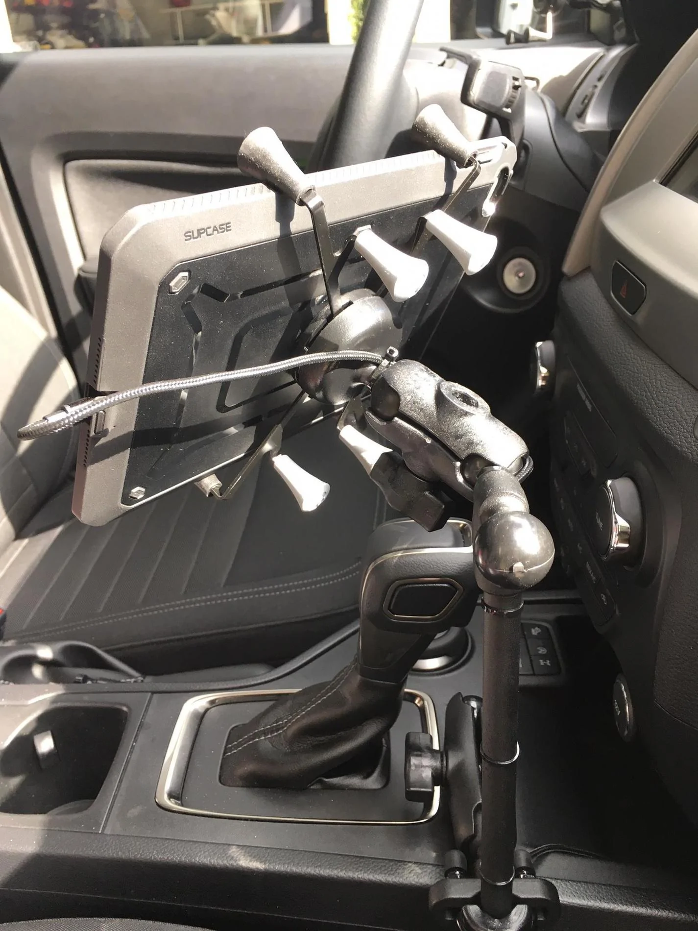

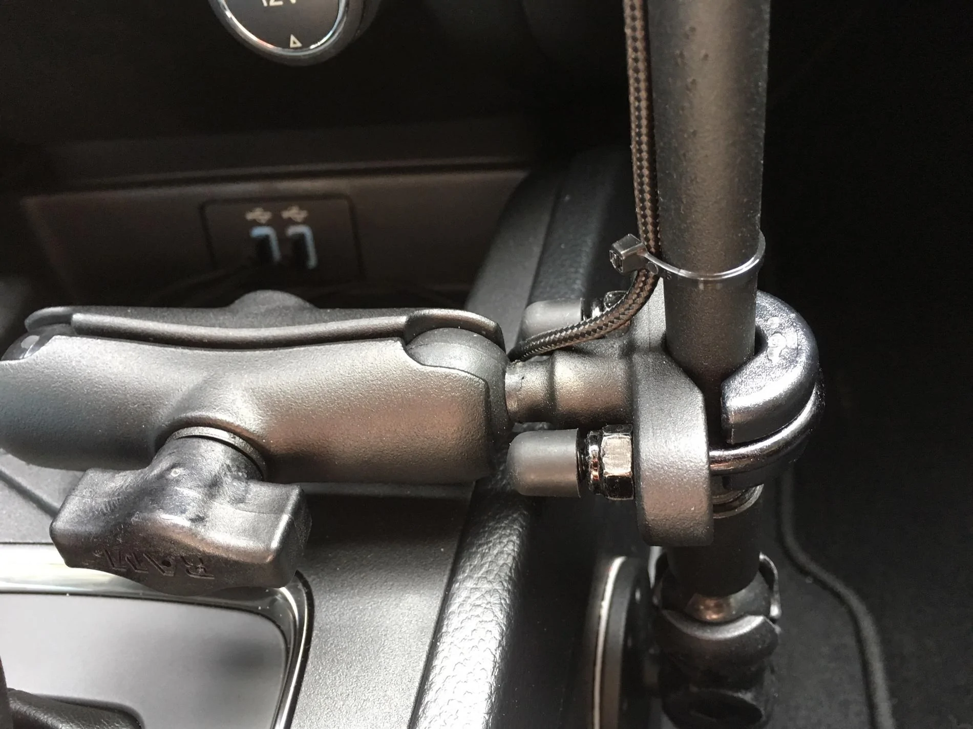

This is the upper half of the base attachment, Ram Diamond ball:

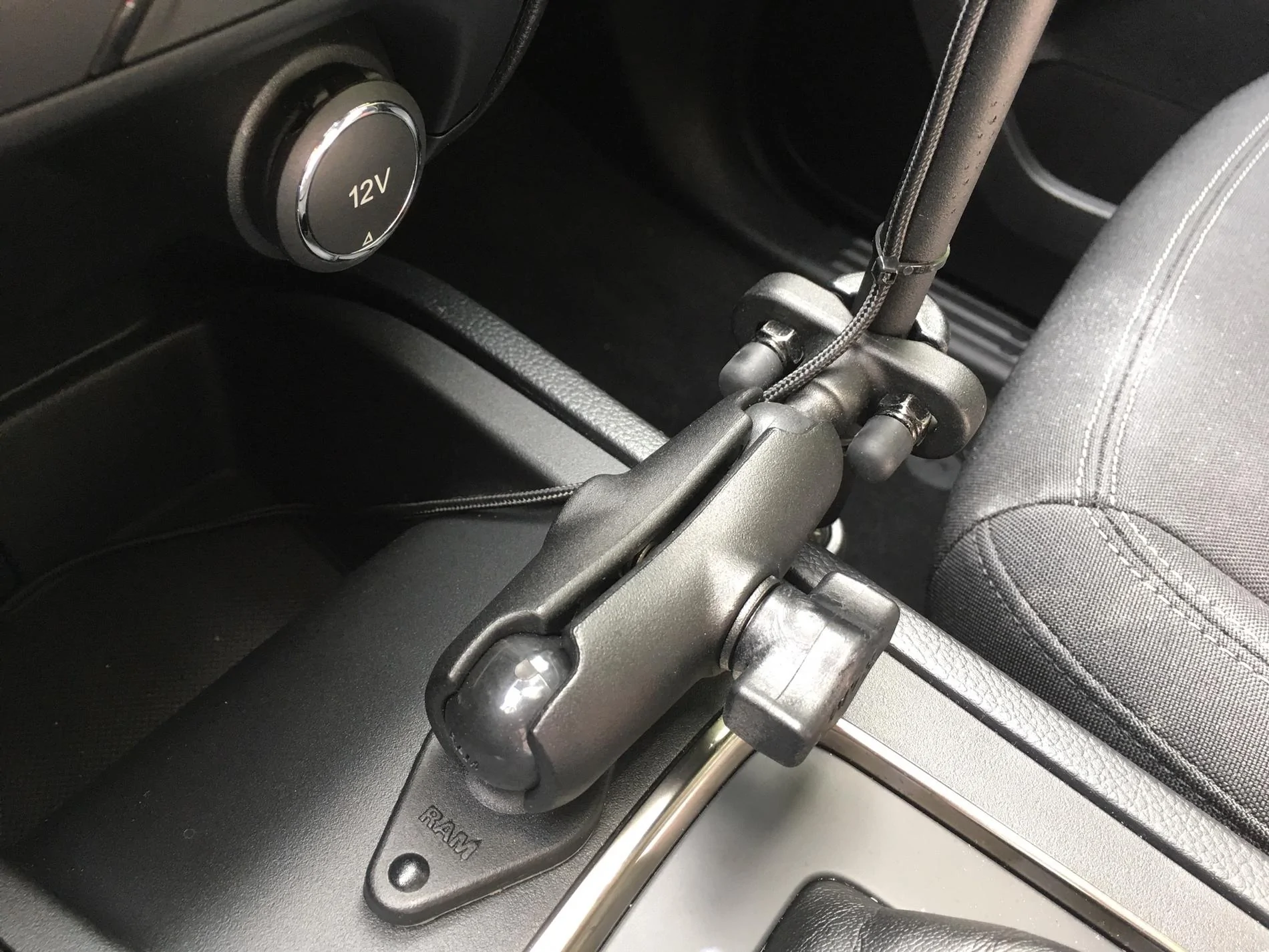

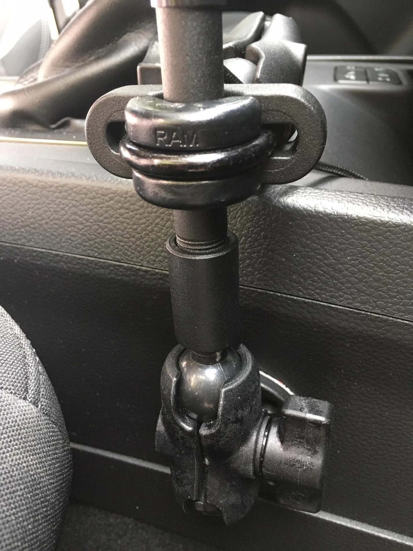

From passenger side...left side of mount is Ram diamond ball base adhesive 3M to console and small caps to fill the hole...medium clamp to reach the vertical bar for extra support...Ram bike bar ball attached to 9" vertical shaft with NTP ball mount on each end...the lower half is mounted to Ram round plate adhesive to side of trim on drive tunnel:
Picture of the 9" riser upper end with twin ball NTP...short clamp attached to Ram tablet holder:
Another view from passenger side of the bike U-clamp attached to riser shaft...at the bottom is attached to universal round base with ball that's attached with 3M tape:

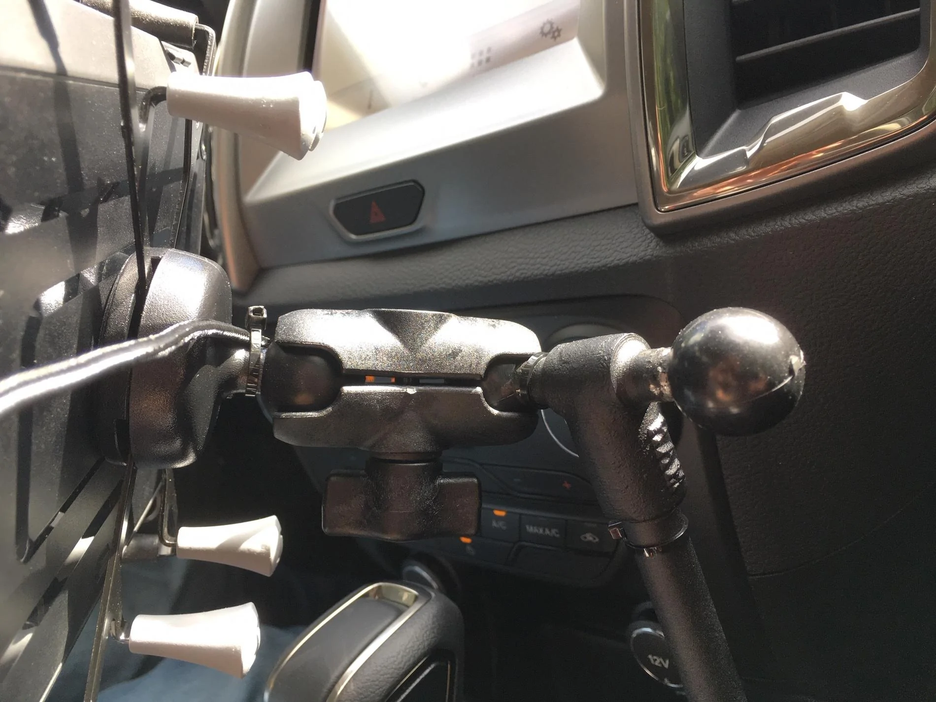

Overall view from the back side:

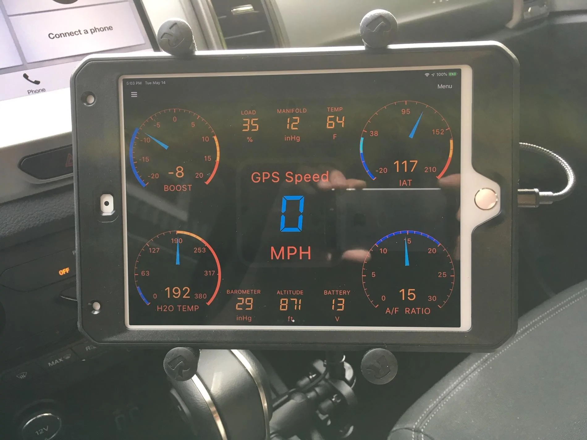

Command central:

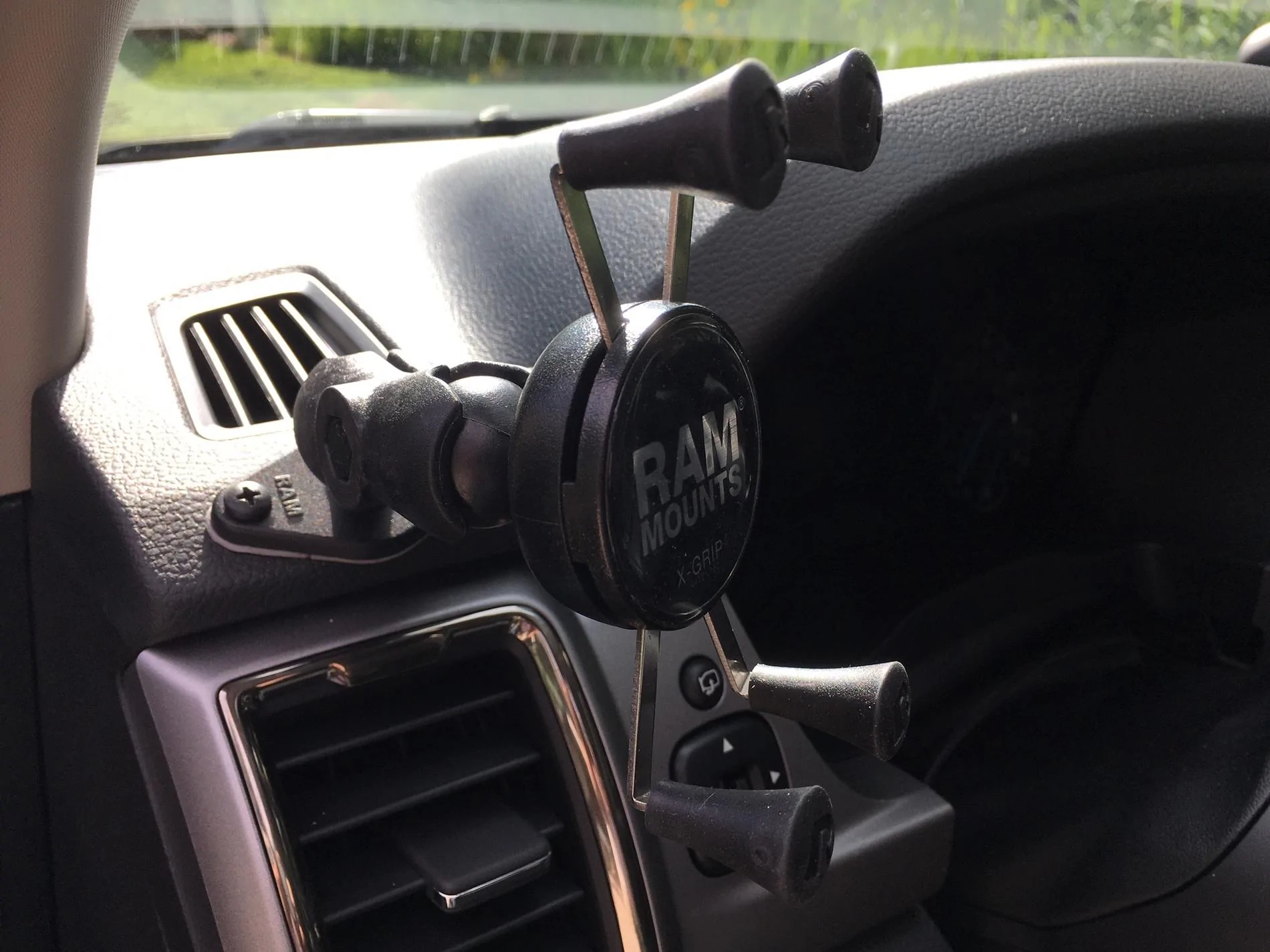

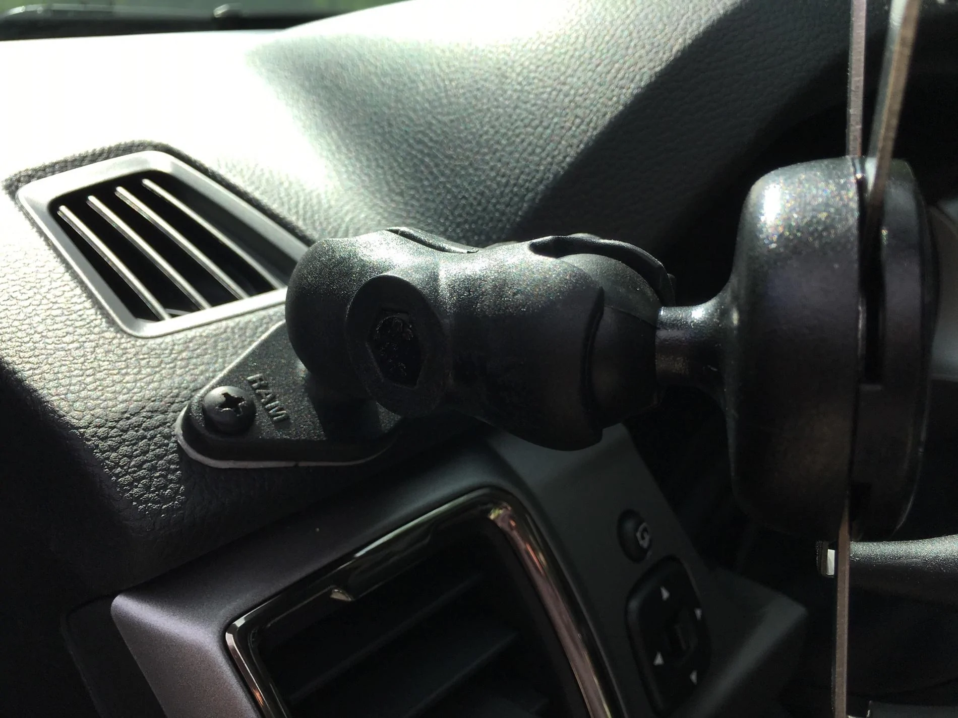

The left side of steering is mounted with Ram diamond base ball, short clamp and cell phone mount...this one couldn't hold on with just 3M tape so had to be drilled and screwed:

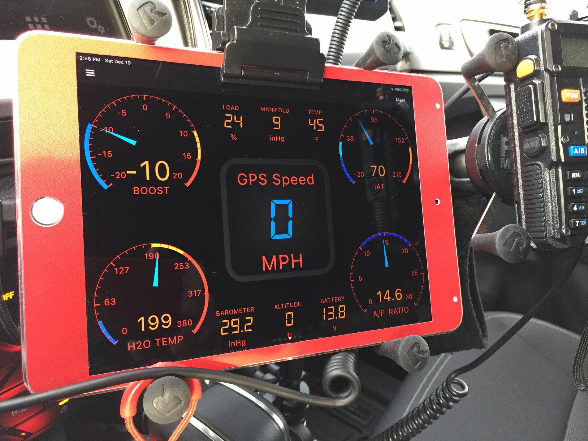

Regarding command central, what are you reading to get boost pressure readings? I have the Ford Performance Tune module and can't find boost pressure to display out of the choices in the module.
