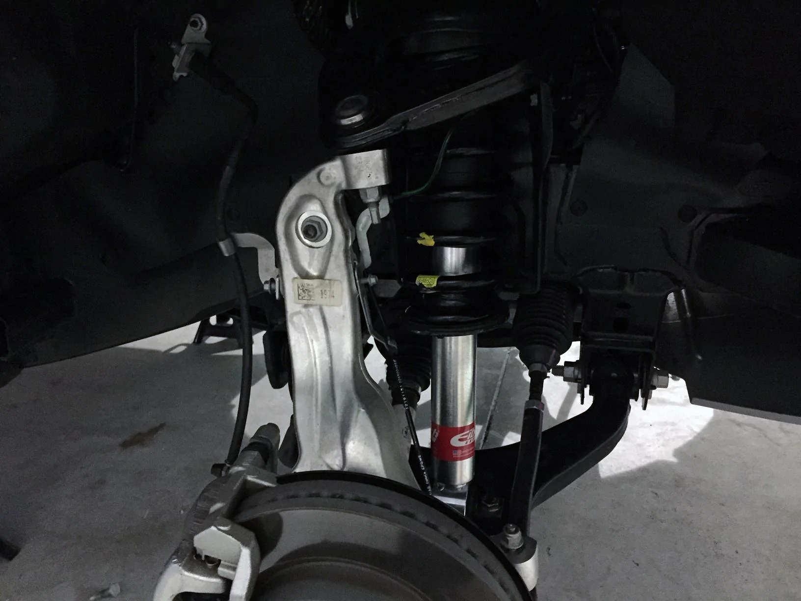

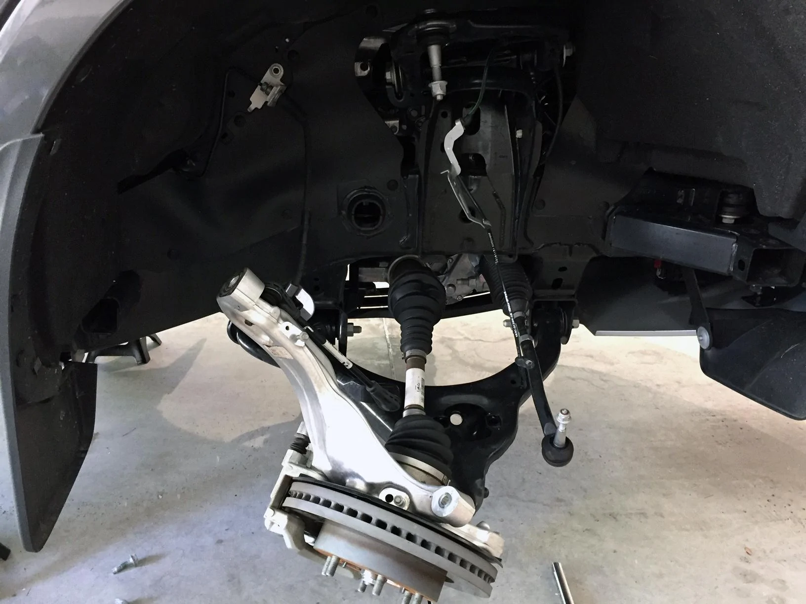

Point of no return my friends...:frown:
After a long day of cursing with everything going wrong from spring compressor failing, getting another replacement, drive shafts popping out, struggling to get them back in, the deed was finally done...:whew::like:

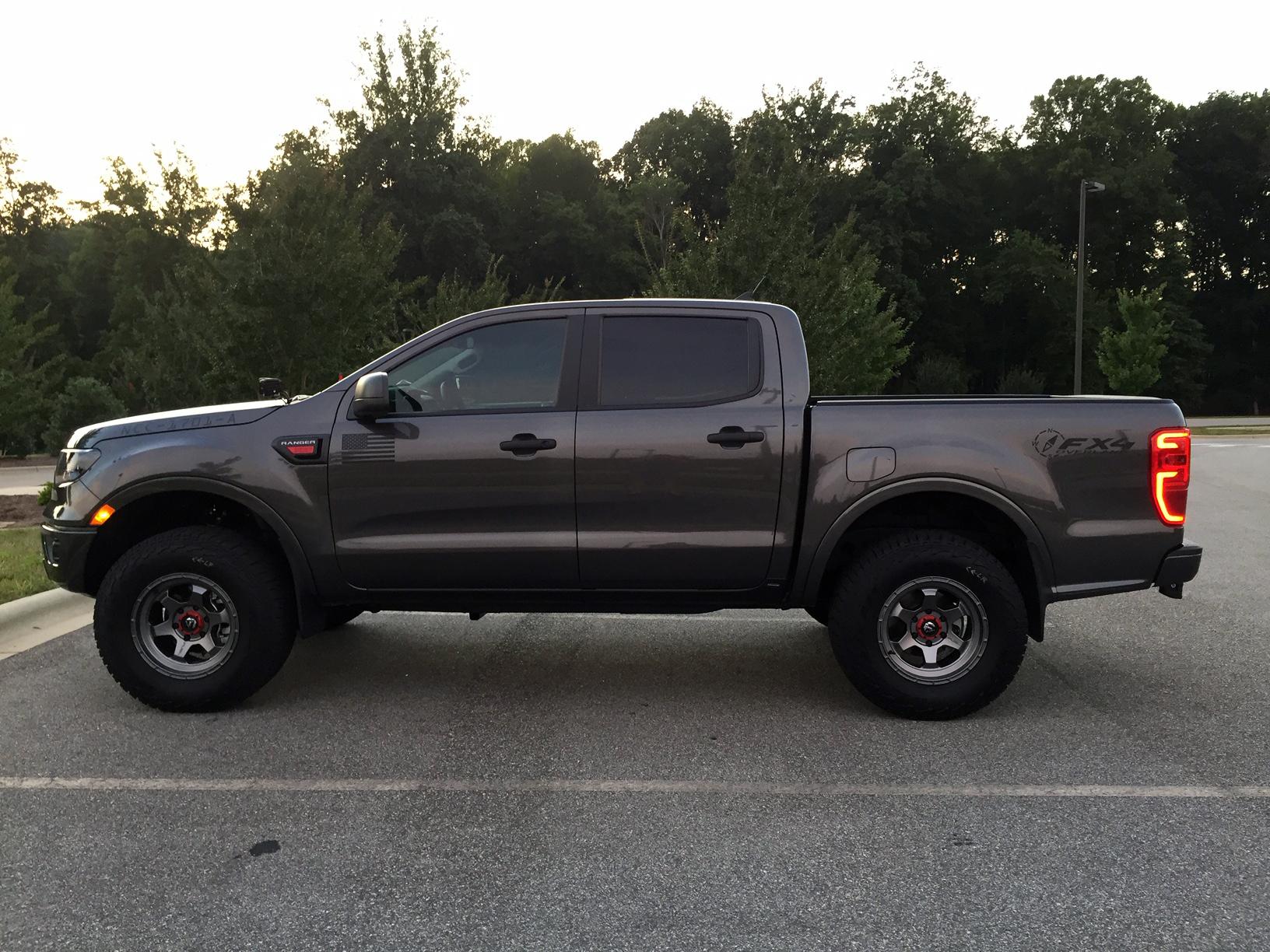

And behold...proper stance at last...just need to get front end aligned...all four ends from ground to fender is approximately 39"...

Love it! Just the right amount of lift. How's the ride and handling?
Also, it seems like everyone is having issues with driveshafts popping out - any tips to prevent this?
Looks great, Sid! The perfect stance. :thumbsup:
Super smooth...haven’t got the matching rear eibachs on yet but thatll certainly make it even smoother
I notice you kept your stock springs. Any reasons why? Also did you set the strut at the 3” or 2.25” mark. Trying to decide on mine. Thanks
Yes, sharp eyes:like: I decided after deliberating for a bit that I didn't want to over extend the stock UCA's capacity and stay conservative. I mounted, according to instructions for using stock spring second ring from the top for 2.25" lift (I think it's more like 2.5" maybe more) in front and not need any additional blocks in the rear. I think I made the right choice as the stance is almost level but still has a slight rake and that will allow me to carry loads and/or tow without sagging the rear. Parked next to any stock Ranger however, the difference is striking. Even with this modest lift, I had to adjust my headlamps down considerably, several times:crazy:
Warning, Eibach's grade 8 bolts (x4) for bottom of front struts are too short. They barely make contact with nyloc thread and mine started to loosen. I replaced them with slightly longer ones.
Keep in mind, this Eibach kit was always a half measure until I move onto a full blown BDS Icon full system (3x the price of Eibach) what will come later, after I've deep dived into the world of overlanding:inlove:
