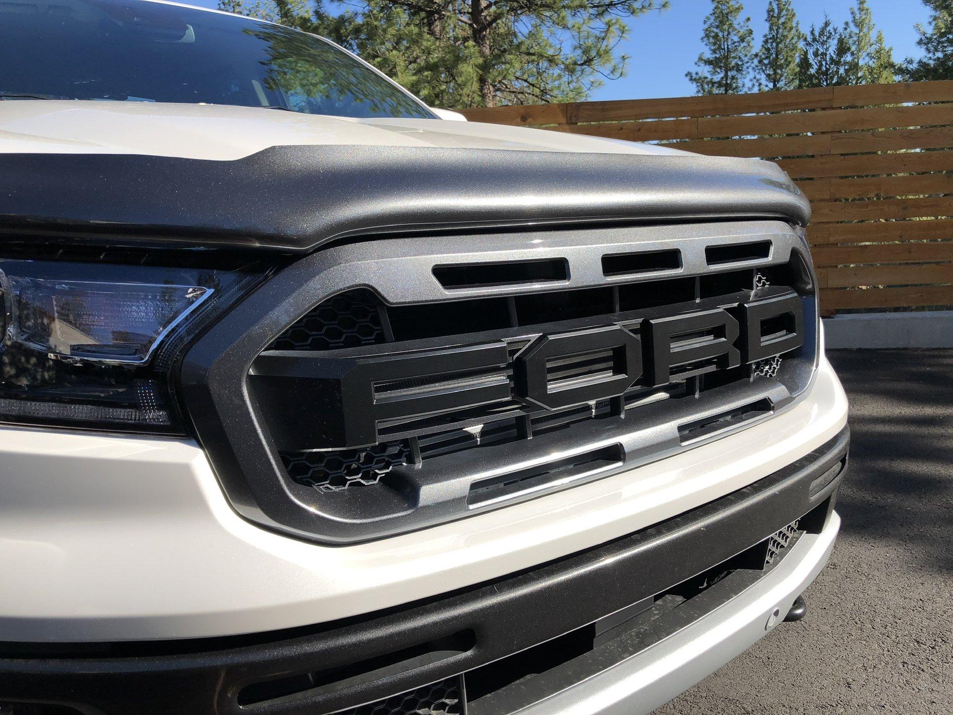

Do you design your own graphics, then just send your EBayer a vector file?
I had the grille (and deflector) on my truck painted to match the Sport package “Magnetic” trim, then painted the Ford letters satin black. Subtle.

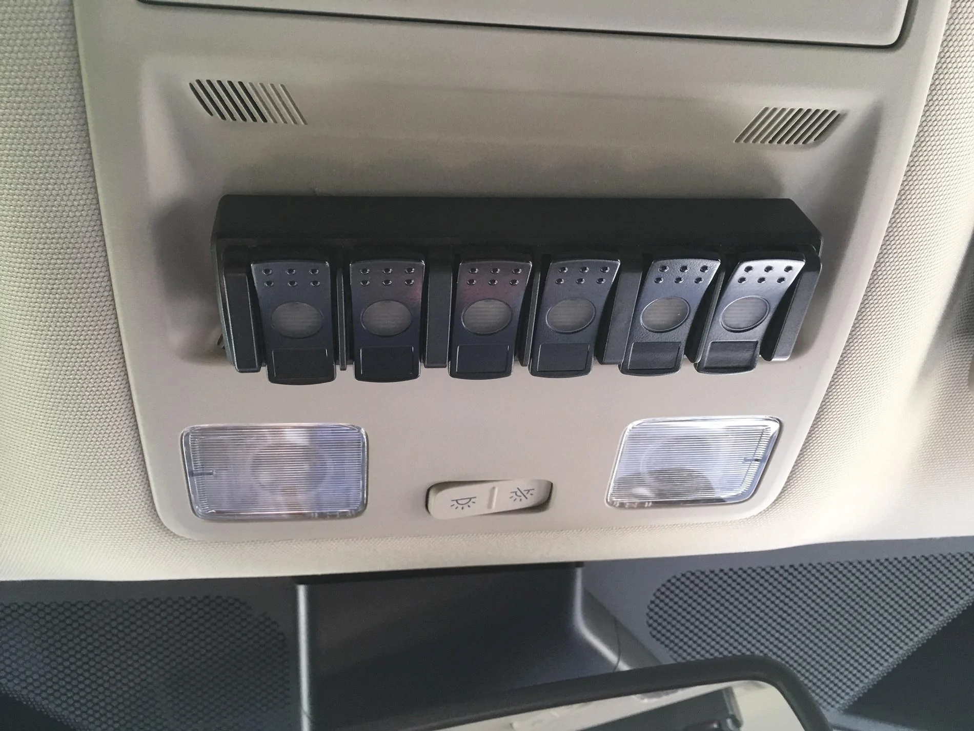

Here's location for the Trigger 3001...I double sided a steel plate to this area and the switch magnetically mounts to it...I can take it outside the vehicle to control remotely...lol it's already a remote:giggle:

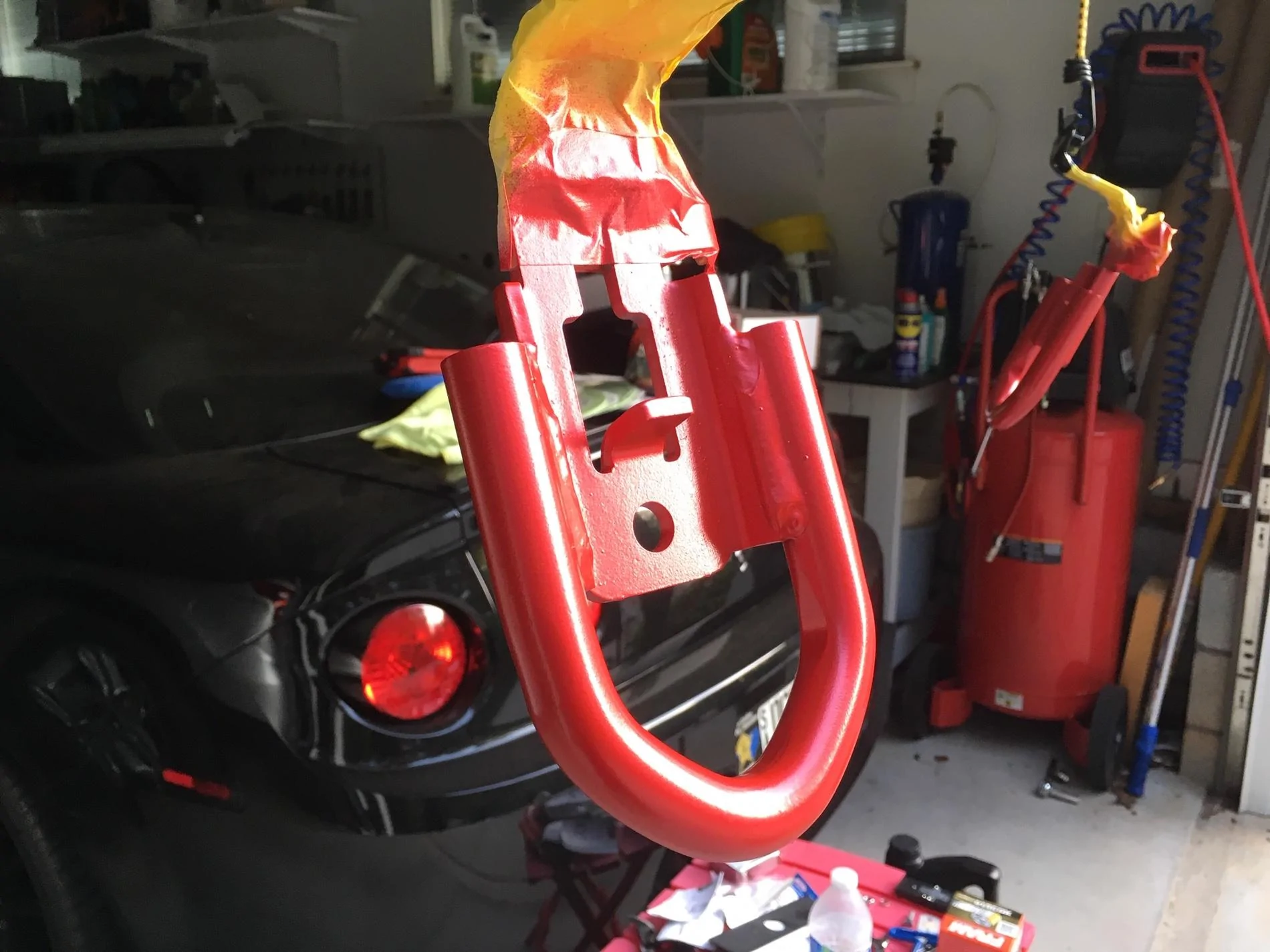

Easy 30 min tow hook paint job...same as the red on my Fuel customized hub cap:like:

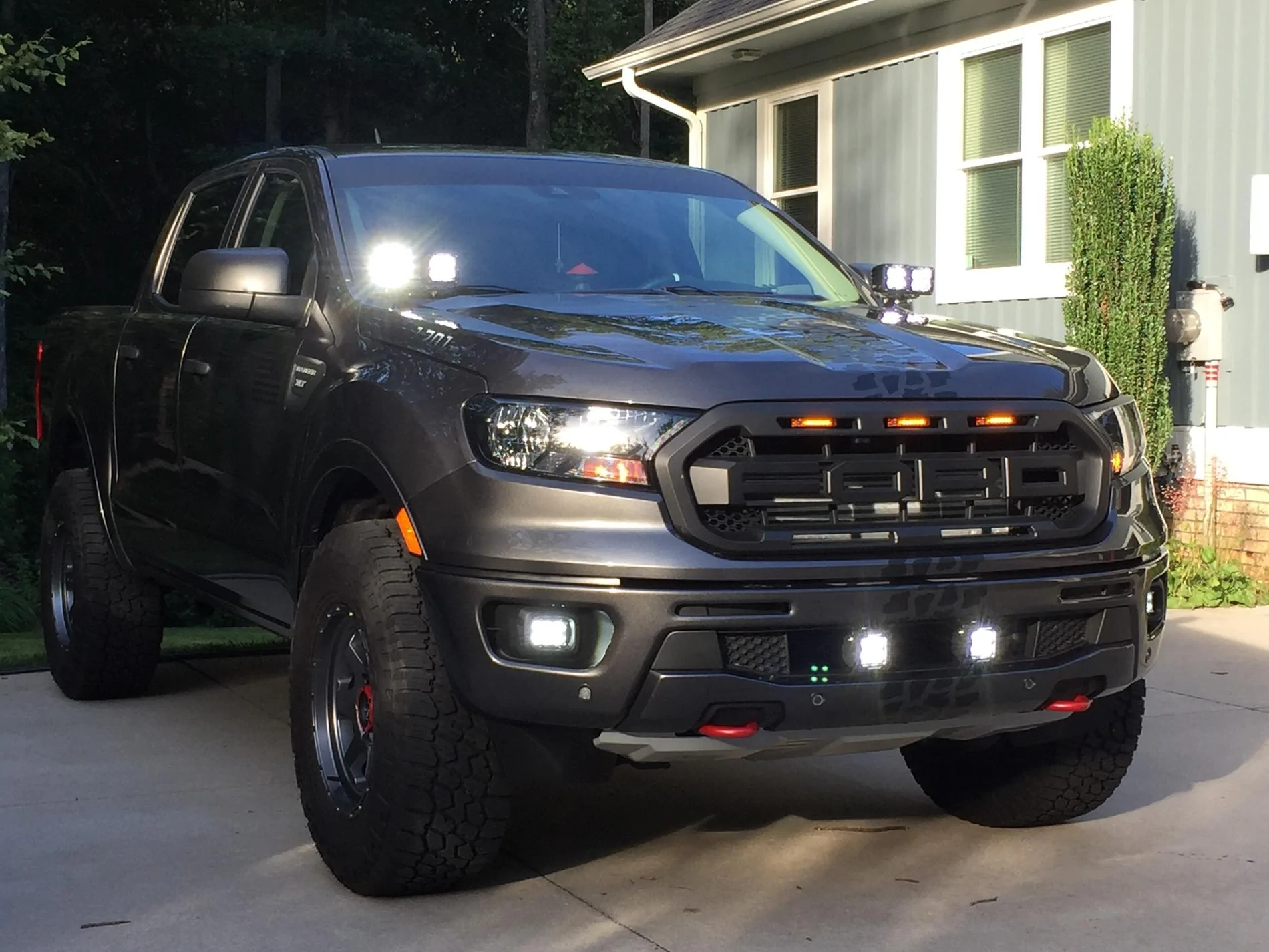

Great build! But please forgive my ignorance as I am new to trucks again, and very new to 4wd. What is the purpose of removing the crash bars? Are you rubbing with the bigger tires? Will the need to do so still be there when the truck is leveled?
9,229
28,566
NWO Robot Polisher
Thanks much...the beams are there to help with offset crash deflection but their benefit compromises the usable tire envelope. Yes, you can lift and keep those beams...however, once the truck begins using it's full articulation while off road with larger than OEM tires, they will make contact with the beams...something I'd rather not encounter when a tires in a ditch or on top of a rock at full lock:facepalm:
So if your fat tires can't steer full lock while in a lowered position (OEM), then they're only good if you don't ever use full articulation:like:
