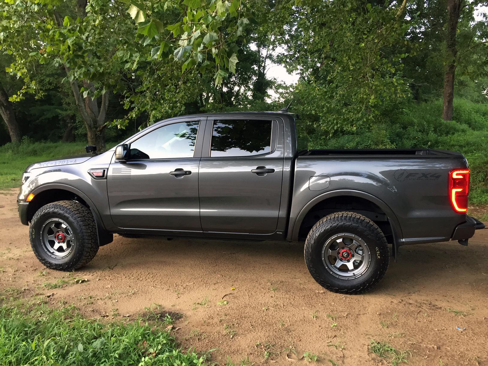

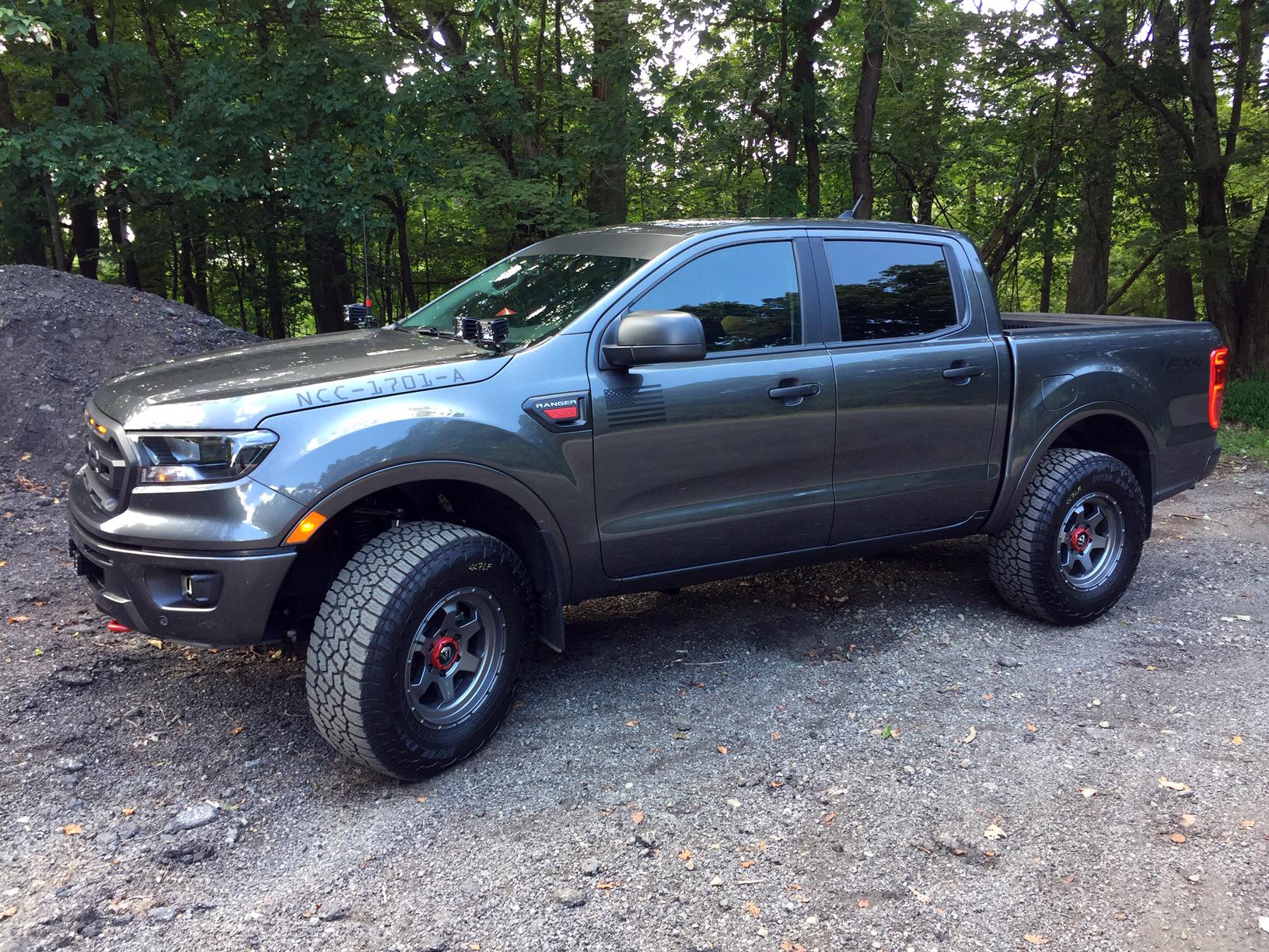

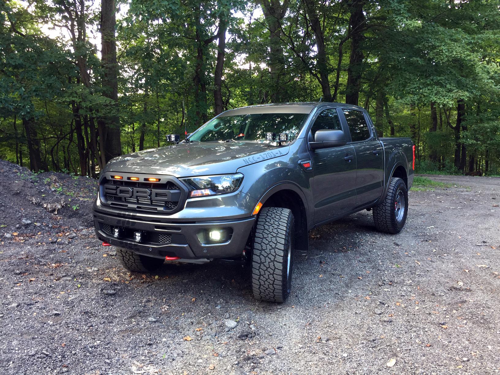

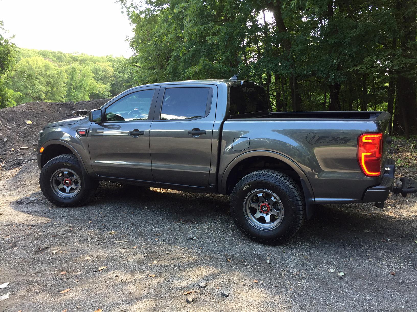

Yes, sharp eyes:like: I decided after deliberating for a bit that I didn't want to over extend the stock UCA's capacity and stay conservative. I mounted, according to instructions for using stock spring second ring from the top for 2.25" lift (I think it's more like 2.5" maybe more) in front and not need any additional blocks in the rear. I think I made the right choice as the stance is almost level but still has a slight rake and that will allow me to carry loads and/or tow without sagging the rear. Parked next to any stock Ranger however, the difference is striking. Even with this modest lift, I had to adjust my headlamps down considerably, several times:crazy:
Warning, Eibach's grade 8 bolts (x4) for bottom of front struts are too short. They barely make contact with nyloc thread and mine started to loosen. I replaced them with slightly longer ones.
Keep in mind, this Eibach kit was always a half measure until I move onto a full blown BDS Icon full system (3x the price of Eibach) what will come later, after I've deep dived into the world of overlanding:inlove:

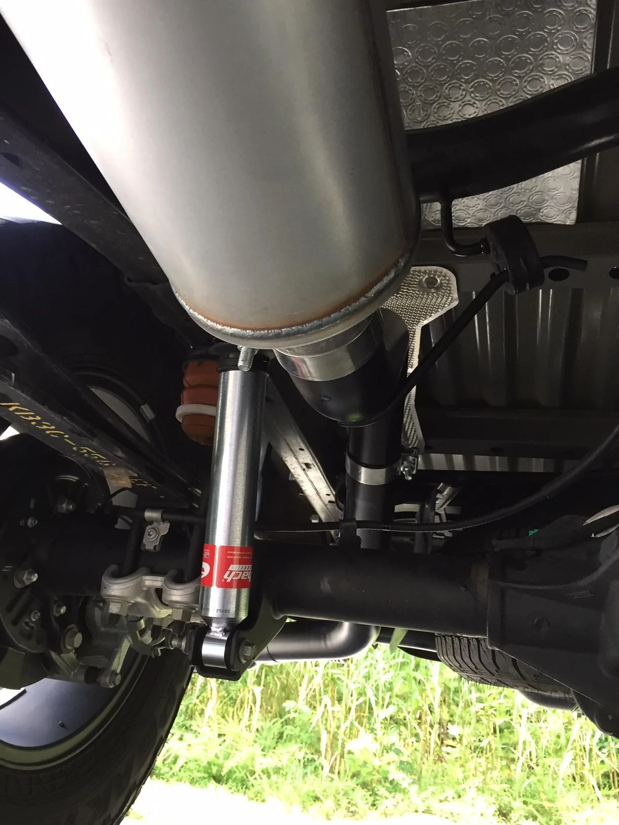

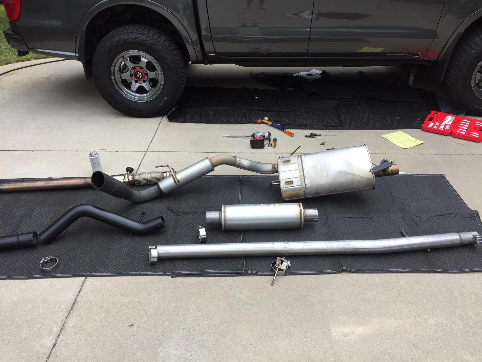

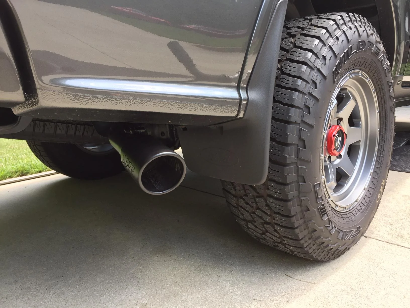

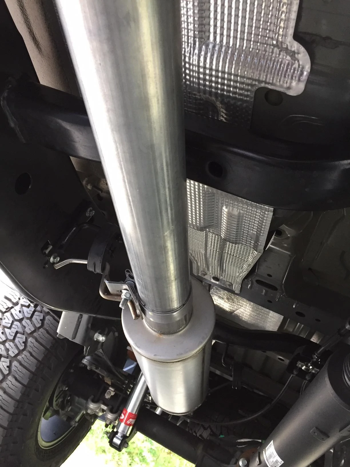

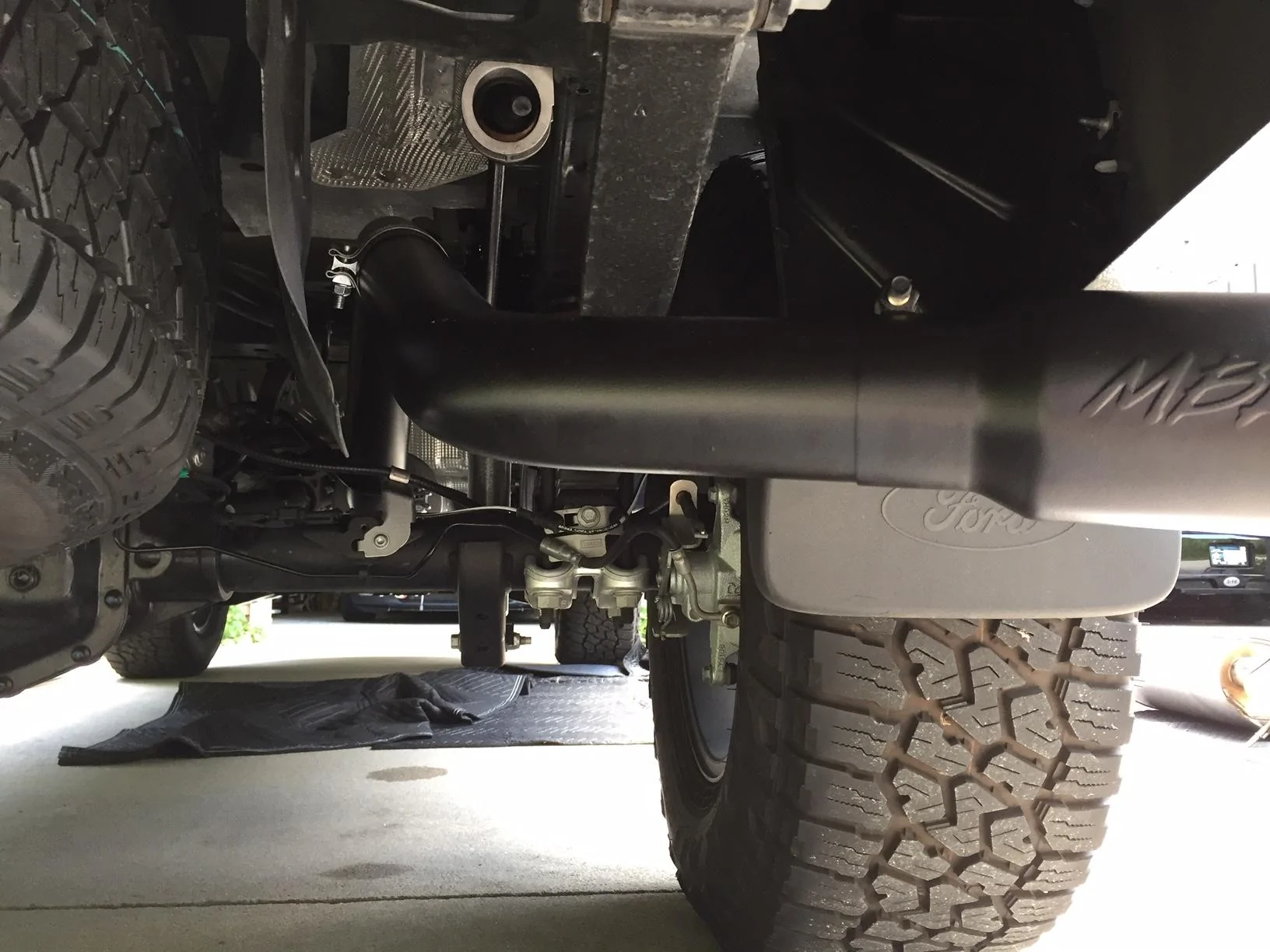

Been sitting on these MBRP exhaust while waiting for the Eibach. Now that those are installed, it's time to lose some weight and gain some noise...MBRP on bottom and stock on top...my what big mufflers Ford stuffed under there:)
Took a couple of hours of crawling in and out from under the truck but it's finally done:like:
Start up was pleasant change of tone...instead of a hum, it's now a distinct purr. On the road, I can hear the exhaust changing note as the gears change. Very mild and understated sporty sound. I LIKE IT:like:

WOT is very invigorating...aggressive but not obnoxious...starting to wonder what would happen if i used straight pipe in place of muffler:giggle:

No drone at all...I barely hear it until I go WOT then it sounds pretty kick ass :giggle:...other times it's just purring away:)
Have you heard a muffler delete yet?
Pops a little on cold start..
Once it’s warm sounds just like an MBRT

Thanks Doc! I've thought about deleting the MBRT muffler with a straight pipe...there would be nothing between the down pipe and the exhaust tip...I imagine that would be much more aggressive than any exhaust system lol...
Is the down pipe etc. “cat less” ?
You could replace the muffler with the stock resonator...if you don’t have a little back pressure you might get a check engine light.
