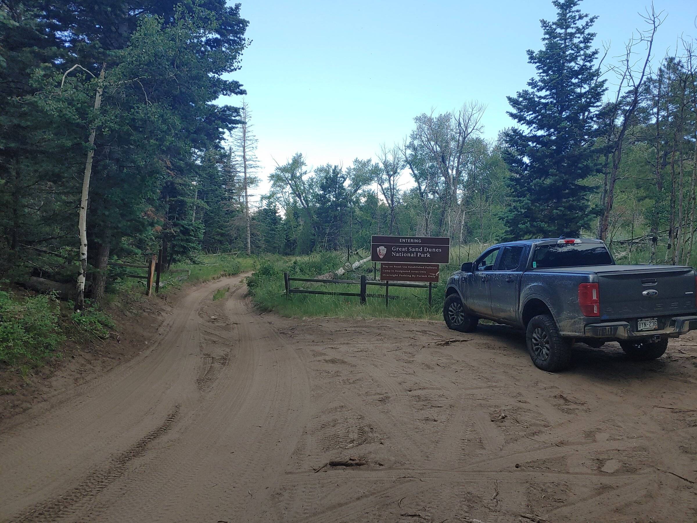

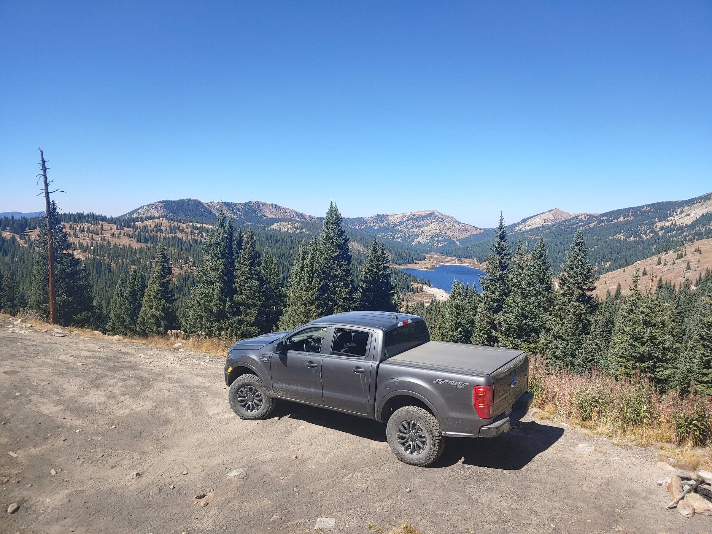

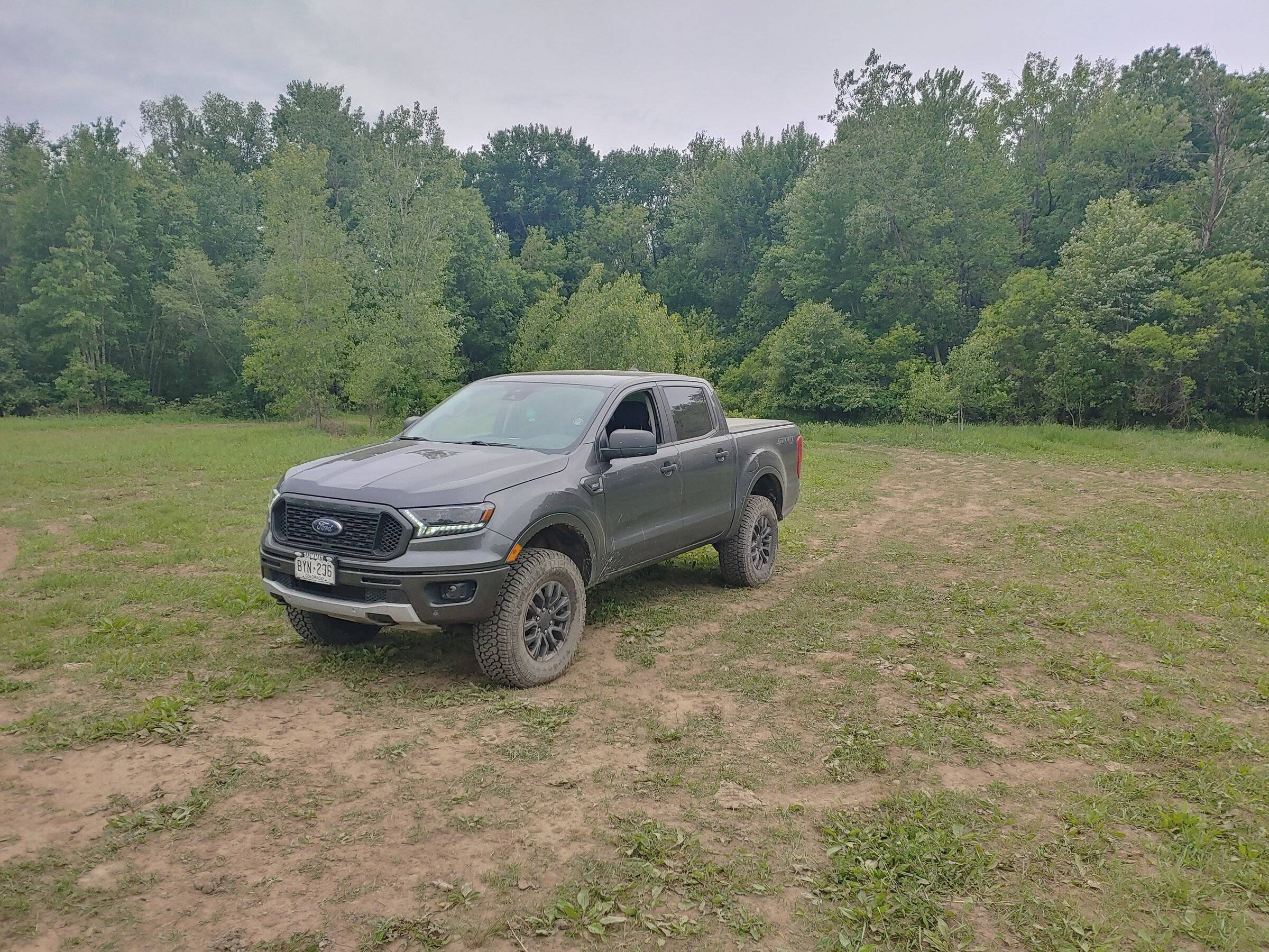

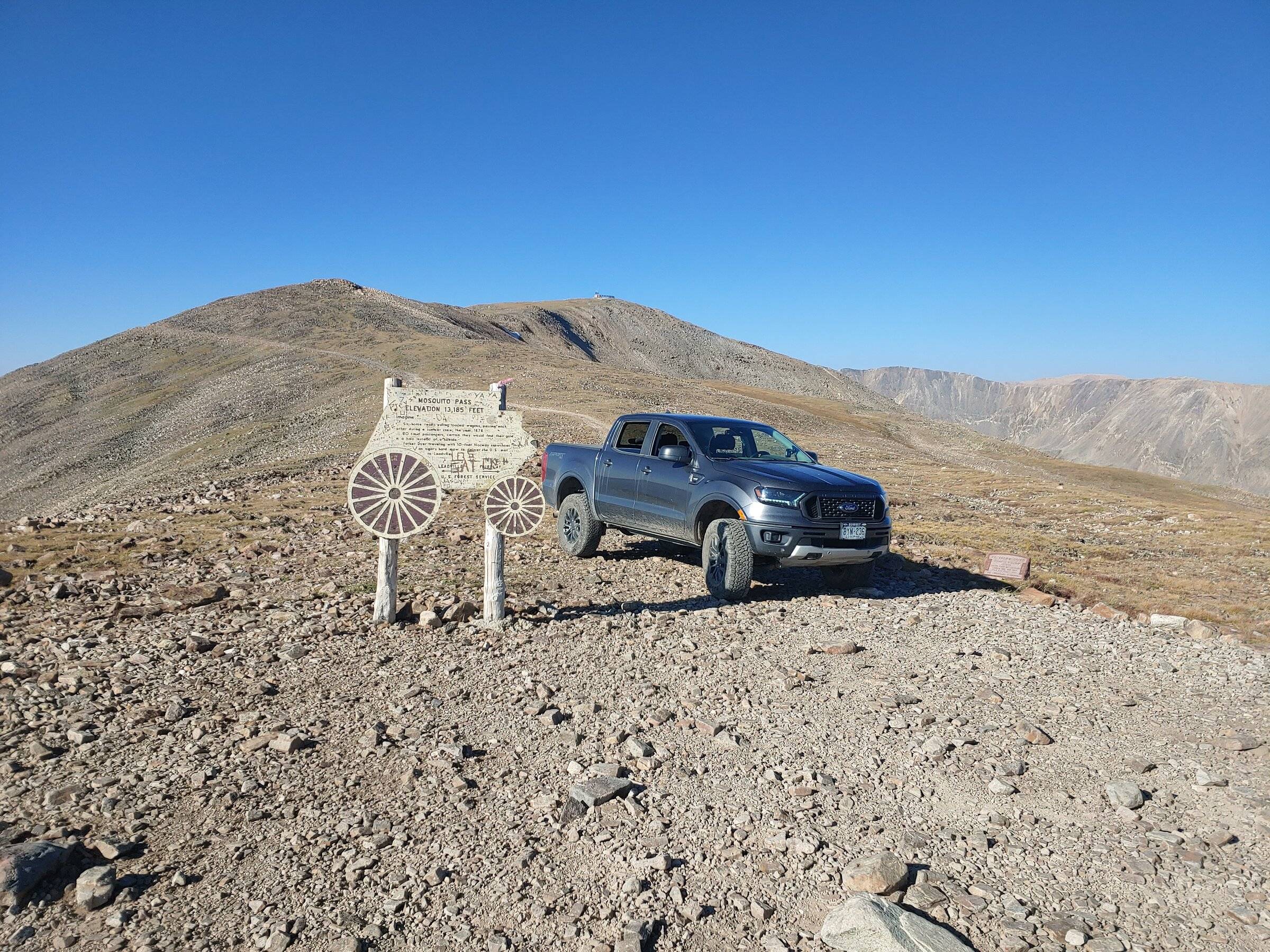

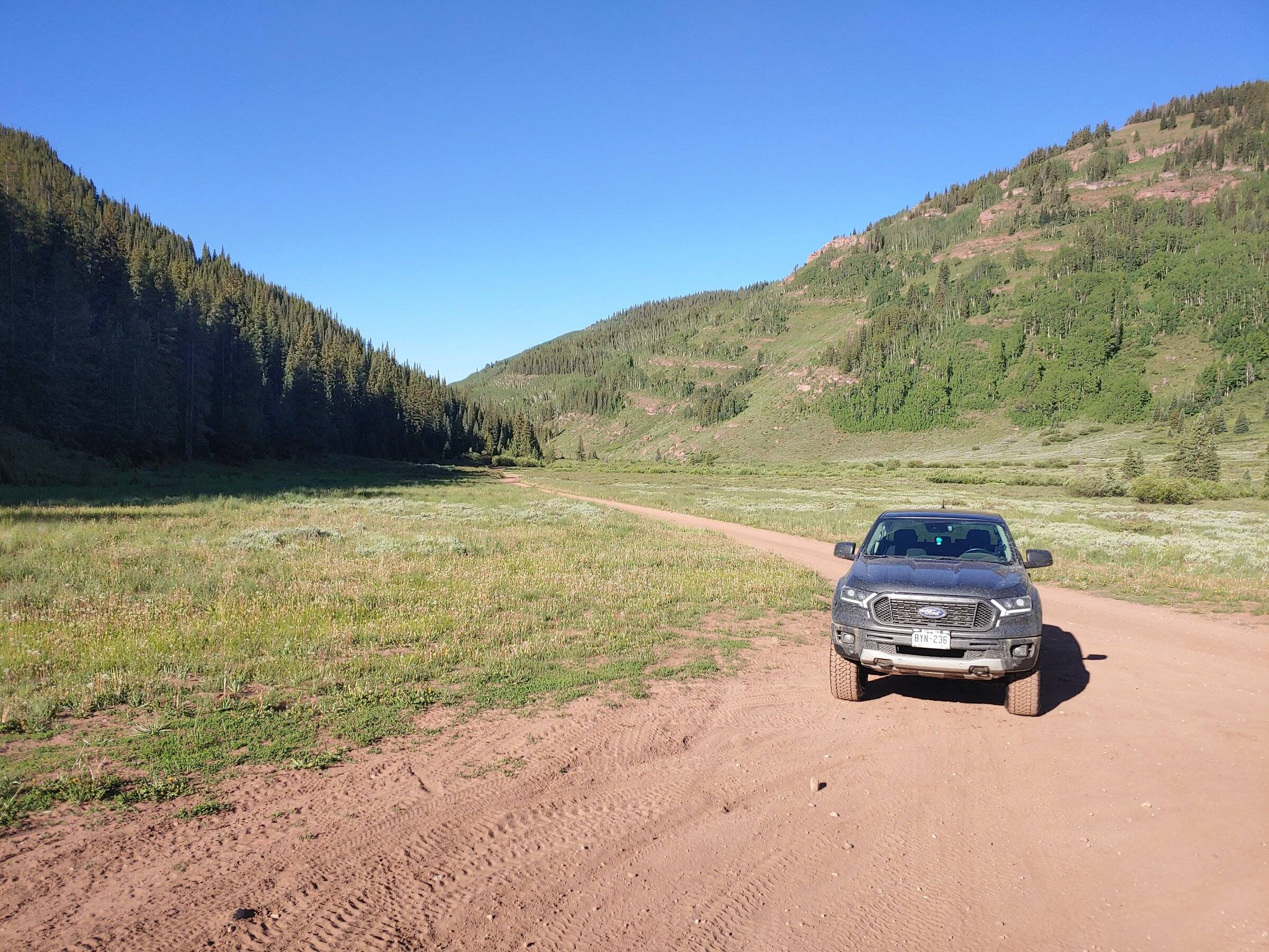

Now if you are planning to take your truck OffRoad for fun trail riding then you might want to consider the Old Man EMU lift kit. It lifts the truck 2.4 front and 1.6 rear. You can run 33's with little to no problems depending on tire and wheel combination. Foe what you get all together it really is the "best bang for your buck" suspension package(and I'm not talking about the BP-51's).
I have had the suspension for close to 2 tears with roughly 35,000 miles and I like it(and still plan to upgrade to BP-51's). If anything I say consider it as it is a great choice for those who take their truck on the trail.
Enjoy the pictures for reference
