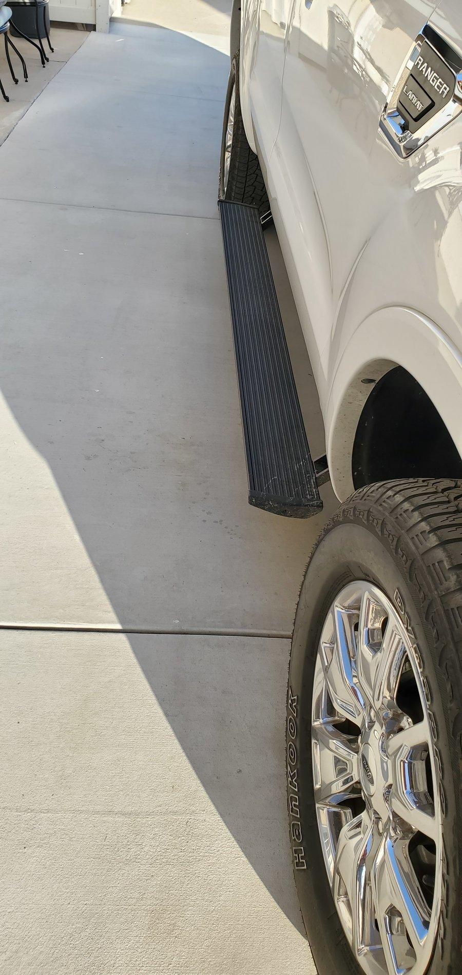

Sorry for the confusion, I meant to say that all other running boards (non-electric) for this Ranger are 79", so why did AMP design their E-Boards at 72", they don't look right.
You know, after installing mine (perfectionist), I think the length is a design trade off for two reasons.
1) The truck body/rocker flares outward at each end; behind the front tire and in front of the rear tire. So to keep the step as close to the body/rocker as possible, they shorten it.
2) When the board retracts the rear end of the board uses the body of the truck as a lever to force the front end of the board tight against the truck. In other words, when the board retracts, the rear end of the board hits the body/rocker first and then the front end is pulled up against the body/rocker. It is subtle, but watch it in action. Oddly, my left side is more noticeable than the right for some reason. According to the instructions I have, they said to measure ~4.5" from the rear end of the board and mount it to the rear bracket/hinge. The problem I noticed is with the board retracted, the front end of the board was further away (seemed to sag) from the body than the rear end - because of the body/rocker flare. So I re-mounted the board, but used 4" instead of 4.5 and now the board end caps on each end of the board are equal distance (1/8") away from the body/rocker.

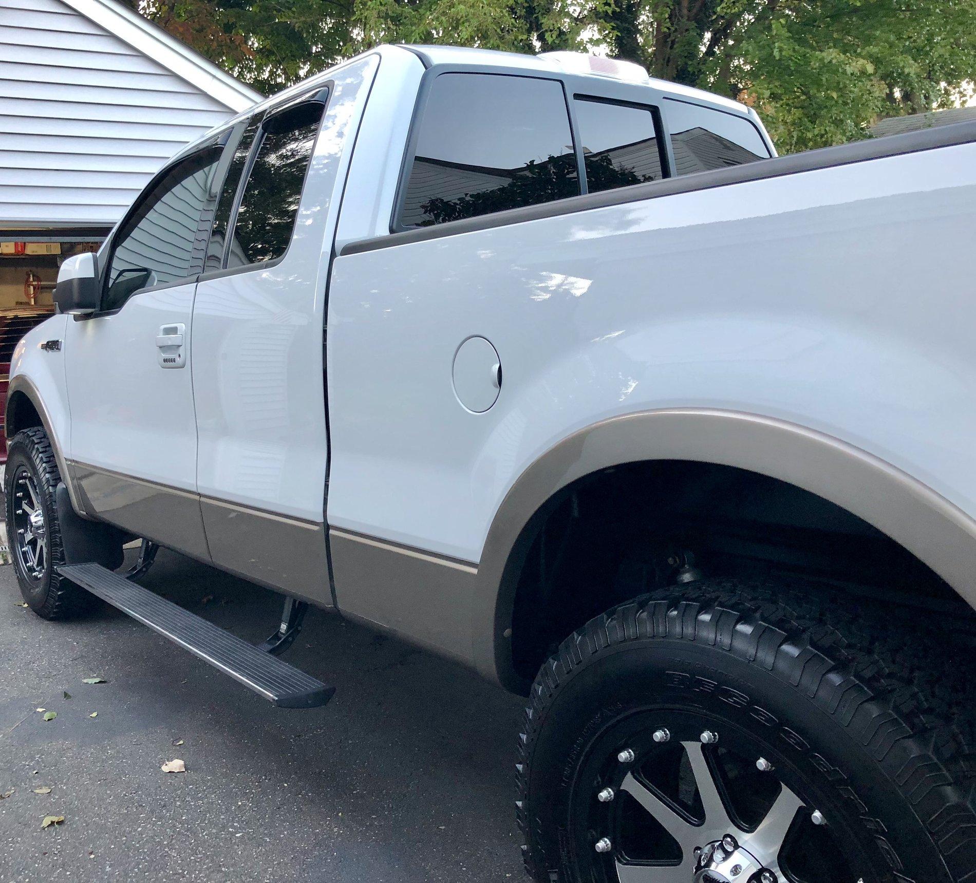

What’s not to love. I have them on my F150, their AWESOME!!
