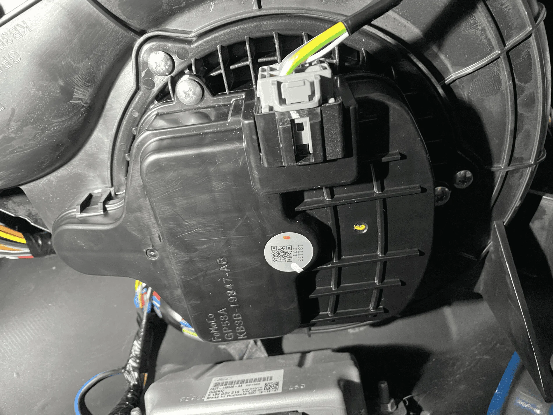

The HVAC blower motor on my 2019 Ranger just started making a growling noise like bad bearings. Anyone replace one. If so, how?
Thanks.

Easy:
But before replacing it, remove the blower motor and ensure squirl cage is clean of debris (Leaves, Mouse Bedding Etc.)
Common for debris to get into the squirl cage and cause noise as it spins.
They run about $114.00.
It's nomenclated as a Blower Motor Control Module as it is all in one unit the blower motor and the blower motor control module.
Just under the Glovebox and below the cabin filter (Check - Clean or Replace) this as well.
3 Screws and a connector and its out.

Surprisingly simple to remove. Just 3 Philips screws like airline tech shows.I had debris from someone trying to make a nest fall into the fan causing severe vibration after removing my cabin air filter. Removal and installation is pretty straight forward.
