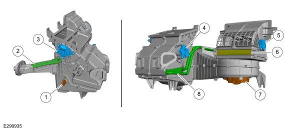

If so, then look at the 2 door actuators, Upper - (Air Inlet Door) Lower - (Pass Temp Door) if you have the Dual Automatic Climate Control.
When you turn truck off, these actuators are depowered, and they will cycle to a unpowered position.
If one is noisy, it will produce a clicking / popping sound (plastic gears) meshed and gears jumping.

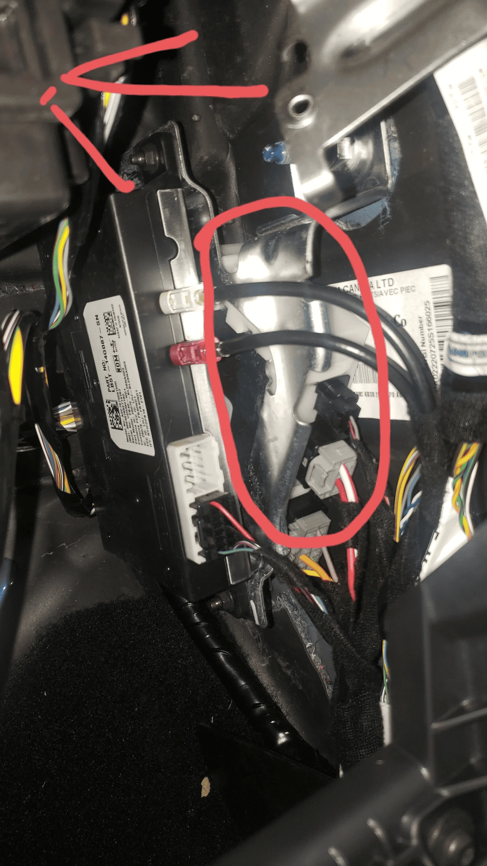

You also have electric modules in that area, they have relays in them, this will be a clicking sound.
1. TCU - Telecommunications Control Unit
2.TRM - Trailer Module - If you have the factory tow package
I believe some have reported the Trailer Module being noisy at times
For Ref:
Trailer Module (TRM)
TCU - Mounted to the left of it.
Door Actuators:
#5 Air Inlet (Recirculation)
#4 Pass Temp Door

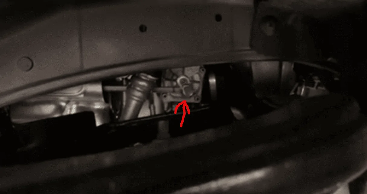

And for external noise, which I think this is what you are hearing
Waste Gate Actuator - Viewed looking over the top of the RF Tire.
This actuator power cycles just as you open the driver's door, (PCM Wake Circuit) to prep for engine start up.
When you turn truck off, it depowers. and cycles
Try this, open passenger window, get in the truck -(Open & Close) Drivers Door.
Do not do anything, as far as starting or accessary power. (Keep It Quiet)
Just sit and wait 3-Minutes, and then press the brake pedal and release.
You will hear the Waste Gate Actuator cycle.
