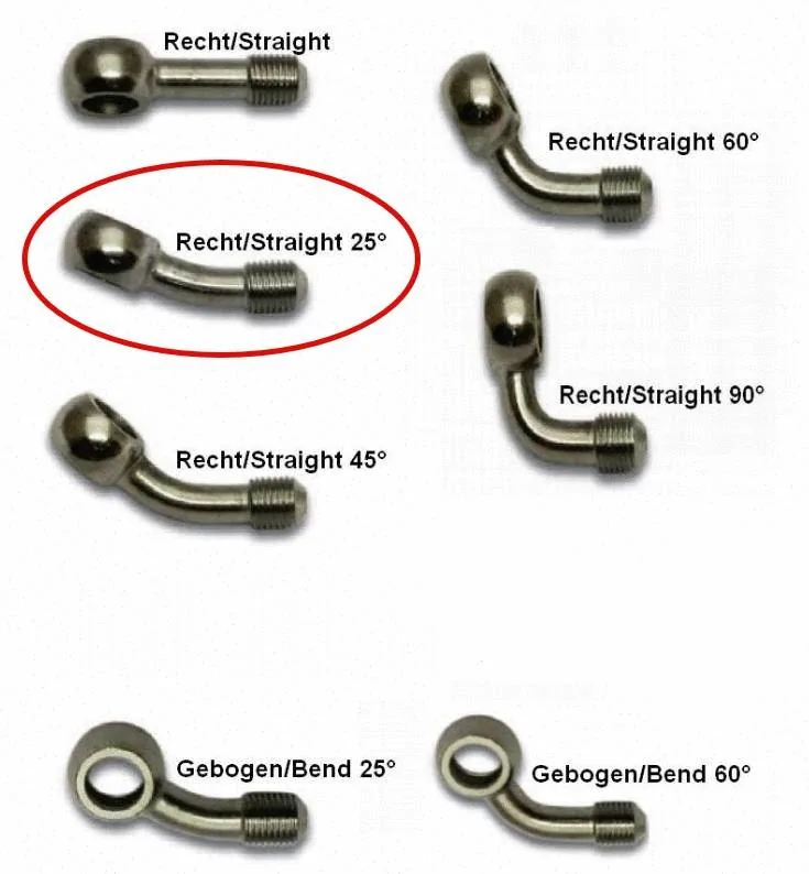

Just a FYI regarding the Pedders Ranger BBK installation.
A. 18" wheels are required... the factory spare (16" I think) and factory 17" will not work.
B. The SS brake lines provided is OK, but have issues.

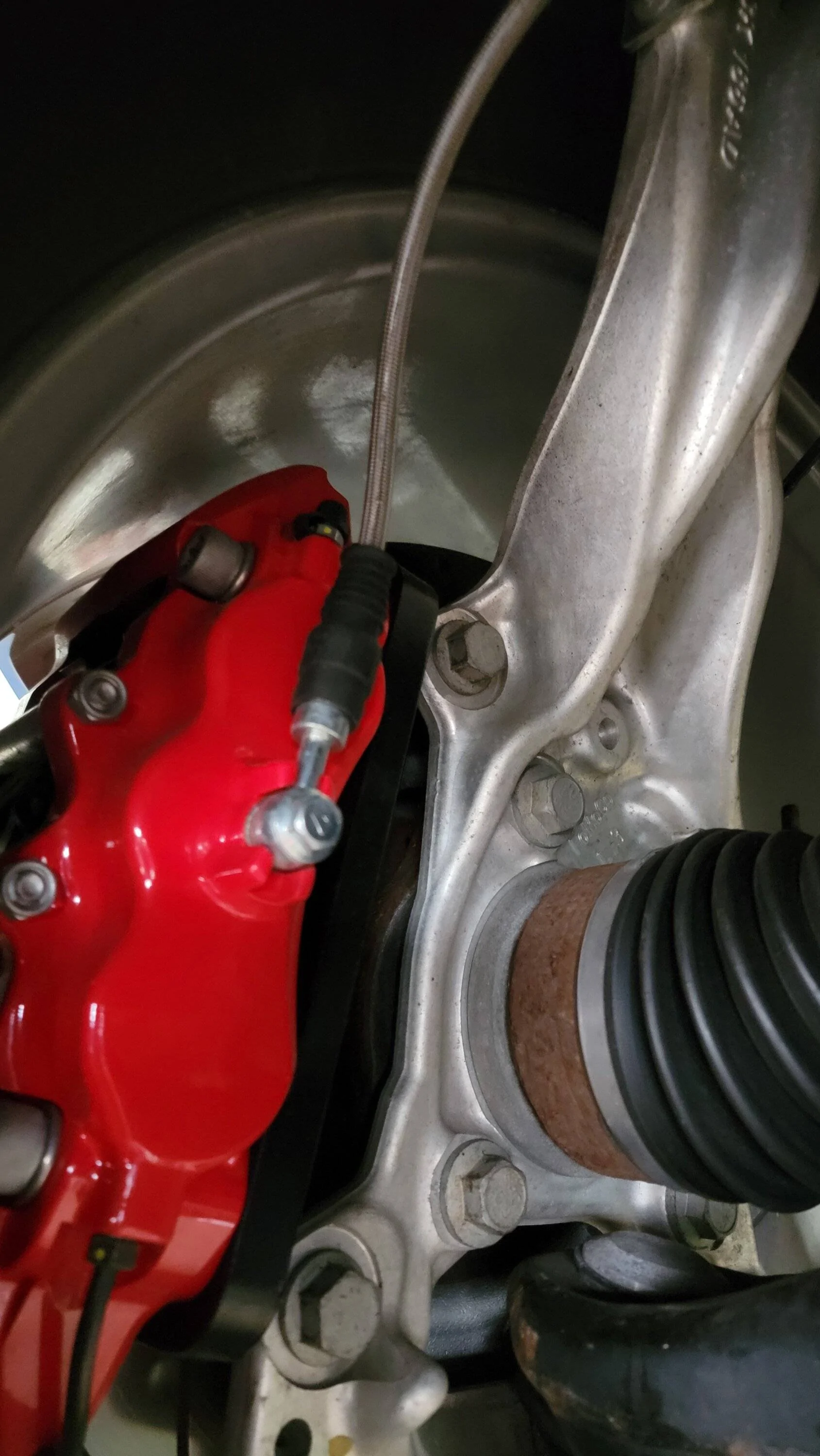

They attach facing straight up...
Which, with OEM 18" wheels (with 55mm offset) has the line pointing almost directly at the rim. And in my case, actually was rubbing on the rim. With my summer tire/wheel setup with 20mm offset, there was no issue. The line at the caliper end needs a 25° bend in it.

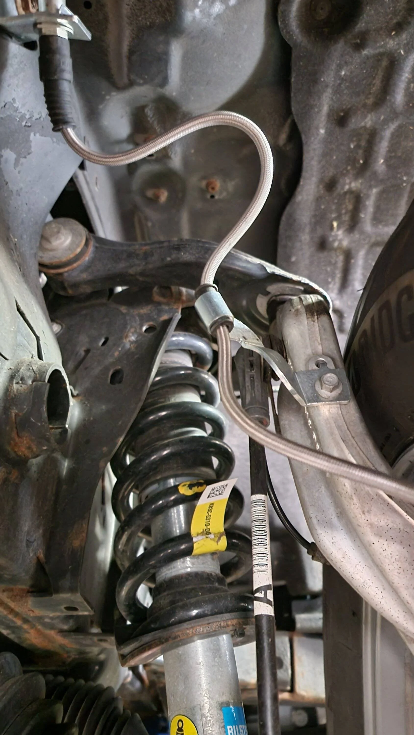

Next, the bracket is not positioned well to NOT bind the line with near 90° bends, and the line can't slip through the guide. Had to bend the bracket to prevent this.
(as adjusted)
Finally, because of the bad angle on the bracket (point more outward toward the tire) the line can, and did in my case, form a "loop" out over the tire and rubbing on the tread. This really showed up after the winter tires were mounted and the line made a heck of a noise as it got caught in the big gaps in the lug pattern. Serious off-road tire would be a disaster.
Now no rubbing, all's good. Other than this brake line issue, VERY happy with the setup.

Yes, they did fit but had to bend the bracket to hold them away from the winter wheel/tire setup (18"). Ideally, a 30 to 45 deg angel on the caliper end of the line would be the optimal solution but not a deal breaker. They have work perfectly both summer and winter.
