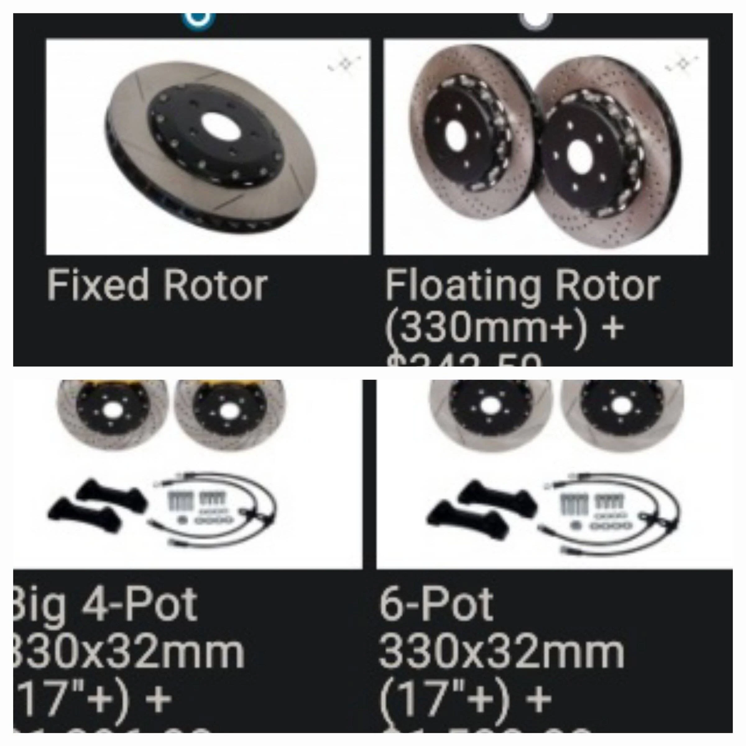

Once you add on the desirable options, it moves up to near $3000.
The $1300 set is 4 piston where Peders and others a 6 piston. PB's 6 piston start at about $1650.

Are the rotors a bigger diameter or just thicker?
Also what does 4 pot and 6 pot mean? And floating vs fixed rotor? I've replaced standard brakes and rotors in the past, even a rusted brake line, just haven't heard these terms, I've never upgraded to indifferent size.Also so for 16", 17" etc. Is that for the rotor diameter or wheel? My truck came standard with 17" wheels but I upgraded to 18" wheels when I bought it oem that is. I went down to 17" wheel on new ones for a couple of reasons, wanted taller side wall plus that wheel and color combo only came in 17". I presume the brake rotors stayed ghe same (fx4-lariat)

Nice line up. The only two that come close when equilaly speced, and still have a somewhat reasonable price, are PB & Ceika.
If money was not an option I would probably go with powerbreak

Just my suggestion, but if you are looking to "upgrade" brakes, do yourself a favor and at least try a different brake compound first before diving head first into these multi thousand dollar brake setups.
Bendix has a semi-metallic pad for our trucks for under $100 shipped for all 4 corners. Typically semi-metallic pads have a better cold bite, higher friction coefficient, and better fade resistance than ceramic pads, with the drawback of being dustier and noisier.
Brake pads and tires are way more important to braking than most understand. I can't tell you how many cars I've seen with huge multi-piston brakes setups at Auto-X get their lap times mopped by a car with stock brake hardware, a race pad, and a decent tire.
As the saying goes brakes stop the wheels, tires stop the car.

If your brake performance is diminishing, it means that something in the system is suffering heat related failure. It's normally either brake pads, or fluid operating over their intended range. Can larger brake hardware help this? Yes, but so can a pad and fluid with higher heat ranges.
Brake pedal modulation is mostly a function of your brake pad compound. All else being similar, big brake kits typically offer less brake modulation, for two main reasons. Increased piston area, and moving the clamping point further away from the center of the rotor will increase torque applied vs the pedal pressure. This translate in the firmer more sensitive pedal many report when they install BBKs. Pedal modulation is mostly about finding a compound that will provide you with consistent friction behavior from initial bite to lockup. Here's a good article on the subject.
https://www.g-locbrakes.com/faqwd/what-is-brake-modulation-2/
HD pickups typically run regular old iron 2/1 piston brakes that you will find underneath pretty much any non-performance vehicle. Their rotors and consequently calipers will normally be thicker though.
I'm not suggesting to never get big brakes, Just try a set of pads first before you spend thousands of dollar on these huge multi piston, 2 piece floating rotor, drilled/slotted disc, brake systems.
One thing often overlooked with these off brand brake brake kits is you are now tied to that company for your consumables, as they almost always use proprietary rotors and pads. A simple front pad and rotor replacement with the listed kit is going to cost you at least nearly $500, plus shipping from Hong Kong(or wherever they ship from) just for parts.
