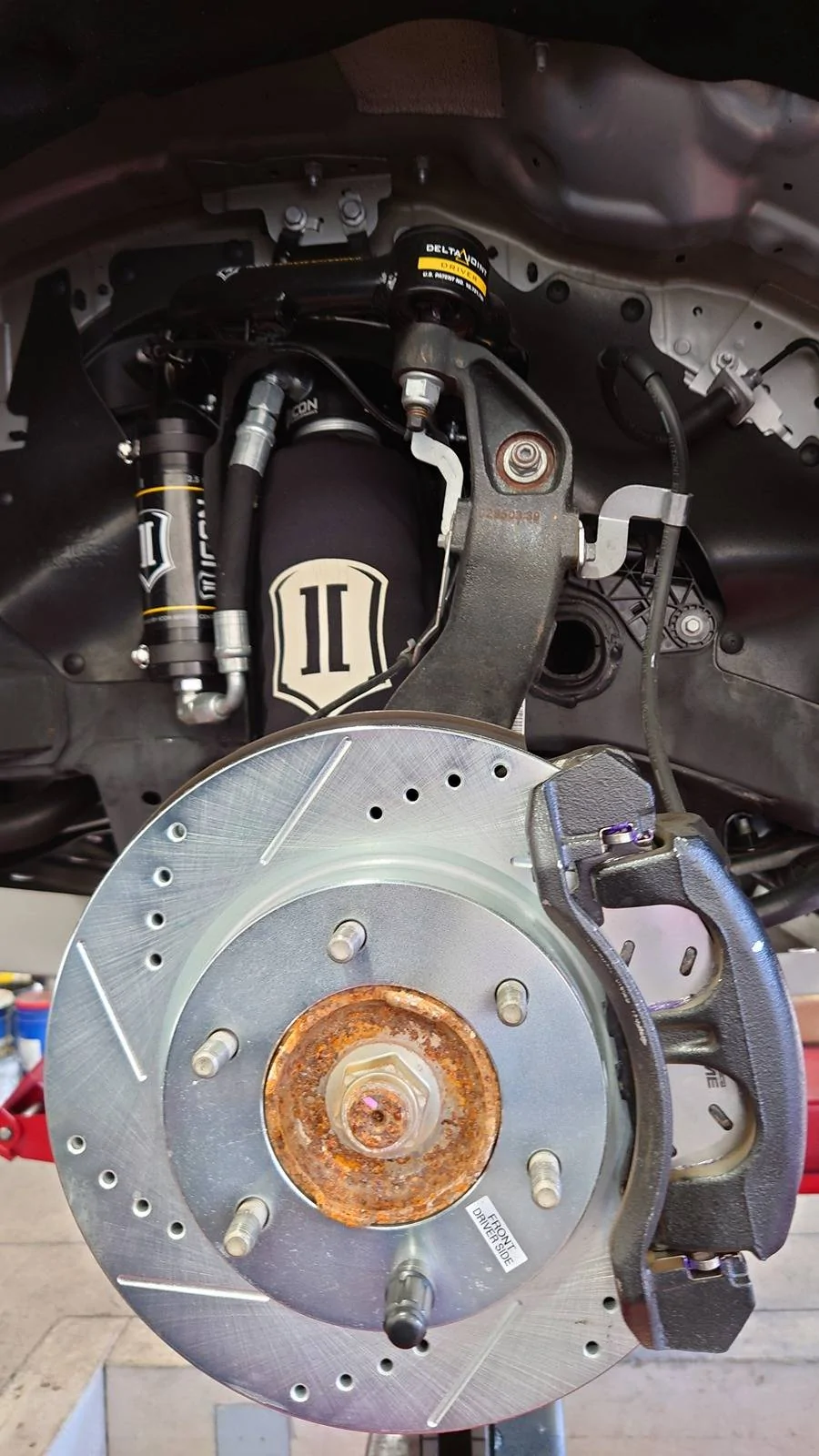

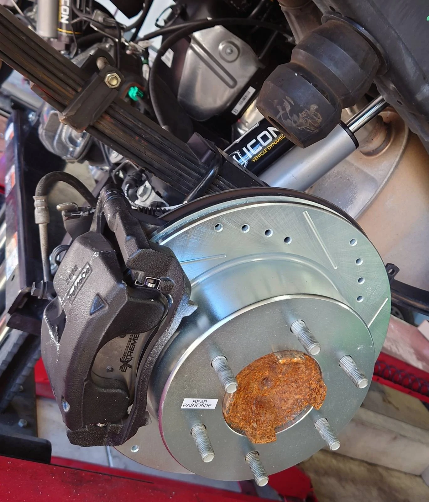

I did Powerstop w/ Tow https://www.powerstop.com/product/power-stop-z36-brake-kit/#y=2020&mk=FORD&mo=RANGER
If you have a mushy pedal, bleed and purge the brake system.
- btw most of the lines under the truck are SS lines covered, the rest is prebent lines.
For a bit more than $300, this seems like a nice upgrade. How has the performance been?
I don't tow, but do offroad as high speed. I just like have nice and tight brakes like most higher end cars. I've had mushy brakes since I got my Ranger. It stops just fine, but you need to plan as there's a big gap before the pads start activating.
