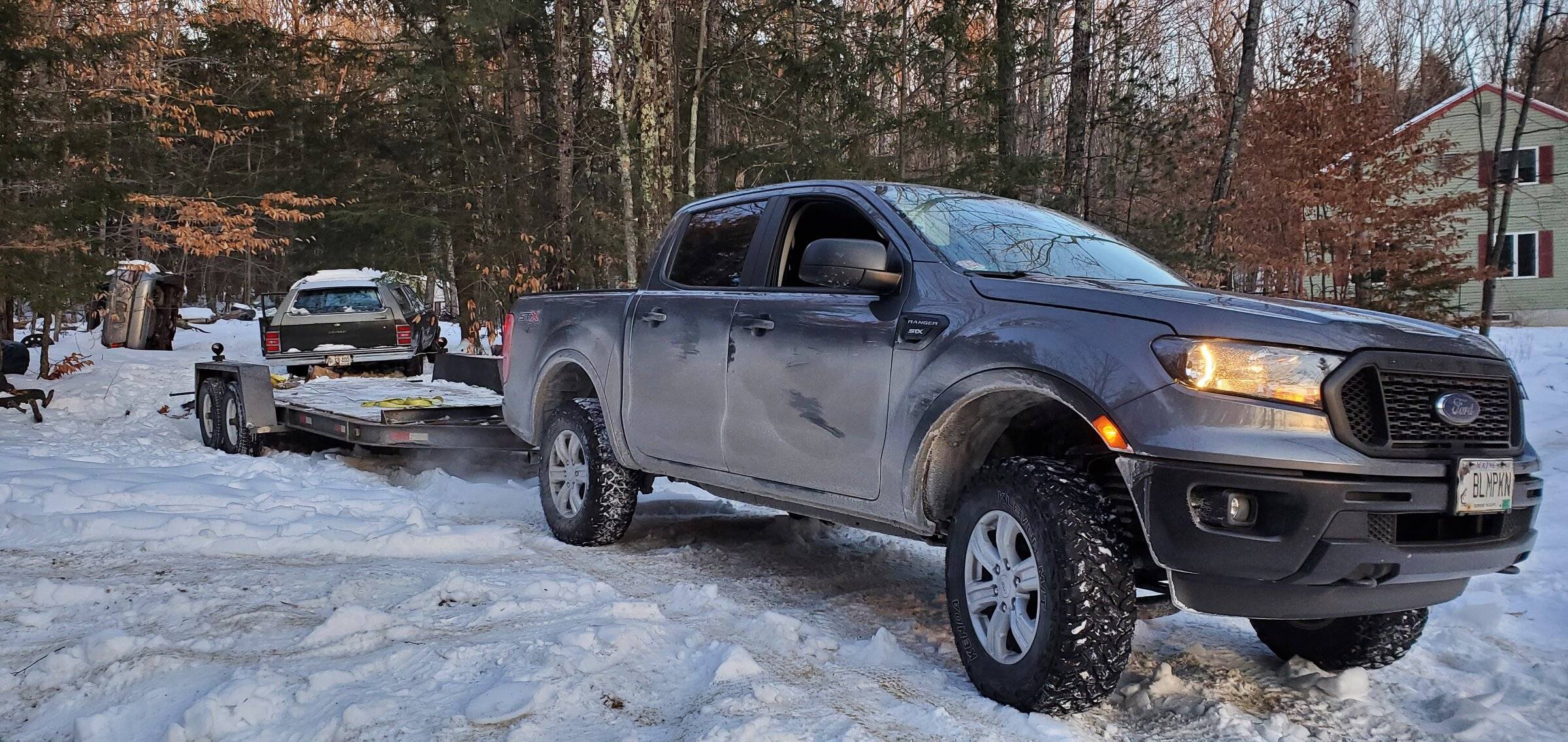

Why do you NEED big brakes, anyways? Do you race your truck? Are you frequently hauling large loads down mountain passes?
I towed 6k+ pounds around yesterday, no trailer brakes... and stock brakes were absolutely more than adequate. I wasn't going down a Mt pass though...

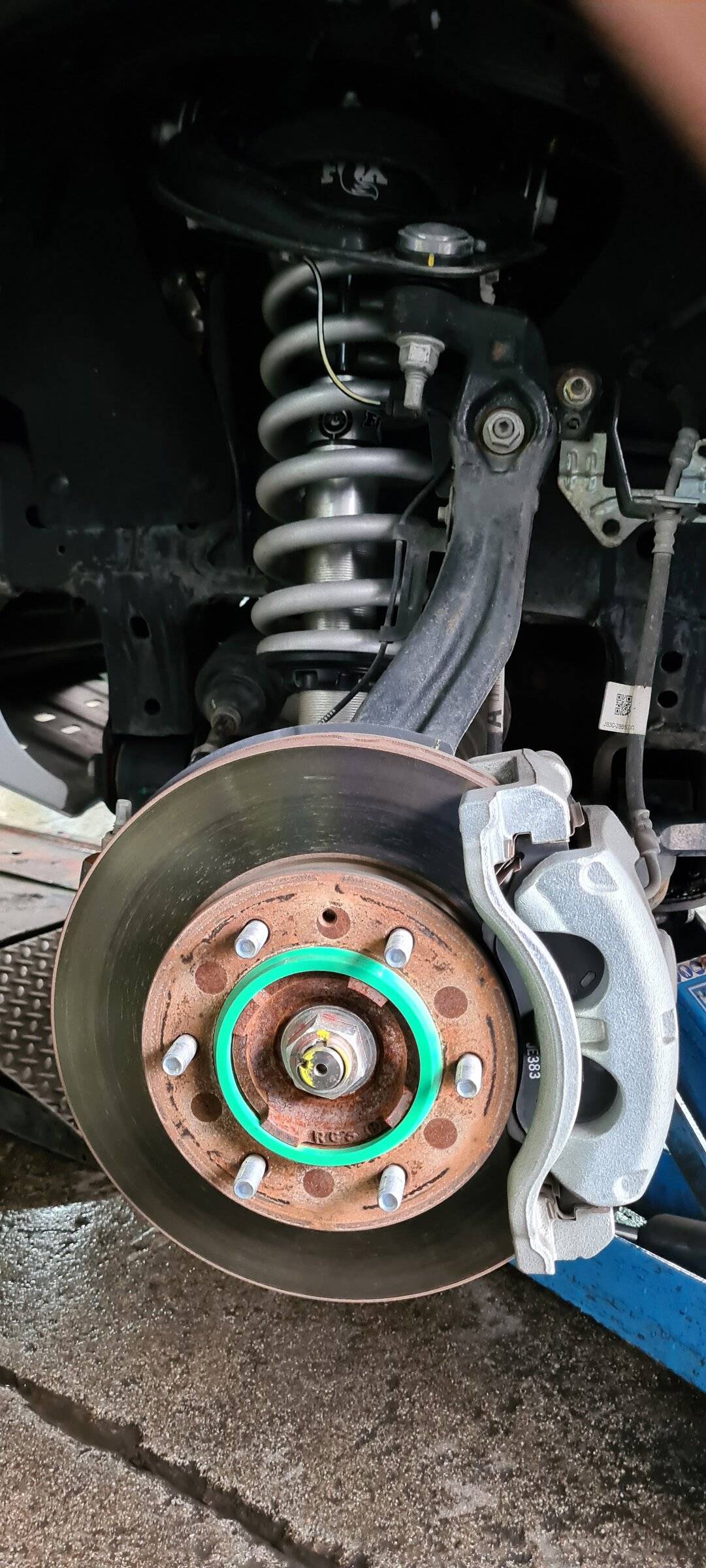

What do you mean when you say you want to upgrade your brakes?
The aftermarket car/truck community uses big brake kits like a sledgehammer to nail in a thumb tack. It is extremely rare that you would ever benefit from upgrading brake hardware on a modern vehicle that isn't being put on a track.
What these kits tend to do is give you a more aggressive feeling pedal. So for a couple thousand dollar you have a better feeling pedal(which may be worth it for you), but your actual braking performance as in your stopping distance is likely nearly the same as it was before. It's very similar to products like the pedal commander, sprint booster. Sure the pedal is more responsive, but the performance is the same.
Unless you are having heat related brake failure issues, up-sizing hardware will not net you any performance benefits.
