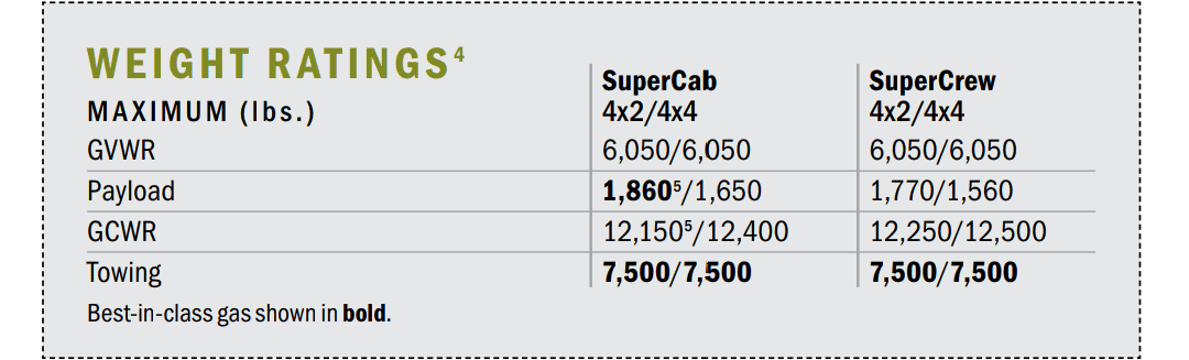

For those curious, the footnote about driver & fuel weight was pulled from this table (which lists payload and towing):
One would assume this applies to all values in the chart, given the location of the superscript...but what do I know lol.
Go by gawr, as balancing tongue weight and load in bed is just as important.
based on the axle ratings, my sticker does not include the driver.
We see errors all the time in the manual. I suspect this is one of those cases.
Certainly possible it is an error. Of note, Ford states the same thing in 2021 F150 literature, specifically regarding payload ratings:
I agee that axle rating is very important and easy to overlook. I suppose a truck scale is your best friend to determine actual loads in that department. Again, +/- 150 lbs is not significant enough to be cause for worry.
Not trying to spread any false information here, just sharing what I've understood payload rating to mean based on Ford publications.
