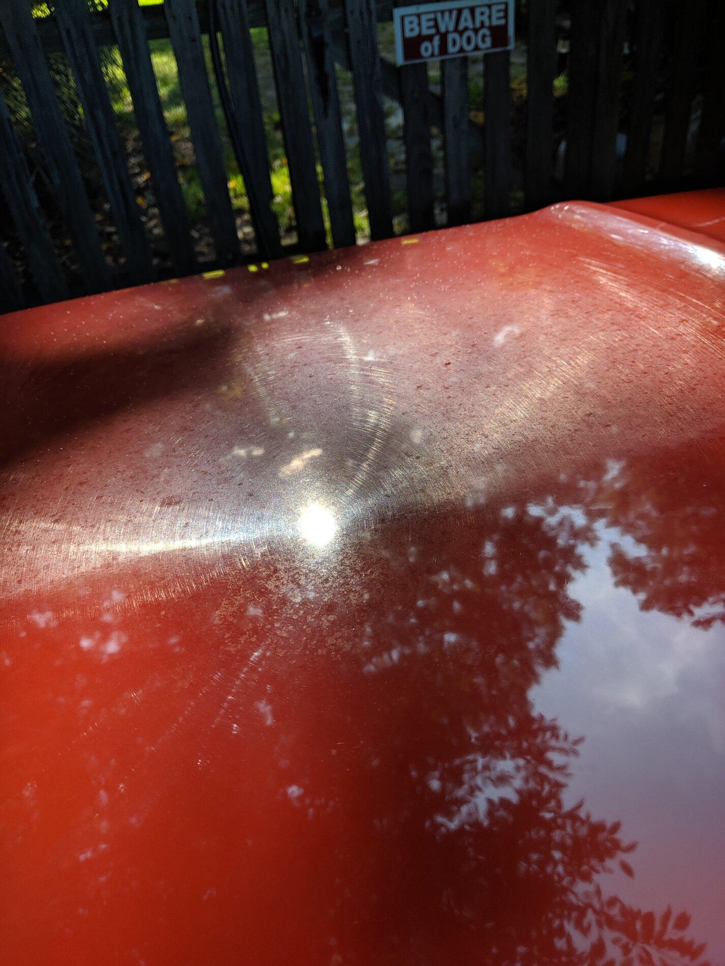

Worked with chemical guys on my 87. Old and oxidized paint in need. Did a two step with light cutting, then a glaze, and topped with carnauba. Took all day, and was worth it. Used my old Porter Cable, v36 followed by v38 on orange pad, then some glossworkz on white pad and butter wet wax on a black pad. I use TW ice seal'n'shine as my up keep.
Below pic is after the first step of v36.
